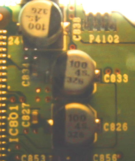

              Hello you mother (board) cappers, Just want to ask this simple question, then I will go away . Are the surface mounted caps suspected to be as much "no good" as the through hole radial electrolylic caps? I replaced a cracked LCD panel on a Dell E176FPf and it has this shakey-snowy look to it like it has some EMI problem .
              I replaced all the through hole caps except for these 3 aluminum surface mounted ones that are right near the video output ribbon cable. The interference is not as bad as before I changed all the other caps. I even switched the lcd screen to another one, thinking it may have been defective one, NOPE ,I changed the ribbon cable too,NAADA. It is absolutely awful this way so,makes you sick just looking at it, I gotta try it before I toss it against the wall .

                          Does anybody know what the 4s. marking is on these capacitors ? Does it indicate 6volts (I would assume). This is an LCD Control board out of a 22 inch Sharp TV . It turns on, has sound ,the backlignts are working ,but the screen is all segmented with all kind of weird designs and colors (mostly grey) .The longer it is on ,the brighter it gets. I am thinking of recapping this before I replace the whole board,but I don't know for sure what this 4s. indicates on the top of some of the smd caps.

                            Re: Recap Surface mount capacitor
                            likely 4 volt
                              I agree.
                              The "S" looks like a logo.
                                Thanks for that,I am going to go with it ,There were also somemore on this board that said 6 s that is why I said 6volts I just took picture of the 4 s ones.There are about 50 caps on this LCD Control board. Would it be better(SMARTER) to replace all the caps or buy a used and working board for around 60.00 dollars?
                                    This depends on if the card fires up (works) at all.
                                    When in doubt and if possible just check volts on cap with a multi-meter by connecting the probes to solder points on the other side of the PCB.
                                    Remember, depending on what the cap does there might be times when volts changes because of what circuit is doing (device mode/condition.) so if you aren't sure of the caps purpose check the volts in all known operating modes to be sure.
                                      If you know the purpose of ANY of the caps 'with the same marking' (and so know if the voltage should be changing with mode changes) then check the volts on that one.
                                      - If it's over 4 you know 4v isn't the voltage.
                                      - If it's under 4 the you still only know it might be 4v,, because other caps might be on higher volts.
                                      I'm pretty confident the mark is for 4v though.
