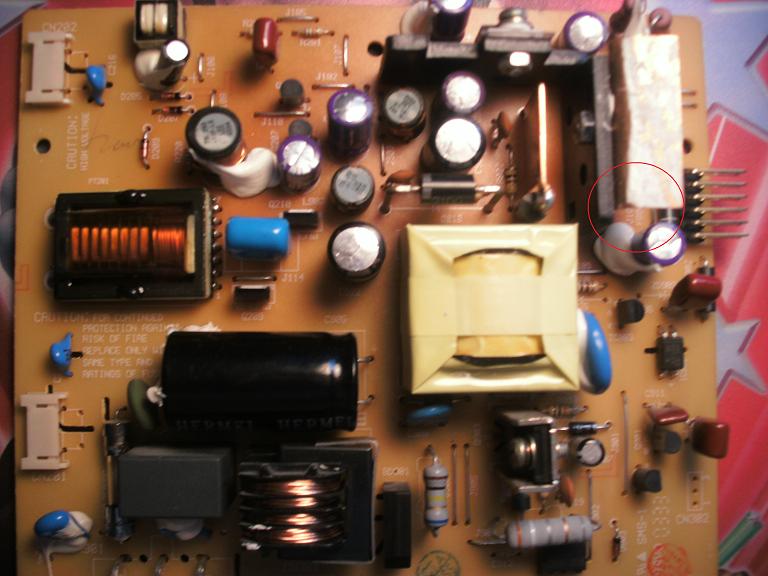

                    Re: HP 1502 (P9617D) pulsing on and off with bad capacitors
                    wow great thread! my brothers monitor started showing the signs of blown caps as it wouldnt turn on and at the time i wasnt really savy with things like this so we just dumped it away in a cupboard but recently i found myself in need of another monitor so i pulled it out and started tinkering with it, i opened it up to find slightly puffy caps which needed changing and also a scorch mark on the board, thing is in this thread ive seen the same scorch mark on all of the pics posted, its right next to C933 and the heatsink looking thingy, (picture attatched) my caps are on the way in the post so i will be able to replace them soon but does anyone know if changing the caps will be enough? its just the burn is in a really random place, thanks in advance guys =] also awesome community here ^^ i stumbled across this place while looking for capacitors
                    • PlainBill
                      • Feb 2009
                      • 7034
                      #30
                      Stop and take a breath once in a while.
                      Scorch marks are common - they are caused by lack of a heat sink on the inverter driver transistors.
                      At a MINIMUM replace all bulging caps. Even smarter, replace any caps from manufacturers on the bad caps list . Best of all, replace all electrolytic caps (except the big 450V electrolytic) in the power supply. Replacing all caps will cost about $10 for parts.

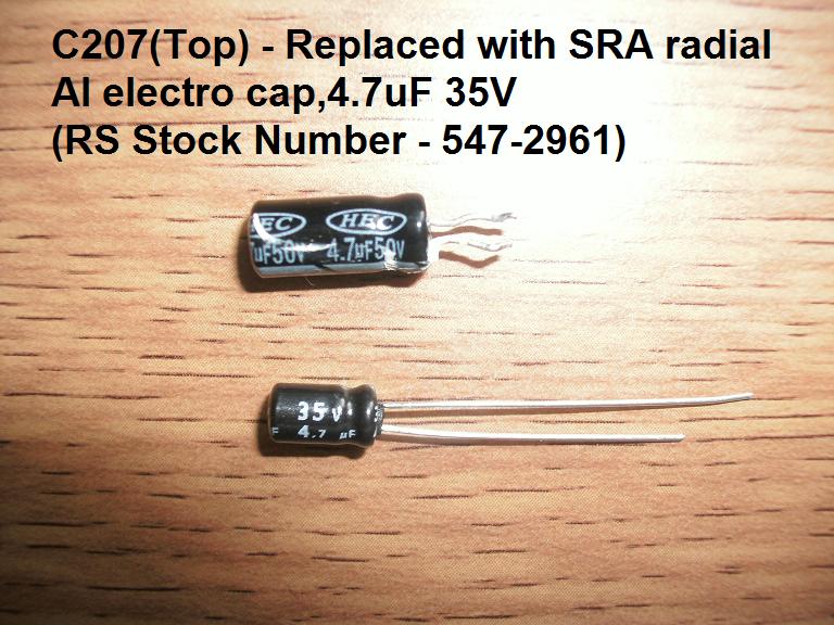

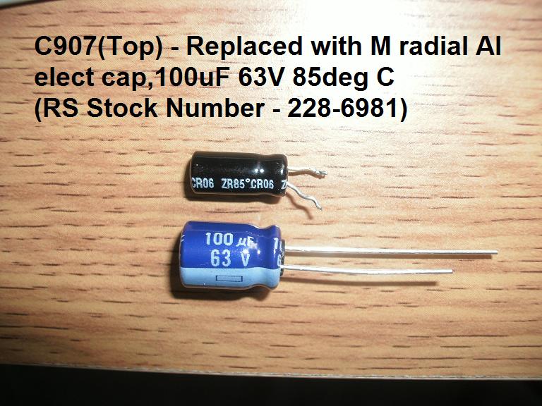

                          #32
                          Hey Again, as ive never done anything like this before i just wanted to check if the caps i have chosen ( based on the specs from the first post of this thread) will be okay hehe. here are the ones ive done so far:
                          See the Attatchments, then these are the other ones i will be replacing later today.
                          C922, C925, C924, C926, C929, C930, C932, C933 - With FK radial elec cap 1000uF 16V - RS Stock Number - 571-656
                          And
                          C201 - With FC radial elec cap 1000uF 25V - RS Stock Number - 571-981
                          This is the site i bought them from -
                          http://uk.rs-online.com/web/
                          Thanks a lot in advance for your help guys =] sorry im such a newbie at all this.

                            #33
                            They should work. At first I thought you had a problem. In the US Panasonic FK series is a surface mount type, but the link at R-S shows it is a through hole type.
