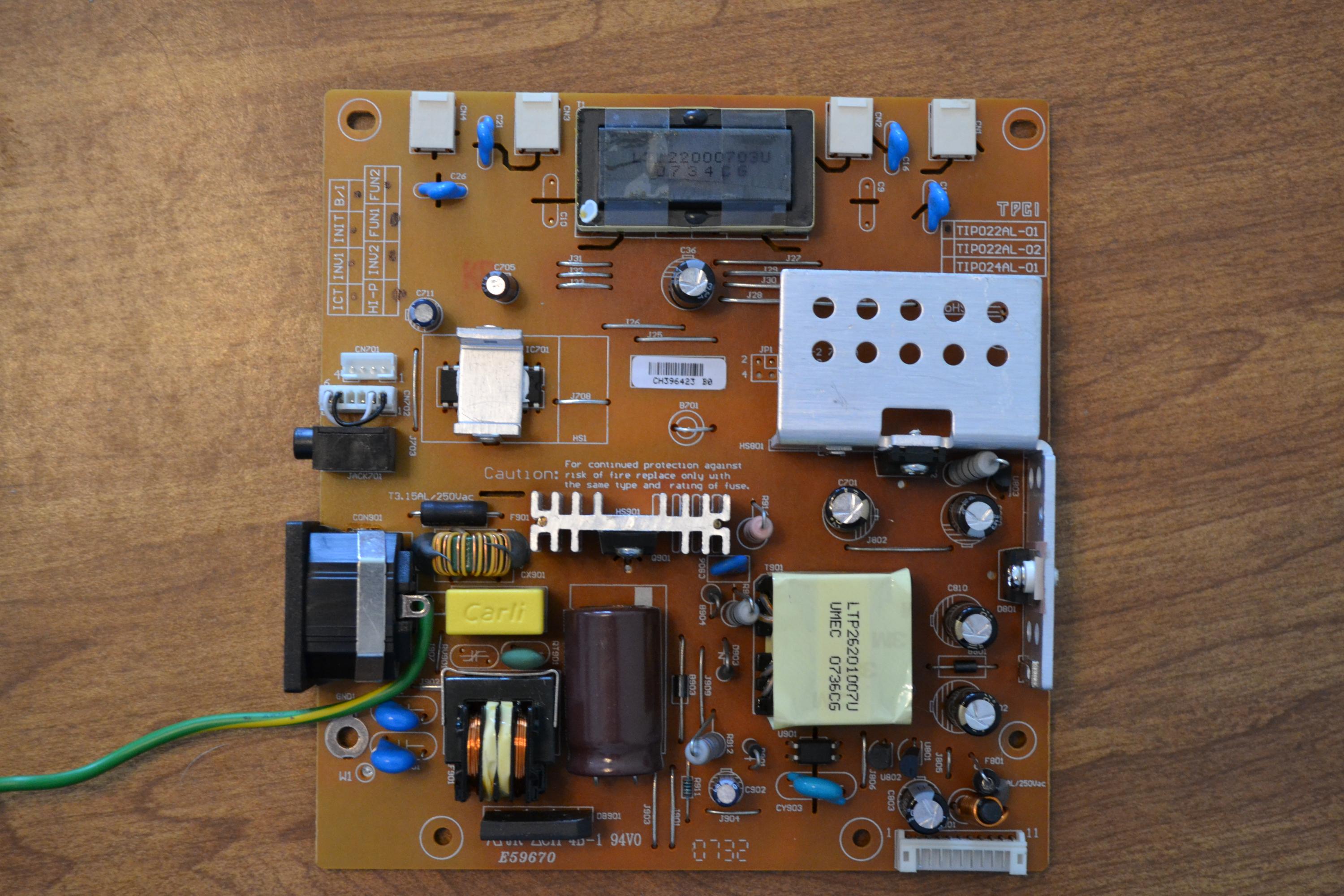

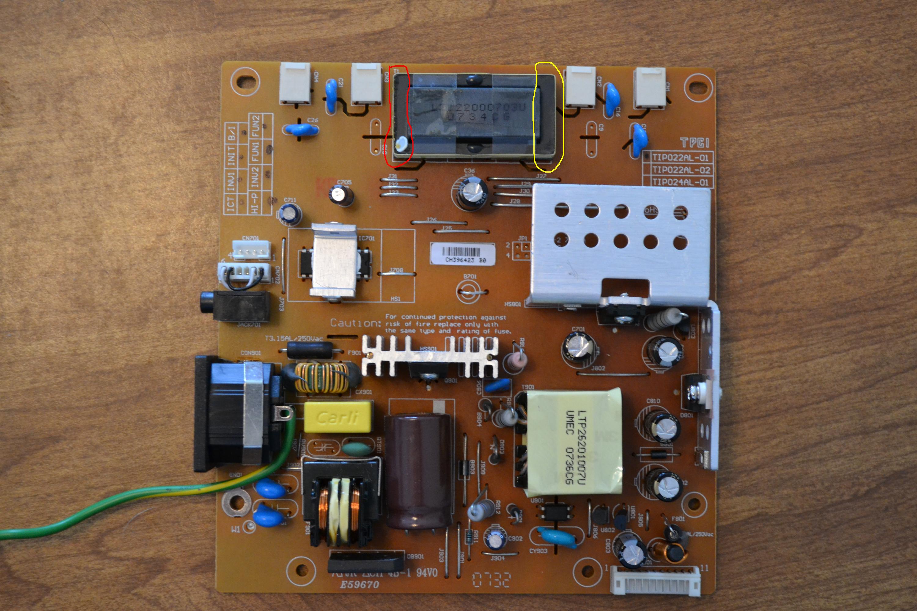

        I don't know much about transformers, but below are the results I got from testing the pins.
        Here are my results on the transformer:
        1 to 2 - 1.0 ohm
        1 to 3 - 1.0 ohm
        1 to 4 - 1.0 ohm
        1 to 5 - 1.0 ohm
        2 to 3 - 1.0 ohm
        2 to 4 - 1.0 ohm
        2 to 5 - 1.0 ohm
        2 to 6 - 1.0 ohm
        3 to 4 - 1.0 ohm
        3 to 5 - 1.0 ohm
        3 to 6 - 1.0 ohm
        4 to 5 - 1.0 ohm
        4 to 6 - 1.0 ohm
        5 to 6 - 1.0 ohm
        1 to 2 - 1.5 ohm
        1 to 3 - ~150k ohm
        1 to 4 - ~150k ohm
        2 to 3 - ~150k ohm
        2 to 4 - ~150k ohm
        3 to 4 - 1.0 ohm
        based on the sticky guide, I'm guessing there may be a problem here.
        You can see my numbering in the attachment.

          Re: Sceptre X22WG-1080P (different board than on other threads)
          Hi sorry i meant the inverter transformer

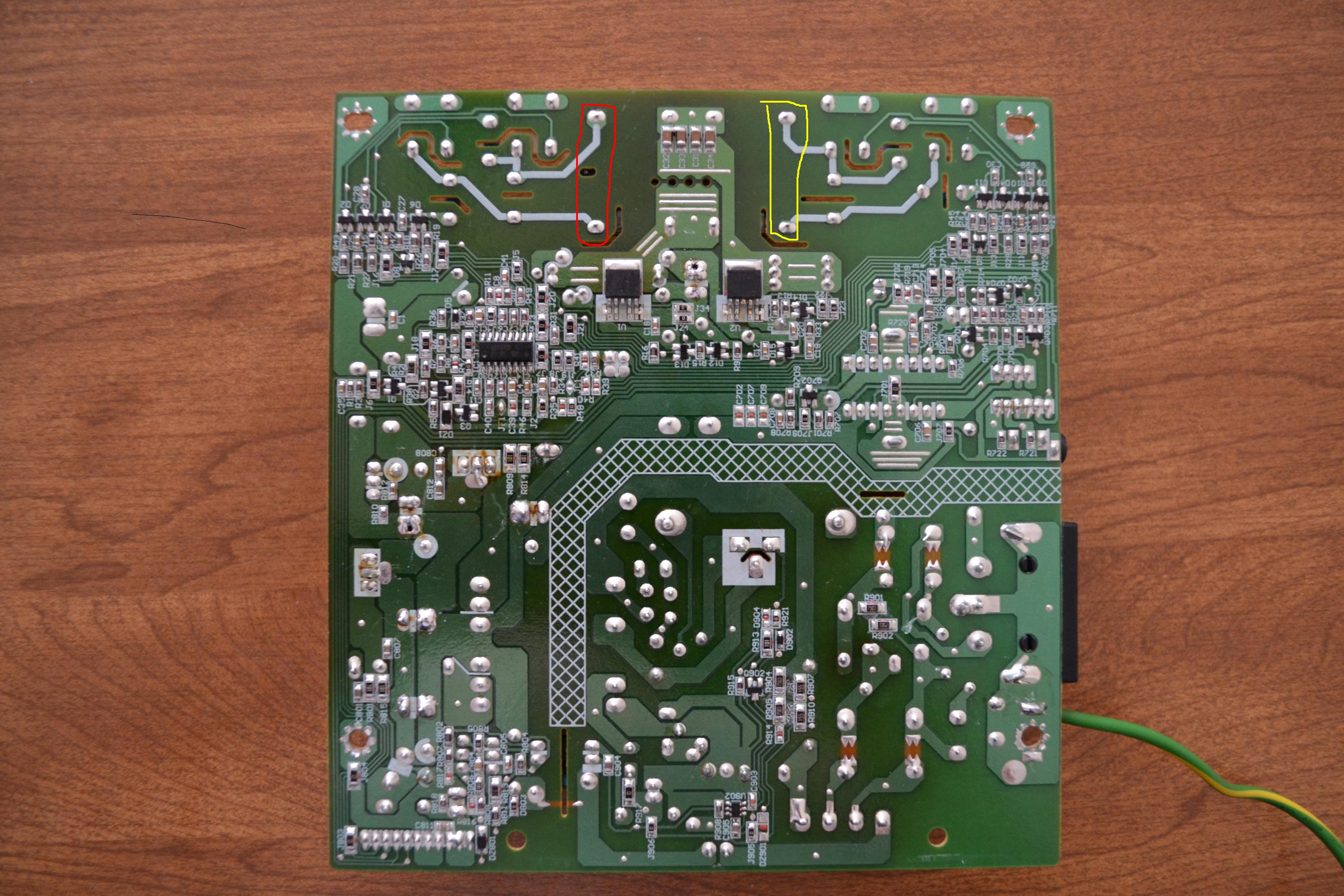

          See pic i have ringed each end flip the board over and measure the resitance between the 2 pins in the red area and do the same in the yellow area and post result
            I got 645 ohm across both sets.

                    The only numbers I see on the Inverter transformer is LTL22000703U and 0734C6. You can see those numbers in my original attached pic.
                    What should I try next? I plugged the 22" lights in to the 19" monitor, and all 4 lights light up, temporarily, but they suffer the 2 seconds to black on that monitor, also. I kinda assumed the 19" just couldn't push enough voltage to keep them lit.
                    What would be my next steps, here? If the transformer is good, all the caps have been replaced, and the backlights are brand new, what else could be wrong? This is the most work I have ever had to do to resurrect a monitor. Actually, I should say, this is the most work I've been willing to do to resurrect a monitor. This one is for my own personal use, so I kinda want it to work, again.

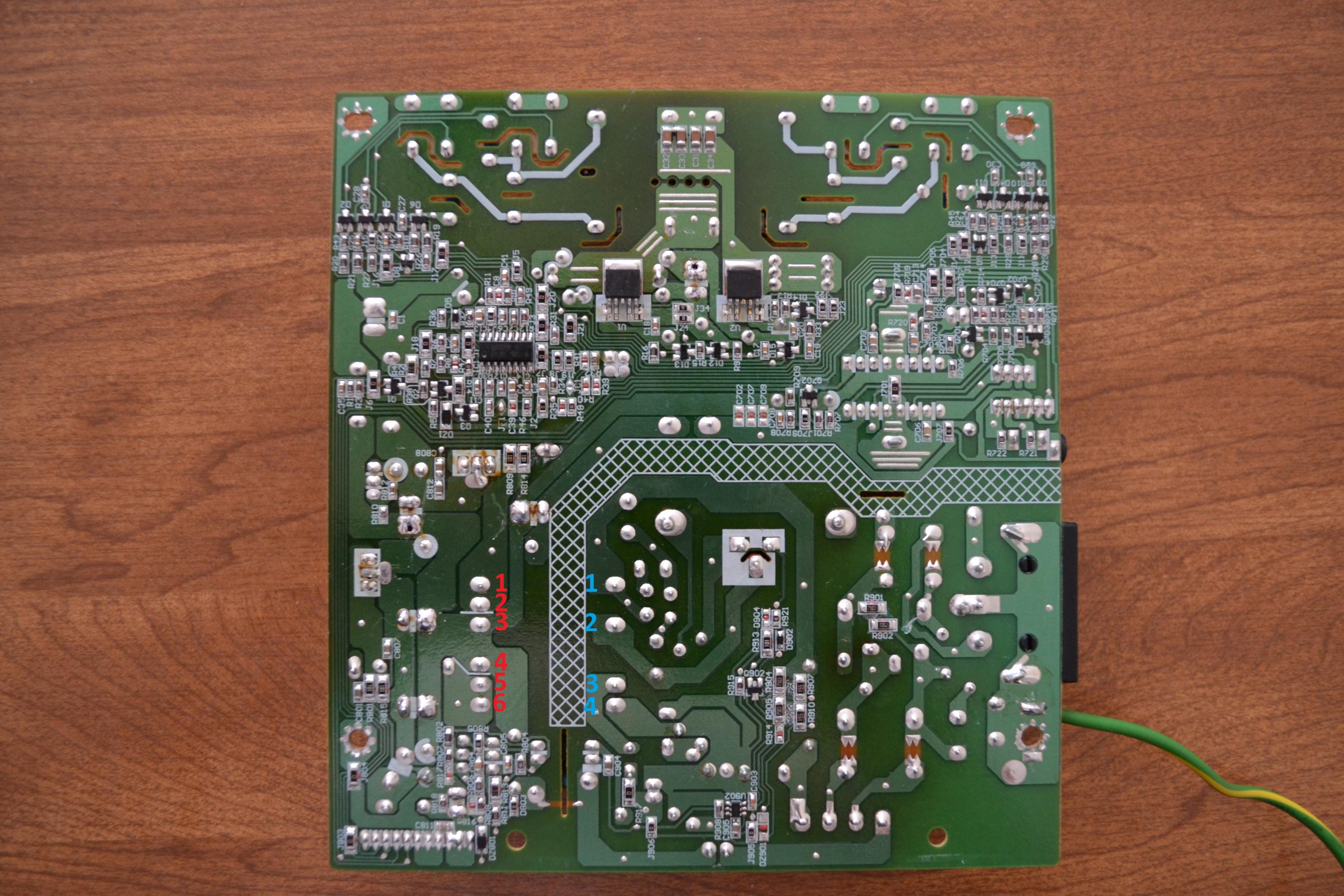

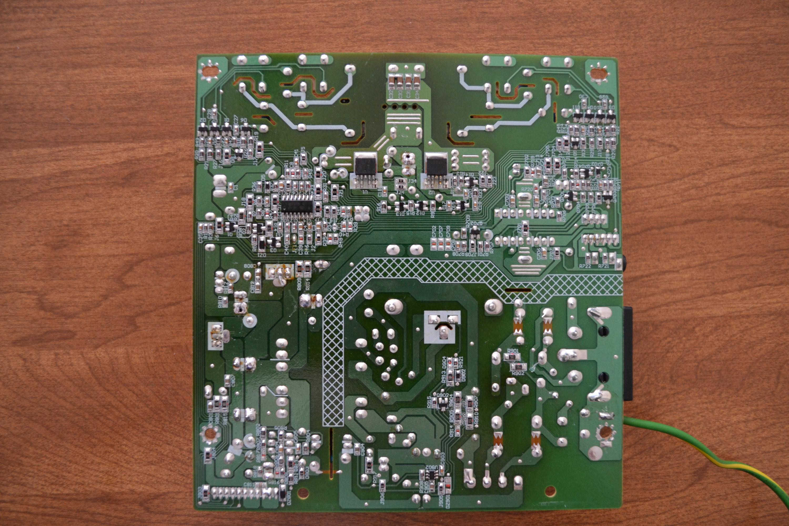

                          I have been looking at the back board pic there seems to be browning around
                          U1 but not on U2 - what are the part numbers - perhaps test them.
                          • Skoffer
                            n00b
                            • May 2011
                            • 32
                            4511GH
                            626696
                            Those are the numbers as read off of U2. The numbers on U1 are the same, but distorted, maybe by heat damage.
                            That browning in the picture, though is not as visible with the naked eye. I had to get it in the light at just the right angle to see it, but it is definately present around U1 and not U2. U1, to my untrained eye, looks to show presence of heat damage.
                            These are ICs, correct? How do I test them?
                            EDIT - nevermind...they are mosfets.
