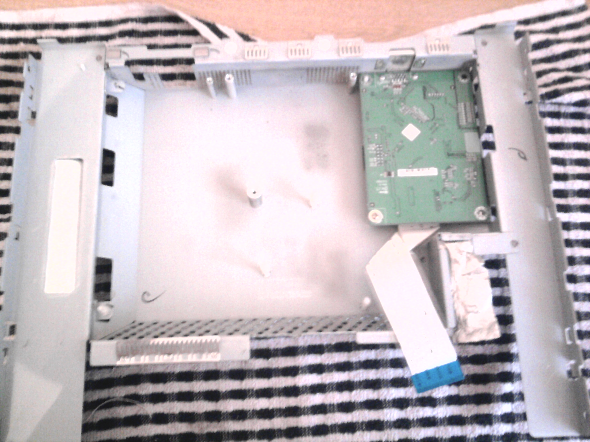

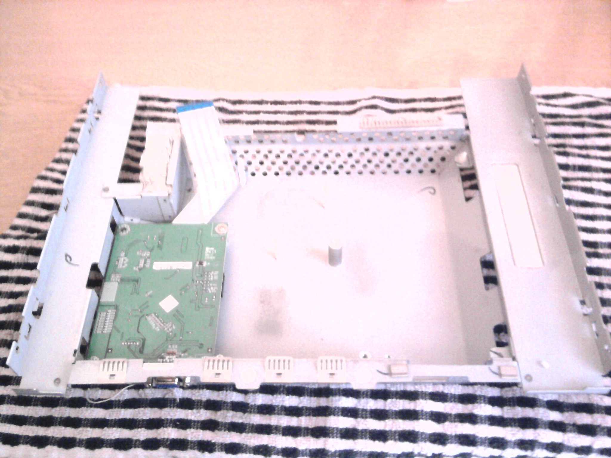

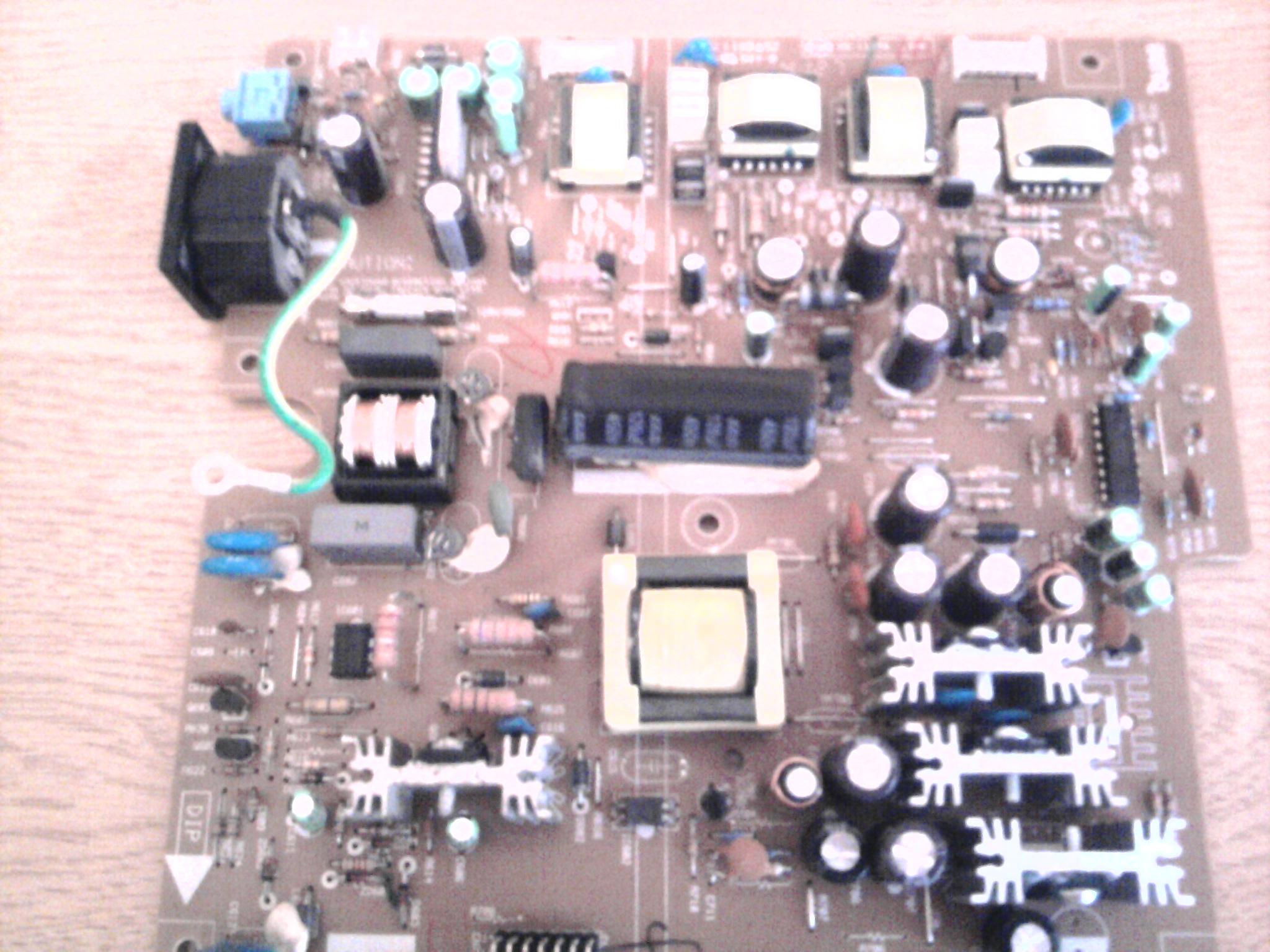

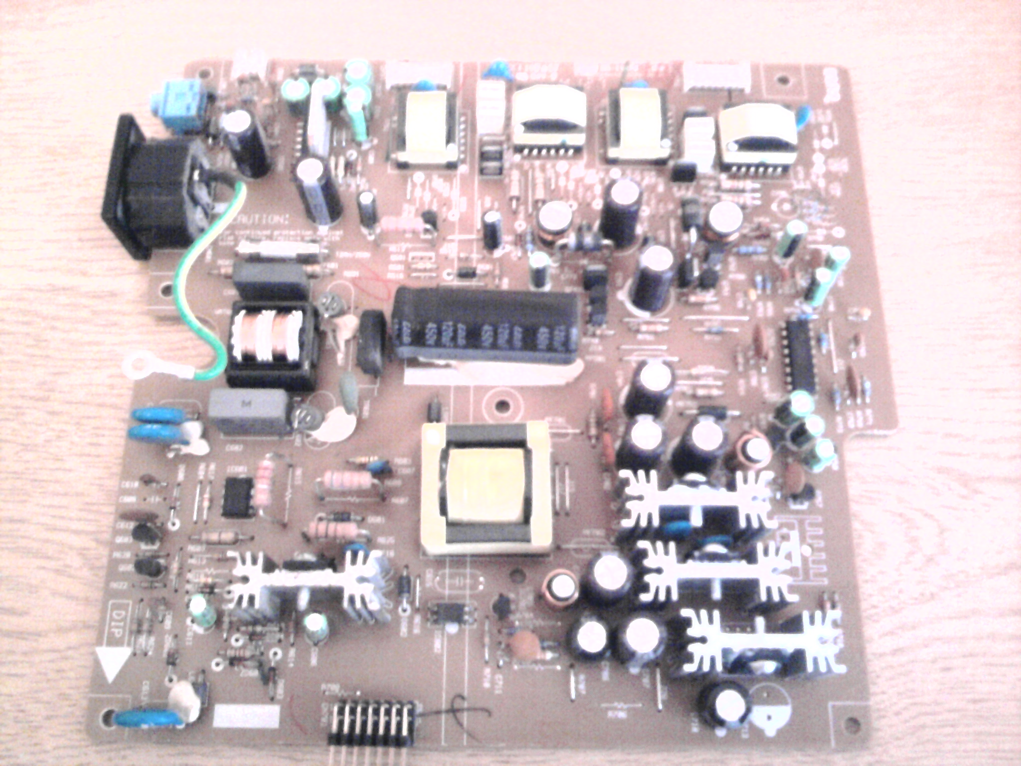

    Hi guys I am in london and have recently tried to diagnose a problem with my monitor I have seen some of the postings on here but not sure the symptoms are the same as mine,well it does not display anything and when you put a laptop onto it just goes to amber and nothing I have got the monitor open currently but not sure what caps are causing this issue,sorry if this is a reapeated topic any piccies or pointers will be very helpful.

    We can help a lot more if you please post good clear pictures of the whole chassis, and then pictures of each board, front and back (in the same orientation) and close up of connectors, (max resolution 2000x2000 and 2MB) using the manage attachments button, which is found by clicking "go advanced" under quick reply.

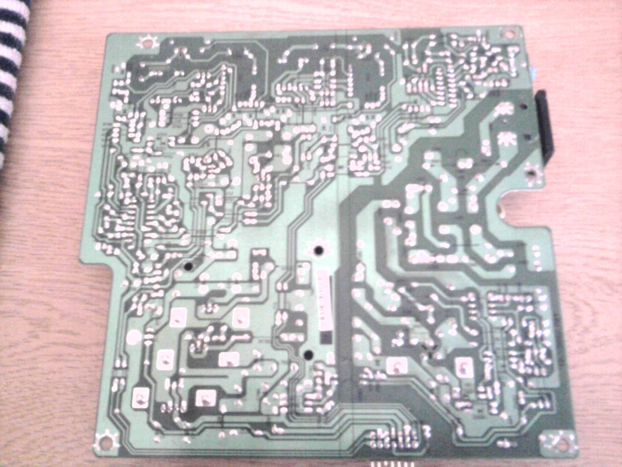

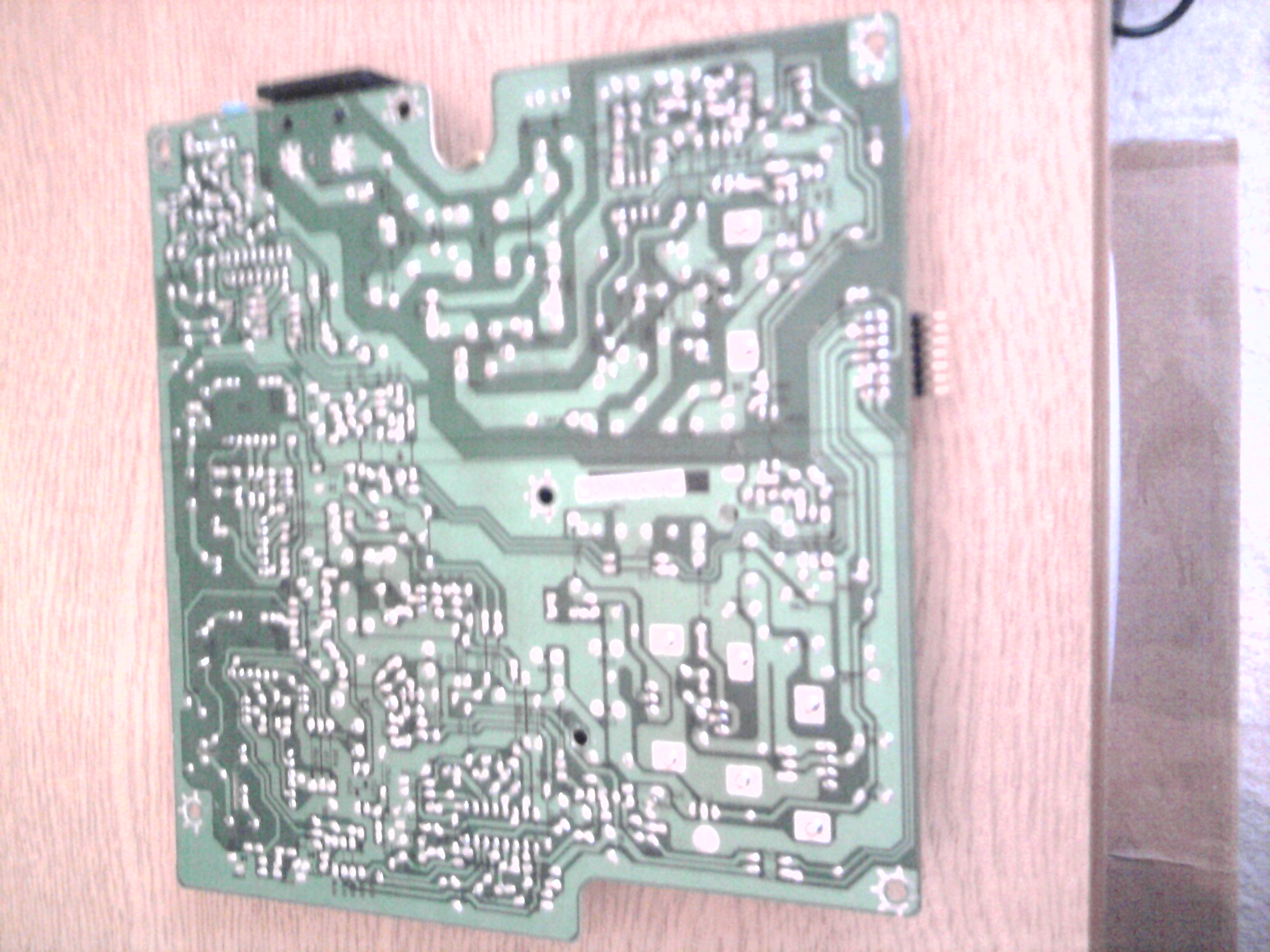

      Anyway much more happier and freer,anyway I do know electronics a little bit and can take care of small issues like this but I have sent picture of my main board I hope they are of some help.
      Thank you for your time and help.

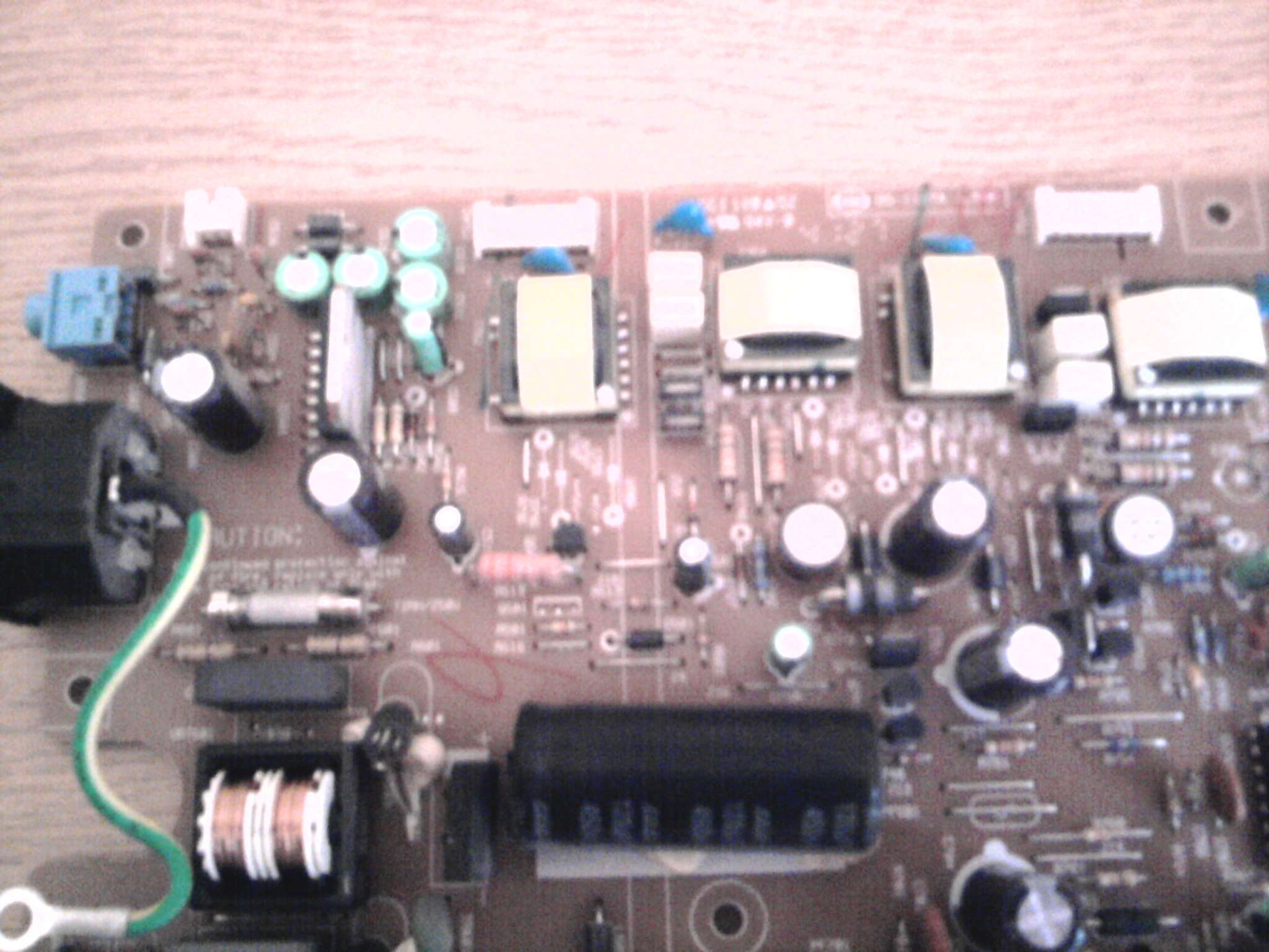

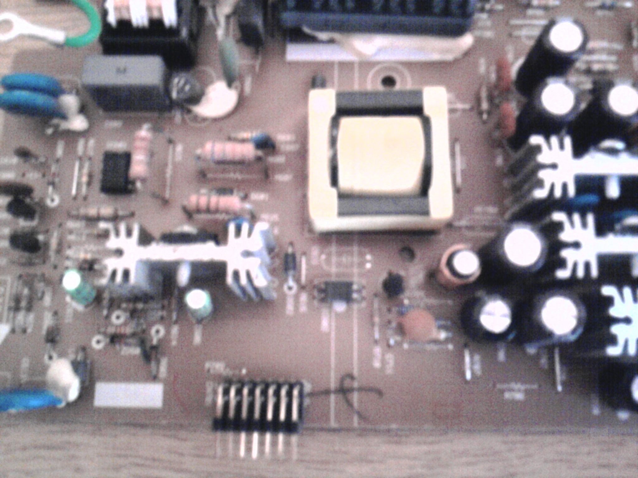

          Sorry but the pictures are useless - You may as well delete them and save the space on the server -can you do better.
          Look at the picture 5 and 6 there is a big capacitor - using ONLY the picture can you tell me what it says on the side.
          That is the largest component on the board so how are we supposed to see the others.

              Re: Benq FP 767 15" Monitor
              Elite
              120uF
              450v
              Muh-soggy-knee

                Main problem with these Benq boards is failure of th 2SC5607 transistors.There are 2 pairs of these,located toward the bottom of the board near the 4 transformers. First thing most people do is test these for short ccts..normally one pair fail.

                  Hi Ben7 thank you for your reply ok the big capacitors values are 120uf and 450V.

                    Hi Rtech thank you for reply ok I have struggled to get a more exploded view of the board I think I have located the transistors you are referring too but not 100% sure looking at the 4 transformers I see the 4 transistors so would you recommend replacing all 4 as my first port of call?

                      I would suggest measuring them, to confirm that they are at fault or not,there can be lots of other reasons for your problem.

                          Ok just a bit of a loss now I have had the Transitors checked and the reading are all fine,so what would be my logical next step with this problem I am hoping someone may have experienced this problem.

                            Looking at your picture 6, there is a Black PF fuse, in front of the three aluminium heatsinks and one of the Black capacitors....check that ..

                              Sorry excuse me being slow but on my board there is only a white fuse that appears to be soldered in or is their a another fuse?

                                Hope this shows it ??
