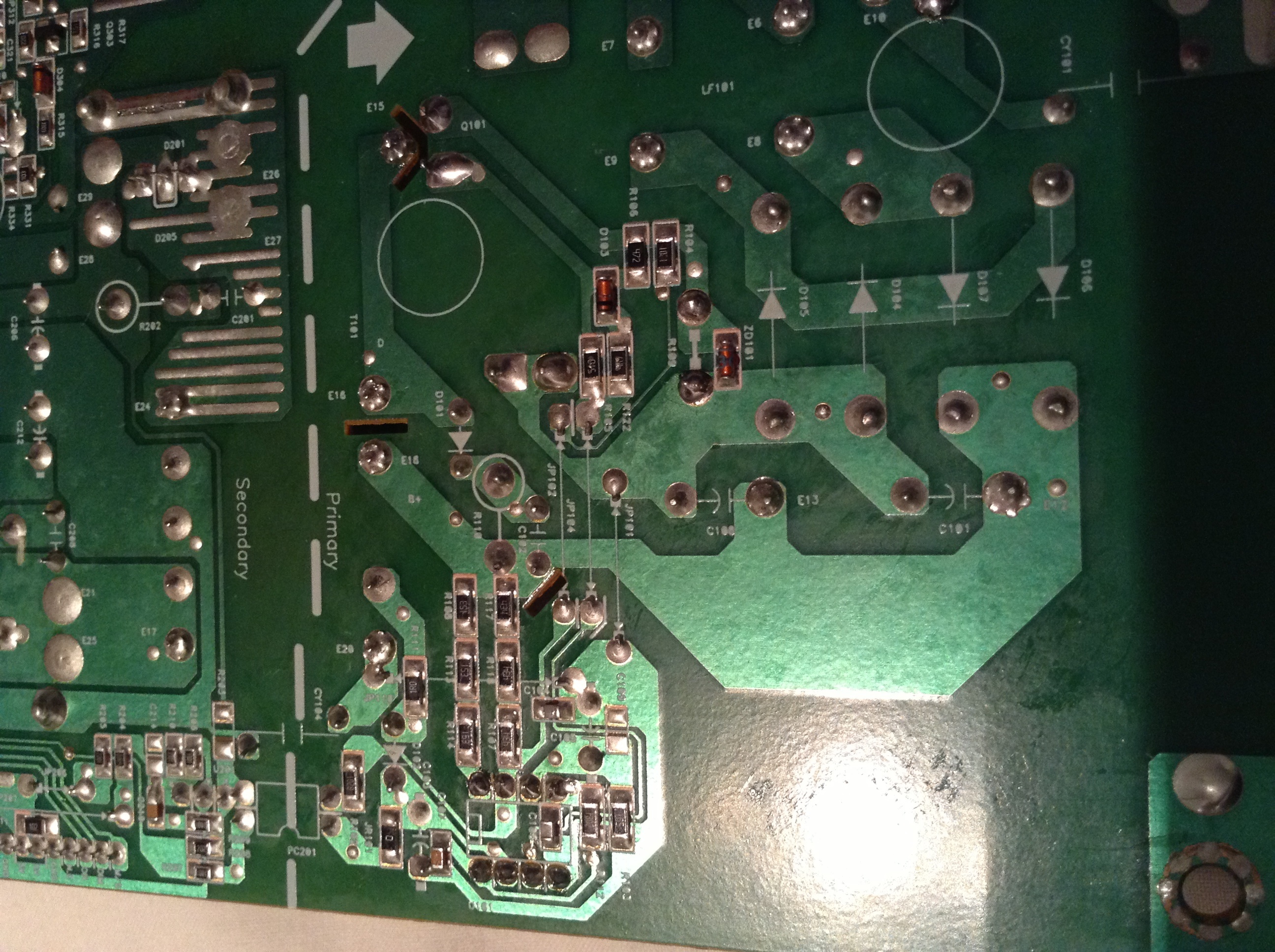

                    Ok MOSFET is shorted still out of circuit.
                    No short on board with MOSFET removed.
                    I haven't ordered smps chip, would you advice to do that before trying the other two or replace all three? Happy to do that just wasn't sure what best practice was

                              Thanks so much received components, the resistor seems a bit different does that matter? It's a 0.39 I think although multi meter reads 0.06
                              Thanks will try fitting them
                              • Trune
                                • Jan 2013
                                • 45
                                • England
                                #35
                                Re: LG W2442PA-BF wont power on.
                                That's a shame,replaced resistor and MOSFET and still no luck.
                                So replaced SMPS and tried again, resistor blew up again.
                                Also saw spark from base of board, but can't see any other damage. Whether the spark came through from resistor not sure.
                                Not sure where to go from here.

                                  You didnt have the legs too long and they shorted on the frame?
                                  Test the mosfet again and the two fuses.
                                  Check those 4 diodes and post the results this time.
                                  Check for a short on the resistor pads.

                                    #37
                                    MOSFET and two fuses are fine. No short on metal case board goes in upside down.
                                    Diodes
                                    D105 - 544 - 0.870m ohms
                                    D104 - 541 - 0.800m ohms
                                    D107 - 538 - 0.784m ohms
                                    D106 - 537 - 0.744m ohms
                                    Resistor pads do you mean with resistor removed? I checked that before fitting new and no short. With resistor in and blown it shows momentary short with continuity test.

                                      =Ok - they still look good - I meant with resistor out - couldnt remember if you had done that before - I dont understand if there is no short showing why did it blow!! - Can we see your soldering handywork.
                                      Could you see any more damage to the board re the spark

                                        Short of taking out every component around the mosfet, SMPS etc,and testing them individually there is not a lot more you can do.Will give it some more though in the morning !!!
                                          Yeah can get a pic.
                                          What about the fact the resistor wasn't the same value as old one, does that not matter?
                                          The spark could have just been the resistor I suppose, it was same area but resistor body was on underside obviously.
                                          Although the fact exactly the same component blew after replacing the smps I guess there's a big issue elsewhere.
                                          I'm not sure my soldering can be called handy work, I think it's okay though.
