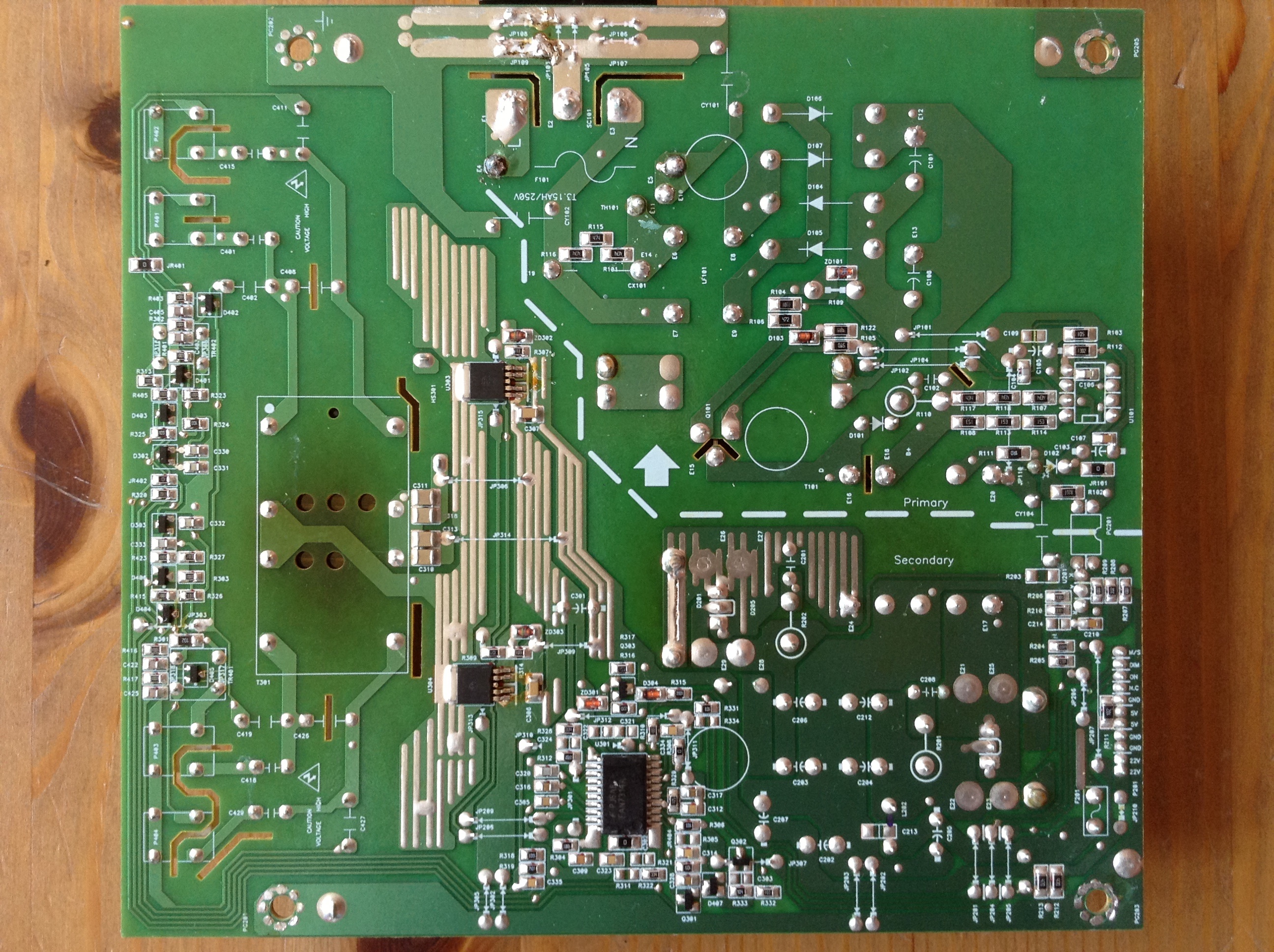

    Hey everyone,
    This looks to be a great forum so I thought I would join and learn a little more.
    I am trying to fix a LG W2442PA-BF monitor. There is no power at all and originally the fuse was blown. I have replaced the fuse and now it stays intact but still no luck with the monitor.
    I have looked around the board the caps look ok.
    I have gone around with a multimeter and can only find AC current. I cannot find any DC voltage on the side of the board that says secondary.
    Now I don't know detailed electronics but the final place I cam find voltage is what I assume is the input legs of a gh-130 transformer.
    Also at the primary side legs of a 817c octo coupler.
    I was wondering if anyone could give me some help on what to test and where? Would like to learn

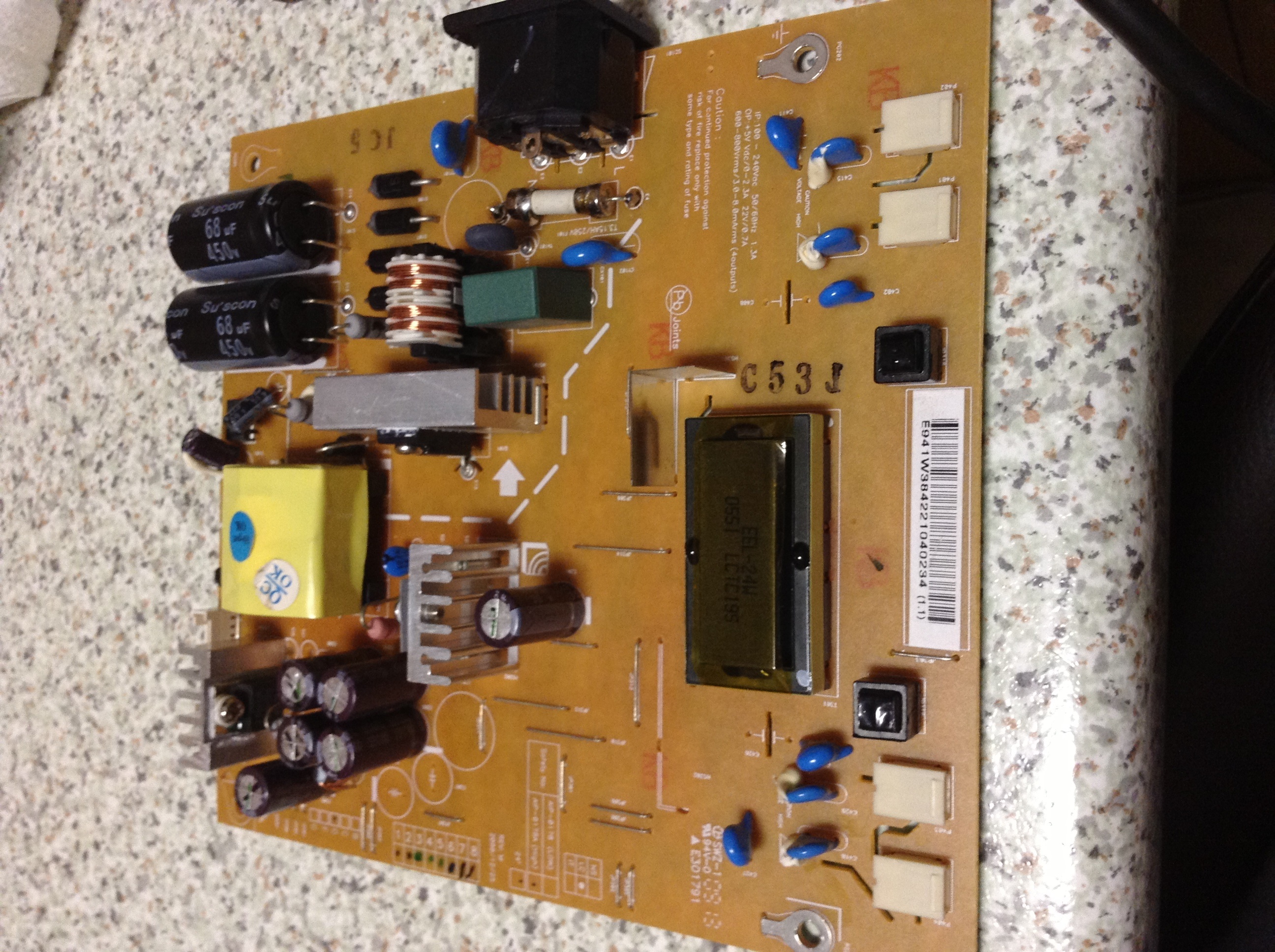

    Re: LG W2442PA-BF wont power on.
    Second pic
      Hi - would have preferred straight on pictures of the boards - we need to be able to read the board numbers. When you measure anything you need to tell us what result you got. Anyway first can you test the voltage on the two 68uf 450v caps.
      CAREFULLY. as this is high voltage. Put your meter on 600vdc and put black probe on
      negative leg and red on positive.

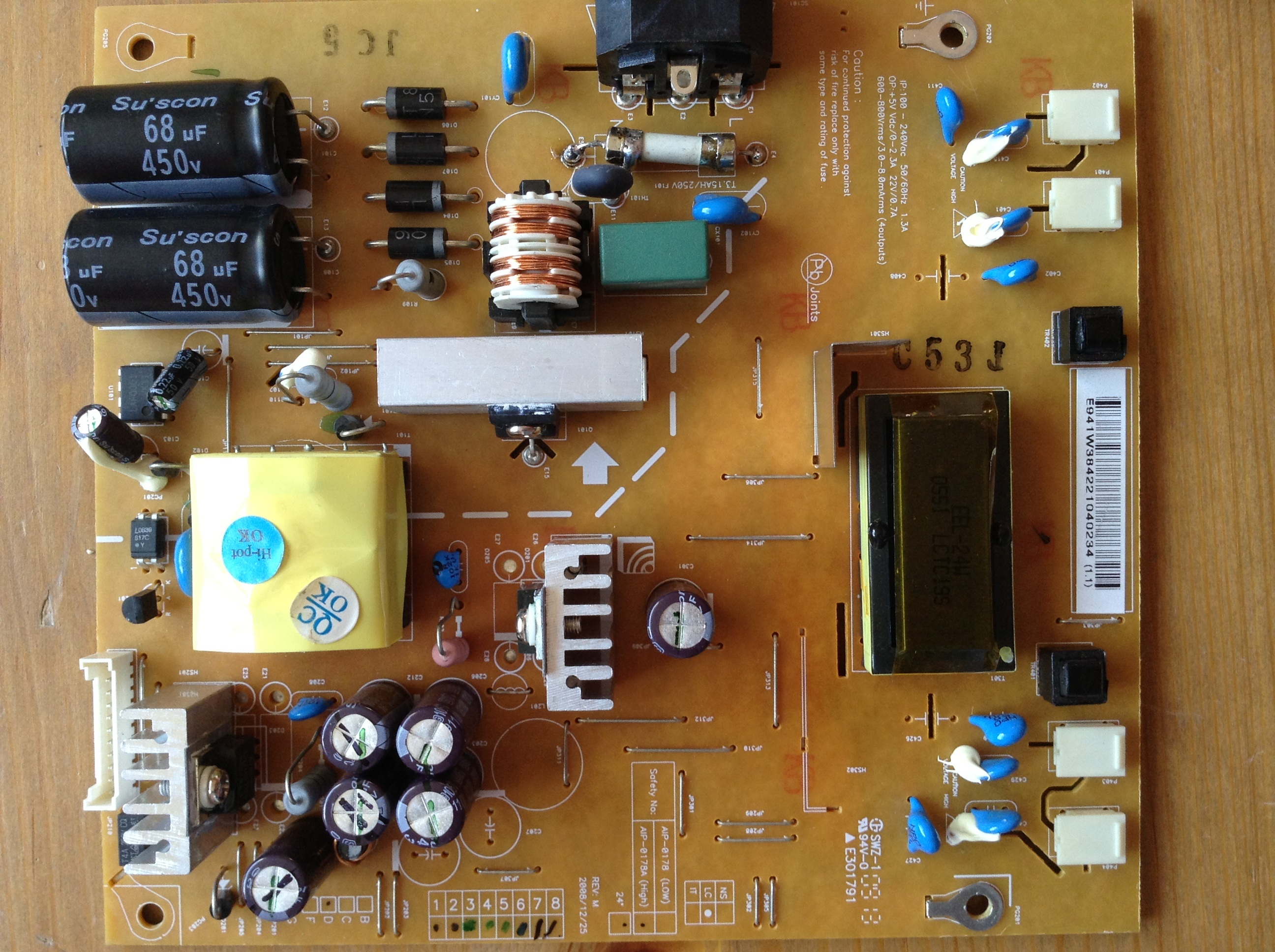

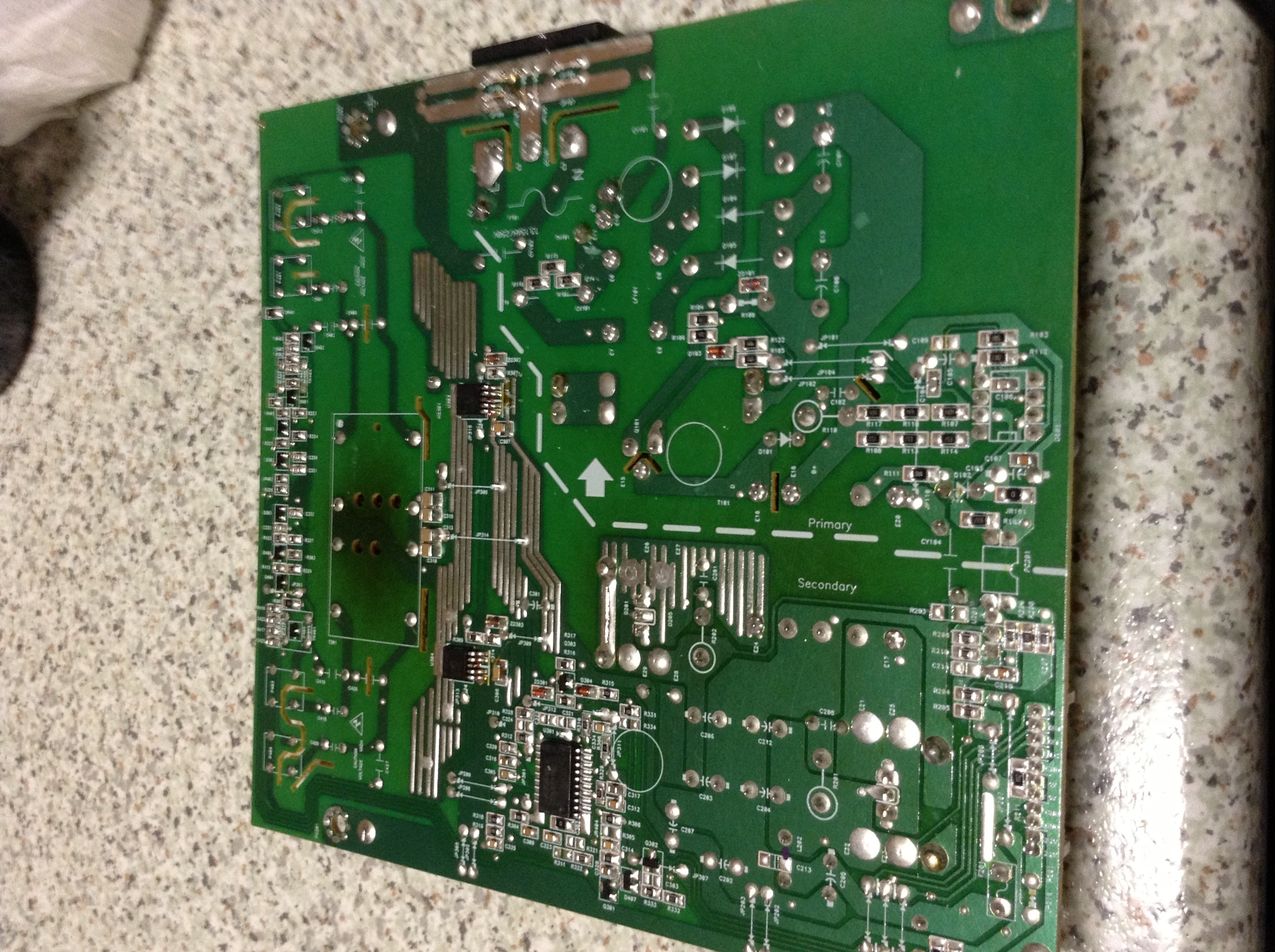

          Better pics, hopefully
            Sorry for some reason won't let me put them on one post.
              Ok both caps are 337vdc.
                Ok Pictures are great voltage on caps is good.
                Not sure about the soldering on the fuse,at some point perhaps you can reflow the joints- add some unleaded solder might help.
                There is a resistor at R109 is it just a mark on it or is it a hole?
                Bottom left corner of the board looking from the top there is a black rectangular component - has T4A on it - this is another fuse. You can test it ( Resistance test first with power off) on the bottom of the board.
                As a starter for things to test this is good - start at post19
                    T4a is fine.
                    The resistor does appear to have damaged casing. Not a complete hole though.
                    It's reading 18m ohms one way and -3.5m ohms the other. The reading also climbs as I stay on it.
