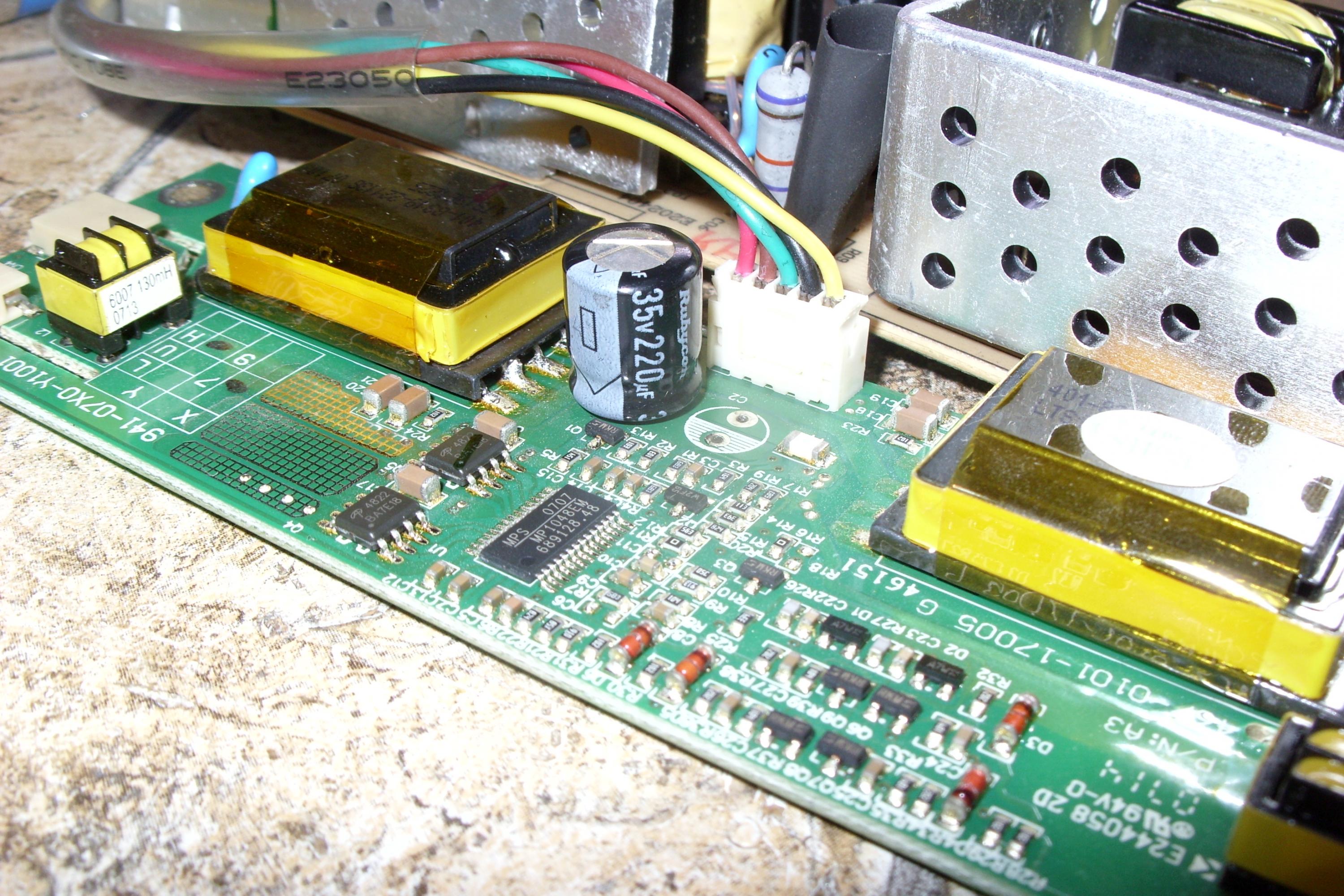

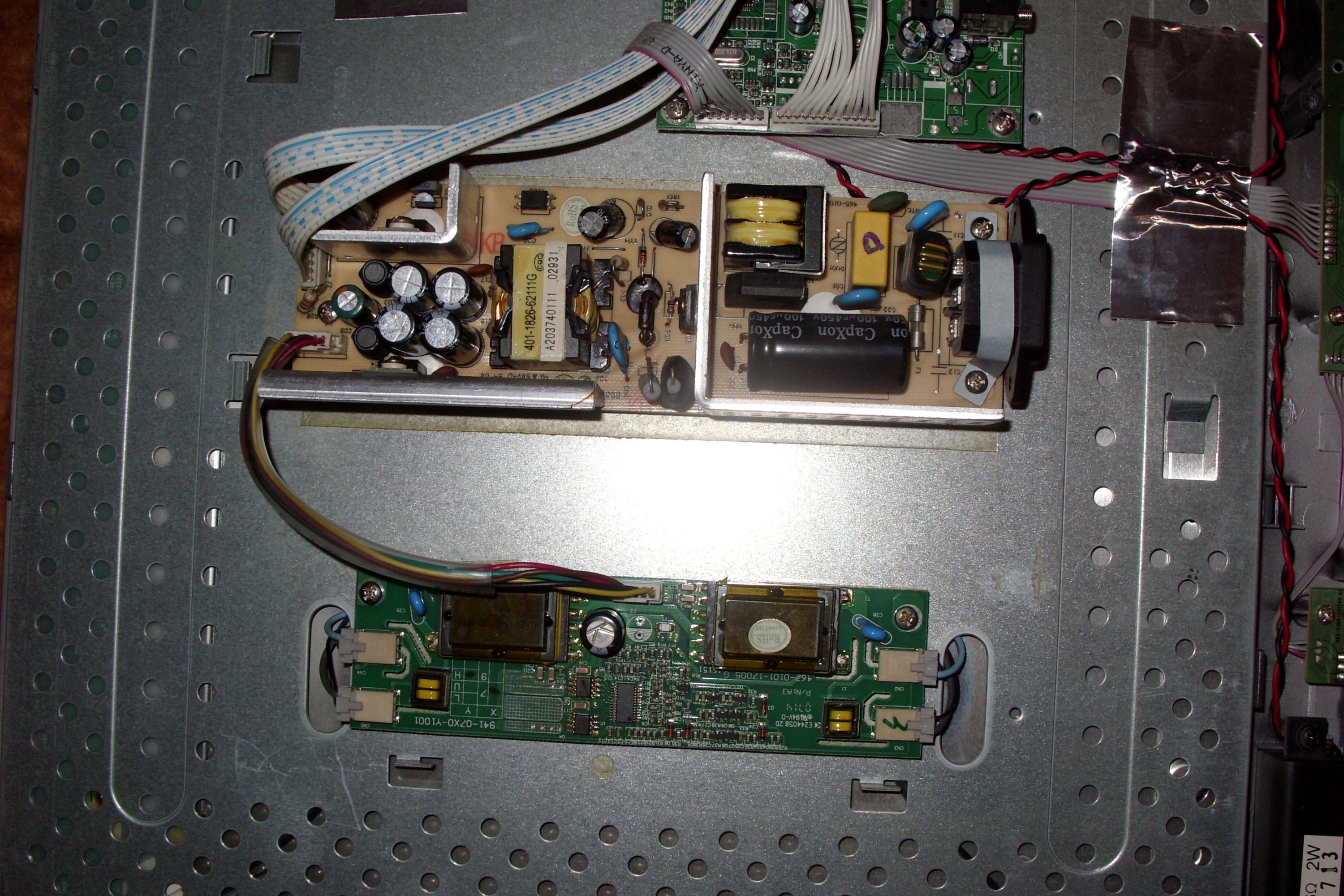

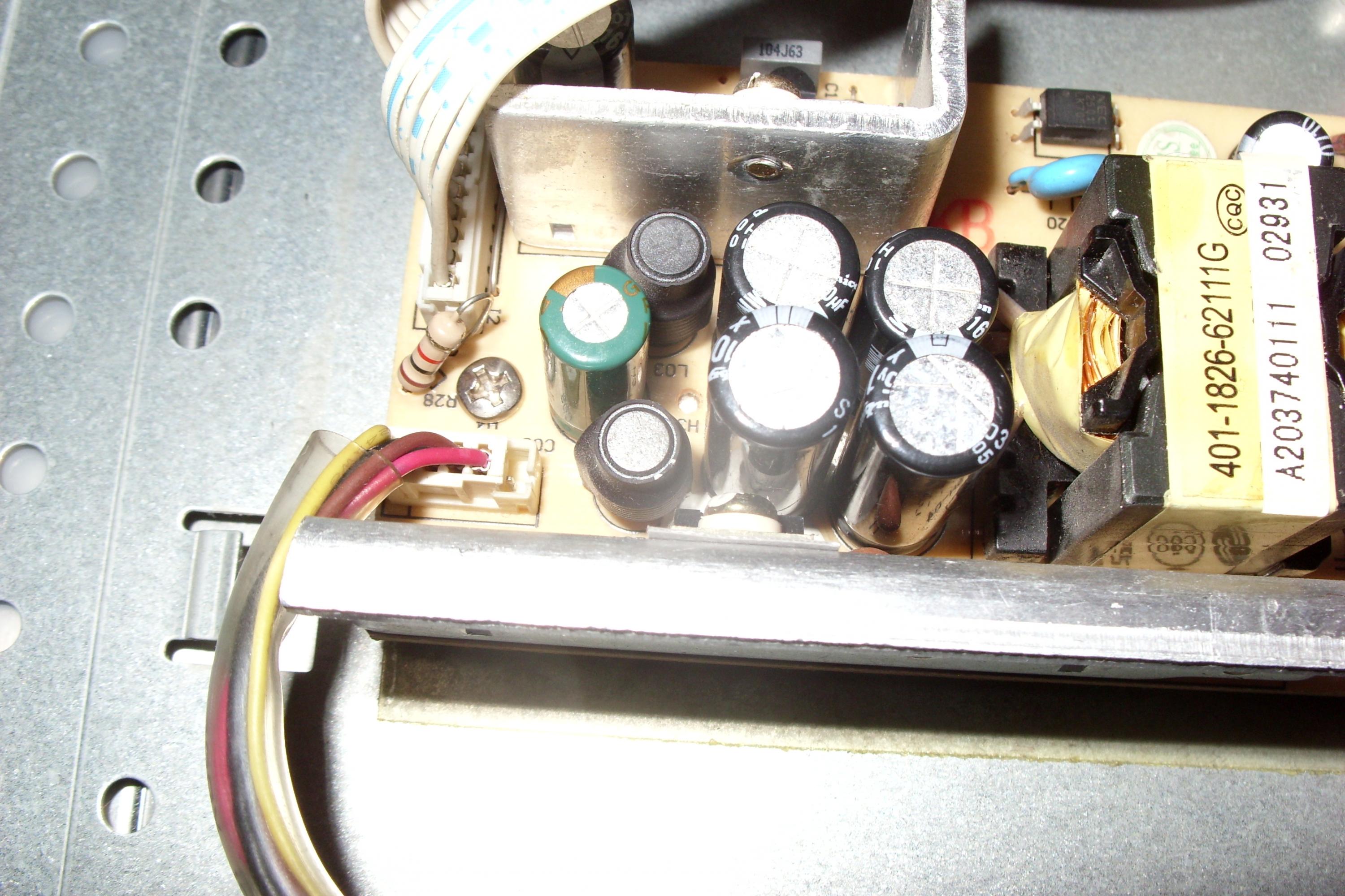

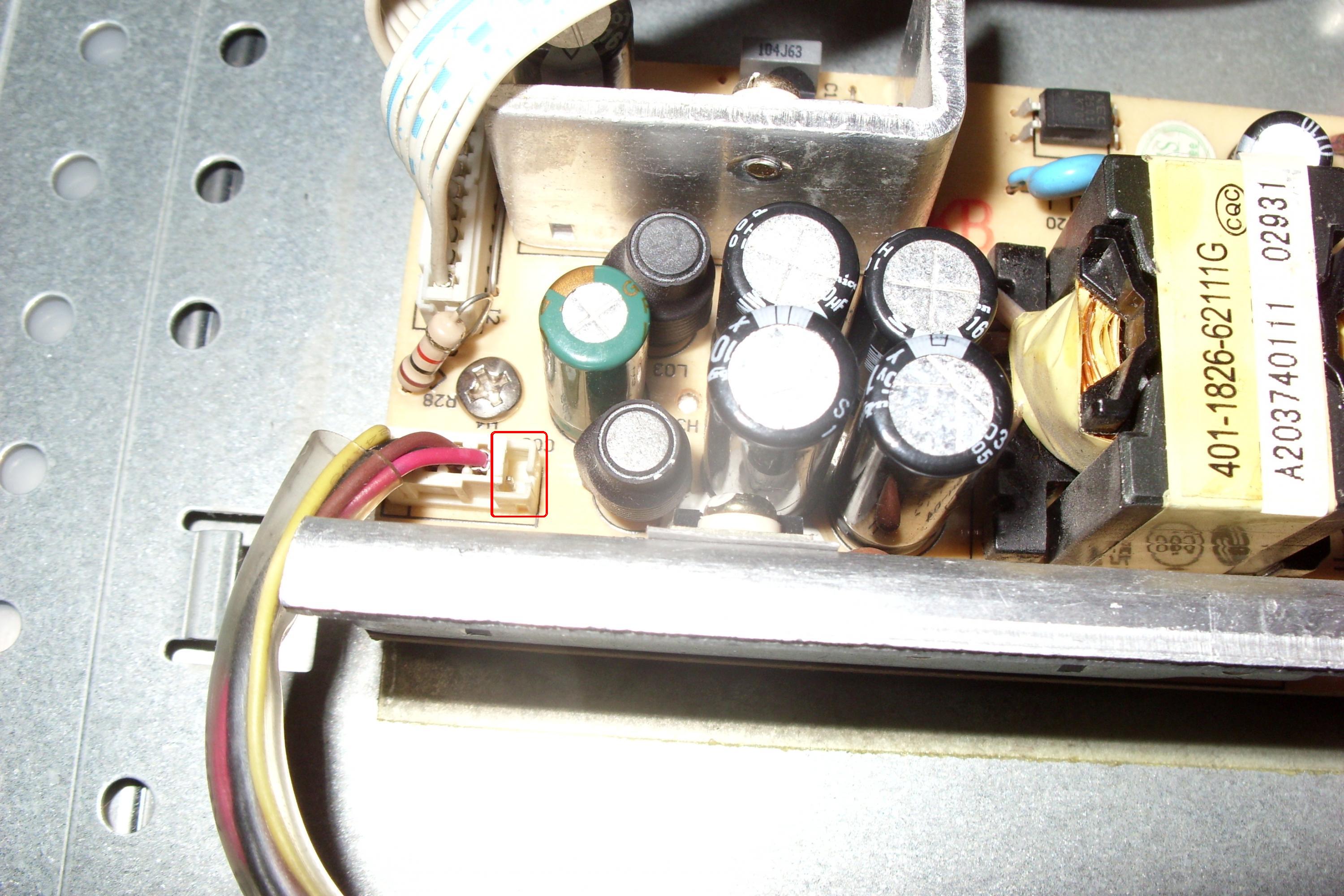

    Had this one brought in today by someone who saw my ad on a local computer forum. He said he hasn't used it for about an year, because it took 20-30 minutes to turn on. I instantly knew what that meant... yup, bad caps.
    Sharp eyes will also notice something funky about the power supply connector where the inverter plugs in, but i'll let you spot it.

    It appears to be 1 pin short of a full load
      Mmmmyup. And as you probably guessed, i got it wrong first time round.

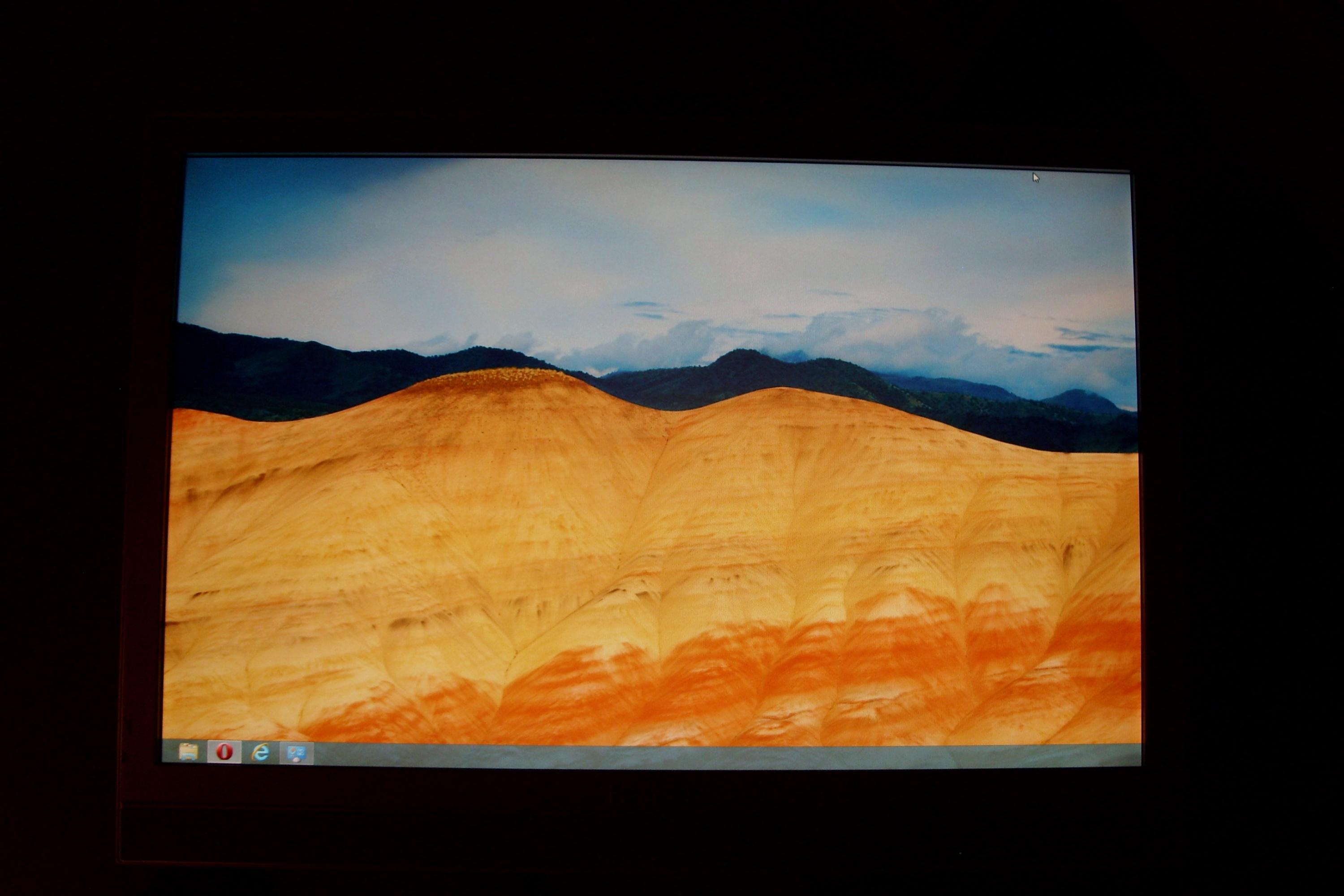

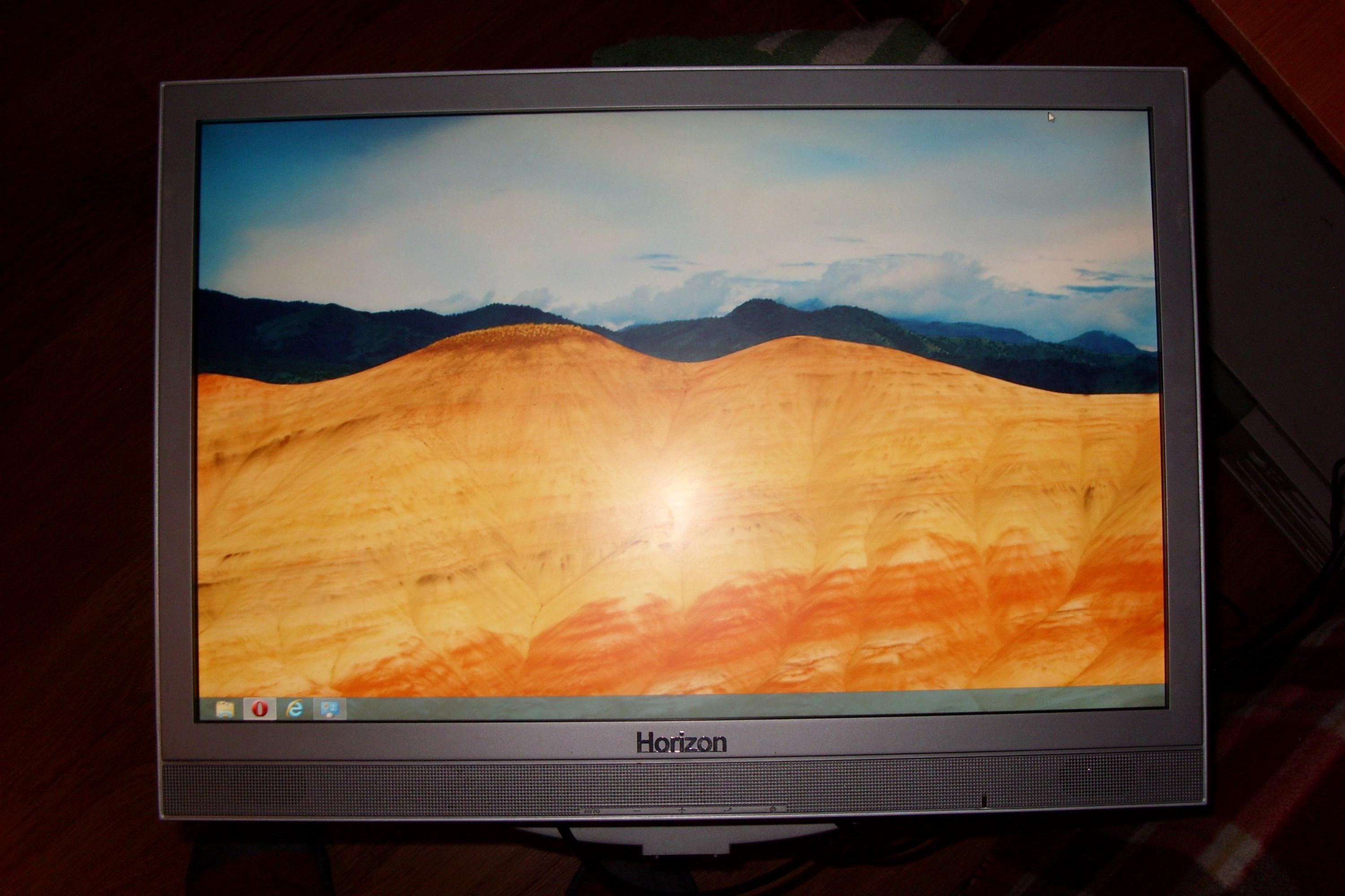

      I got lucky tho - the configuration of the connector is so that the BL_ON got wired to one of the power supply rails but that was all. The inverter wouldn't turn off (full white screen when the panel was supposed to be "off"), but fortunately there was no smoke. Moving the connector to the other position restored 100% normal operation. Phew. Customer picked it up today.

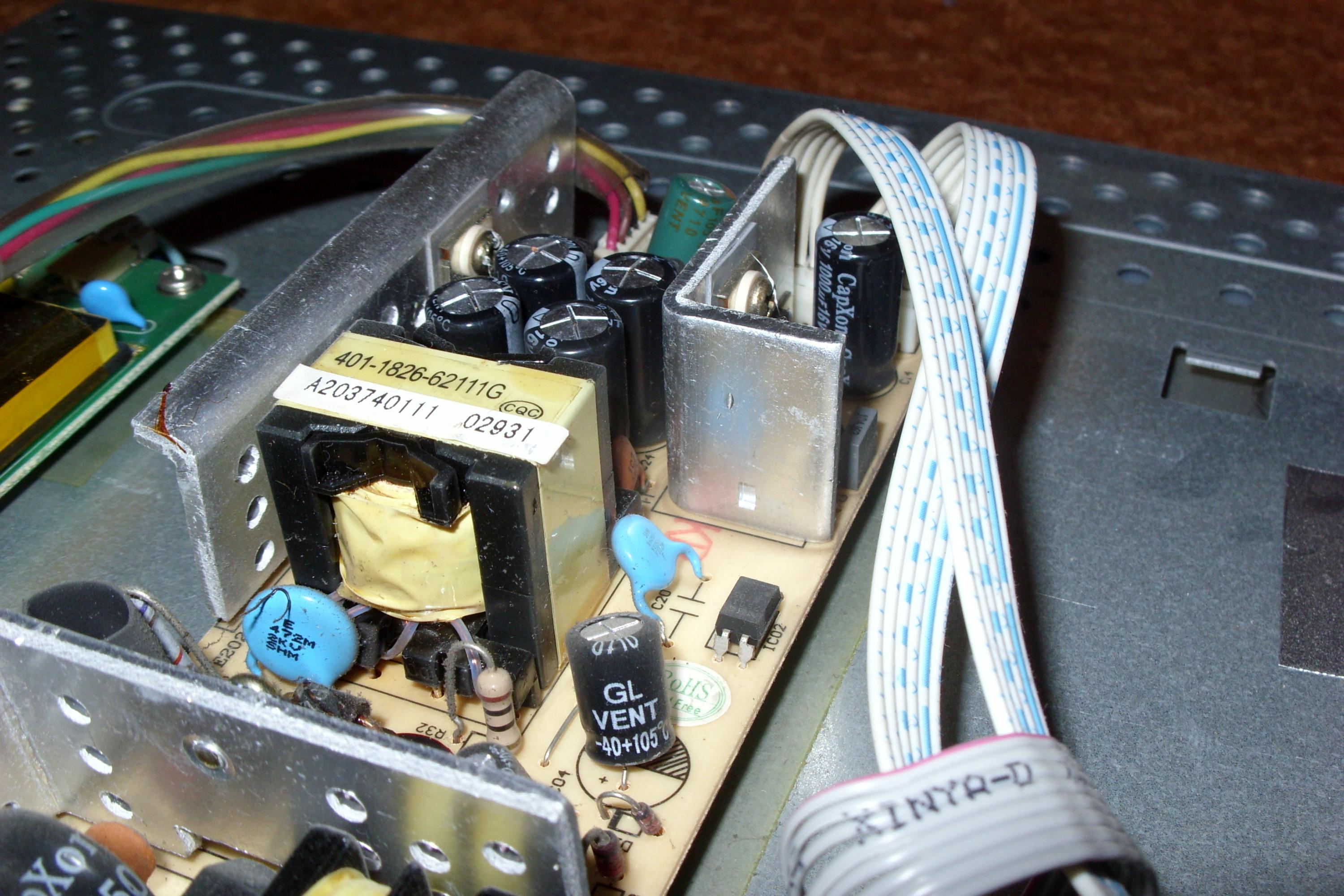

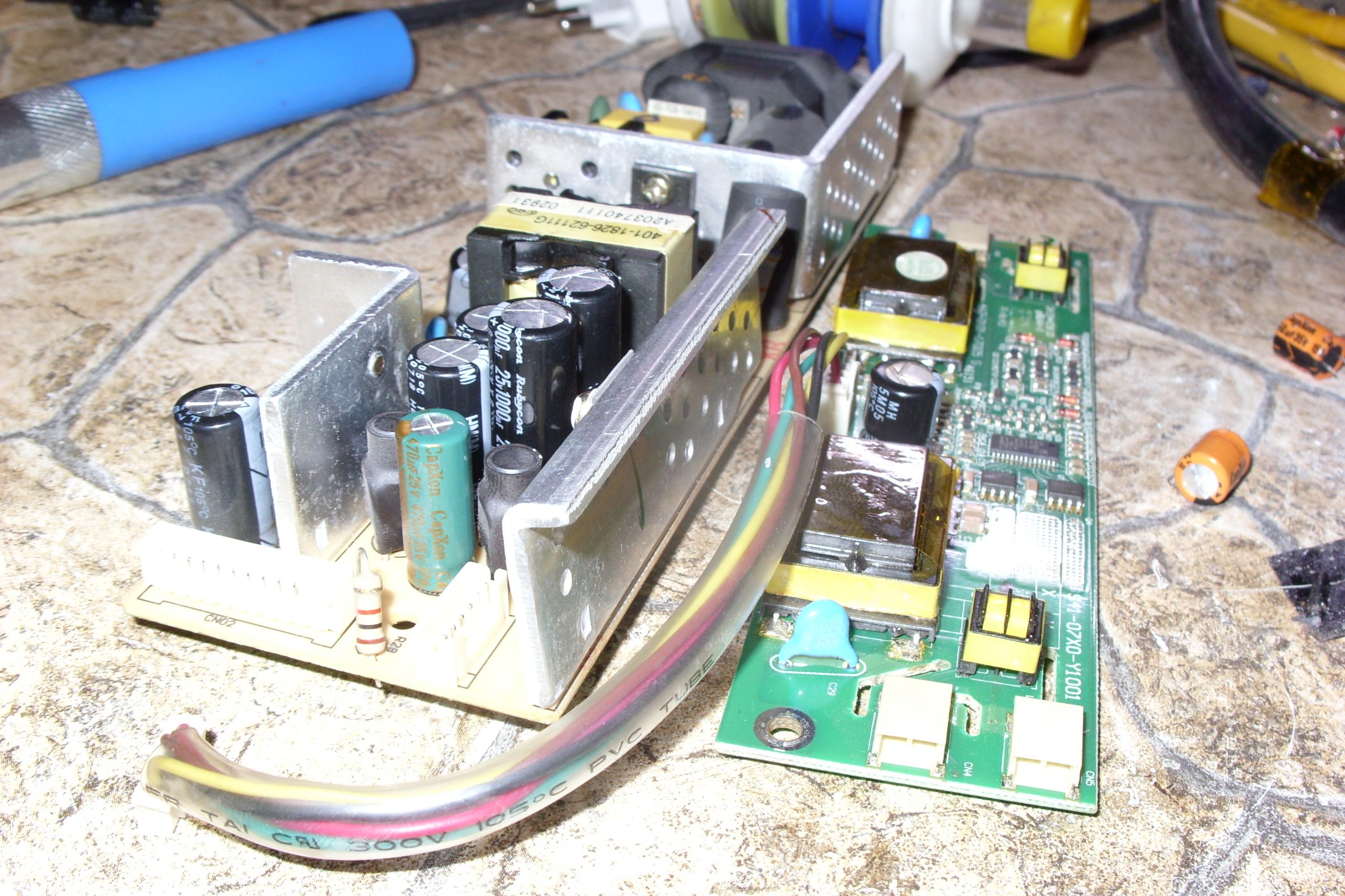

        To the OP. I have the same monitor with the same problem. What exactly do I have to replace? (it takes ab 1-2 min to turn on and it's getting worse)
          Re: Horizon 2206SW repair

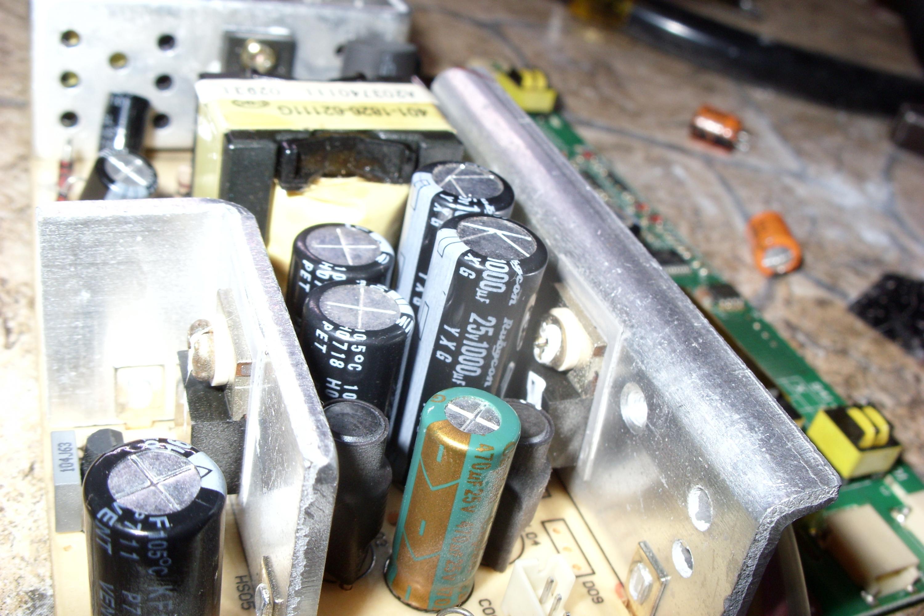

          You have to replace the capacitors on the secondary of the power supply. The side where the 3 ribbon cables plug in. The 16v and 25v ones.

            Done. Thanks! All I had to do was to take it apart. Man, what was there, it was a massacre!

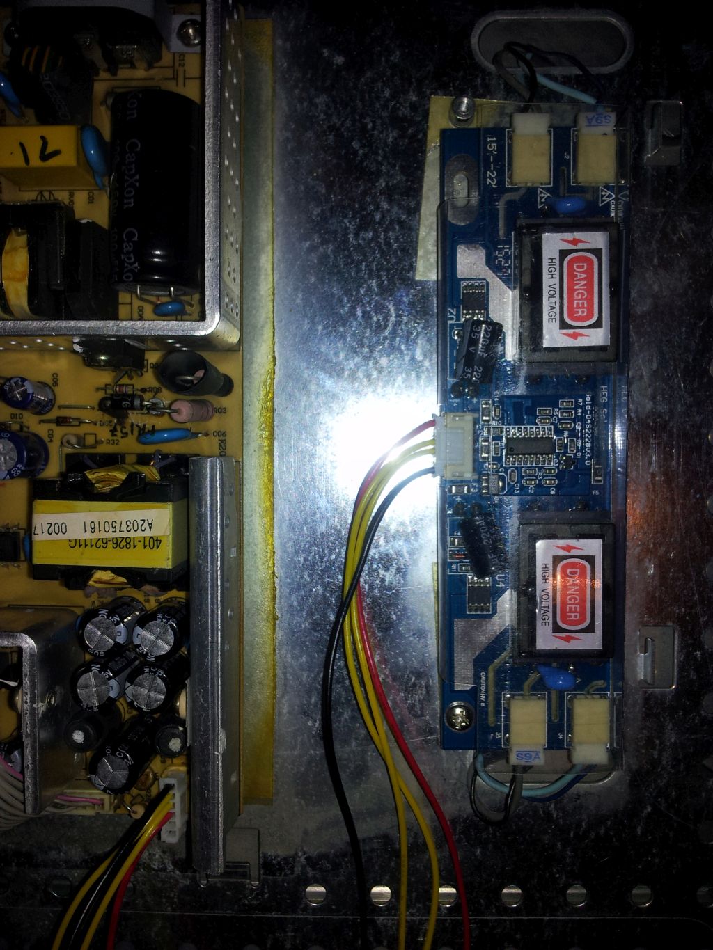

              I just replace the inverter but something goes wrong because i have on/off command only on VGA without ajdustments , DVI doesn`t receive the command to turn on CCFLs . The picture shows the connections .
                The inverter doesnt receive the on command from DVI , only from VGA with no posibility to adjust luminosity - it goes in off protection after 60% .
                  On the new inverveter are marked the connections : 1,2 +Vcc , 3 on/off , 4 adjust , 5,6 GND .
