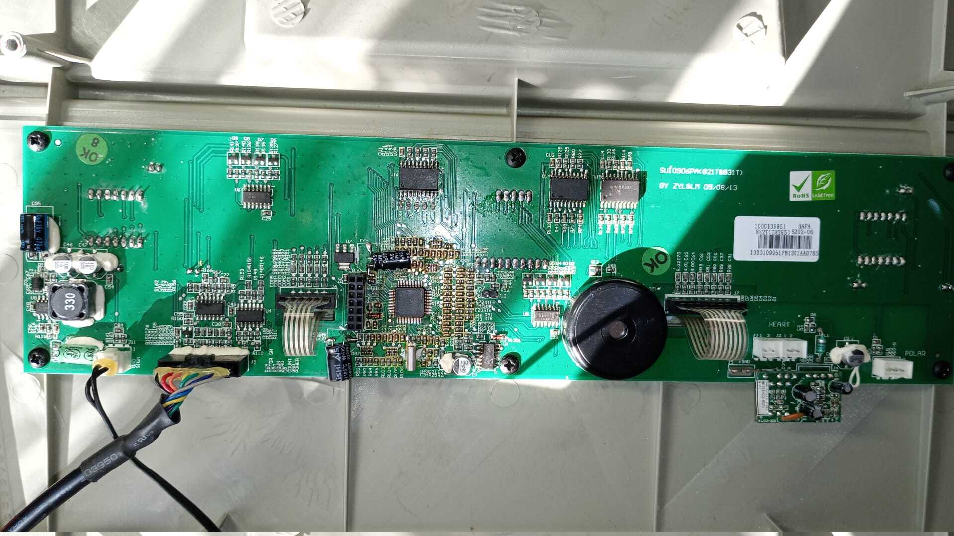

    Hi, trademil Horizon freeze after start like video, i try reset (3sek push stop), remove and I put new ones capaticors 3,3V line digital and analog line.
    The device in service mode passes all tests, except for the display test, where it hangs. The display in service mode during engine testing, etc. seems to behave correctly, it shows values, the engine is working, I can adjust its speed but only in service mode, in normal operation after pressing start the machine freezes
    All the multiplexers that support the display seem to be working. It's like the processor is frozen, I've unsoldered everything from the display, but the treadmill still locks up after starting, there are no beeps in response to using the buttons after pressing "start".
    In the video, after freezing, the display shows "0" but each time the freeze occurs with different display content which looks random but is probably a part of the display multiplexing.
    Any sensible suggestions are welcome. I've run out of ideas.

    corrupt software?
    • warsztat
      • Feb 2017
      • 190
      • Polska
      One possible cause of the failure.
      There is probably a connector for this on the board, but obtaining the software is probably not possible.
