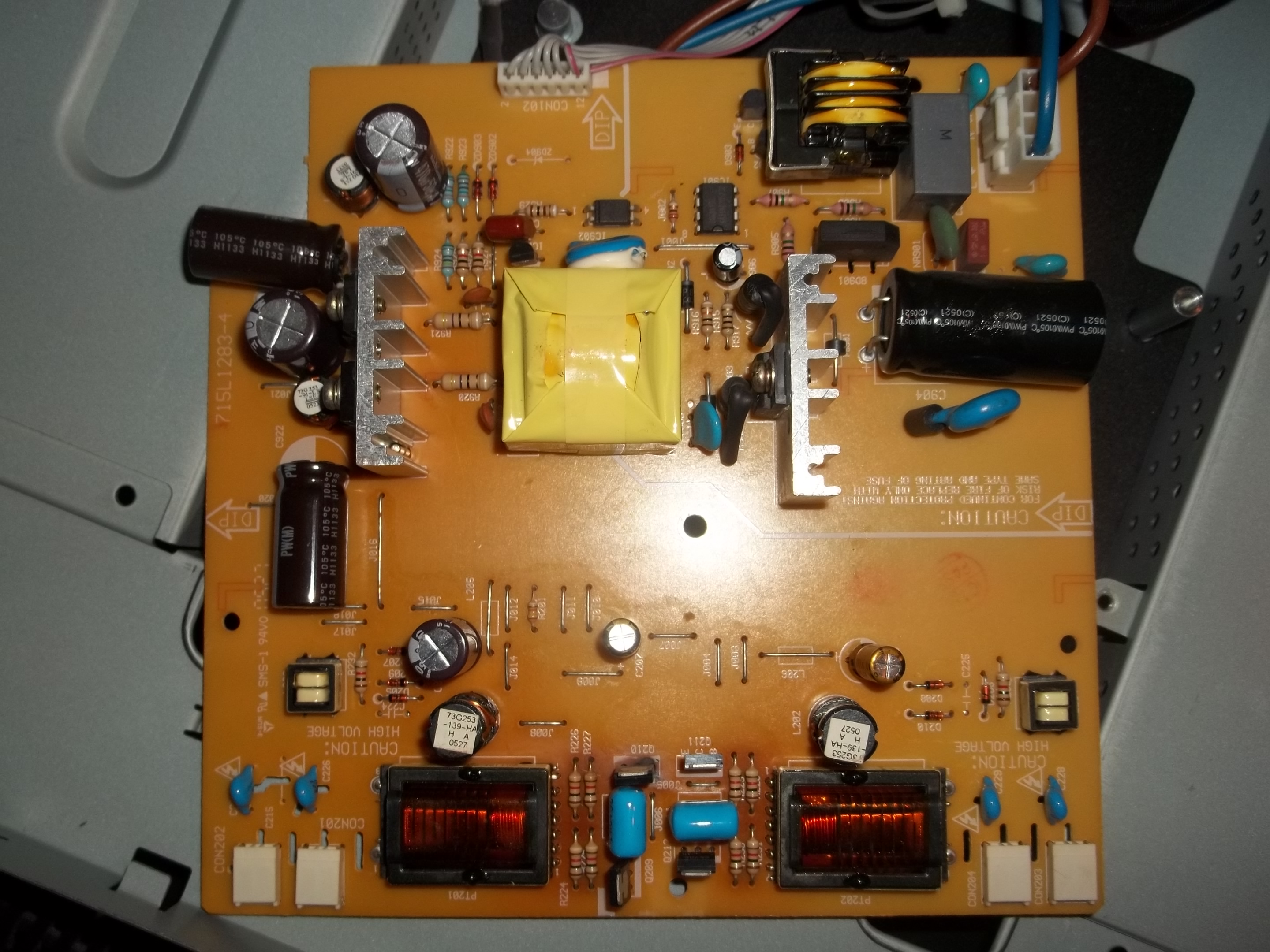

    When I opened it up, it was obvious what was wrong: the mosfets were blown open. Charred. Replaced them, and then it worked! Well, the backlight works. It has a white picture, with pinkish lines on the sides.

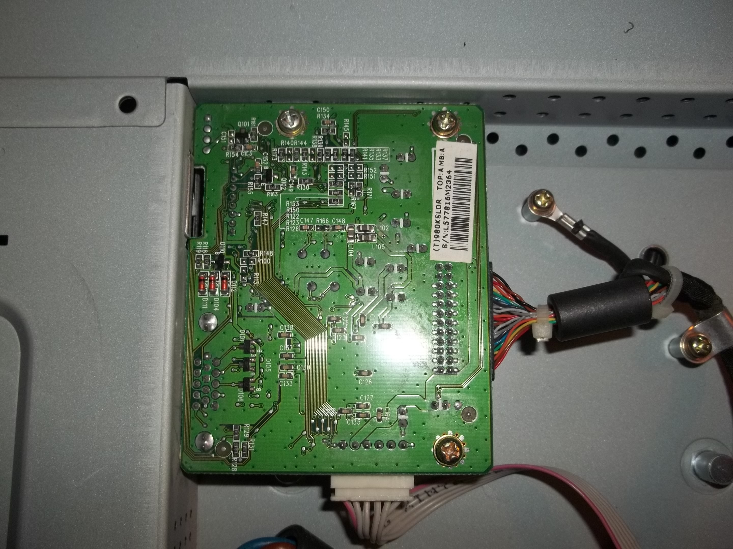

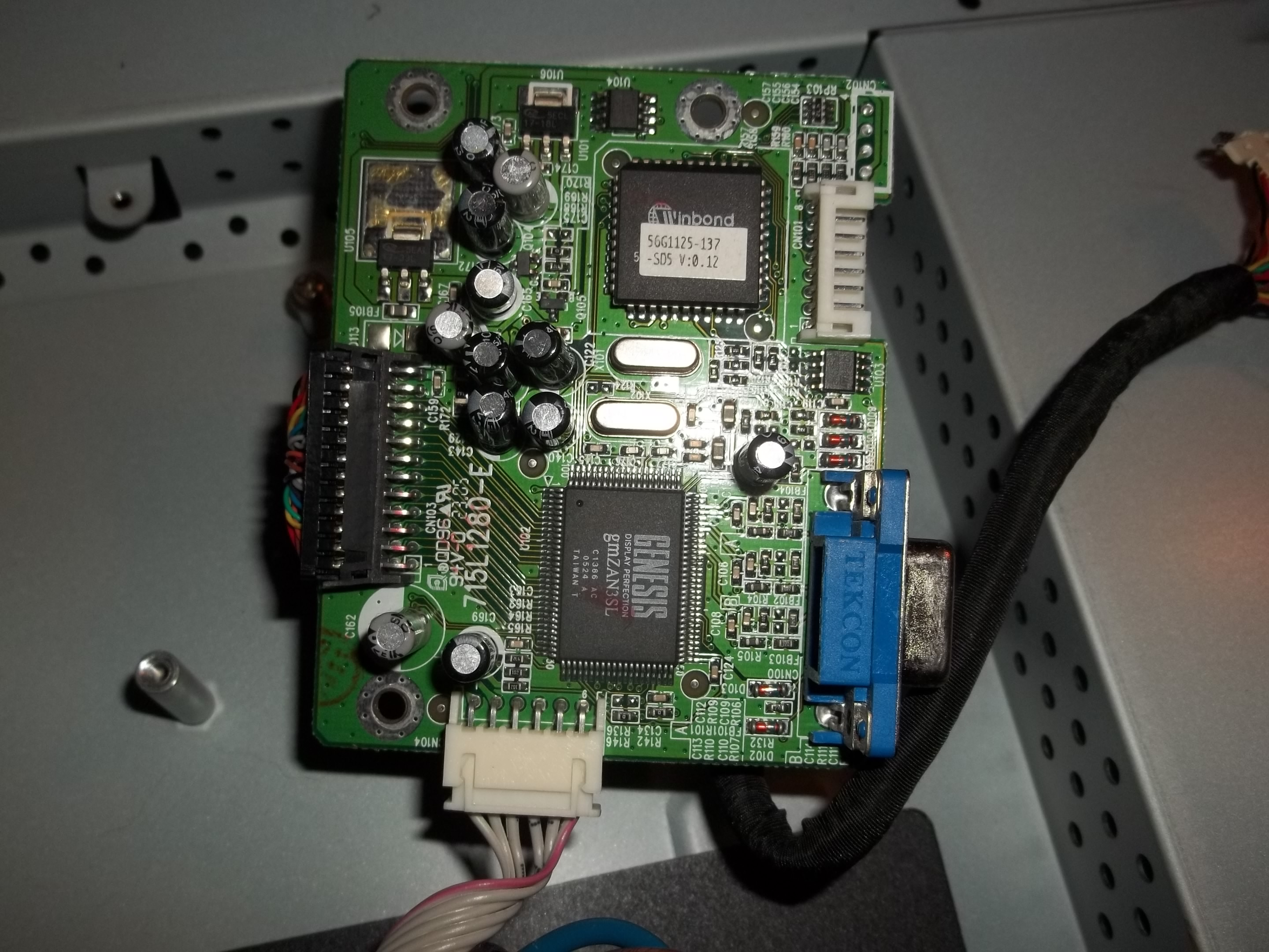

    And, here are the photos.
    Something tells me that this is either the logic board, or a poor connection to the LCD panel.
      Re: Dell E193FPc
      It sounds like the T-con on the LCD panel assembly may not be getting either 5 or 12V from the logic board, check the fuse and the voltage on the LCD panel.

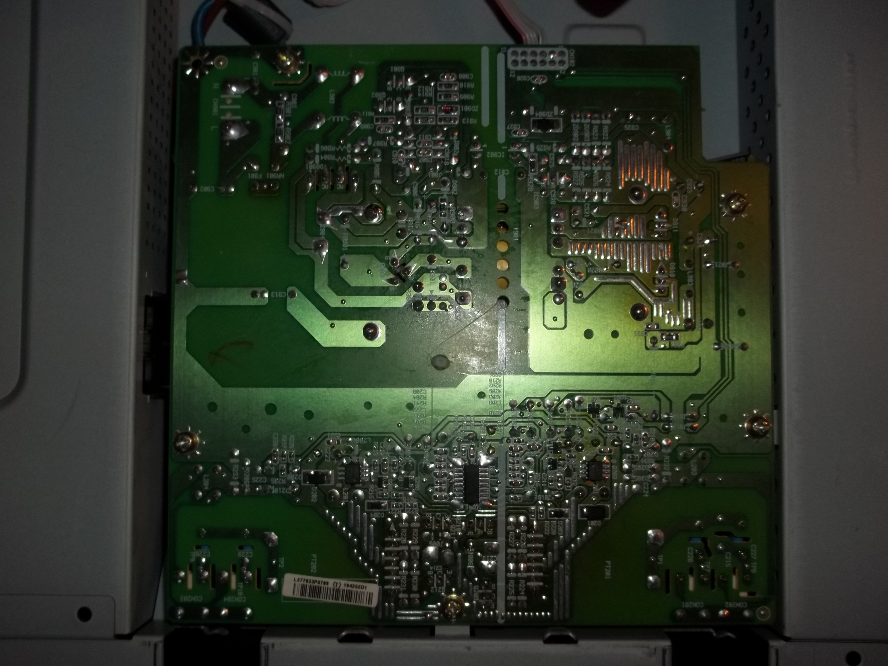

          Transistor Q210 on the power board between the two inverter transformers looks like it shorted out.
          Disregard, I see that you already replaced them.
            Re: Dell E193FPc
            Yup! Although I'm curious how you noted that - the board isn't browned or blackened there, that I can see.
            edit: never mind - it's quite obvious, in the photo.

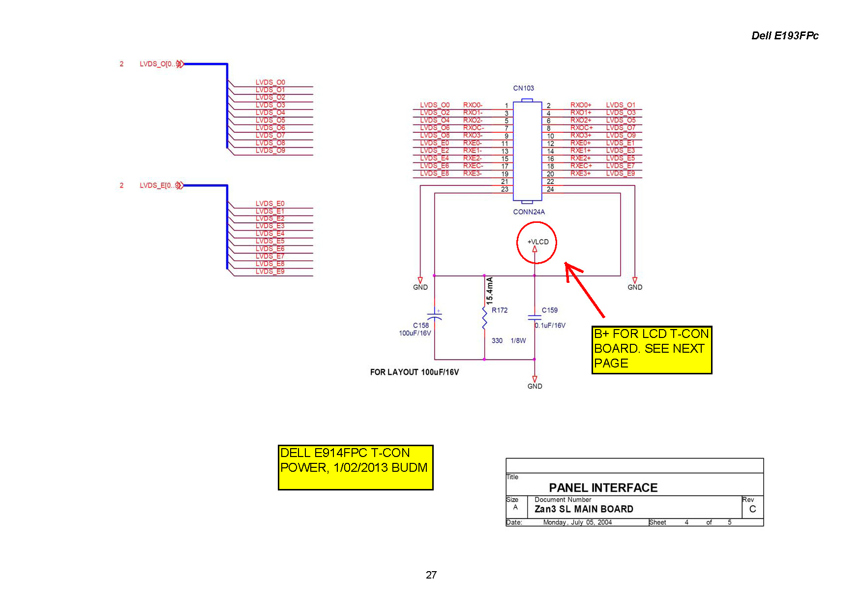

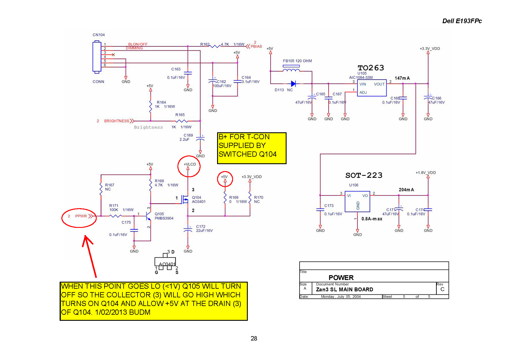

                        Diagram of the main board if it matches yours. I expect 5V as well. There is a switched transistor that supply the voltage to the T-CON.
                          Re: Dell E193FPc
                          I'm having trouble trying to follow that. On page 27 I can find the connector (CN103) but I don't see the transistor you mention on that schematic.
                          As a guess, when looking at the board, itself, there's U105.
                          edit: found U105 on page 28, but it just has traces going to nowhere. I can see that it outputs both 3.3 and 5...
                          I'll power it up and see what it puts out. When I use the diode function of my meter to test it, it reads every which way. Perhaps it's because it's in circuit...or, perhaps it's bad.

                                Re: Dell E193FPc

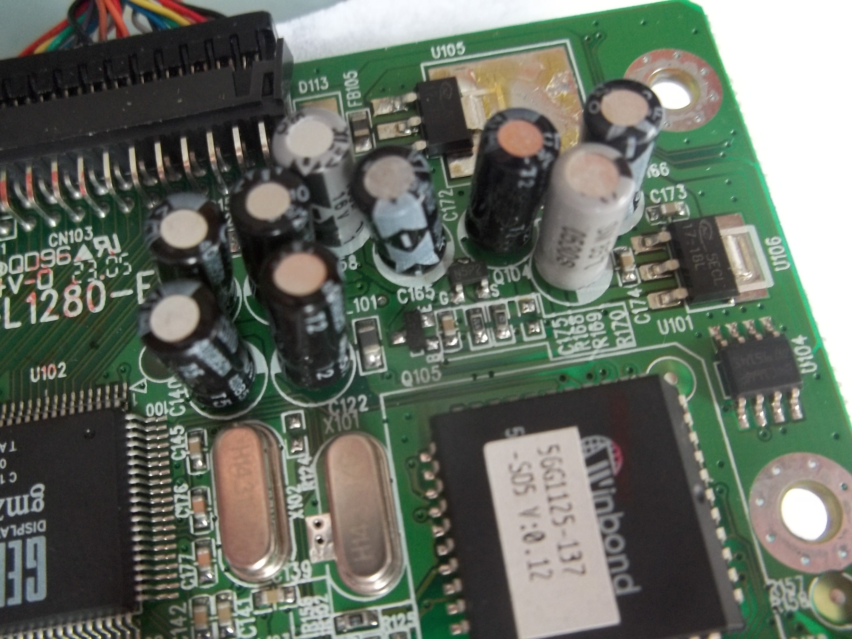

                                Tested the voltages coming off of Q104, here are my results.
                                I don't know which pin relates to B/C/E, so I included this photo to illustrate what I'm looking at.
                                Top pin - 5.06V.
                                Left pin - 0.08V
                                Right pin - 5.06V.
                                Does that mean that the 5V is being interrupted somewhere upline?

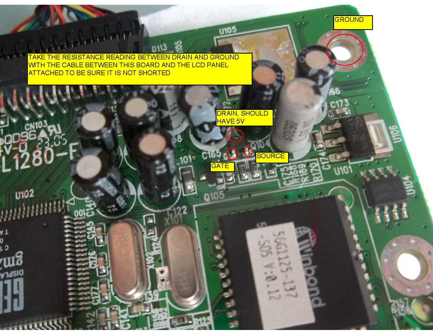

                                  Re: Dell E193FPc
                                  It is MOSFET which has S, D, and G.
                                  S should have 5VDC, G = ~5VDC, D (the top tab) = 5vdc
                                  Also take the resistance reading between the D and the fuse on the T-CON board to make sure that it is less than 1 OHM.
                                  Voltage measurement must be done with the monitor power on and with running PC.

                                      So...
                                      Source = 5.06V
                                      Gate = .08V
                                      Drain = 5.06V
                                      That's without the LCD panel attached. Working on that, now...
                                        Re: Dell E193FPc
                                        It's reading in the MEGA Ohms. Red lead to Drain, black lead on the fuse on the TCON. So, somewhere, I've got a break, correct?
