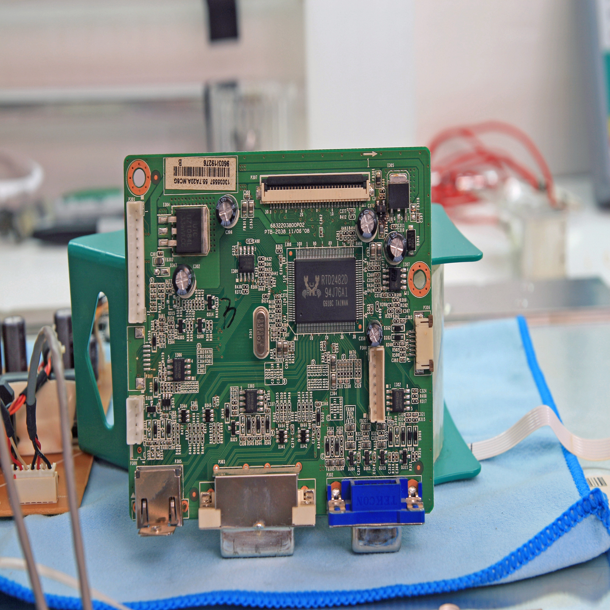

    Hello all
    I acquired an Acer H233H When turned on it has a white screen problem
    checked all caps on power supply all tested good on esr meter I noticed a burned diode, correct me if not a diode I measured resistance I get 10.25 ohms both directions. I also lost all power to screen led button.

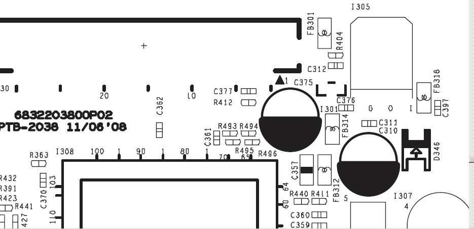

    Can you clean up the damage area with some isopropyl alcohol - you may even be able to read the part number on the burnt item

      I cleaned of with alcohol I see A 14 with a burn mark in middle any Idea what that is

        Re: Acer main board part ID
        Working on it - is it at I304

          Yes I see faintly an I304 under diode

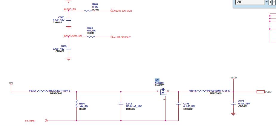

            OK No - I think it is I301
            I searched for the board number.
            The same board is in the G245H.
            See Attached
            Think it is one of these
            http://www.alldatasheet.com/datashee...TC/AO3419.html

              Thanks Selldoor I found it on digikey
              https://cdn.badcaps-static.com/pdfs/...5e3d5c4bc2.pdf
