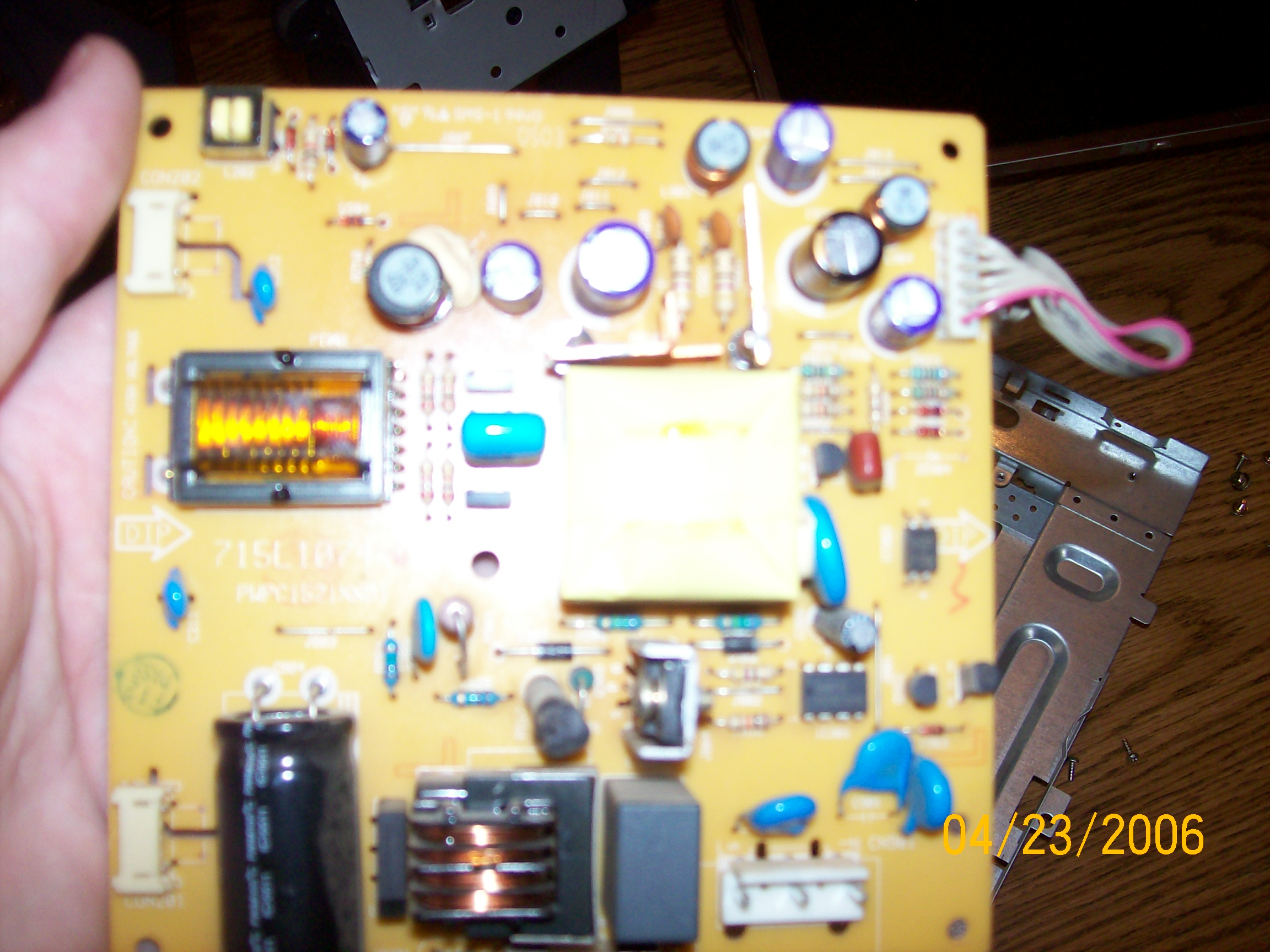

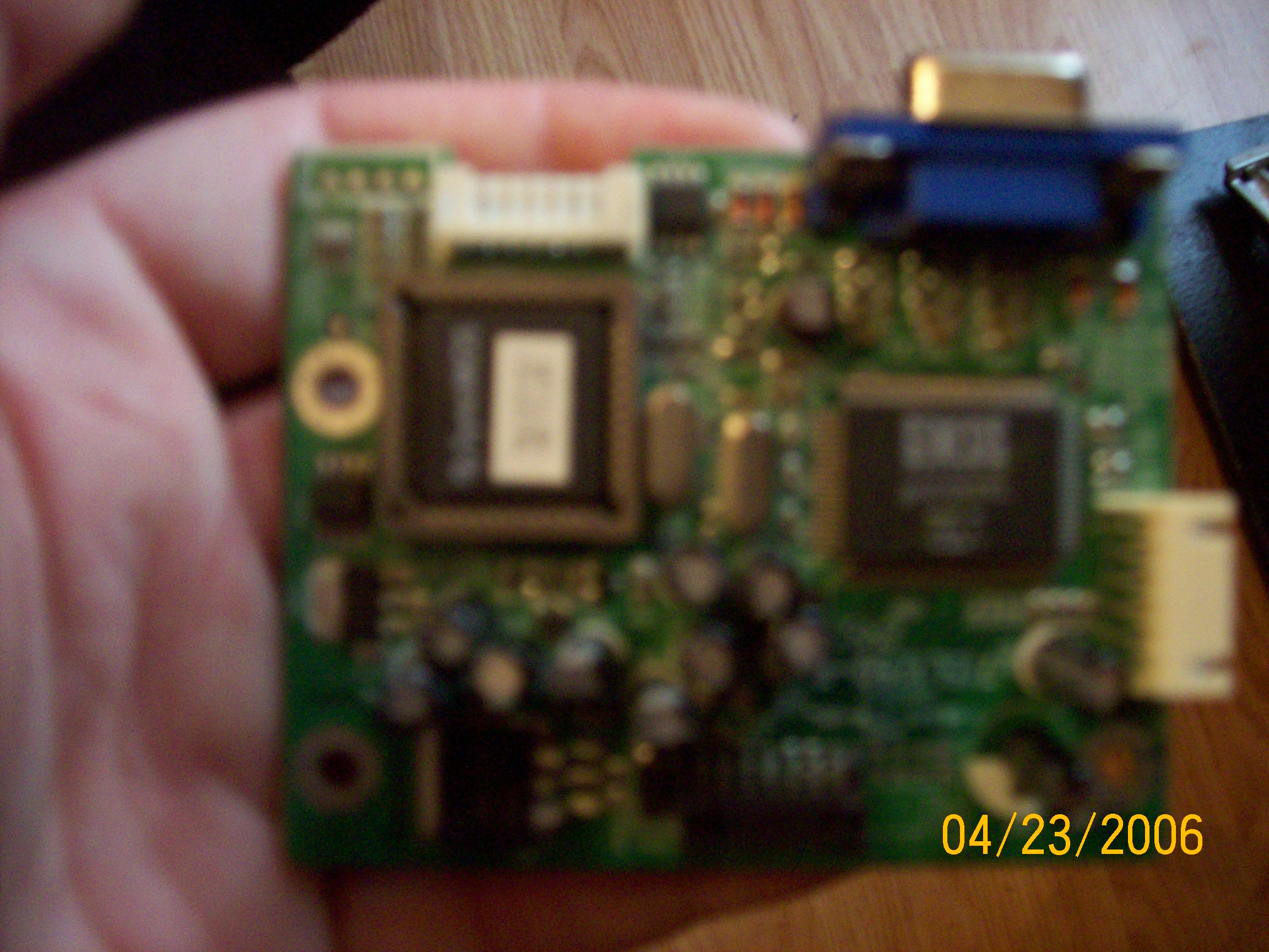

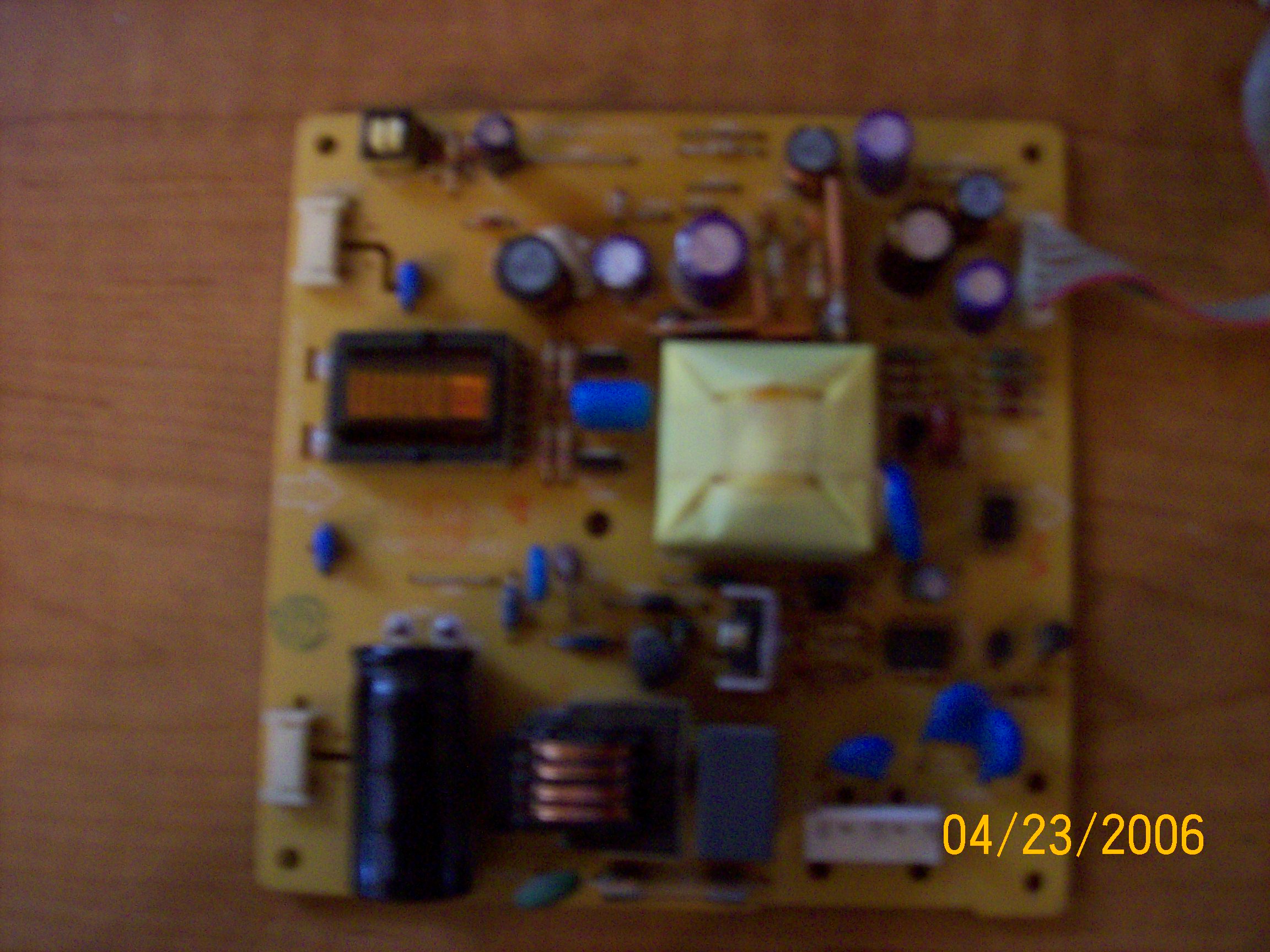

    I have a Dell E153FPc monitor that turns on then goes dim. I have checked the caps and they are not leaking or bulged. Please help!

    Can you please focus your pictures?

      Cant thats all my camera does...

        https://www.badcaps.net/forum/showthread.php?t=24612

            I have the same issue with this exact model. Just changed capacitor C922 and everything went well.
