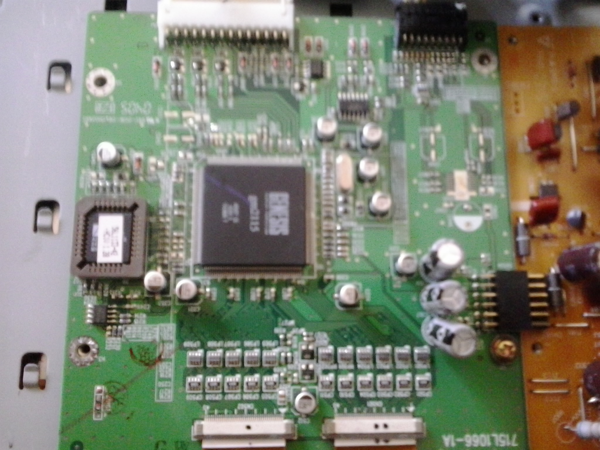

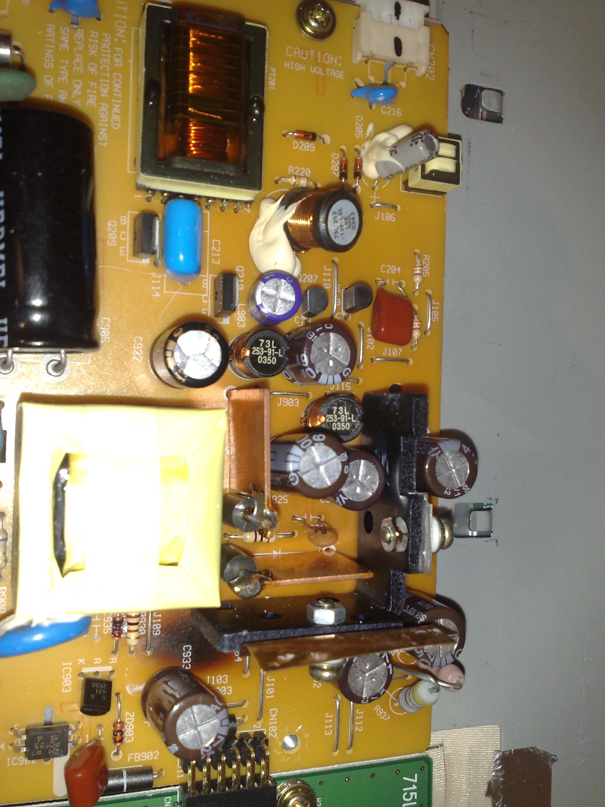

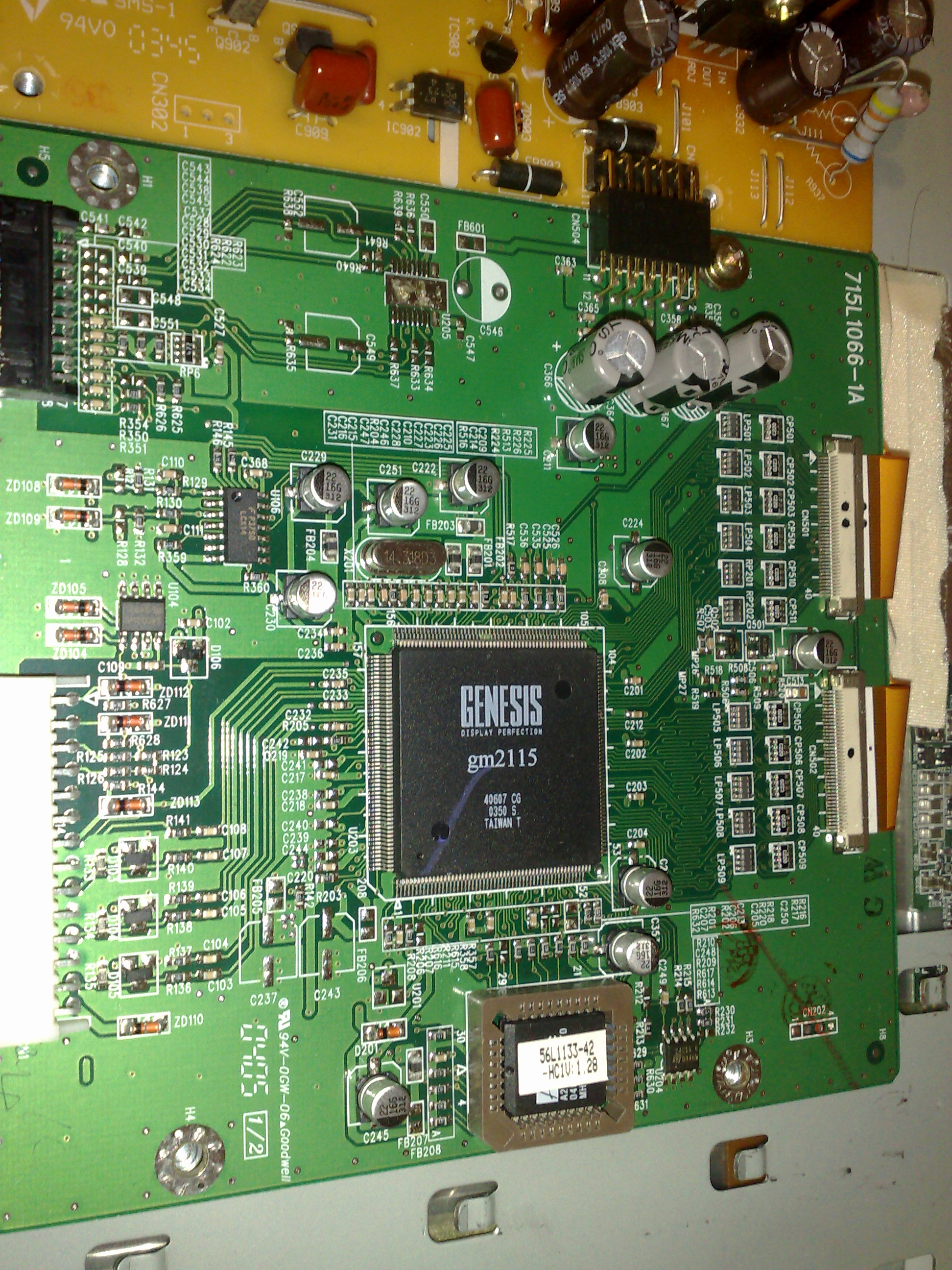

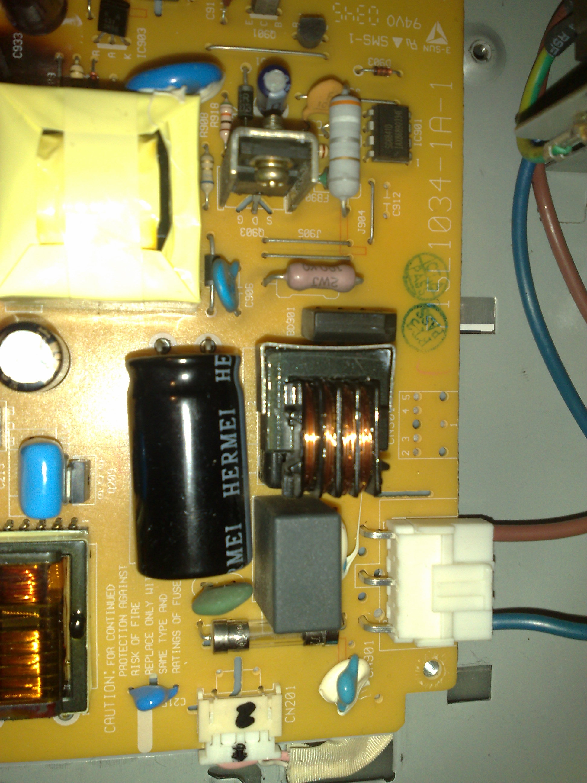

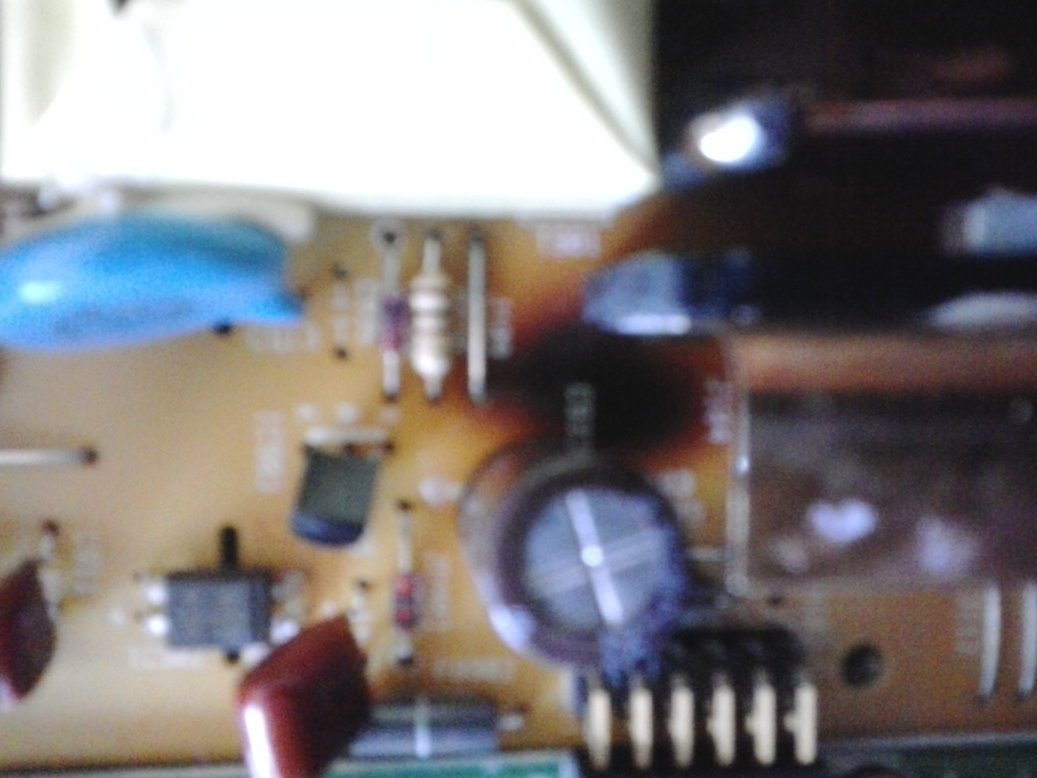

    I have an HP 1502 Monitor which us not working fine. It has a white backlight and flickering screen. I opened it and found out 6 faulty caps: (C924, C925, C926, C929, C930, C932).
    After reading this post: https://www.badcaps.net/forum/showthread.php?t=2658 i still can't sort the problem.
    I also noticed a burnt area on the board near the ZD904.
    Please find attached pictures of the boards for further help.
    Hope that someone can help me.
    Thanks,
    Matthew

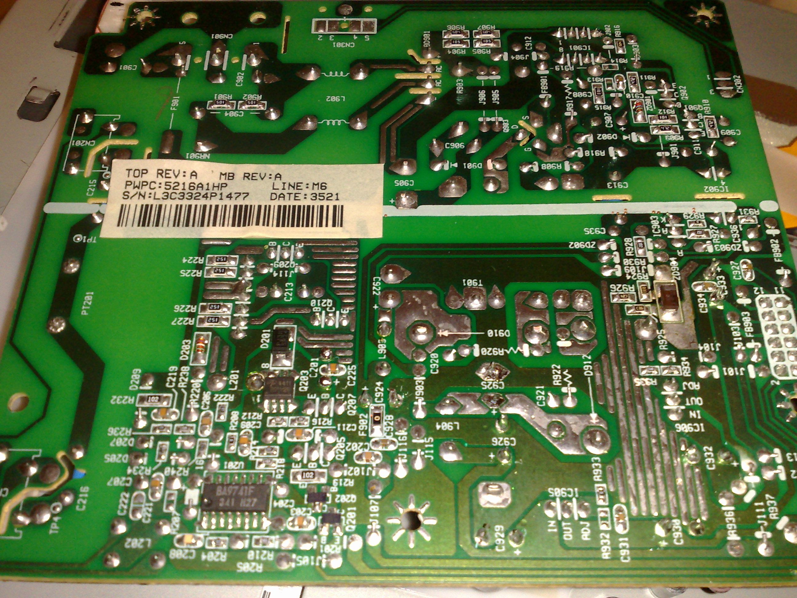

    Need a good,focused photo of the bottom of the Power Board
      Re: Hp 1502
      Can you just confirm that you have three monitors (similar) that you are working on?
      None of the pictures are clear enough for troubleshooting.
      What make series of caps did you use
        Re: Hp 1502

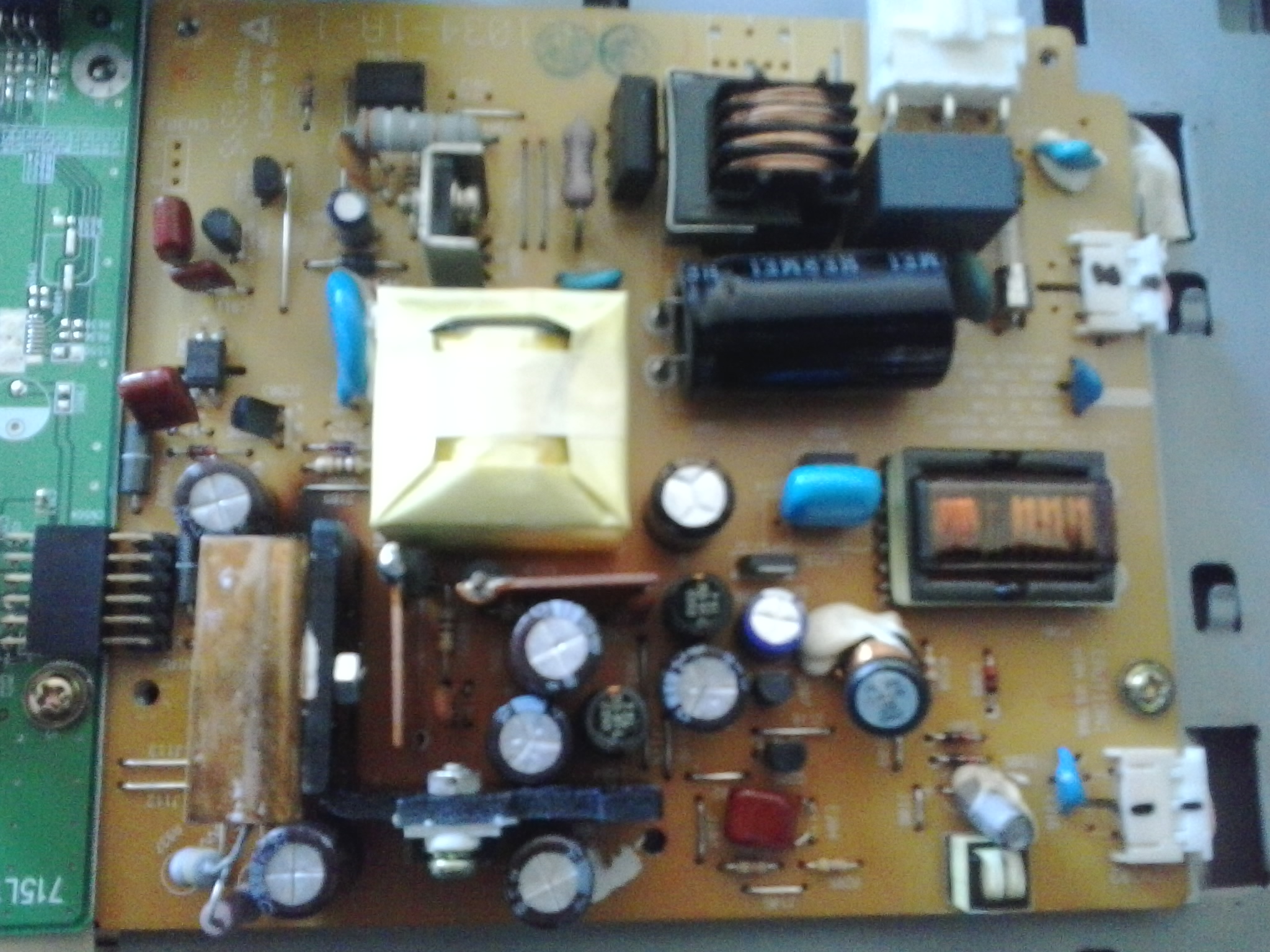

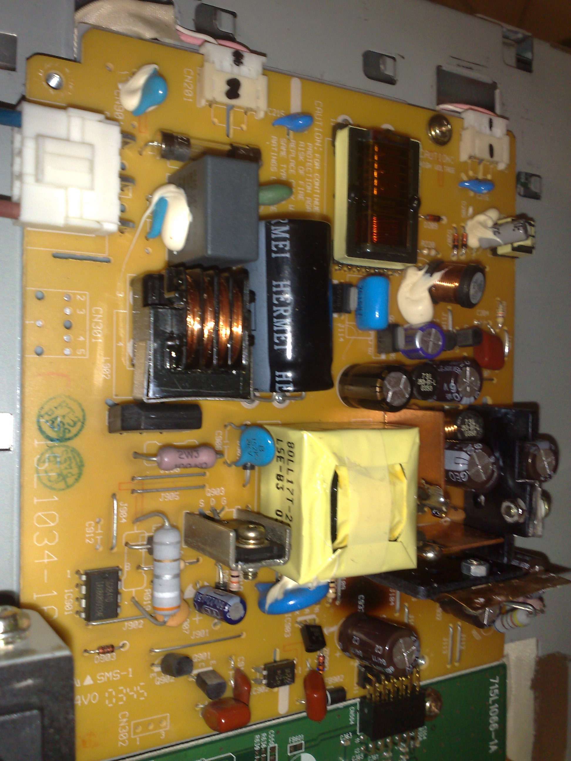

        Yes I confirm that I have three different monitors. Please find attached more pictures, hopefully clearer images. As for the other two monitors, I am going to upload photos on the other threads.
        The Brand of the caps that I am using is: Yageo
          Re: Hp 1502
          I would replace them all, as shown with red marking. They should be low ESR type.
          You are saying the backlights are flickering?
          http://s807.photobucket.com/albums/y.../HP/HP%201502/
          It can be bad lamp assembly also.
          http://s807.photobucket.com/albums/y...klight%20lamp/

            yes the backlights are flickering. The problem is that I can't find to buy one of the caps to be able to replace them all as one of them is 25V 150uF. Can this be replaced with a different one, if yes by which?
              Re: Hp 1502
              You can use 220uF. Mian key is that, they have to be low ESR type.

                        Hmm, try something else. In Pic 4 post4 at the top there are two sockets
                        with pink and white wires.
                        First try and change the plugs over - you may need to turn the board or the panel over to do this or have them stood on end. Move them into position without the power on then switch on as normal ( Sometimes one bulb/transformer is weaker and changing them over is just enough to stop flickering)
                        Next
                        Do either of the other two monitors have the same size plugs.
                        If so, you need to try and manoeuvre them so you can plug it in.
                        Again move without power til connected then switch on.
                        This is a double sort of test and may not work at all - it may come on
                        and flicker which suggests a different problem on the 1502
                        It may light up and stay on which suggests bad bulb or wiring on the
                        1502. AND proves that the lamps in the donor monitor are good.
                        OR it may not come on at all which suggests the bulbs or their wires in the donor monitor are bad
                        Hope this makes sense but just come back and ask if it doesnt. I know what I mean ( I think) but its not easy to convey
