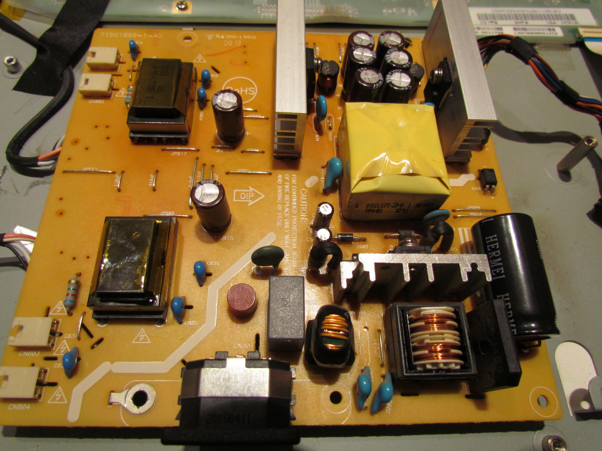

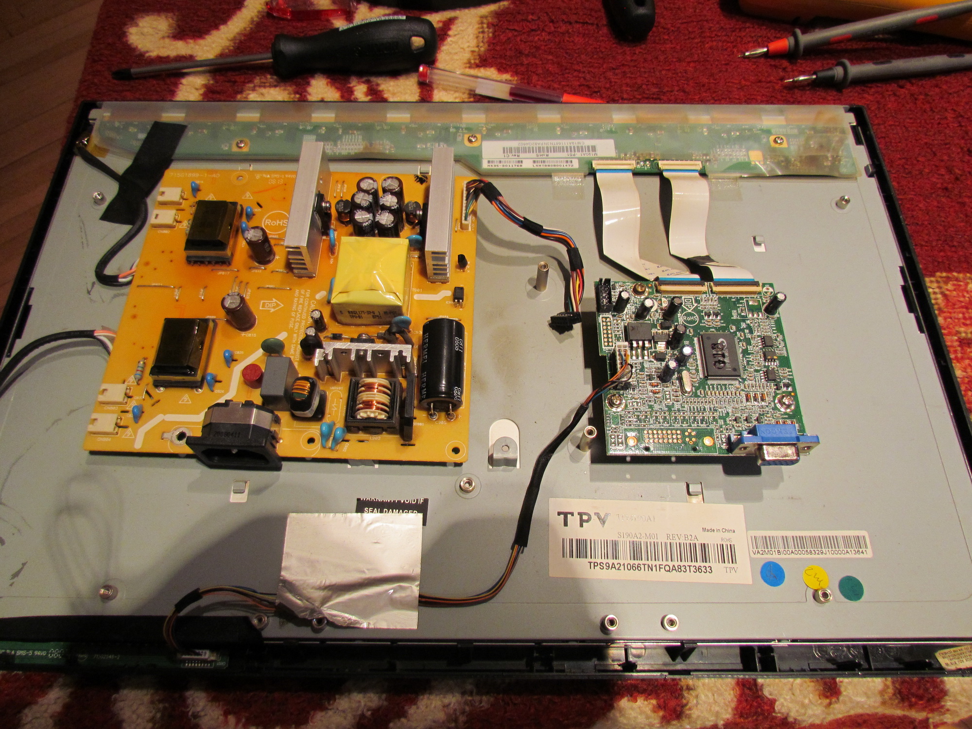

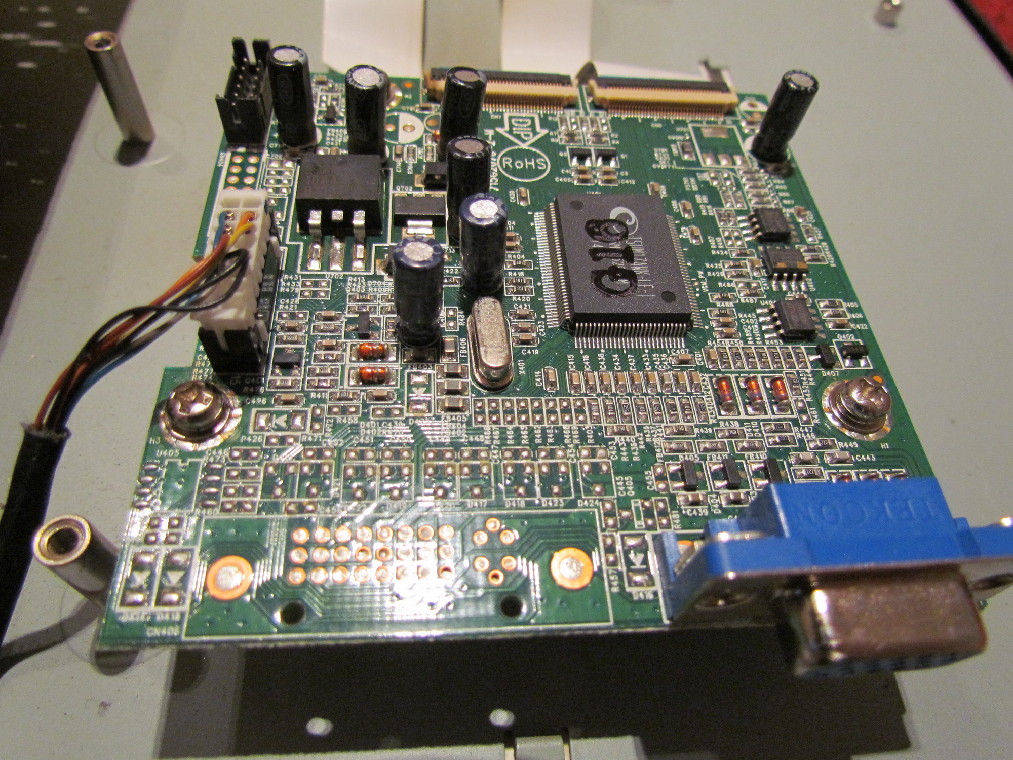

    I have this Asus monitor and "2 seconds to black" problem.
    Help please!
    What is your opinion?
    I'm not very good at this, but I did some tests.
    I checked mosfet, diodes, transistors and I didn't found any short circuit or bad diode.
    Also I removed all caps and I checked their capacity with multimeter Fluke 179. All of them has good values, except big one. It has 92 mikroF out of nominal 100.
    Caps are Hermei and Elite.
    Voltages on CN902 are:
    12V - 13.79
    12V - 13.79
    5V - 5.19
    5V - 5.19
    NC - 0
    dim - 3.78-4.78
    on/off - 2.95
    Voltage on big capacitor is 308 V.
    Voltages on mosfet are:
    gd=306
    gs=0.36
    sd=310-315 unstable

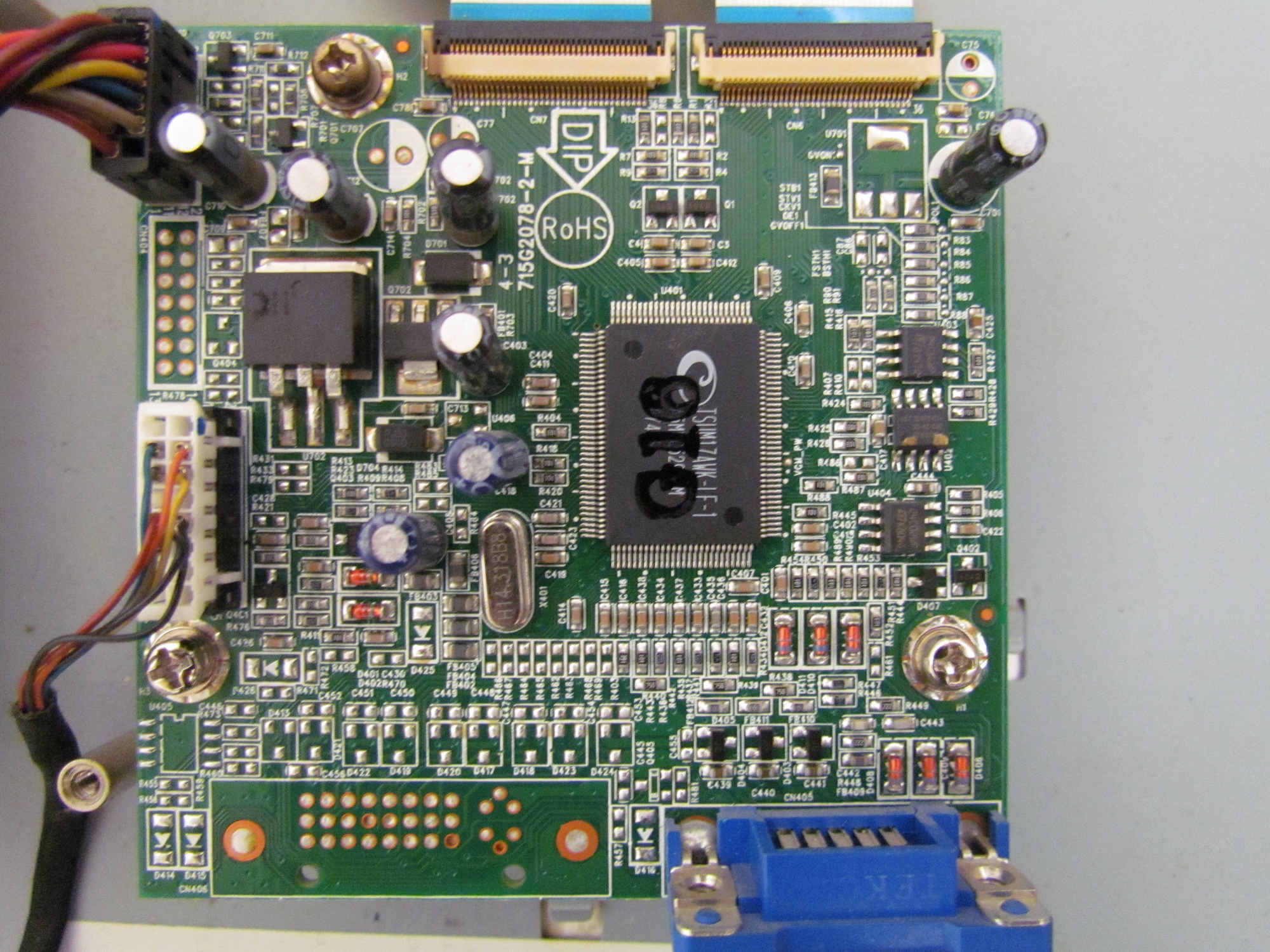

    Voltage regulator (1084-33) on main board has this measurements:
    1. pin=0V
    2. pin=3.29V
    3. pin=4.35V
    Resistance of secondaries of two transformers for lamps is the same and it is 457 ohm.
    Resistance between pins of primaries is 0.1-0.3 ohm.
    Also I checked lamps without one spare, but without one of four lamps.

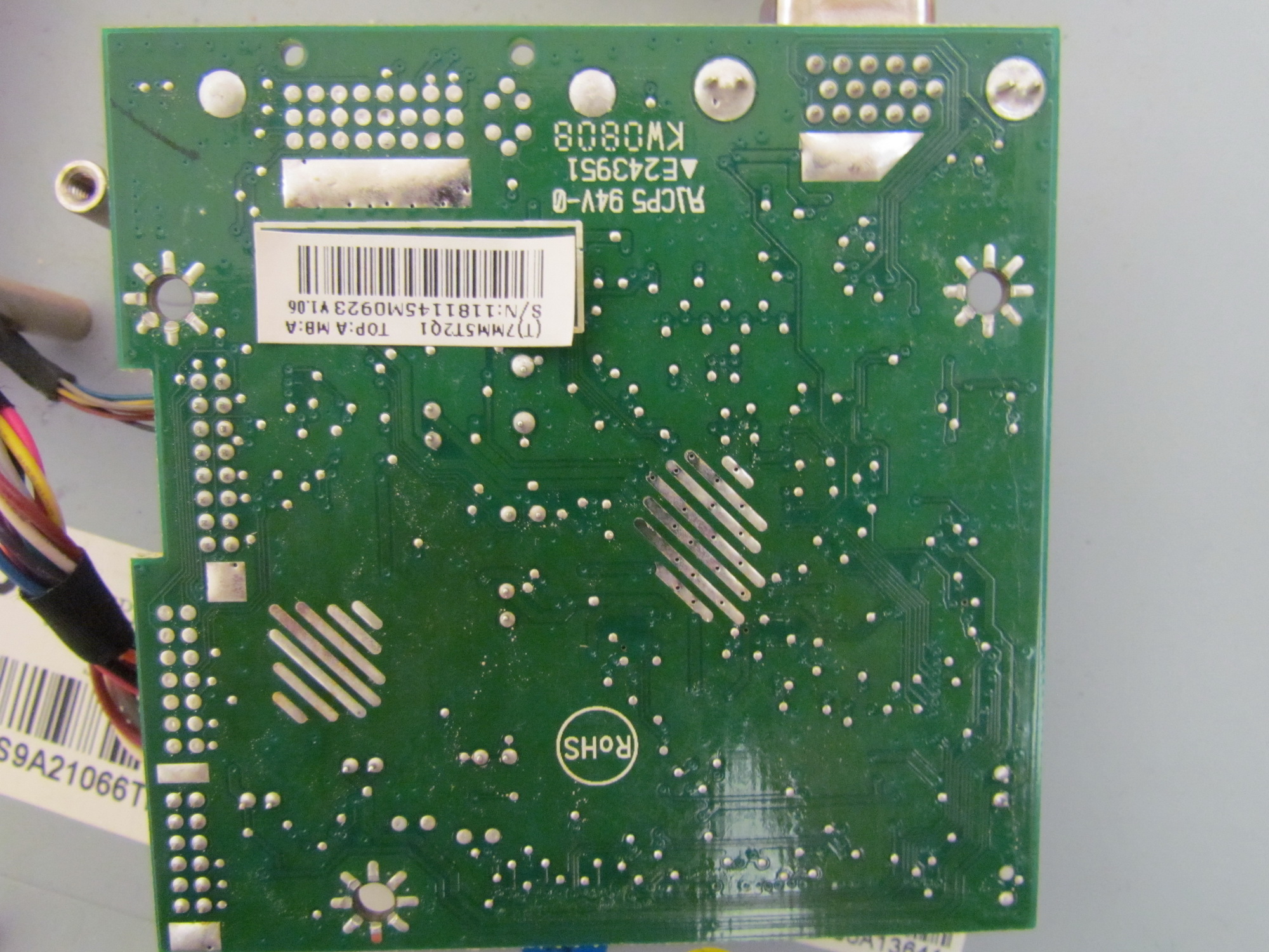

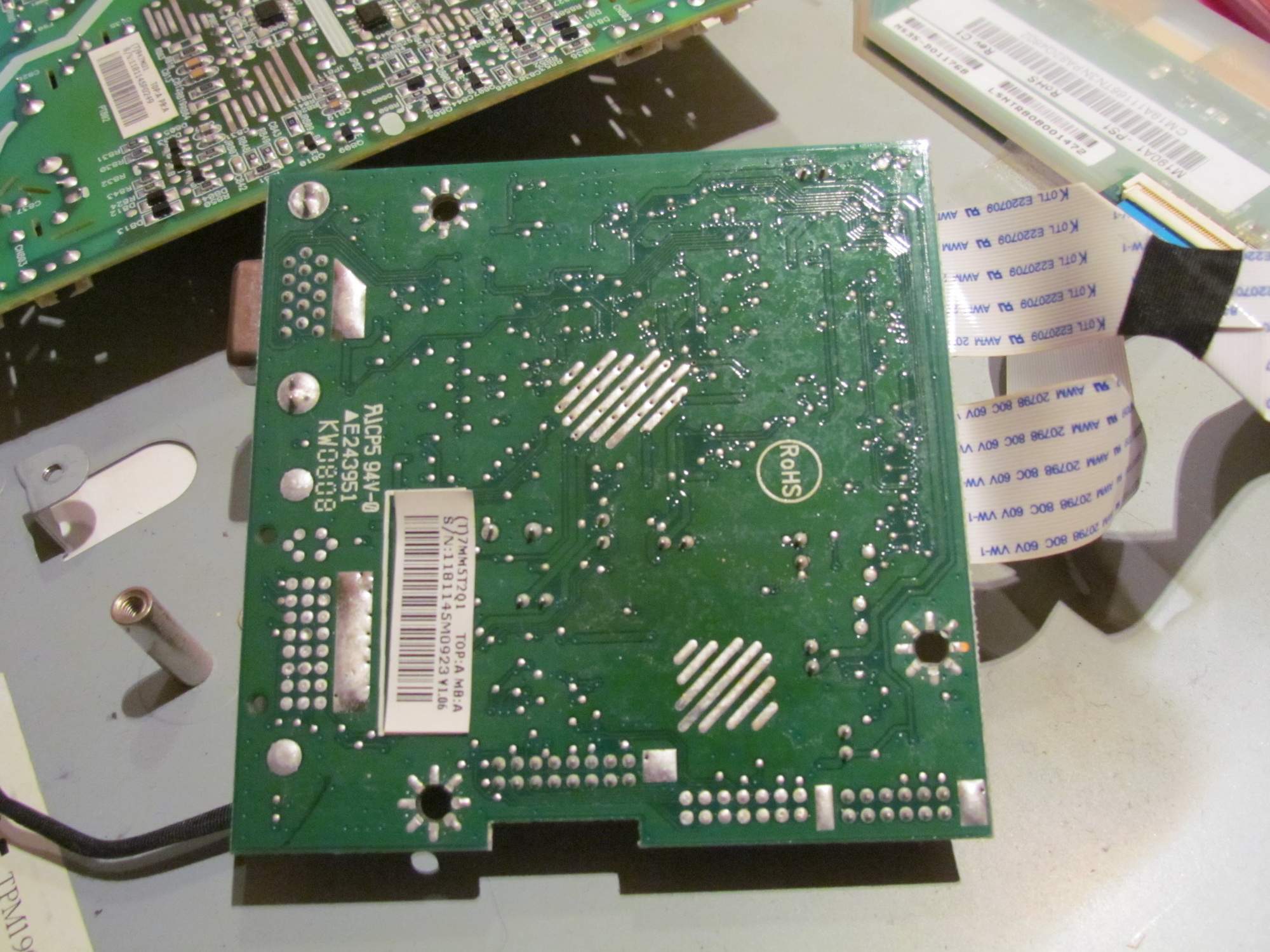

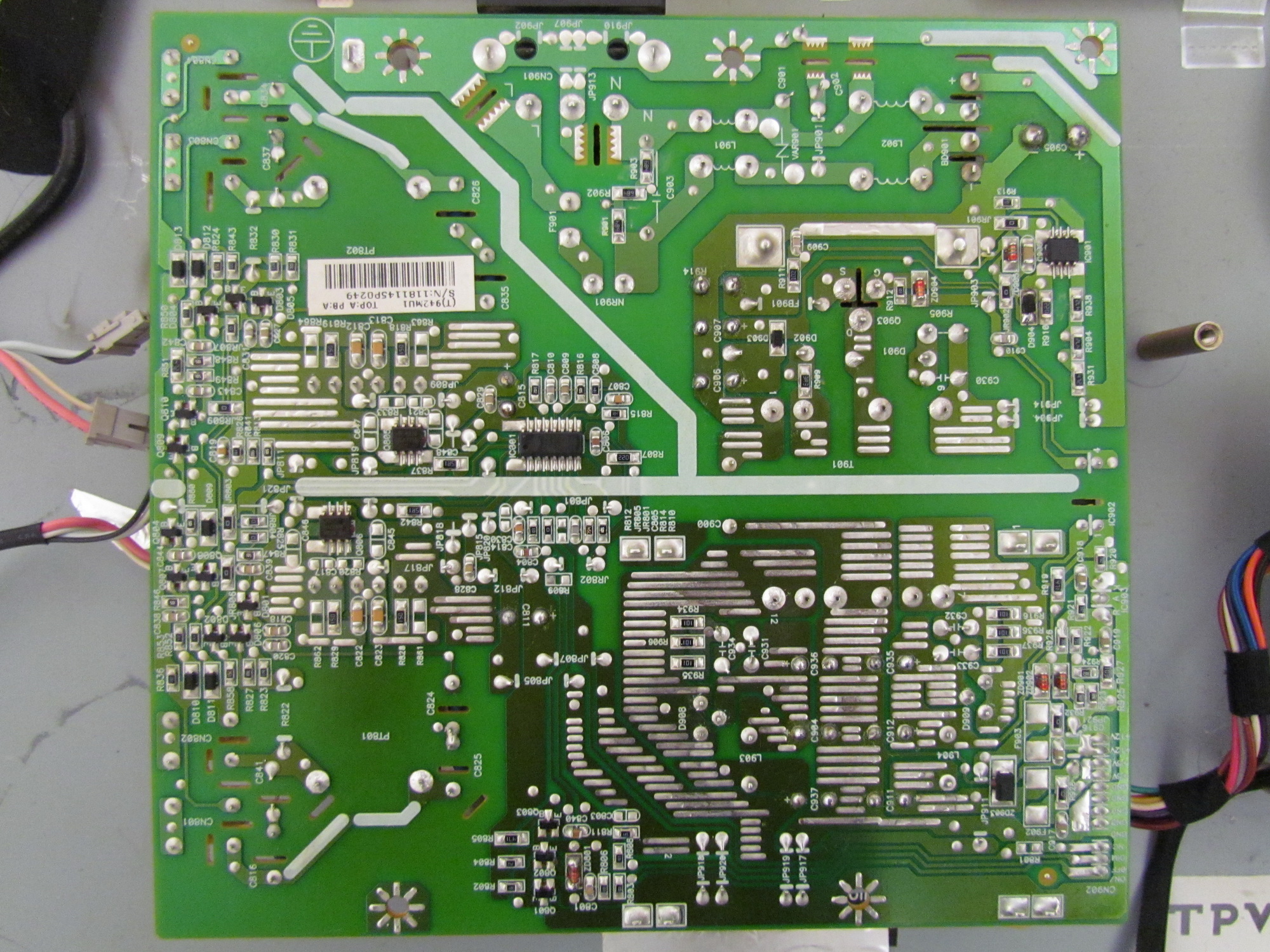

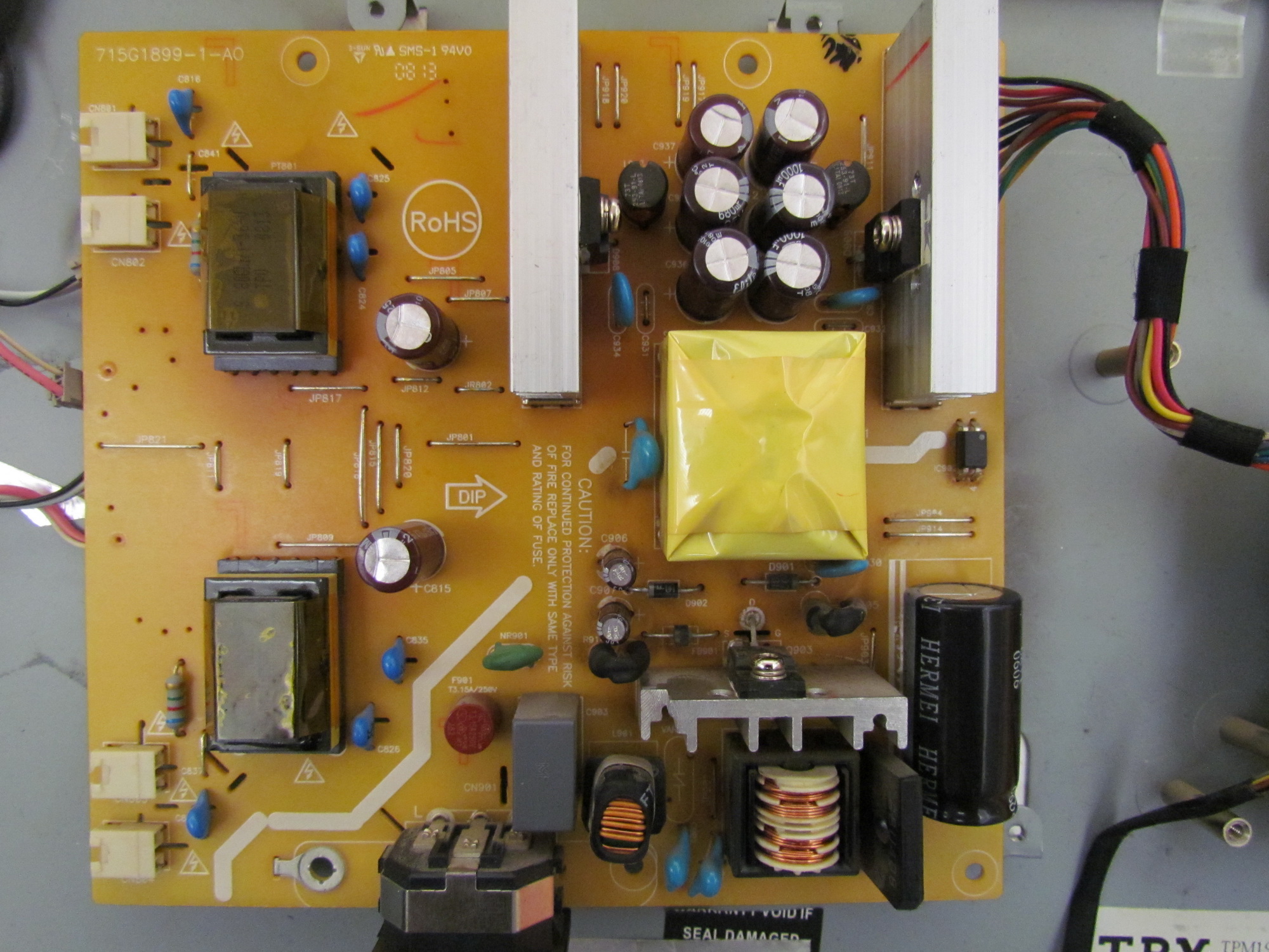

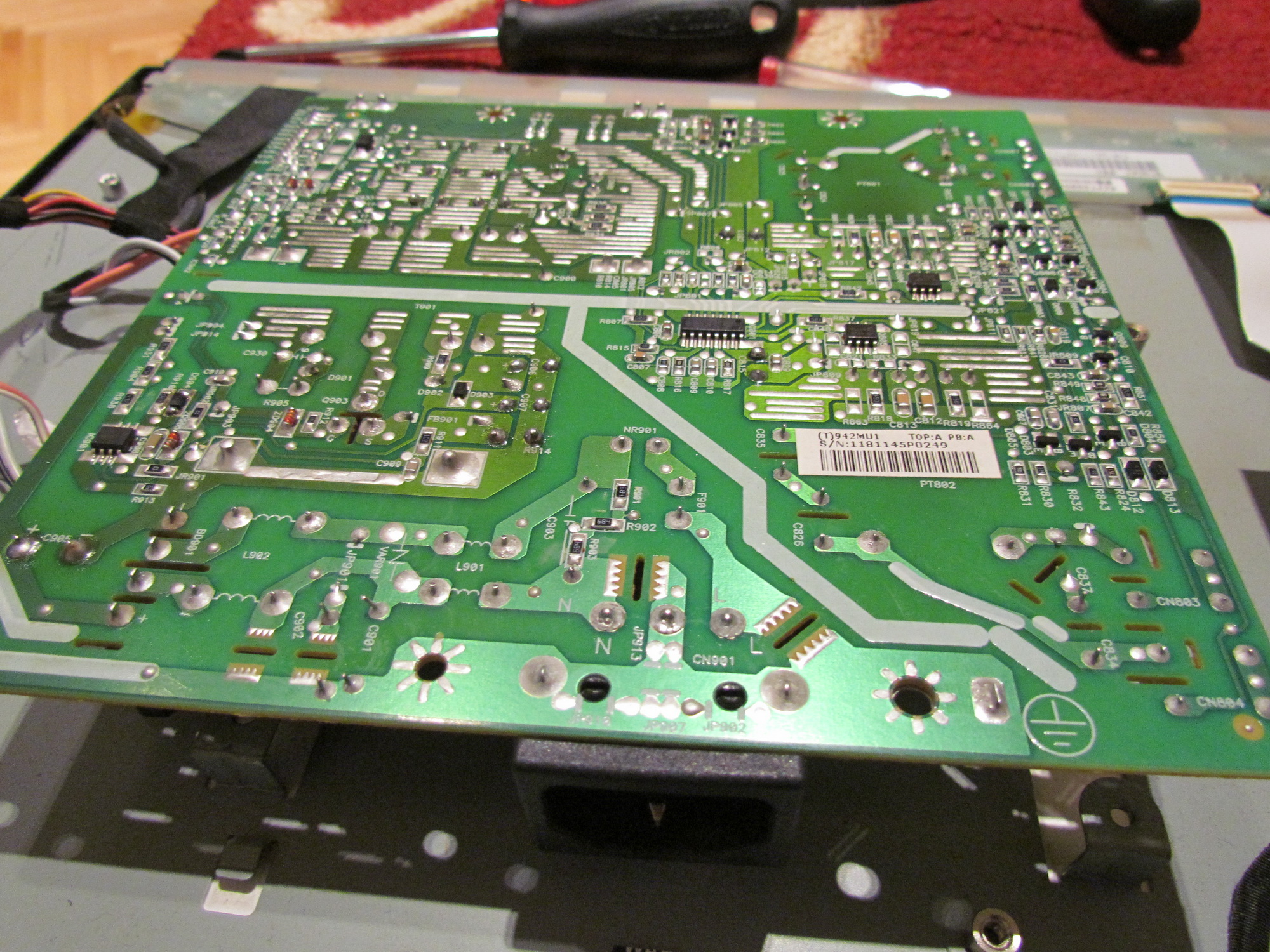

            Is the set all connected up now?
            If not can you retake the pictures of the board - looking straight down.
            If it is connected up then take them next time its apart and try this.
            With it all connected but off disconnect the cable from the main board to the screen
            Main board end is usually easier. Then try and switch it on and report.

                    @selldoor
                    I did what You asked me to do and the same thing is happening, but without picture.

                        Ok reconnect the cable and thanks for the pictures.
                        Another problem illimination test is when it goes off after 2 seconds
                        does the power light stay on the same colour and can you still see a very dark image on screen shining a flashlight at an angle might help.
                        It still does look like a problem with the bulbs or wiring so have a look as budm asked.
                        If I recall correctly the cfl should be low wattage 4 to 11.

                          Re: Asus vw193d-b "2 seconds to black"

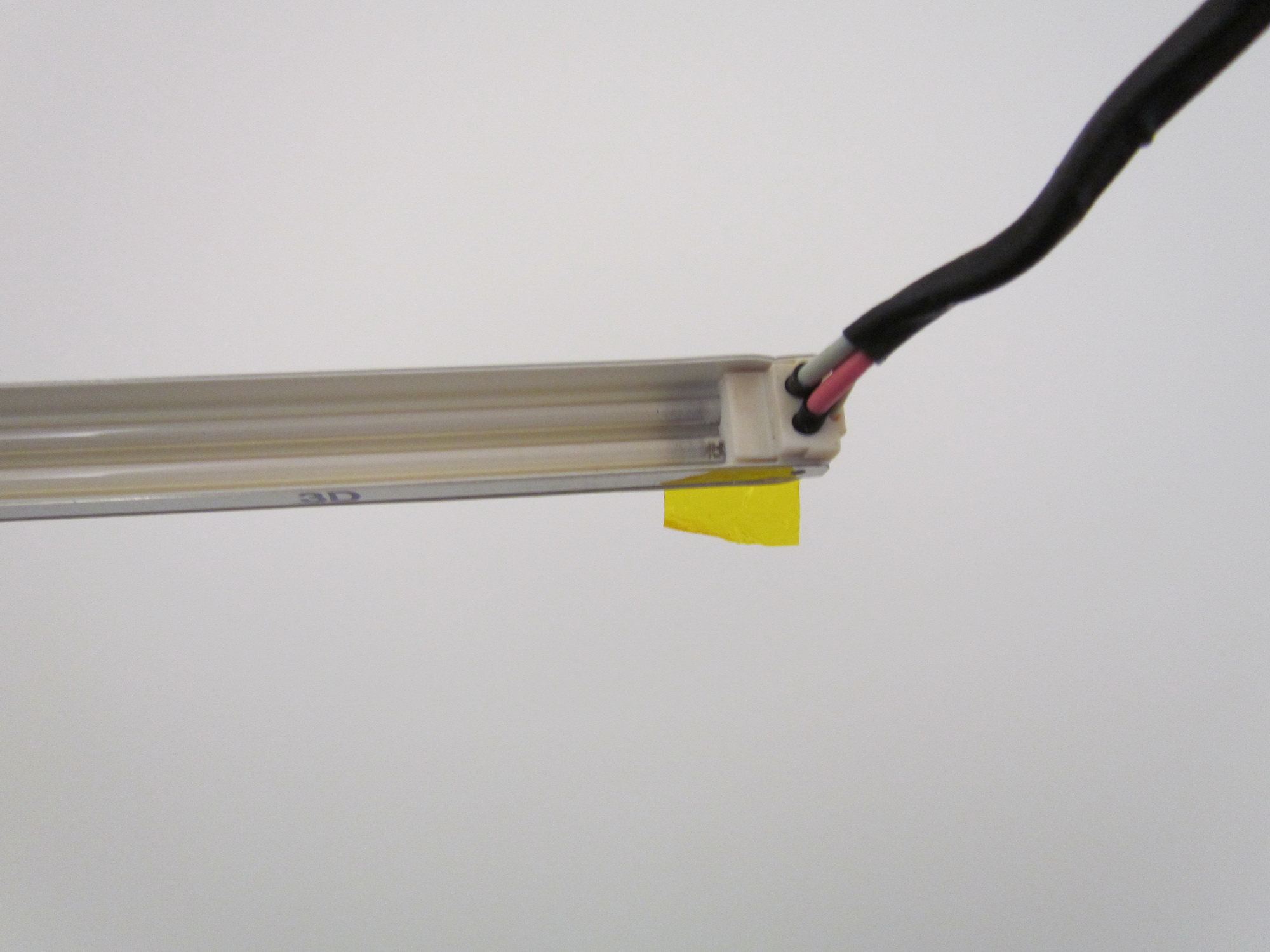

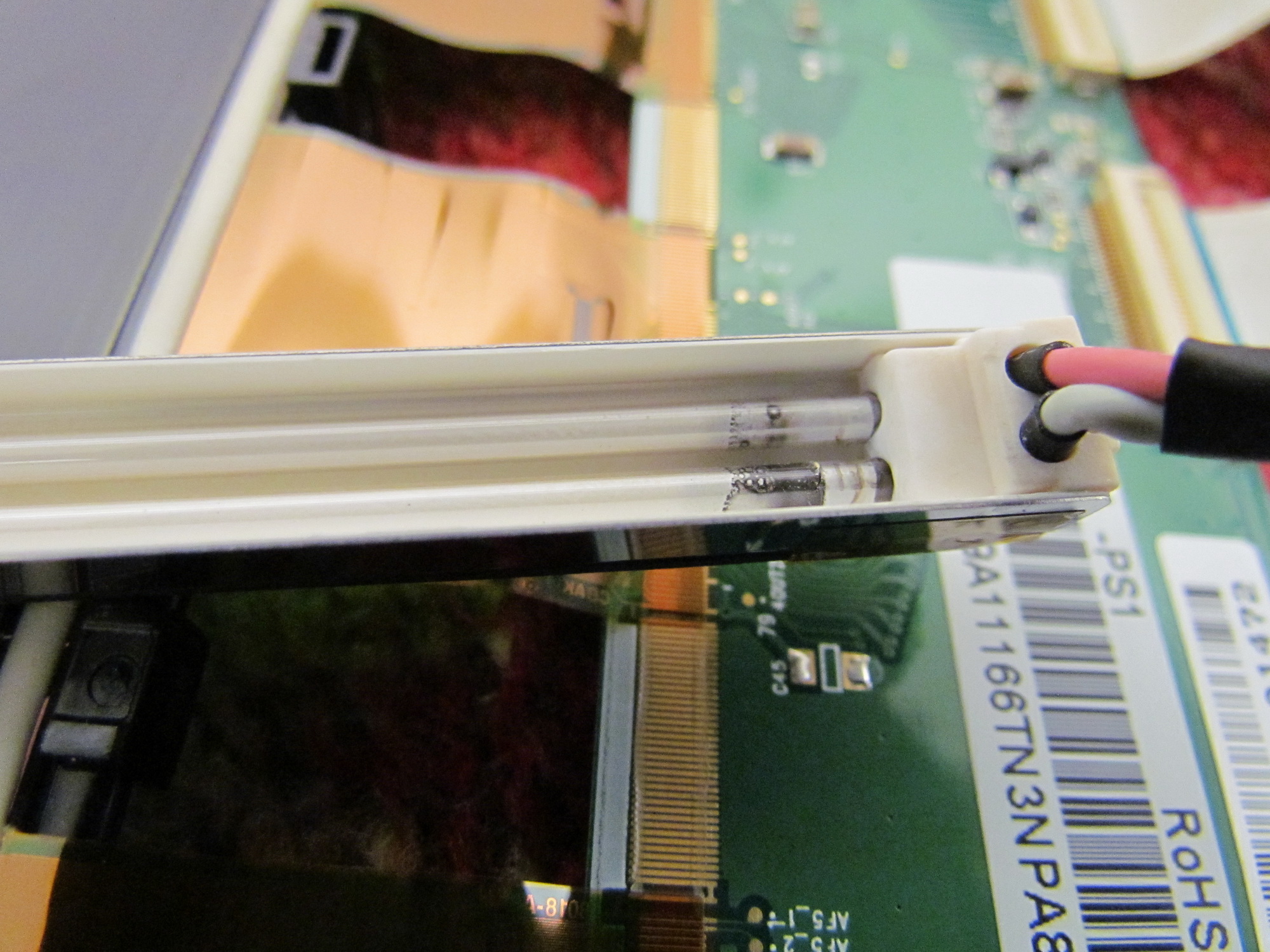

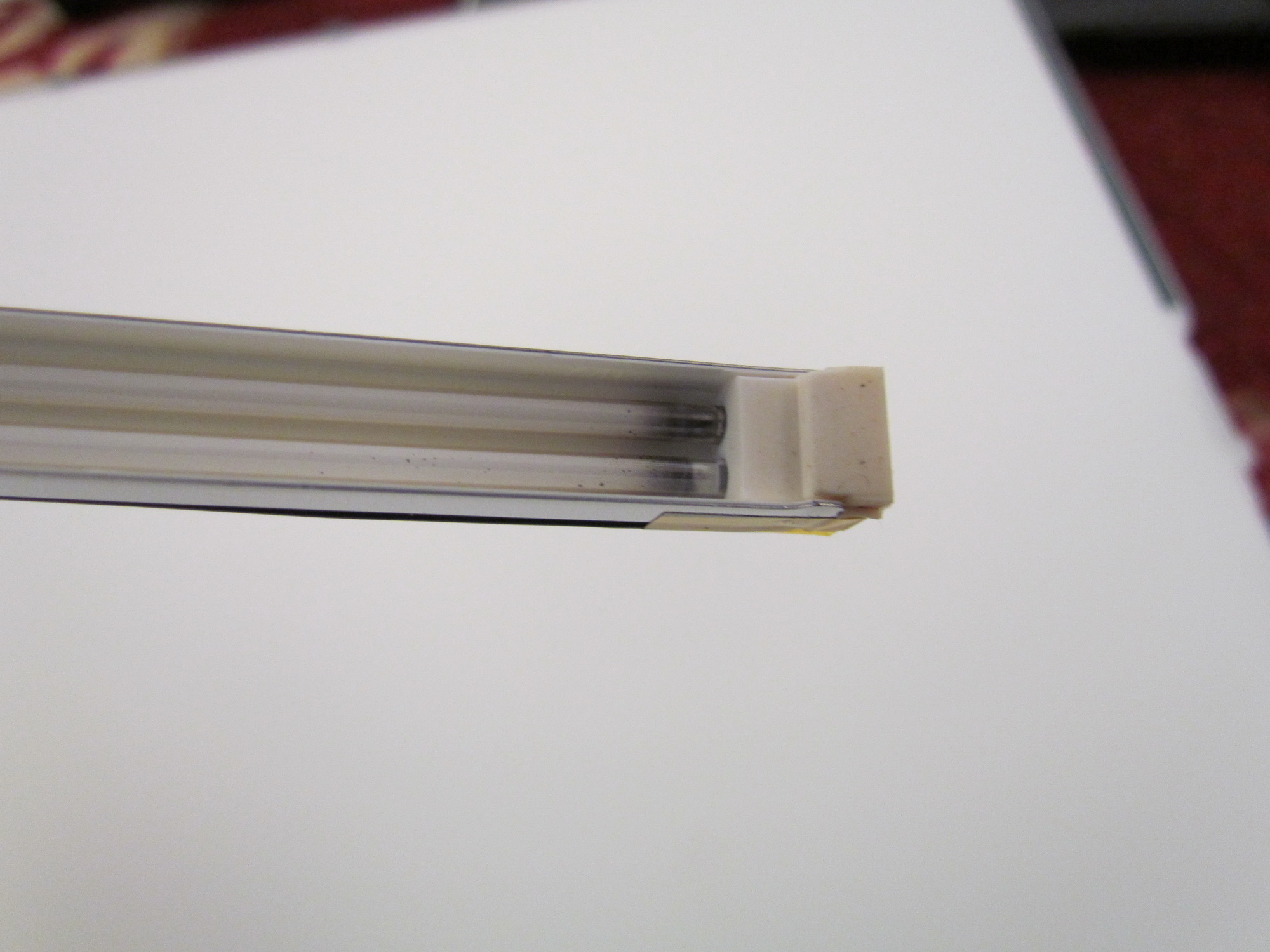

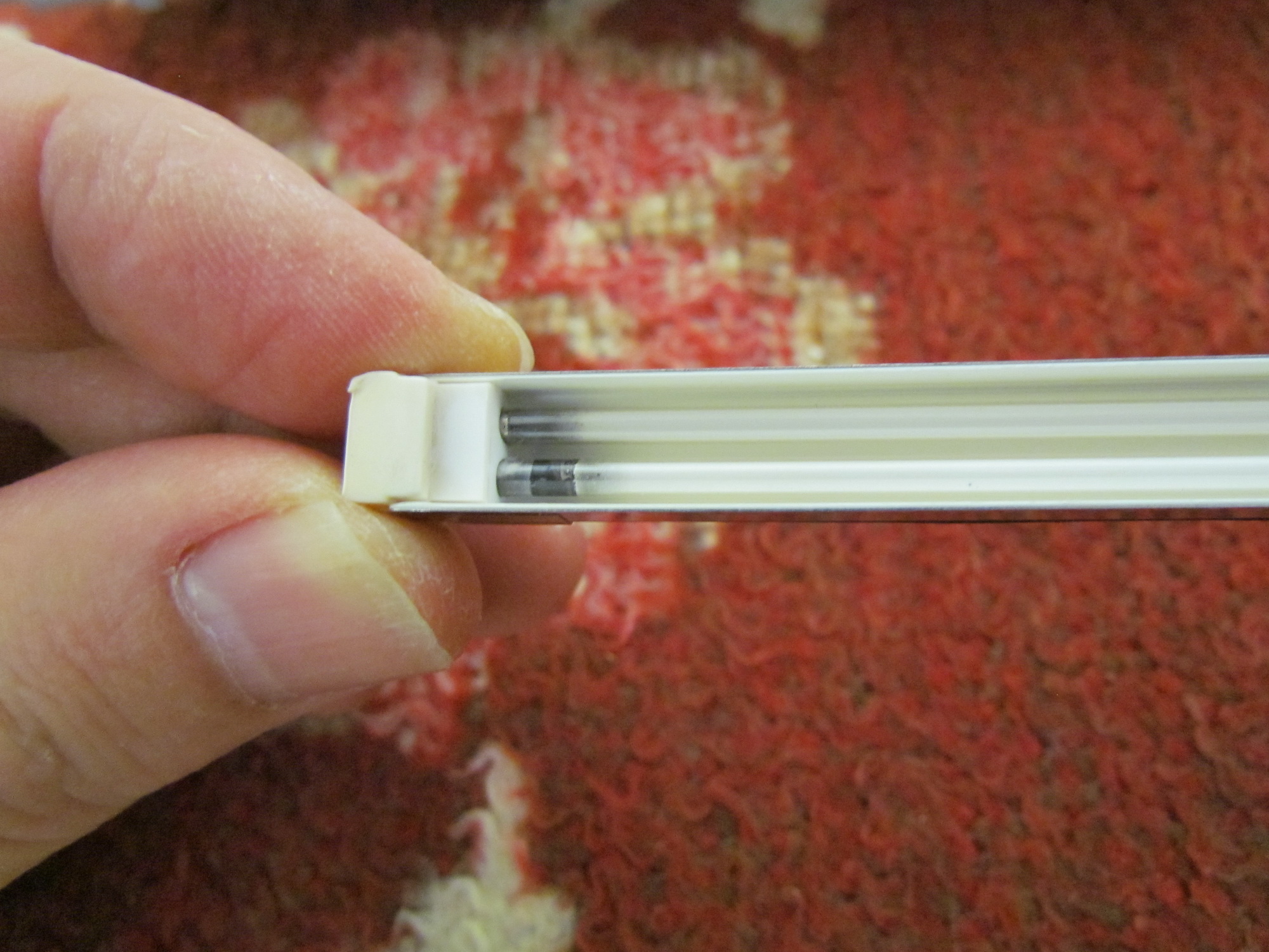

                          Ok guys, here are my lamps.
                          I suppose they aren't good?
                            Nope, they aren't. In the first picture it appears the bottom ccfl is cracked. Those are definitely some well used ccfl's with the dark black ends.
                              Yep, they are bad!
                                Thank you all very much for help
                                  Save the good ccfl's for future testing.
