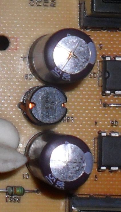

    I have to repair 2 PC Screens (a LG L1730SF and an HP L1740).
    They are quite -old- and we were throwing them away, as the company we used to send them to be repaired were asking quite some money for each, to break down again after some months.
    After the math was done, it would be cheaper to buy newer screens (with 3yrs of warranty and all) than to keep sending the screens to be repaired.
    So, I got those 2 home to start my quest at repairing.
    Enough of the background story...
    My questions:

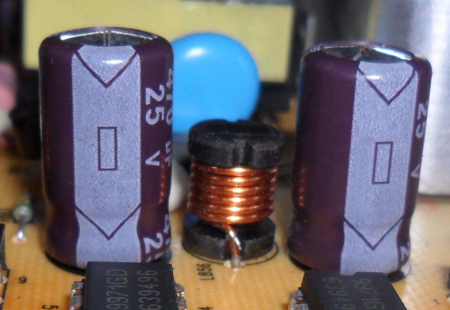

    On the HP one, I found 2 bad caps.
    On the LG one, I found 1.
    Should I replace them all? all the others look ok but since the screens are quite old.. Maybe...
    So, I was checking at the store for the caps and got stuck at the fact that badcaps sells like 4 or 5 different brands of caps and even of the same kind of cap, there are different "series". I tried checking the rubycon (470uF, 25V) ones, and both ZLJ and ZLG series work for what I want. So, how should I decide? Or even between the multiple brands?
    My thoughs: I was thinking in going for the cheapest. Especially because it'll be the first time i'll recap and if it fails, I don't want to loose everything...
    As a sidenote, the bad caps: 2 Su'scon 470uF, 25v (from the HP screen) and 1 Su'scon 1000uF, 16v (from the LG screen).

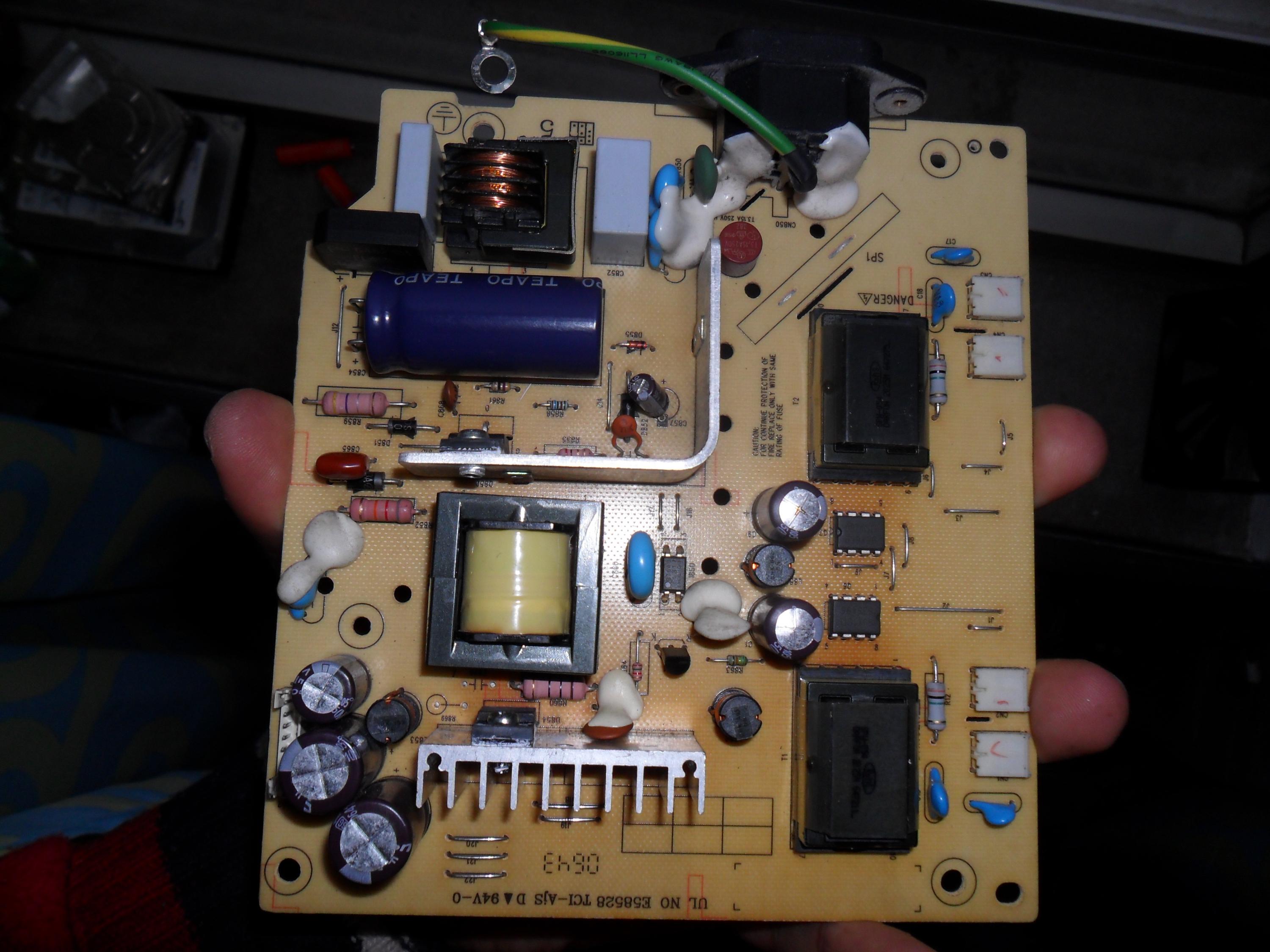

    Sidenote: the pictures are from the HP board as I forgot to take a pic of the LG one before removal.

    I am not sure if you can get PANASONIC FM or FM series in your country, what you need for switching power supply repair are LOW ESR type with 105c rating.
    I would replace them in a set of caps.
    There are other suggested caps list on this site, so you can find out what you can get in your country.

        For ALL the monitor repair I have done, I only use the FM/FR and some time FC series as long as the dimensions match the original depends if you have the room or not.
        So what brand of caps can you get in your country?
        What ever you are going to get, just make sure the ESR (Impedance) is the same or 25% lower, the Ripple current should be the same or better, same 105c rating, longer life hour the same or better. The size will depend on how much room you have on the board.

                        First check which model of HP L1740 you have. I have seen them with 4 different oem
                        power supplies. The one I am most familiar with is the Phillips power supply. The one I own starts with 715G. On these two models even after replacing the caps the problem turned out to be one or two ccfls was burnt out. The other 1740 power supply is made by BenQ. That one I am not familiar with troubleshooting. There is another power (not sure of the mfg) supply that replacing the bad caps repaired the monitor. Look at my 1st post for the Phillips power supply pictures.

                            George Ortiz, unfortunately I don't have any sticker nor plastic casing, as I had to strip it down to the bare metal since I didn't wanted to be stuck at the security guards asking me questions about it. Even though My boss knows i took it home, this is supposed to be for learning and training. Making it work is a plus.
                            I can show you a picture of the pcb though.

                                From your picture this is definitely the fourth model of power supply that I've worked on.
                                Your picture shows exactly the same problem the two 1740s had. I replaced the 470uf25v (2) per board and voila the monitors worked. I had a third one fail at the same two
                                capacitors, but replacing the caps here did not fix the problem on this one. Since I already had two other spare 1740s, I elected not to troubleshoot further. I used Panasonic caps for the two repairs.

                                    So I decided to get all the caps exchanged on the 2 monitors (appart from the biggest cap like selldoor said. Based on this quote, I made came up with this:
                                    Clickable links:
                                    on the image, the First one is in red because, that's what would match this panasonic's table ( ), but the impedance was way off so I though if I could replace with a similar yet smaller one (the EEUFM1E471L)
                                    All the rest, was direct "mix-and-match".
                                    So, how bad?

                                      Either one in the first two links will work fine.
                                      For the 1000uF, stick to the 16v one, the 25v one may not fit on the board as it's 12.5mm. But if you think it does fit, feel free to get it, it won't hurt going for higher voltage rating.
                                      But pay attention to the shipping costs, for my country Digikey used to charge 20$ for orders smaller than 200$ (saying used because it's a few months since I ordered last, it might still be the case).
                                      And, you might also pay customs taxes and VAT if they're shipped to you from US, but it depends on how your country's laws are.
                                      I'm using Farnell and RS-Online mostly nowadays, because Farnell has a flat fee of 20 RON (~4.5 euro) for any package for my country - but for other countries they have minimum order sizes and other annoyances. RS-Online has a Romanian distributor they work with and they charge only a courier fee of about 5 euro 1-2 Kg packages.
                                      Farnell and RS-Online prices are a bit bigger than Digikey's but if you order a lot of parts, with Digikey you may get hit at customs with the 1-3% import tax and VAT (which in my case is 24%).
                                      It's still a tad cheaper to get from Digikey in volume, but sometimes it's worth more for me to have the UPS guy at the door with the package 2 days after the order (yeah, they're really that quick, 2-3 days for stuff to arrive from Farnell's UK warehouse), instead of waiting 2 weeks to get stuff from US.
