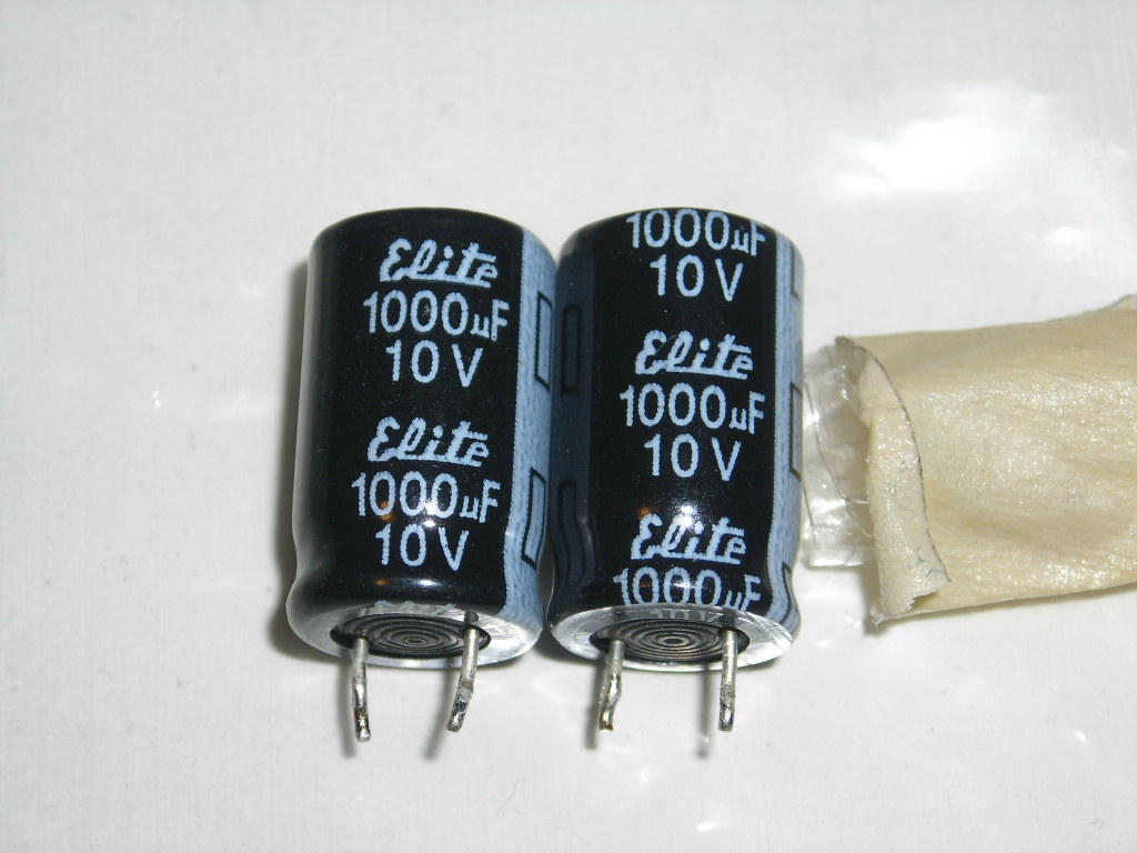

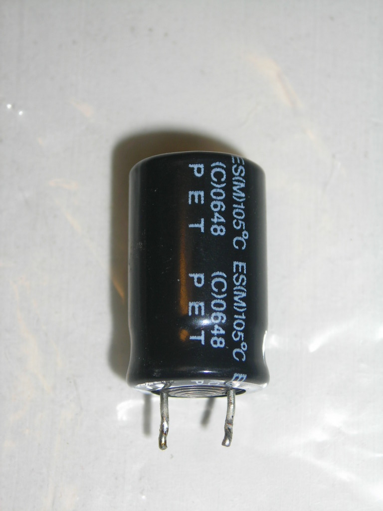

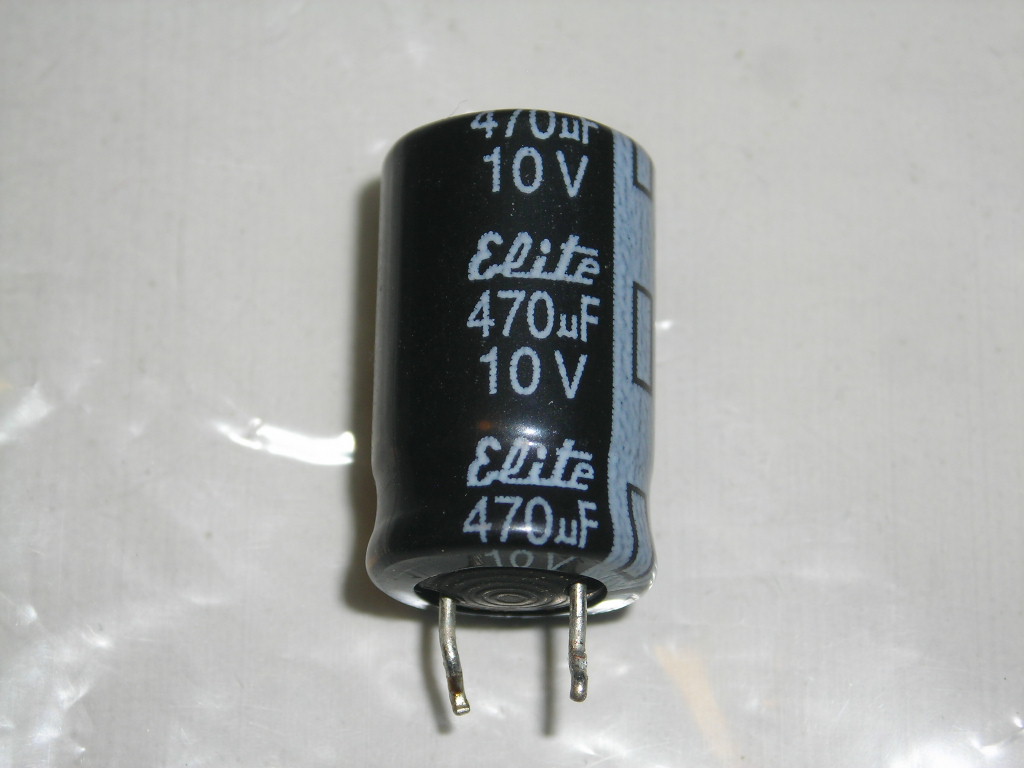

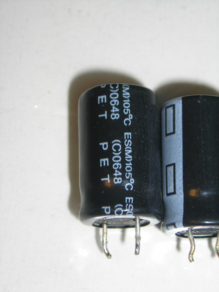

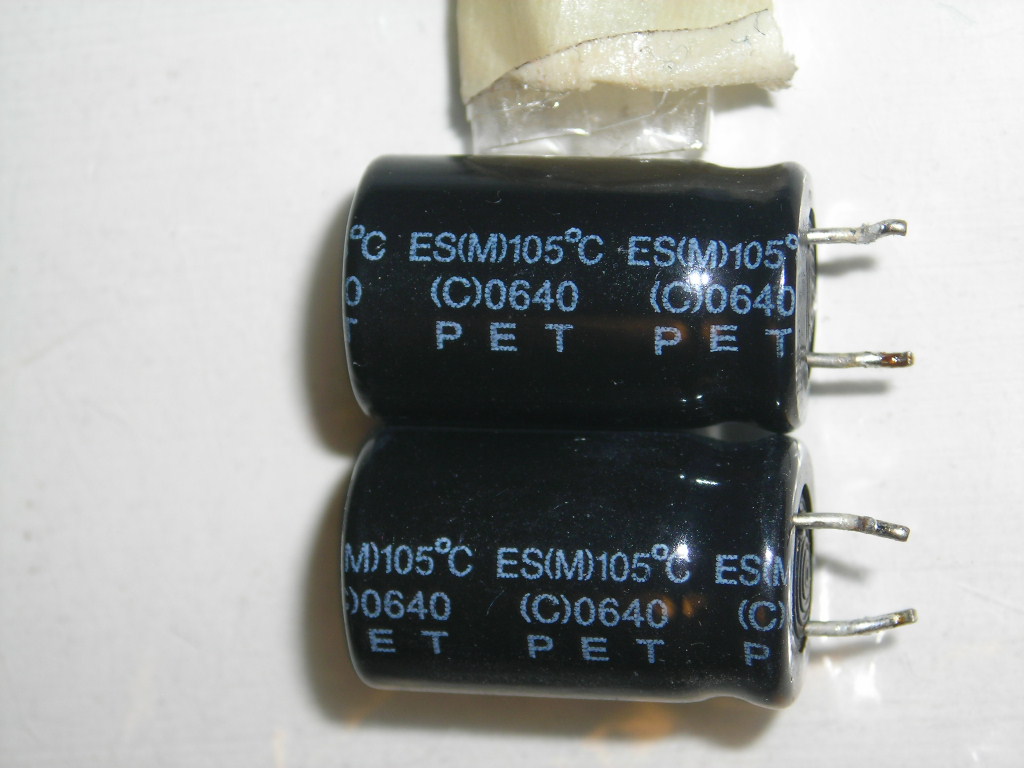

    1. First HW-191D Repair
    This one's power supply had 8 caps blown.
    5 x Elite 470uf 25v
    1 x Elite 470uf 10v
    2 x Elite 1000uf 10v
    And these were replaced by
    5 x Rubycon 470uf 25v
    1 x Nichicon 470uf 10v
    2 x Rubycon 1000uf 10v

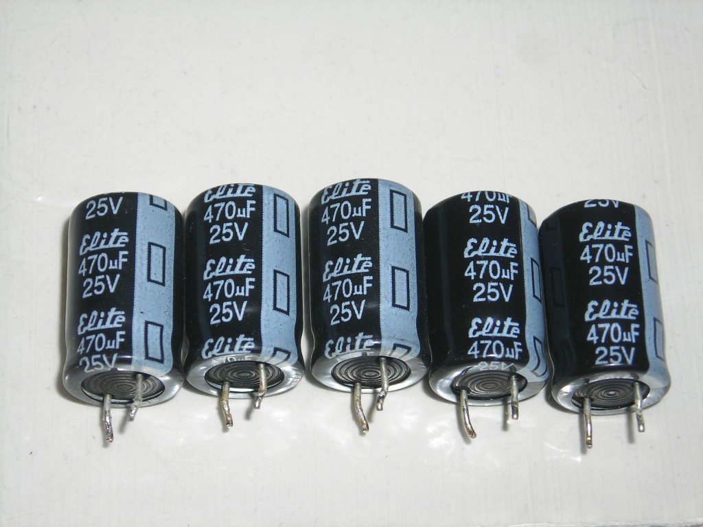

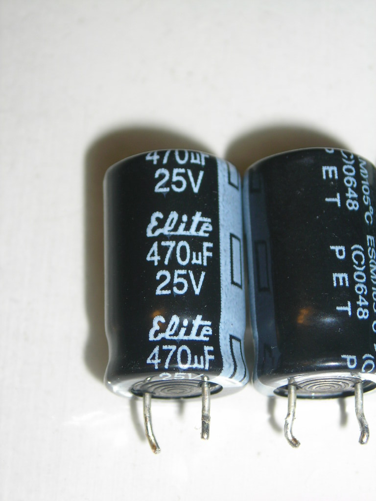

    2. Second HW-191D Repair
    Another same model I repaired. This one only had 4 caps blown.
    4 x Elite 470uf 25v
    and as well, these were replaced by
    4 x Rubycon 470uf 25v

    Re: Two Hanns-G 19" LCD HW-191D Monitors Repaired
    Good repair job, but did you use low-ESR units?
    The Elite electrolytics which have not been replaced (except for the 400/450V unit) should also be replaced too, as they can cause a second failure.
