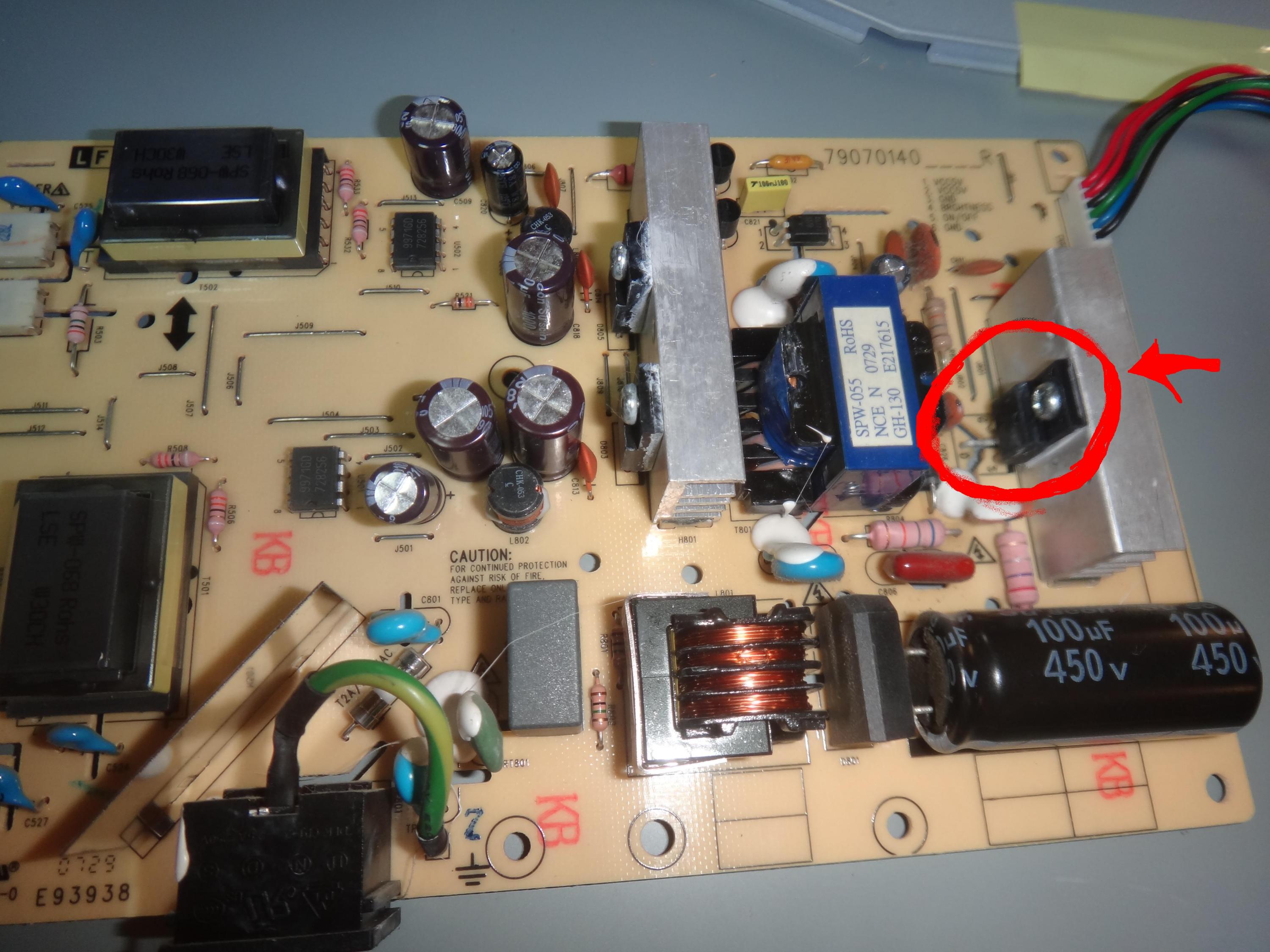

    What does this power transistor do? can it cause this

    Welcome to this great forum. You can't just substitute one (set) of ccfls (bulbs). You have to replace both (sets) on that board. In fact on almost all inverter boards it will be that way. Try that first before you attempt to replace that mosfet you circled in your picture.

      That mosfet is in the Power supply of the circuit,and is obviously good,as you can see a dark image.

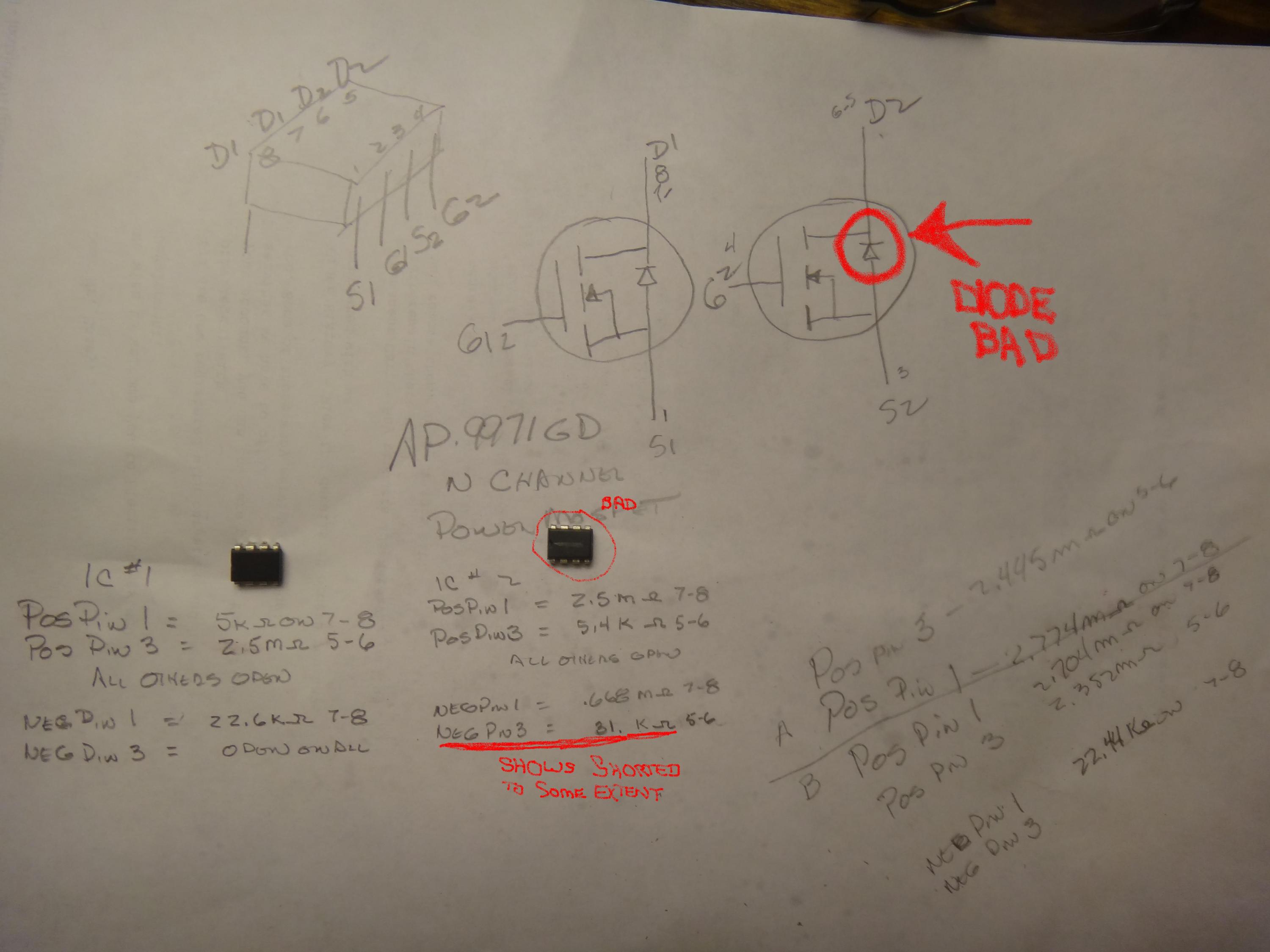

          U501 and U502,are the mosfet drivers for the Inverters.You can find the datasheet for AP9971GD, and then do resistance comparison checks on them.and advise your results as follows :-measure 1-2,1-3,1-4,1-5,1-6,1-7 and 1-8..then 2-3,2-4,2-5 etc. to 2-8.then 3-4.3-5 etc to 3-8 right through similarly on the other pins to 7-8
            Re: Gateway FPD1976w 2 second blackout
            Thanx for the info. I have removed both MOSFETs and per the spec sheet diagram the following is what I have found:
            Parts on order!!

                Can not find these MOSFETs. Bought some out of China and found that they were bogus knock offs
                Still have a bad monitor. Started by changing the caps, replaced the high voltage transformers and replaced the CCFLs. these MOSFETs are the last thing I can deal with if I can get them.
