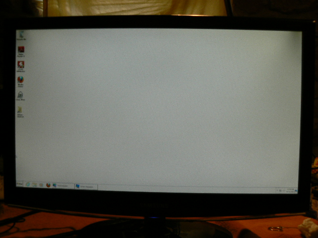

          I wanted to report back that today I finally was able to get this monitor working again. It has been a very long learning process that is for sure.
          Originally posted by Lumberjack777
          Once I was relamping, and was looking at the LCD screen, and set some needlenose pliers down on the bench. Right on top of a bulb. *crack* Oops!
          This information helped me out greatly. I caught myself almost making this mistake repeatedly with various tools I was working with during the bulb replacement. I kept thinking of this comment the entire time I was working on this project and I have to say it was very helpful.
          I want to thank Budm and Retiredcaps for the bulb ordering links (how to and where). I have to say my ordering experience was one of great learning. As I stated in my first post, I did not want to disassemble the screen again just to order bulbs out fear of unnecessary damage during the process. So instead of doing it correctly I did exactly what I should not do and just got a rough estimate of the size bulbs I needed from external measurements. I then went to the site recommended by Retiredcaps and found some bulbs in their clearance section that I thought would work for this screen. They were only $2.50 each so I went ahead and bought four of them.
          When I went to install them I discovered that they were not going to work. I think the length would have been OK, but it turned out the diameter was almost double what it should have been. I really was not surprised by this result; I knew I was taking a big chance when I ordered them. I now have some long bulbs that I will use for future testing. The only other one I had for testing before this was out of a 12” laptop.
          After this I ordered the longest bulbs they carried that where the correct diameter. (2.4 x 490mm Full Spectrum CCFL) These bulbs happened to be just about 15mm shorter than I would have liked but I thought they would work OK.
          It turns out that I was correct and it would have been better for them to be longer by about 15mm but I did not let that stop me from using them. I did not enjoy working with them but I managed to get them in without breaking any, much to my surprise and relief. The screen now works again; the only problem is that the top left and right corners are a little darker than the rest of the screen due to the bulbs being short. It is a little noticeable but it is not too bad, at least it is not in the landfill. So to answer my original question when I started this thread 2.4 X 505mm bulbs would work great for this monitor.

            That is so awesome to hear. Your first attempt and you did it. That's fantastic. Especially since it was a longer lamp. 17" are a lot easier. I think relamping is just about the hardest repair to do on an LCD. Congratulations!
            If you are looking for more projects to practice with; you can check to see if you have a local electronics/TV/computer recycling place. I found one and they sold me 4 non-working LCD monitors for 20 bucks. Also Goodwill or Salvation Army type stores. I found a couple on Craigslist. I even bought a couple non-working monitors on eBay. When you get to the point where you can mix and match parts, or have extra lamps to test with. It makes it much easier. I love taking an LCD that was totally dark and useless: and bringing the life and beautiful colors back into it. ~ L-J-7 ~

              Re: Please help with Samsung Syncmaster 2333SW CCFL Bulbs
              Lumberjack777, thanks for the good advice. I had not considered a recycling center.
              I would like to know if there is an easy way to remove/replace the little silicon figure 8's that hold the bulbs together. All I could get them to do is tear. I have to say it was very tedious work, I am hoping the next one I have to fix has bad caps. Everything I try to repair, it seems, has some crazy hard to fix problem. You learn more that way, but sometimes I would rather not learn so much.
              I am attaching a picture of the repaired monitor. The picture quality sucks so I apologize in advance. The right corner is a little worse than the left one, the white background makes it really stand out.
