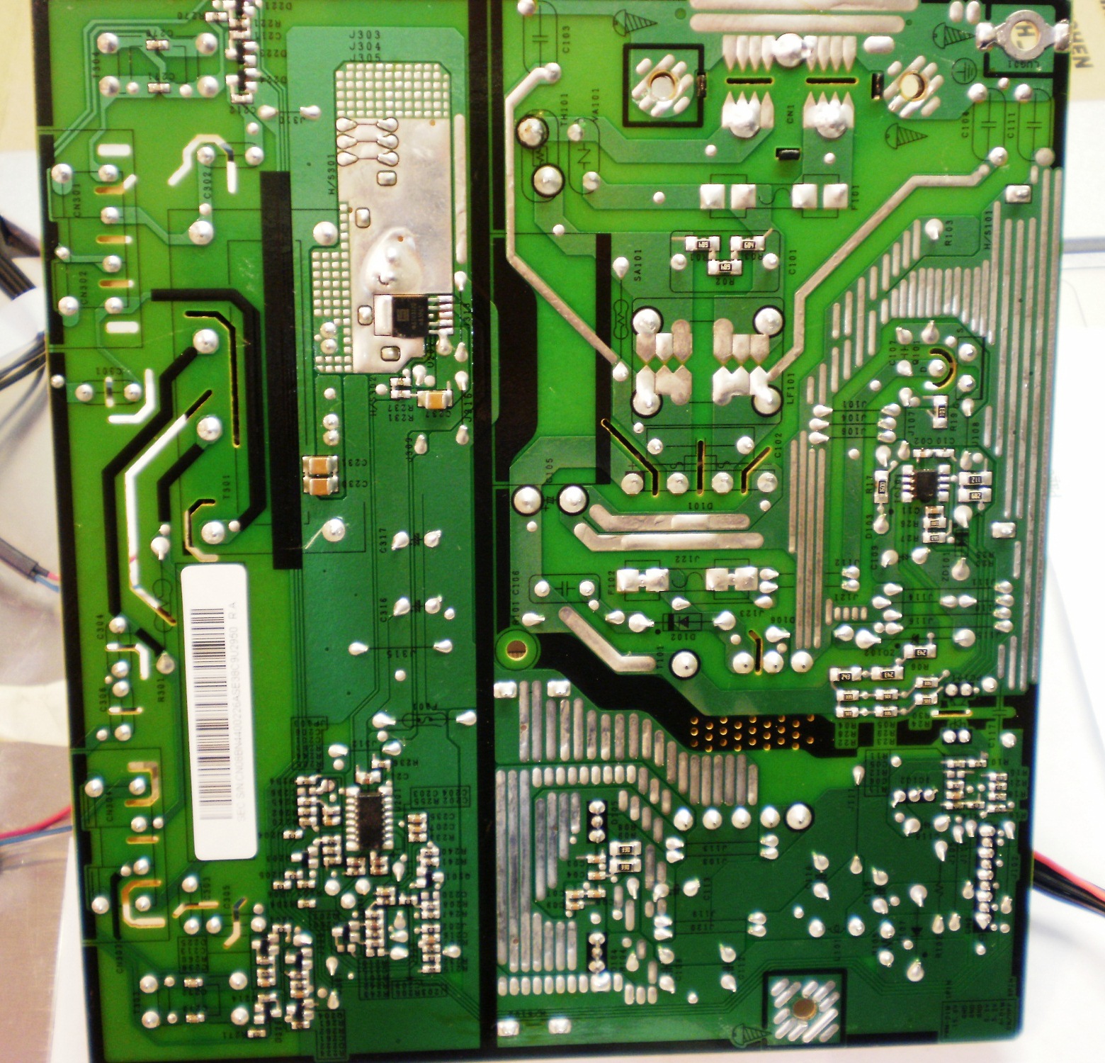

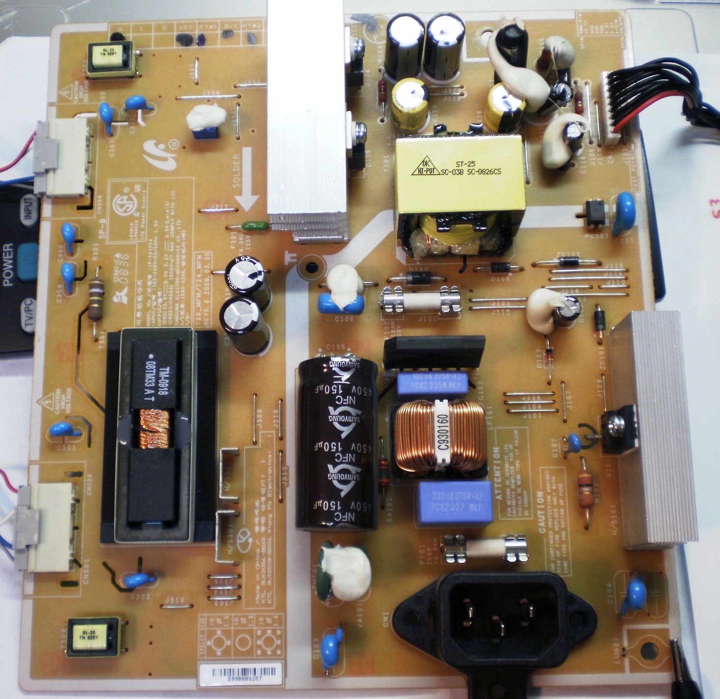

                        Here are the pictures:
                        (left side inverter, right side connector for the main board)
                        This is the 2333HD version, has a big mainboard.
                          Re: Please help with Samsung Syncmaster 2333SW CCFL Bulbs
                          So are you getting any voltage at the small green fuse for the inverter circuit? There is only one Dual MOSFETs that drive the transformer (it is a half bridge drive setup), chek all the pins of the MOSFET to see if there are any voltage on them. P/N of the MOSFET and the PWM IC?
                          Also on the white connector to the main board , I cannot read which pin is for the BL_ON pin, see if it has >3V on that pin.

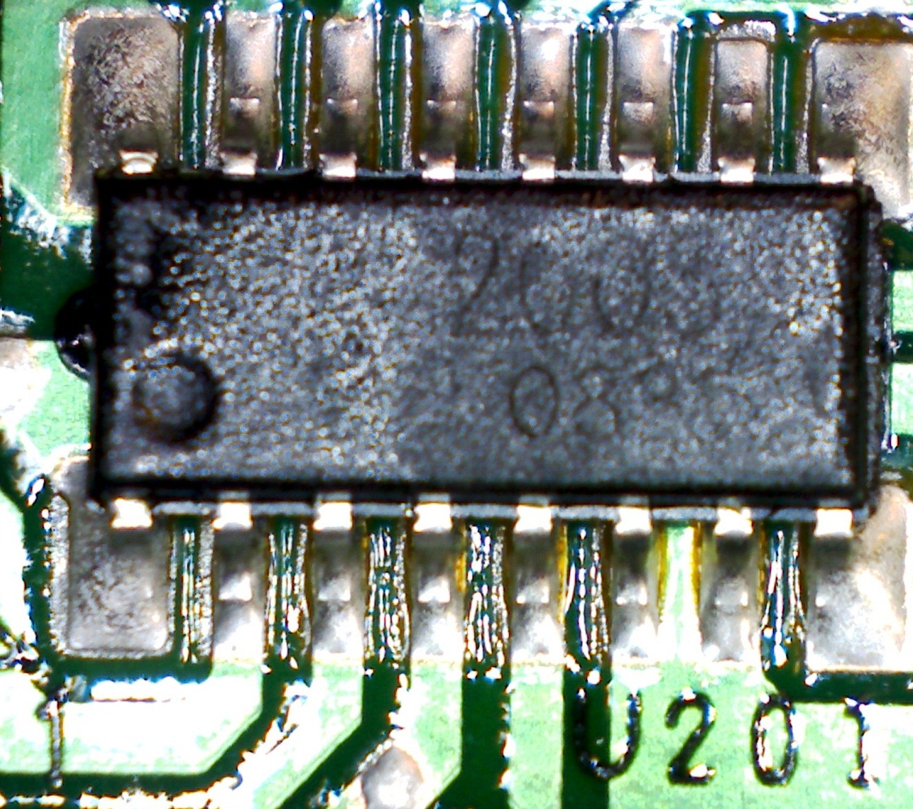

                                Unfortunately, I can't read the part number from the IC. I did not had time to measure the voltages yet.
                                This is all I can see:
