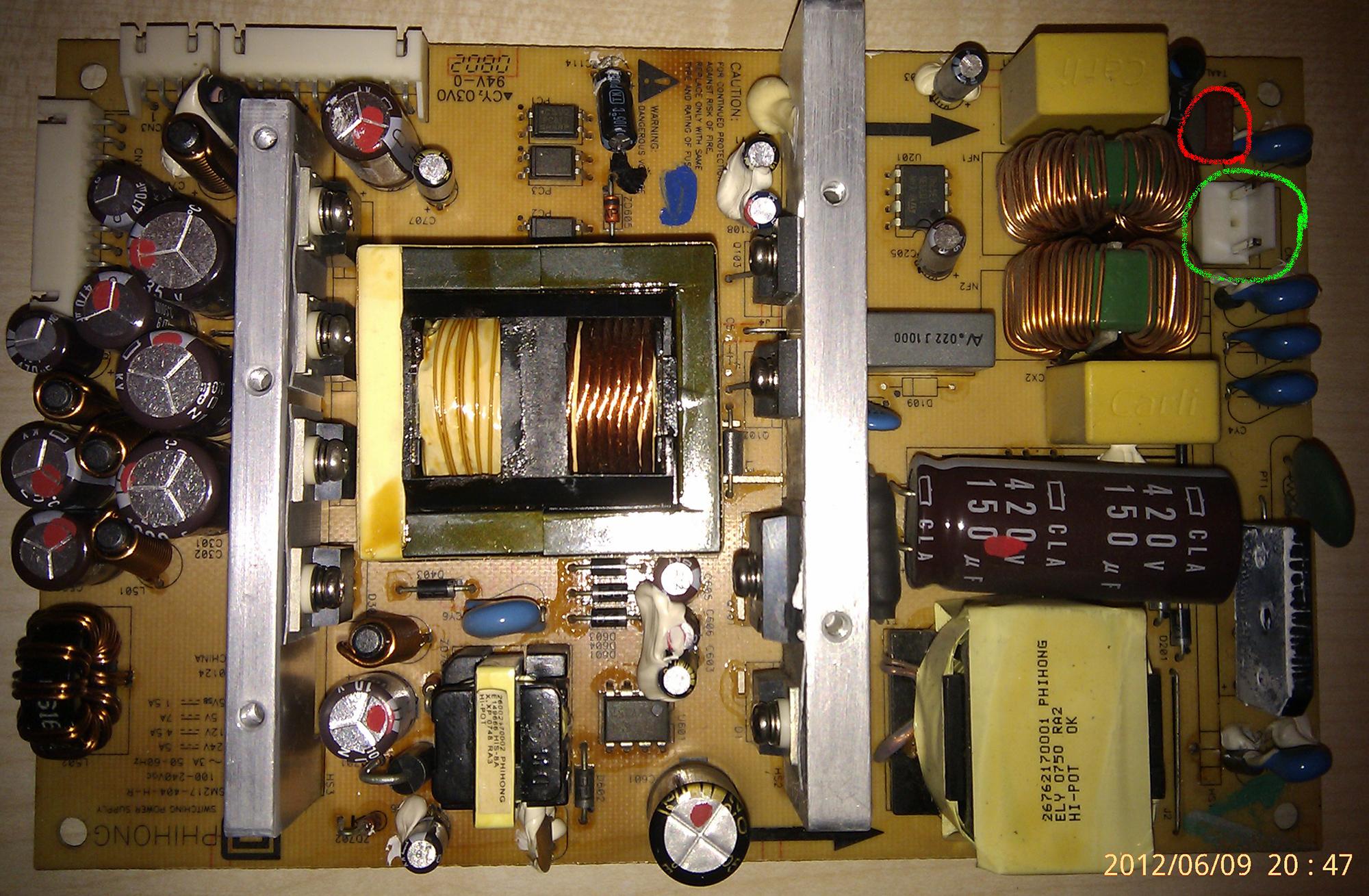

                        1) Your fuse is likely in the top right hand corner. It is red and square. On the board, it should say something like F100. "F" stands for fuse.
                        2) A good fuse should measure less than 1.0 ohms. Always measure resistance with power off and lcd unplugged.

                          5) Since I can't see how you have things connected, I have to ask the obvious.
                          a) Do you have the AC cord plugged into a known working outlet?
                          b) Do you have the cable connected to the power board that is connected in green?
                          PS. Your fuse is circled in red.

                            Thanks retiredcaps --
                            Yep, I got an AC plugged in from a working wall socket. I have the plug which connects the powerboard to the AC plug connected to the board (the one circled in green.)
                            I measured the ohms on the "new" board for the fuse...it reads 9.04 Mohms (M and the ohm symbol, i''m guessing mega ohms, which is a huge number).
                            I then measured the ohms for the fuse on my "old" board (the one which I tried to re-cap, and kinda messed it up) and got around .4 ohm (which is about what you said it should be, for a good fuse)
                            Sooo maybe my problem is just a fuse on the "new" board? I'll have to check RadioShack if they have a new fuse, or I can just pinch the fuse from my other board to test with in the meantime. Thanks for your help so far --

                                  I got the new fuse installed -- the voltage at 5VSB now fluctuates in the 4.75 range. It is never stable at any point.
                                  • retiredcaps
                                    • Apr 2010
                                    • 9271
                                    Re: Hanns-G 281D -- No power, Replaced Powerboard
                                    If the standby voltage is fluctuating, then you likely have bad caps like Mishannya
                                    https://www.badcaps.net/forum/showthread.php?t=11329
                                    It sounds like you got completely ripped off on a "tested" and working board. First the fuse is blown and now you have unstable 5V SB power.
                                    I would file a complaint and try to get your money back.
