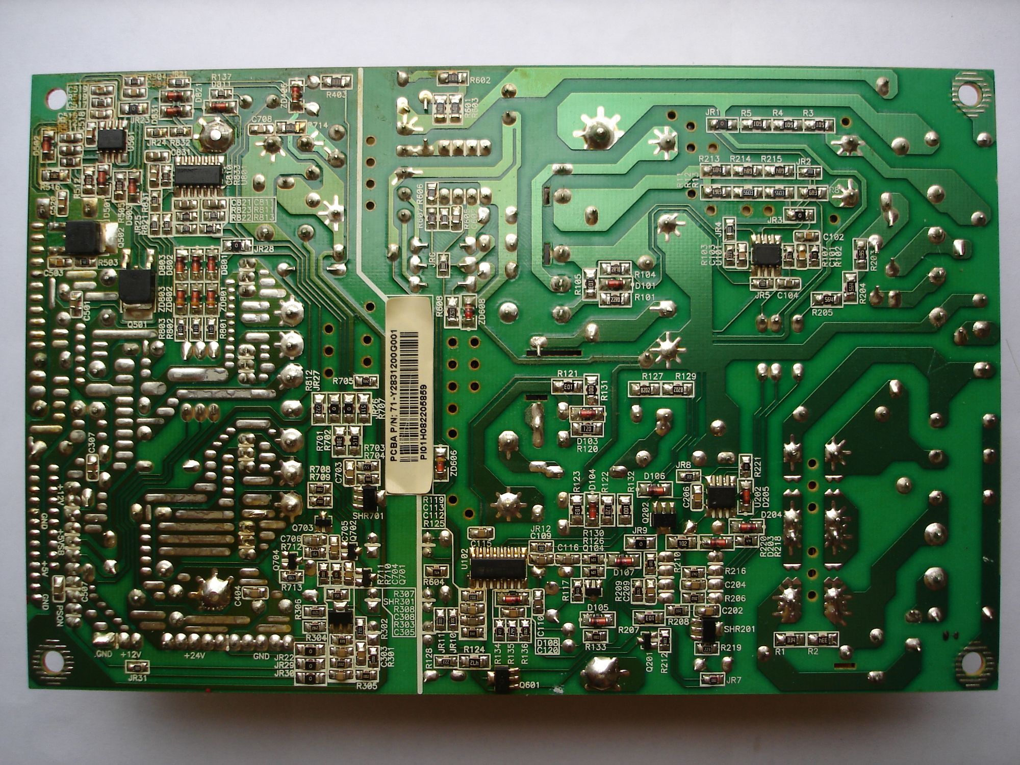

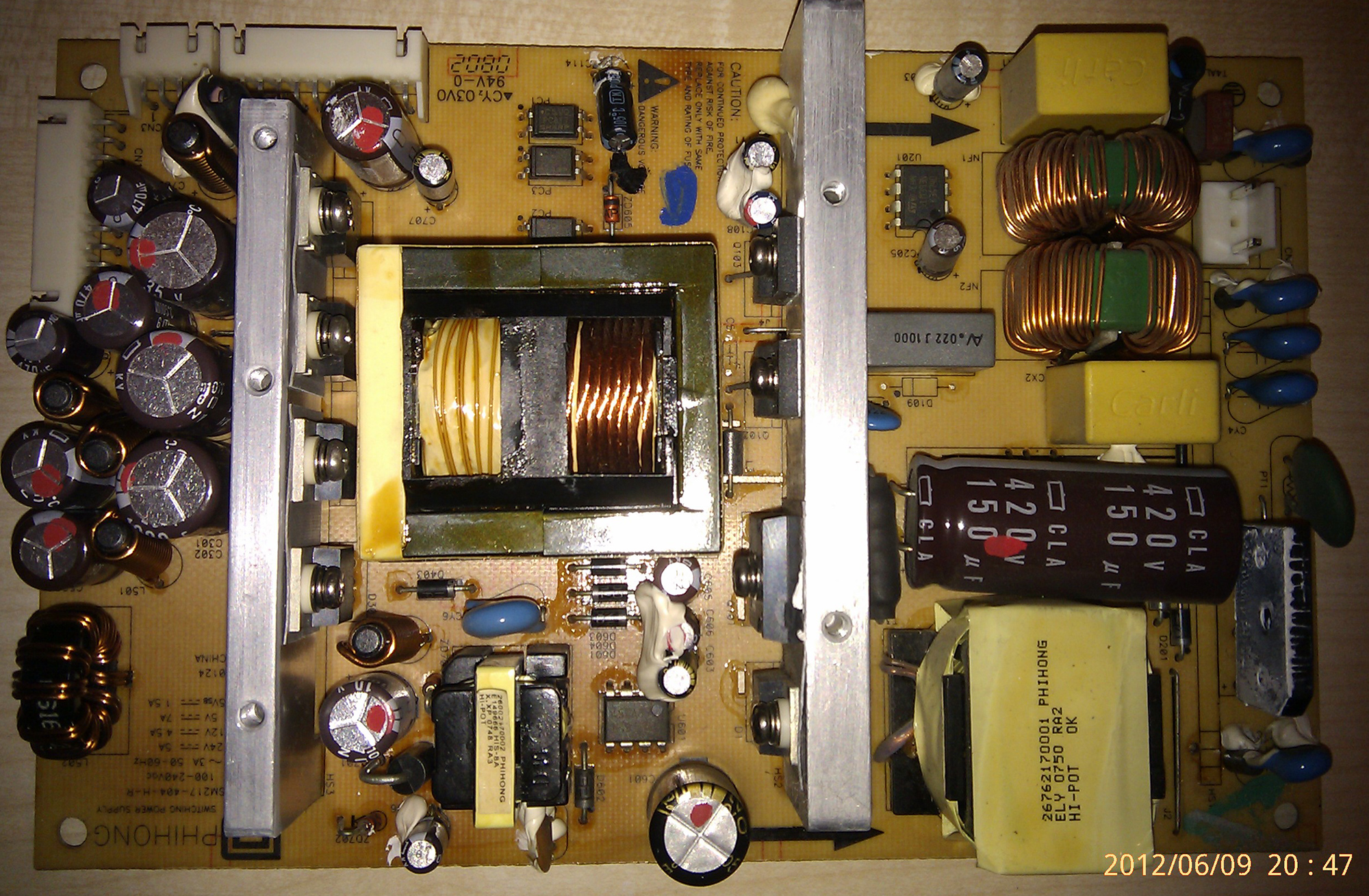

      Here are some pictures of my powerboard. None of the capacitors are bulging or anything like that. there is a logic board on ebay now. Any ideas on how i could test it for functionality?

        That said, you have in the picture of the bottom side of the powerboard marks of 12V, 24V, GND , 5V, 5V Stand By, etc.
        First, measure with black probe in GND, red probe in +5VSB.
        If there is 5V in it, use a 1K resistor to connect it to PSON. Then with red probe in the other voltages ( +12V, +5V and +24V ) see if there are voltages present.
        Inform your findings.

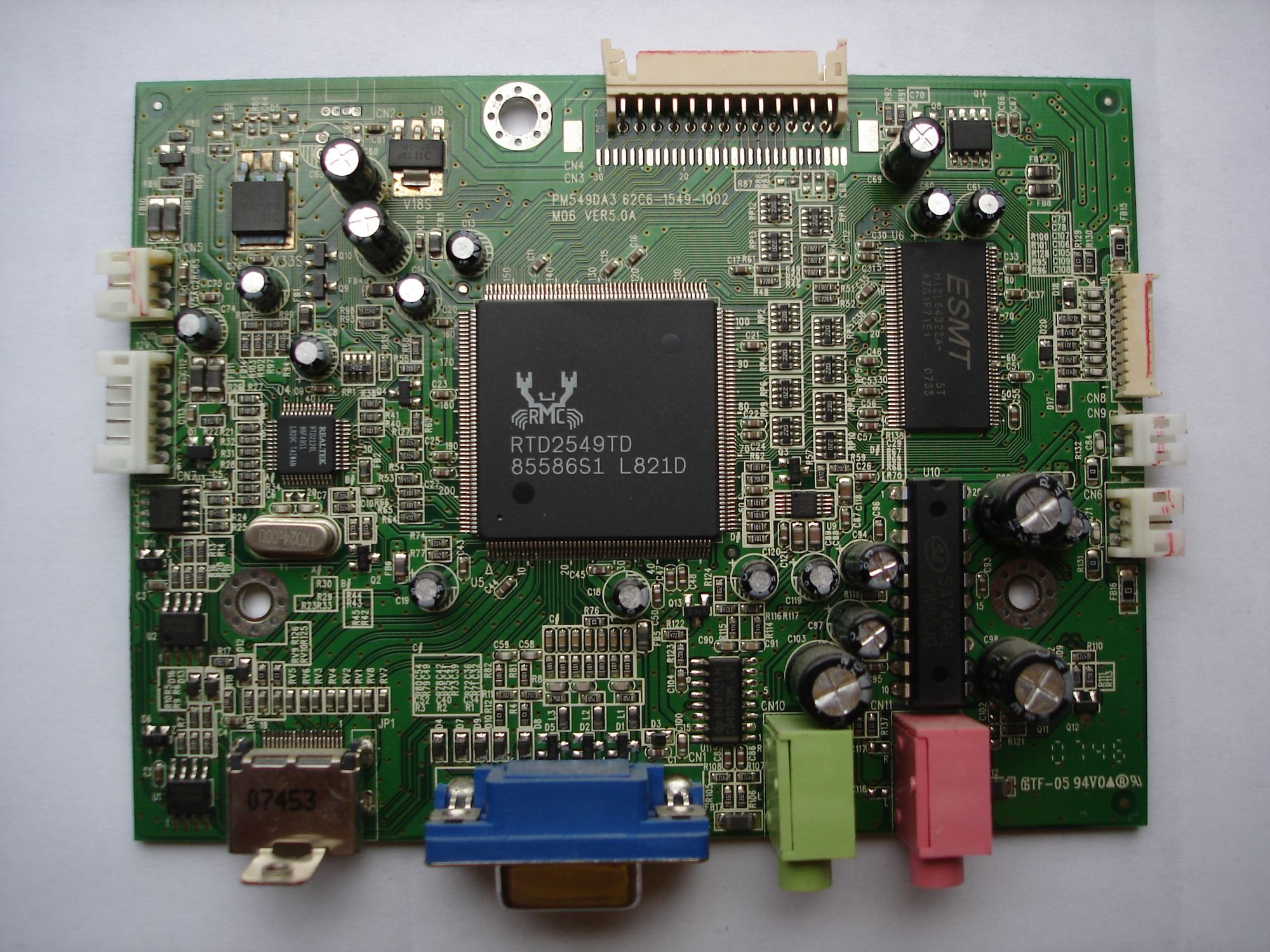

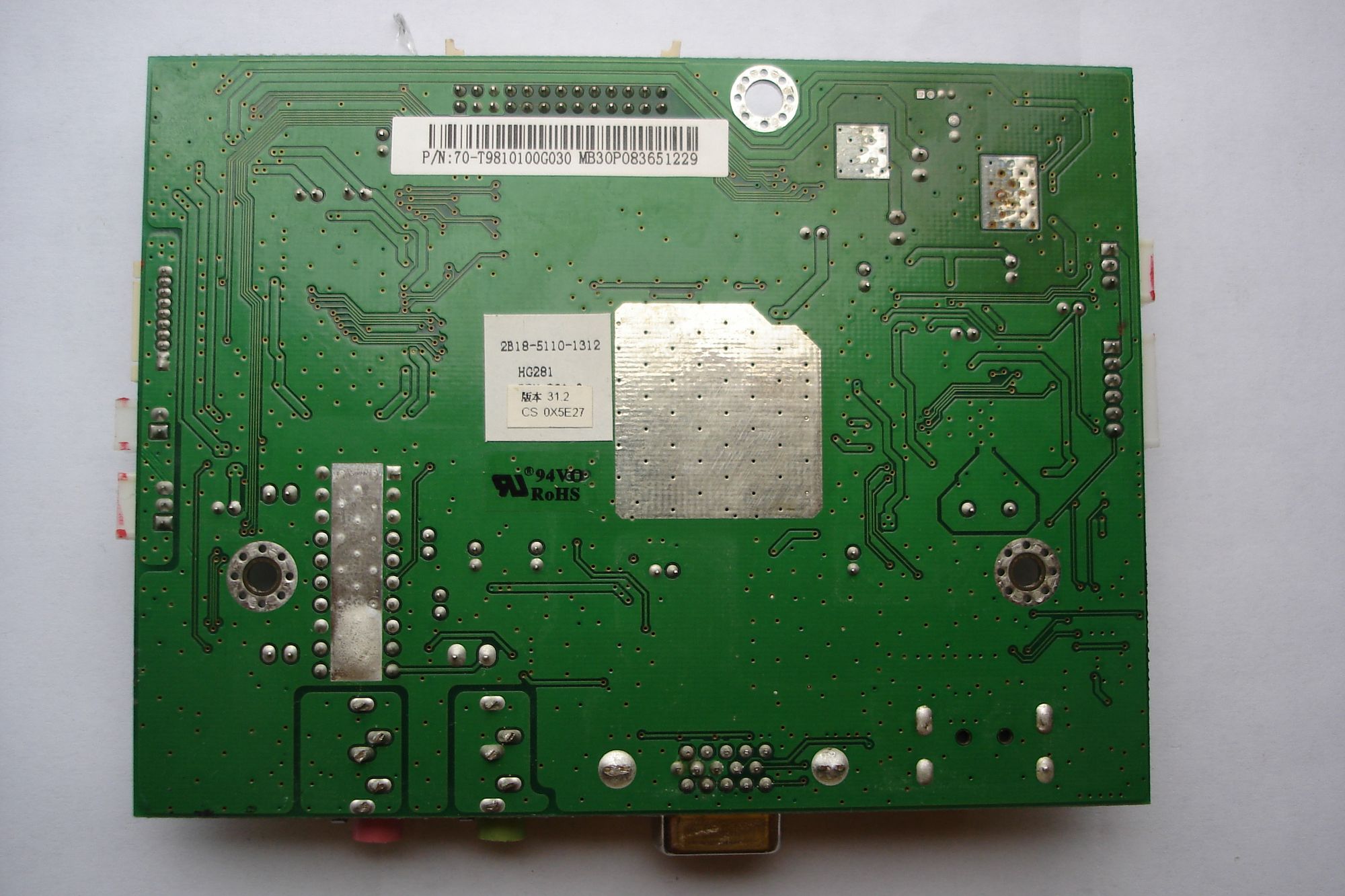

          You cannot test the functionality of the Logic Board,all you can test on there are the Voltage regulators,but as there is no photos of them,cannot point them out...ALSO please use the photo software which comes under Advanced.

            sorry for the crummy photos -- here are some high res ones, which i borrowed from a couple different threads on this site.
            In measuring 12v & 24v, does that mean the voltage at the pins will default to 12v and then go to 24v once the power button is pressed? or are there two separate terminals that I should probe, one for 12v and one for 24?

                Look at the underside of the power board. The pins of the connectors have marks like "+12V", "+24V", etc.
                The voltages in these pins should measure near the values marked on them.
                First, measure the 5VSB one. And inform if it is ok.

                        Re: Hanns-G 281D -- No power, Replaced Powerboard
                        Originally posted by tylerwerrin View Post
                        Where on this board would the fuse be? Could you direct me to it? I'm leaning towards the heat shrunk wrapped "thing" by the large brown capacitor (the big 420v one.)
                        1) Your fuse is likely in the top right hand corner. It is red and square. On the board, it should say something like F100. "F" stands for fuse.
                        2) A good fuse should measure less than 1.0 ohms. Always measure resistance with power off and lcd unplugged.
                          5) Since I can't see how you have things connected, I have to ask the obvious.
                          a) Do you have the AC cord plugged into a known working outlet?
                          b) Do you have the cable connected to the power board that is connected in green?
                          PS. Your fuse is circled in red.
