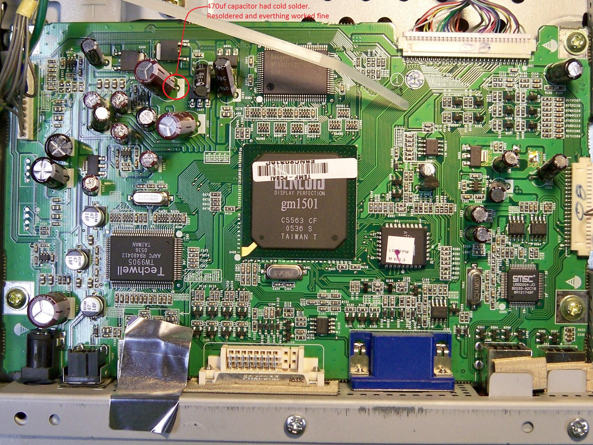

                Re: Dell 2005FPW monitor flashes red green blue and white full screens every two secs
                Problem Solved.
                One of the 470uf 16v capacitor had cold solder.
                Re-soldered and the monitor works fine.
                See attached image.
                  Well done - I think I would have probably replaced all the middle range caps as they appear to be samyoung samwha and the like.
