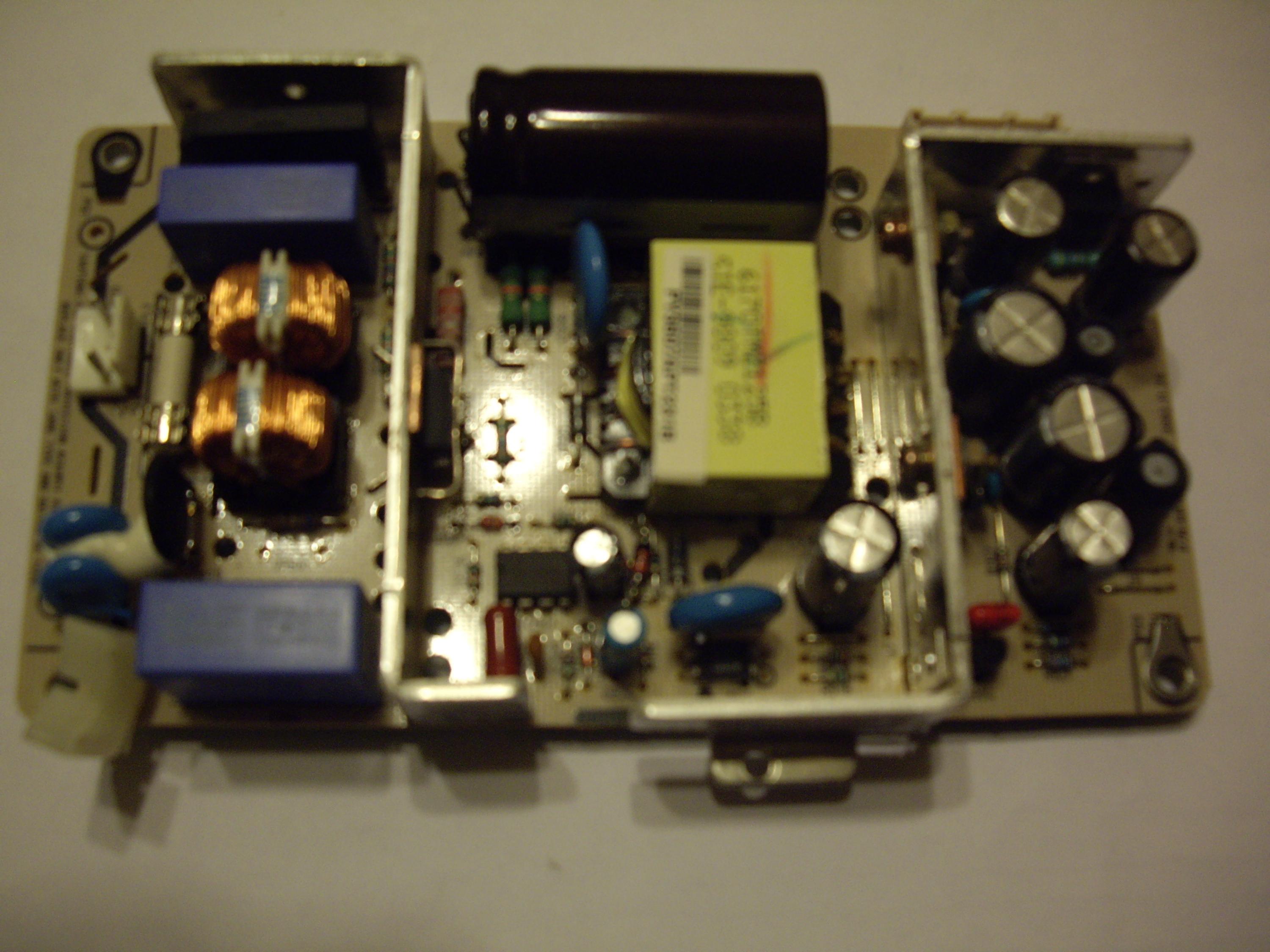

    Hello All,
    Does anyone here have a "FREE" service manual for a Sony SDM-S81R monitor?

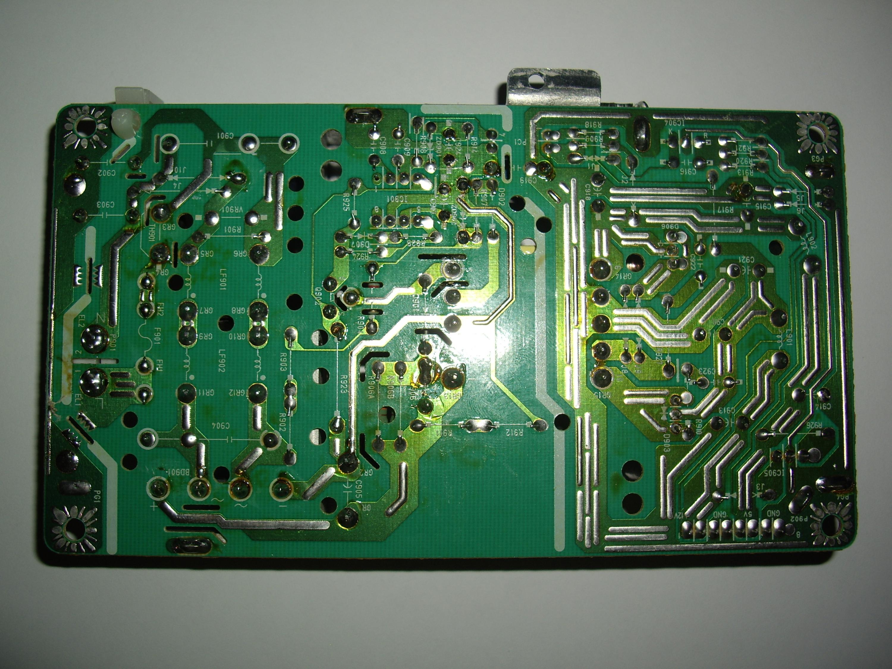

    Someone has already been inside this unit. And by the the looks of it,didn't know there ass from a hole in the ground. I'm including a stock photo of the board (identical to mine without being butchered). Any help or direction would be great!

    That looks like the same LG power supply used in a dell 1800fp.
      Re: Sony SDM-S81R Service Manual
      Sure does, check the VCC pin and Ground pin of that SMPS 8-PIN IC (P/N as printed on the IC?) to see if it has low resistance reading.

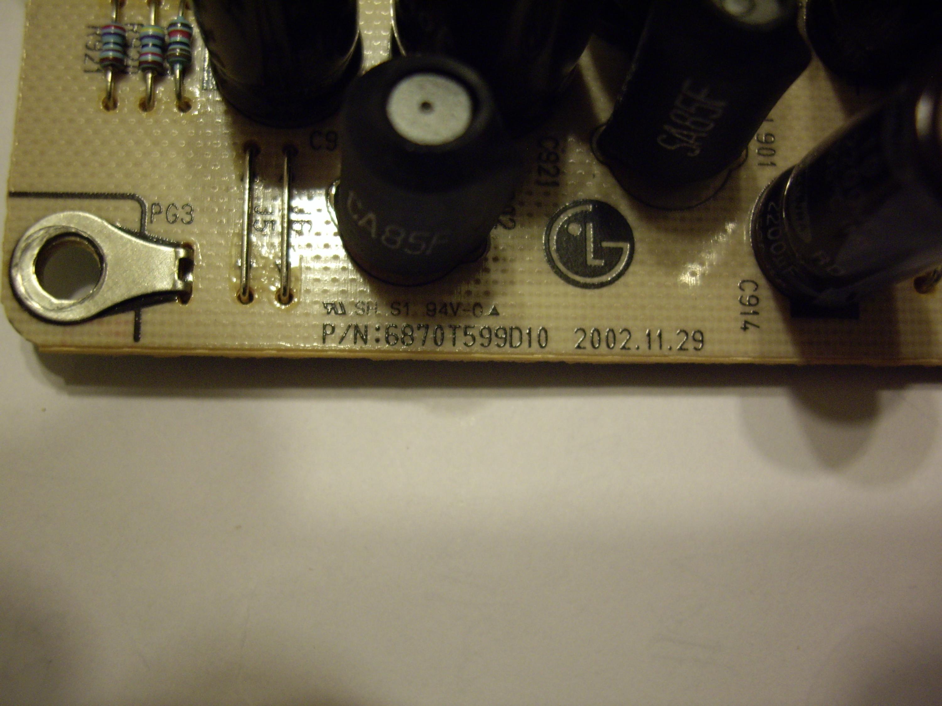

        Thanks for the information. I looked up a Dell 1800fp. And yes they look very similar aside from the AC outlet connection. There is a zener-diode ZD902 on my PCB. Whomever hacked into this monitor before jerry-rigged this diode. They cut the leads of the original part and soldered a replacement on the component side of the board. So the Dell board part values don't co-inside. Thats kind of why I need service manual/schematic for this board. Its a LG board. With a p/n : 6870T599D10

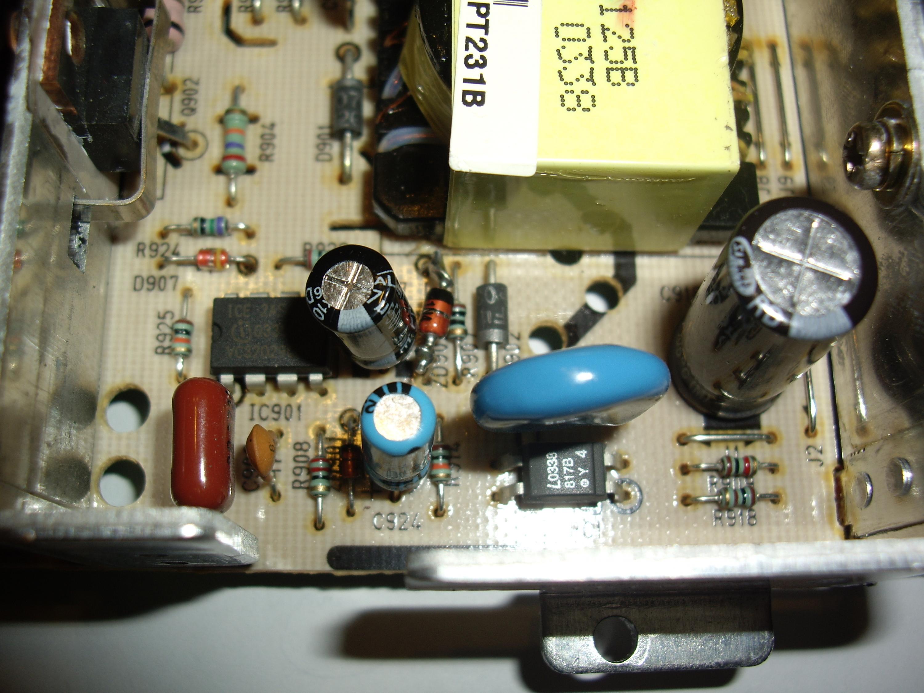

                      I don't get any DC voltage between VCC and ground pins of the IC when the monitor is attached to an AC outlet. That might be from the two small uf caps that the person before me replaced? There is a Mallory 47uf@50v and a XICON 33uf@25v. I don't know anything about Mallory but XICON is the kind of crap that Radio Shack sells. And they're not low esr caps! So from that, does that mean the IC needs to be replaced? And where would I source it through? I don't want to wait a month to get it from the orient. DigiKey's site says call no stock. As well as Jameco,Mouser.

                          I found .004VDC on that large cap on its side. Not good! So which MOSFET is the one you're referring to? Q902,D906,D903,IC905? I can't read all the part numbers without removing them. What about the Mallory and the XICON caps, could they be part of the problem?

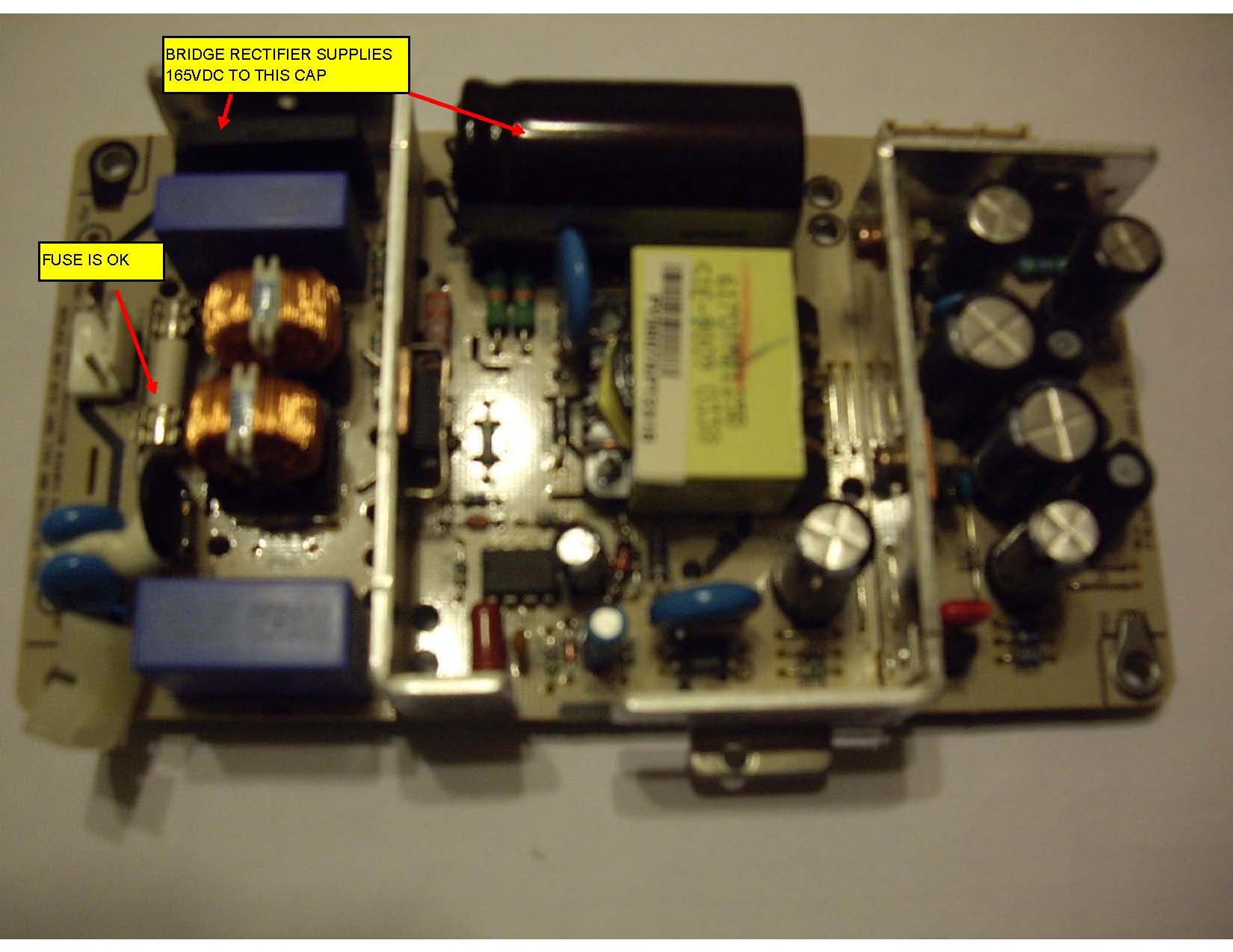

                            I did not ask from the beginning if you have already check the main fuse, right now it sounds like the bridge rectifier is not getting the AC, or the output of the rectifier does not reach the cap.
                            We need GOOD FOCUSED PICTURES of both sides of the board to be able to trace out the connections.

                              To honest with you I forgot to check the fuse as well. And its bad now that I checked it. I'm going to get a new one today, and try that. I'm gonna upload better pictures of my board as well.

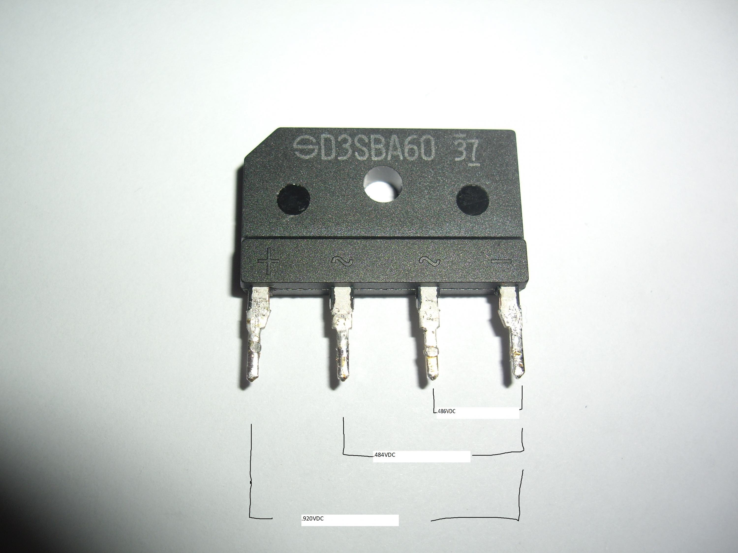

                                Check to see if the bridge is shorted, the MOSFET on that heat sink by the two blue caps.

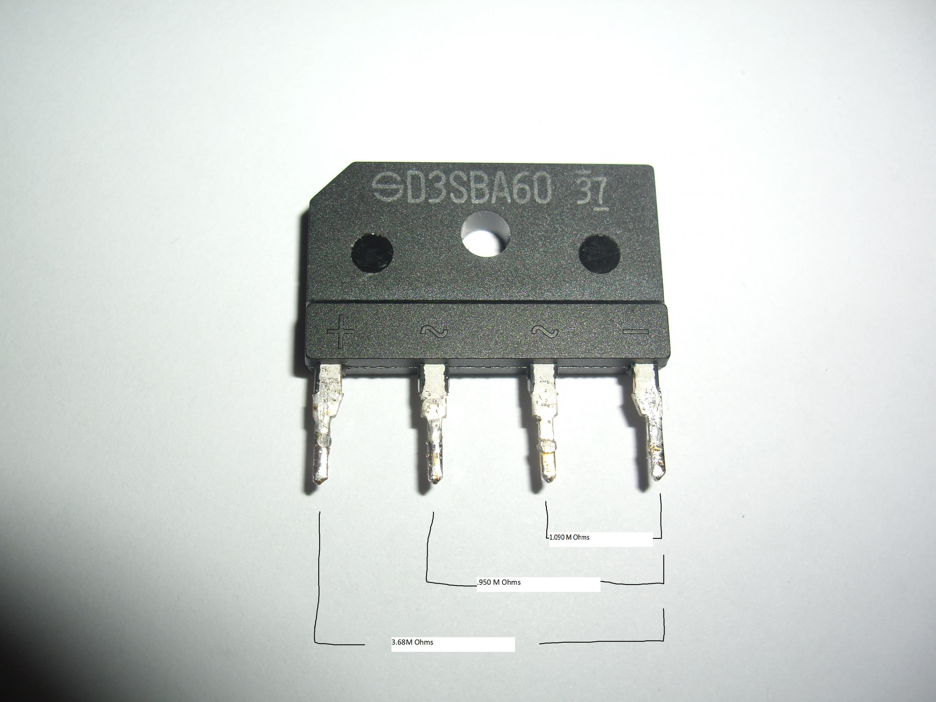

                                  I'm going to try to give some info on the bridge rectifier. Let me know if you can make it out all right.
                                  Thanks,
                                  lcdman
                                    OK, there is no dead shorts on the bridge. Now put the meter at the two solder pads on the board where the two outer pins of the bridge are connected to and see what resistance you are getting.
