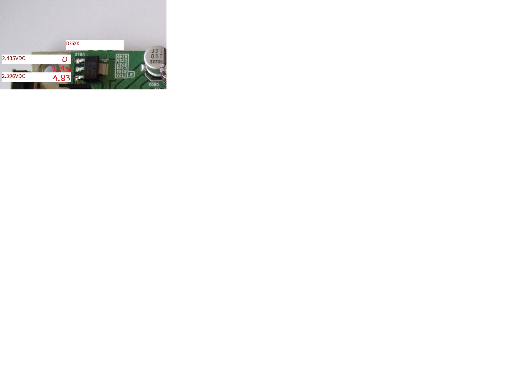

      I'm learning alot on this project. Sorry for not completely understanding before. Ok here we go again, on the outside leg I got 0VDC. The middle leg gave me 2.432VDC. And the last leg gave me 4.83VDC. So now does that give the correct info you were asking for? Does this part need to be replaced with the caps on this board? Where would the best place to get this part?

        That input pin of 4.83 sounds kind of low, I would expect to be 5V, for the output of 2.432V I am not sure if it is 2.5V regulator or lower or higher voltage.
        I cannot read the printing on the part, can you see the numbers on it? It seems to be fixed voltage regulator. D6XX does not sound right.

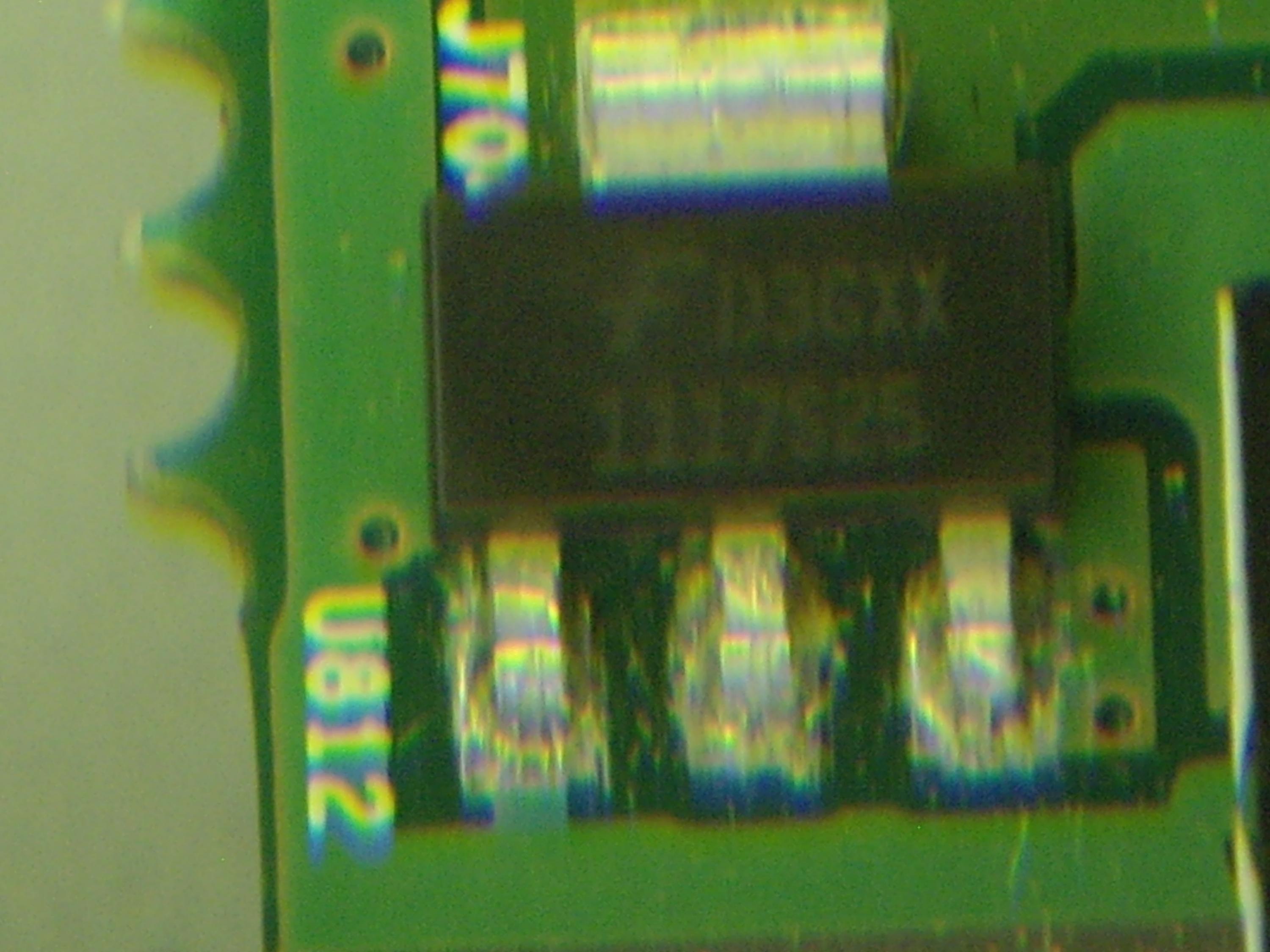

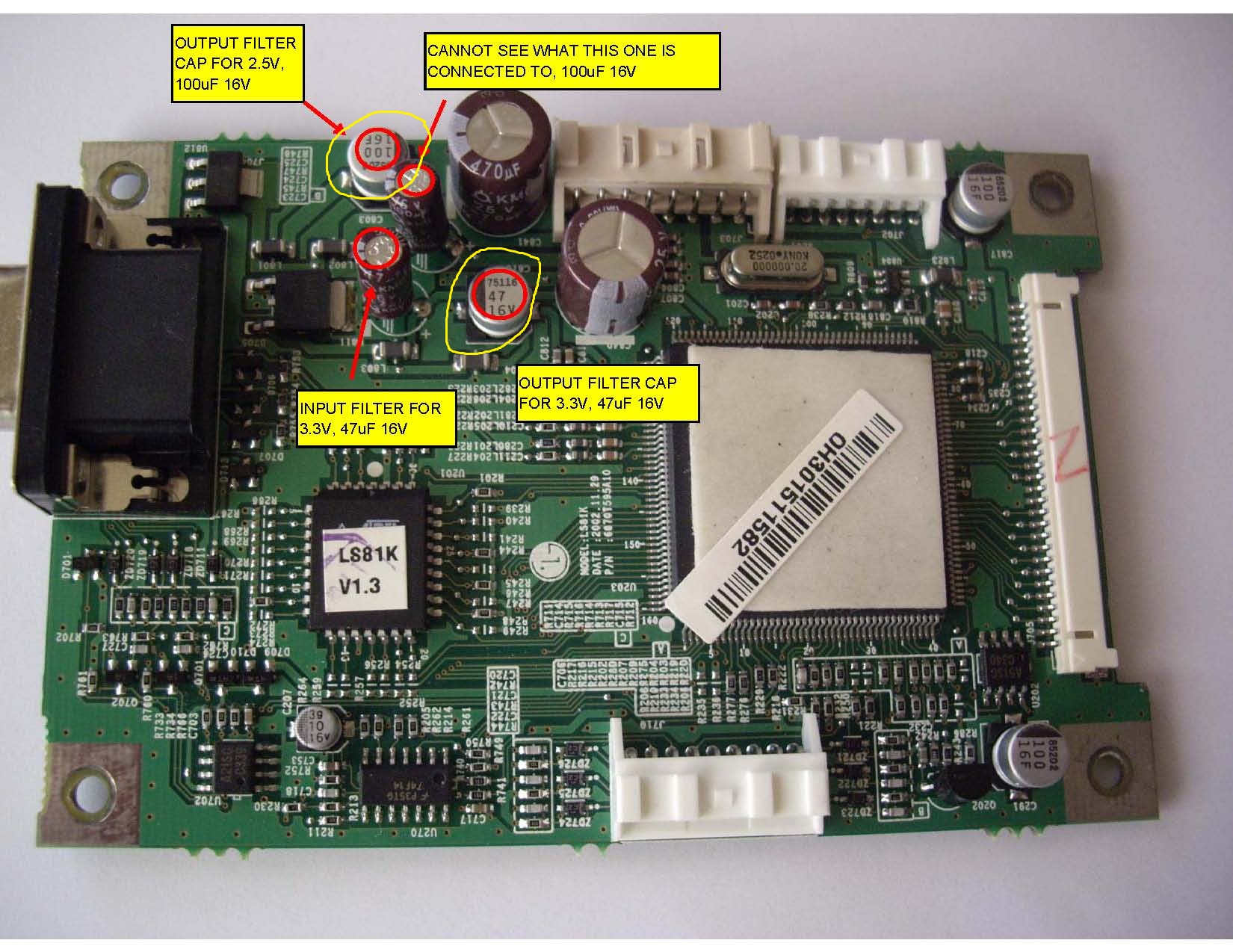

          The numbers on the part are F D3GXX and 1117S25
          I'm including a slightly blurred picture I took through my magnifier work bench light. The F is on an angle. Maybe a Fairchild part#? Those little parts are hard to take good pictures of!

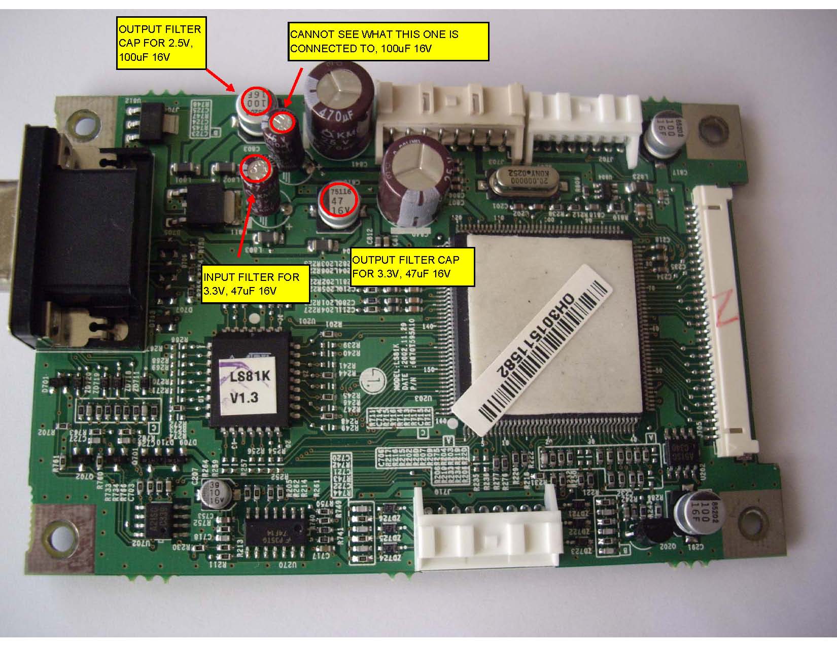

            OK, the 1117S25 is 1117 series LDO, 2.5V, right now it is more than 2% off, and the input voltage also does not look quite right, I have seen this problem before and it was due to bad filter caps for these two regulators. So try replacing the caps first.
            I would replace those caps, what I do with the surface mounted is I use through hole cap, cut the legs short and bend the end outward long enough to be able to solder on the old pads.
            I would also replace the two large one also, but try the little one first to see if the voltage will come back up.

              So I can replace those polymers with low-esr electrolytics? Is the colored area the negative connection on those caps? If so I'll try them first. I don't have 470uf 25v caps that are short in height so I'd have to order them along with the voltage regulator if it turns out to be shot.
              Thanks,
              lcdman
                #47
                Re: Sony SDM-S81R Service Manual
                Yes, low ESR. The two surface mounted caps, the black band on top is the negative. You can lay the cap side way if you have room.

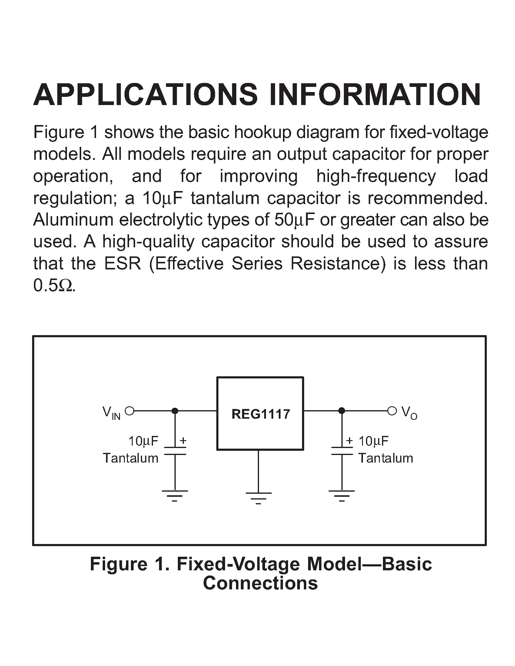

                  For an LDO, it is best NOT to use low-esr capacitors; just a good general purpose cap. ESR 0.5 ohms minimum, 5 ohms max, to ensure stability.

                      Some regulators (particularly CMOS using enhancement-mode PMOSFET pass transistor) are stable with ceramics which have nearly zero ESR. However, the 1117 uses a PNP pass transistor, so ESR is important for control loop stability. See diagram on page 11:
                      in particular, "Stability"; it appears at room temp the regulator is stable with ESRs from 0.01 ohm (really low) but as it warms up stability problems could become more evident. Output voltage also matters. These things have so many dependencies!

                        That 117 uses NPN pass transistor setup just like generic design with discrete components (op amp for comparator , ref voltage, etc) that has been around for decades, it just get put in to a small package. Onething is not very clear in the graph is that the stable region, it shows typical <20 Ohms but at the bottom left corner,not sure what they are tying to show, neither it show the graph of other lower ESR before it becomes unstable, Iknow this kind of circuit, too much capacitance at the output can cause Oscillation.

                          I go by what the manufacturer suggests. It appears that in the low ESR region the regulator is unstable by the graph, as well as the high ESR region.
                          LDOs are often unstable because you have an inverting feedback amplifier, contributing -180deg phase, but then an inverting pass element (i.e. -180deg), giving -360deg overall phase shift. Anything around 360deg is a recipe for oscillations, so the amplifier is compensated (don't ask me how - degree level stuff) but the compensation creates only limited windows of stability.

                                  Those caps (the ones I pointed out) are not polyester, they are electrolytics, if you have general purpose you can use them to see the result.
