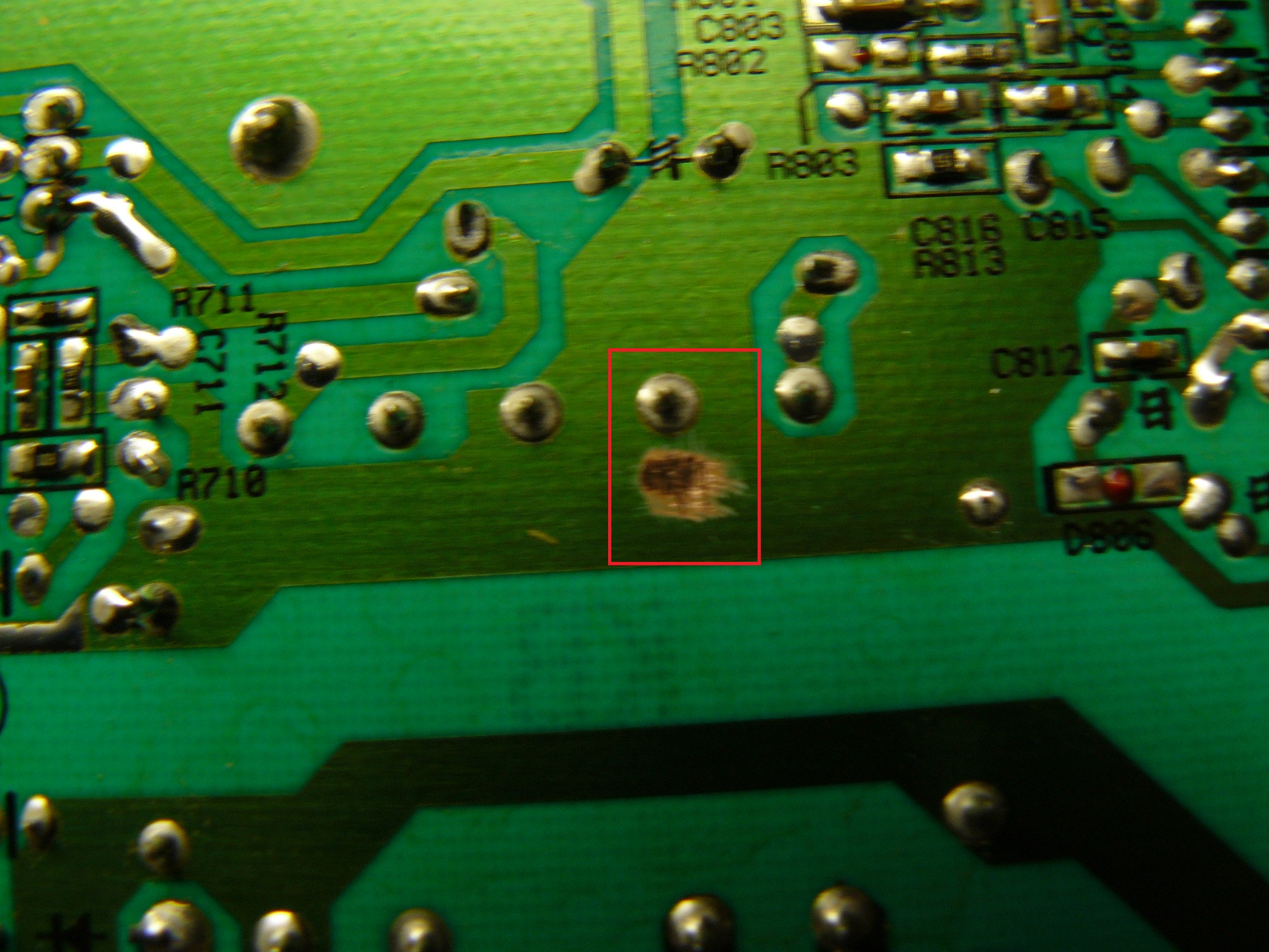

      Update: I think I found the problem. I regretfully do not own a multimeter so I can't get you those readings, retiredcaps. However, the 2.2uf capacitor (green in the picture) is loose from the board. The board is actually split in that area from trying to remove the old cap from the silicone/paste (whatever it is). I am not sure if this is even repairable at this point without just buying a new power supply. Thanks everyone for your help. I will go cry now while I try to find the Chinese Ebayer with the highest rating
        You can run a jumper cable from the cap to the next component that has continuity to it. You do need a multimeter though to verify which component you can run the jumper wire to.
        Something like this
        http://www.circuitrework.com/guides/6-1.shtml
          If you post good clear pictures of each side of the damage area we can
          suggest if it is repairable and how.

            Re: Samsung 216BW SyncMaster Monitor. Cap replacement didn't fix
            Oh, man. You guys don't want to see this haha. I surrendered and just started gobbing solder trying to get it to stick to the board. No luck. I sucked it all off for the picture. It's toasted.
            EDIT: Also, I had tried to stretch the cap lead to the next point as you can see.

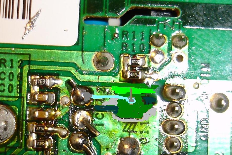

            • Mr Bill
              • Nov 2011
              • 648
              You have 2 options before getting another power supply.
              1)You can solder a wire from the caps leg to the point you were trying to strech the leg to.
              2)Take a razor blade, small screwdriver, something sharp and very delicately scape the trace to expose the copper and make a pad and solder to that.
                Hey. we usually like a "real" challenge.
                It still looks a bit messy - take the old cap out and remove as much solder as you can then with an old toothbrush or similar brush the are with some isopropyl alcohol, then post another picture. If you get a new cap it looks like the legs will be long enough to reach the next joint. If you want to use the old one then straighten the legs and put it back in securing it to the board with the good leg. Tin the bad leg. Get a wire and make a loop in it to fit over the leg and long enough to reach the next joint. Solder the loop to the leg, slide on a piece of insulation if required then solder the other end of the wire to the next joint.
                I think you should be aiming for something like the attached.
