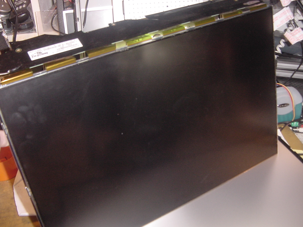

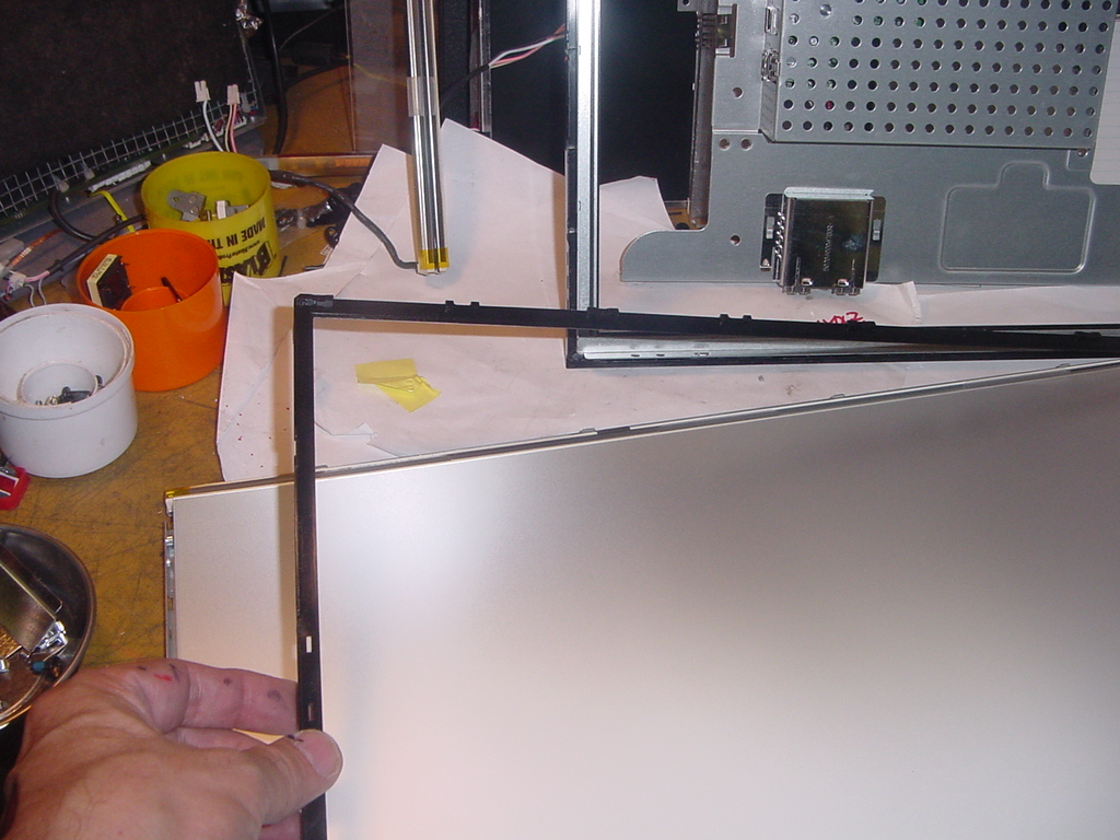

3 Dell 2208WFPF with bad lamp assemblies

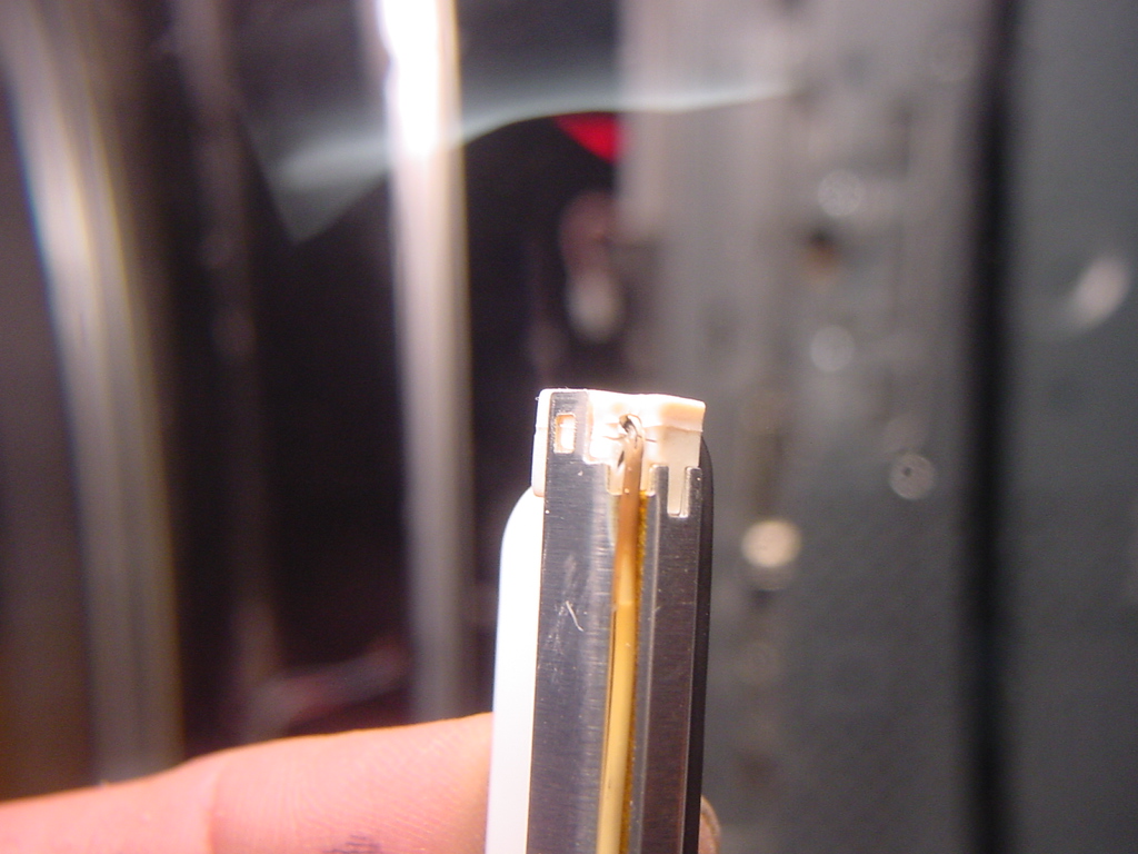

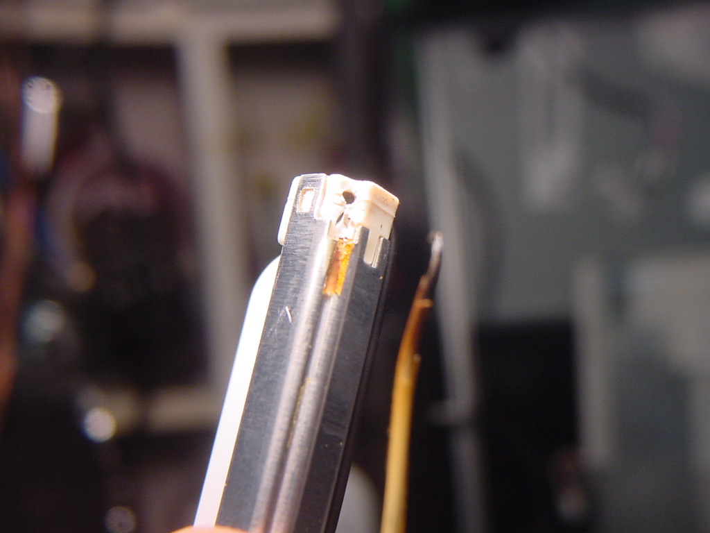

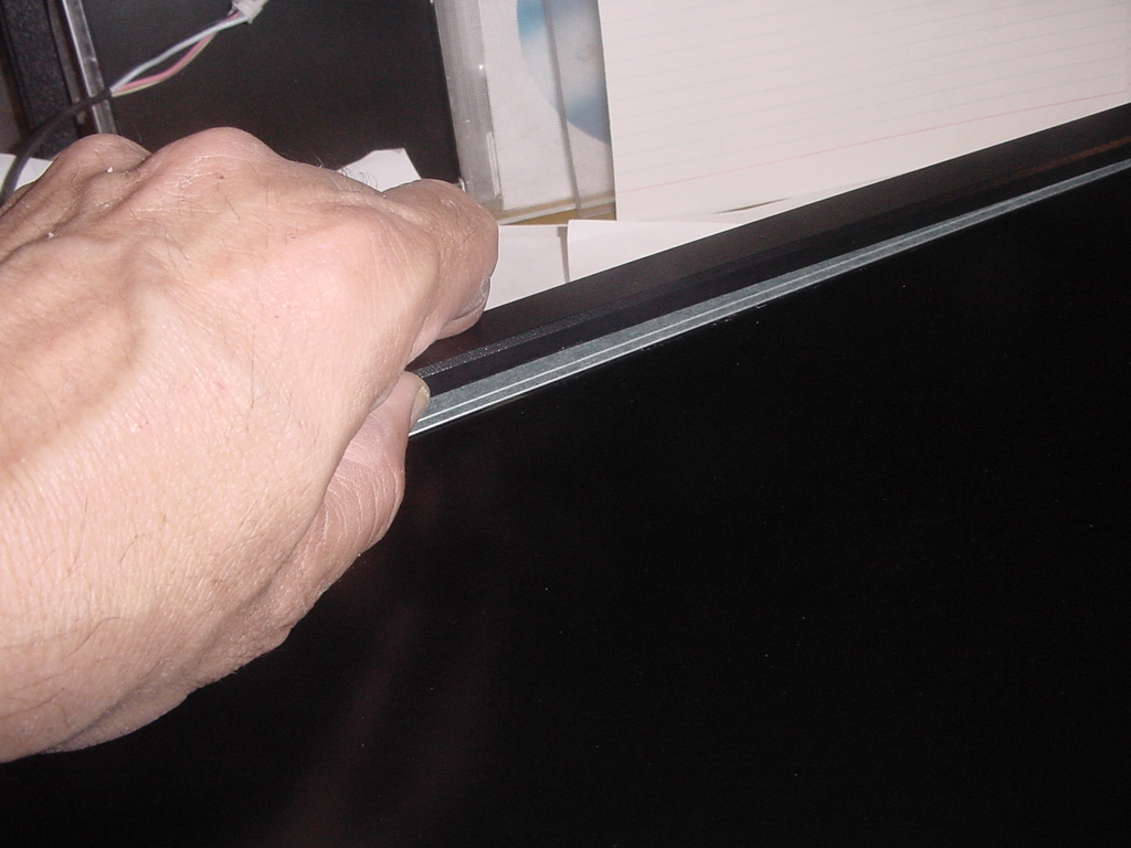

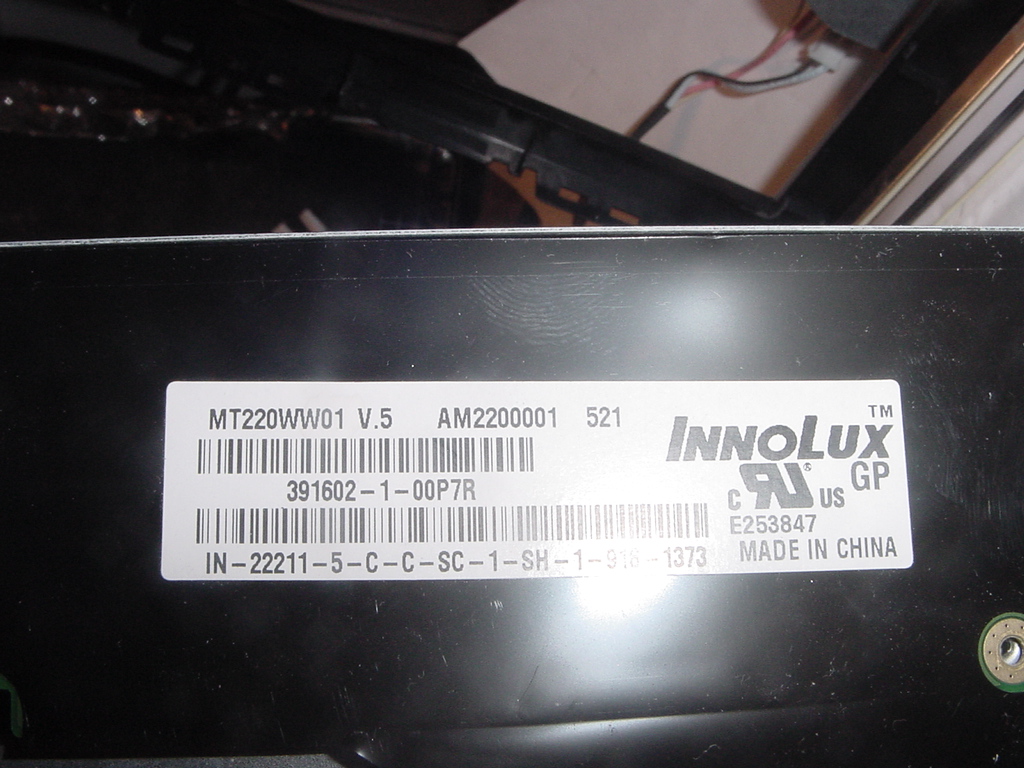

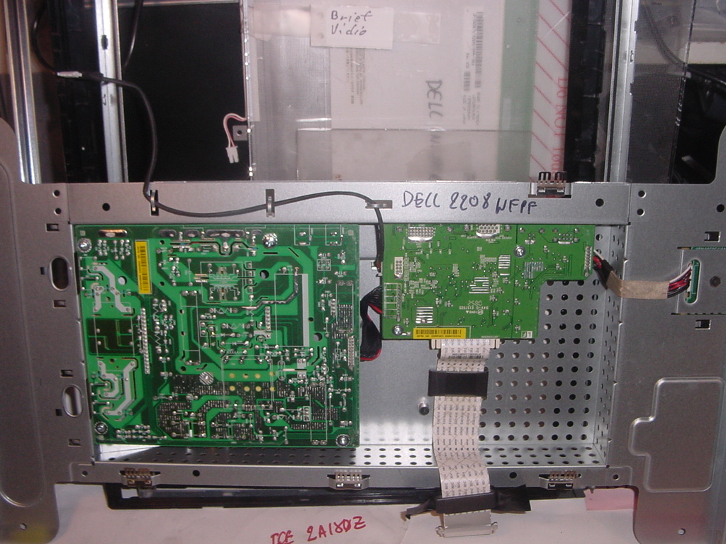

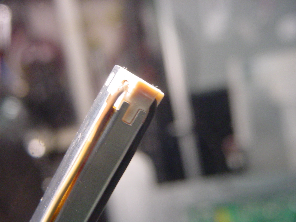

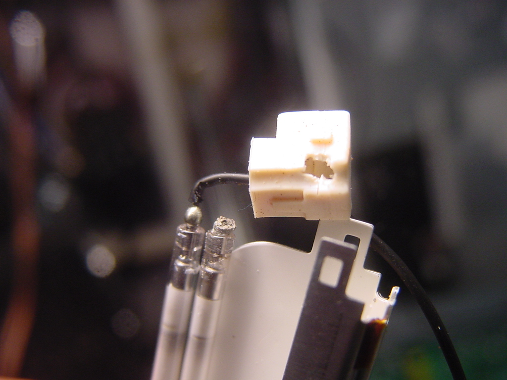

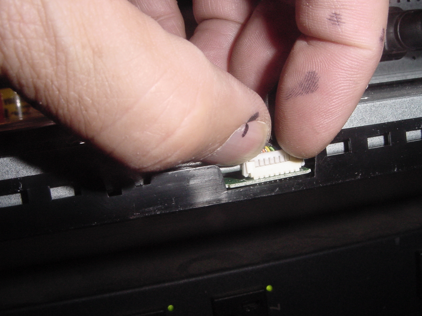

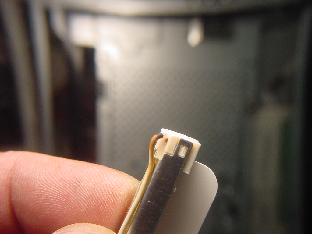

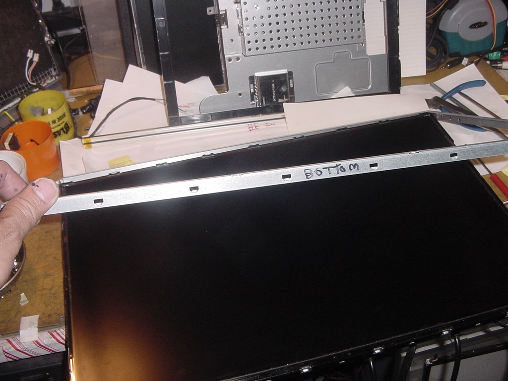

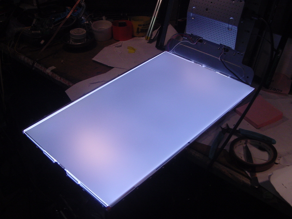

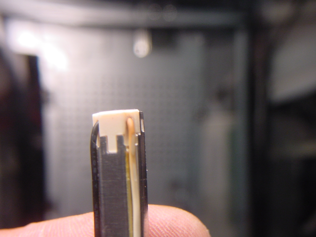

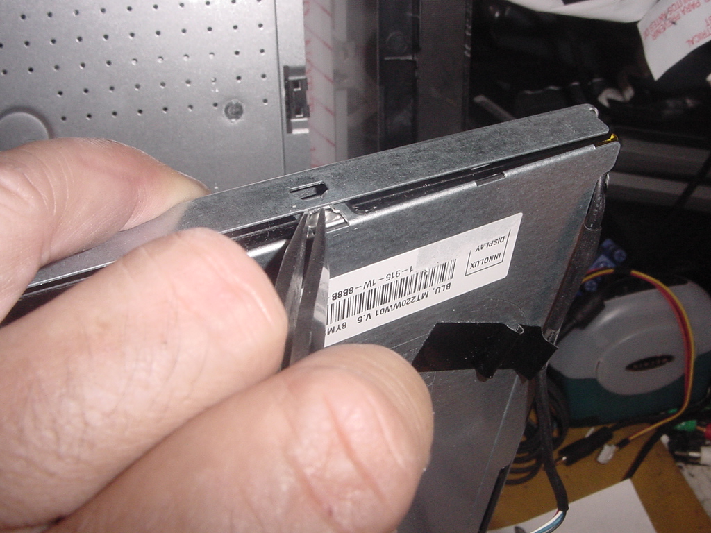

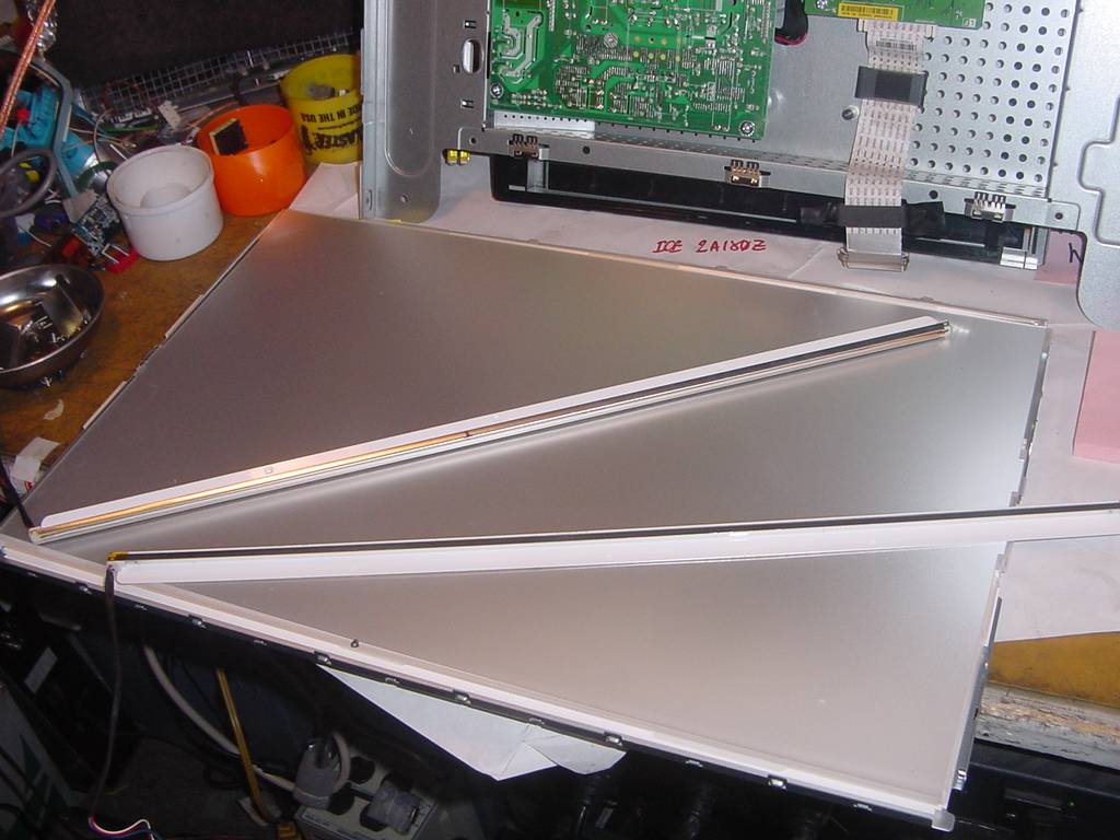

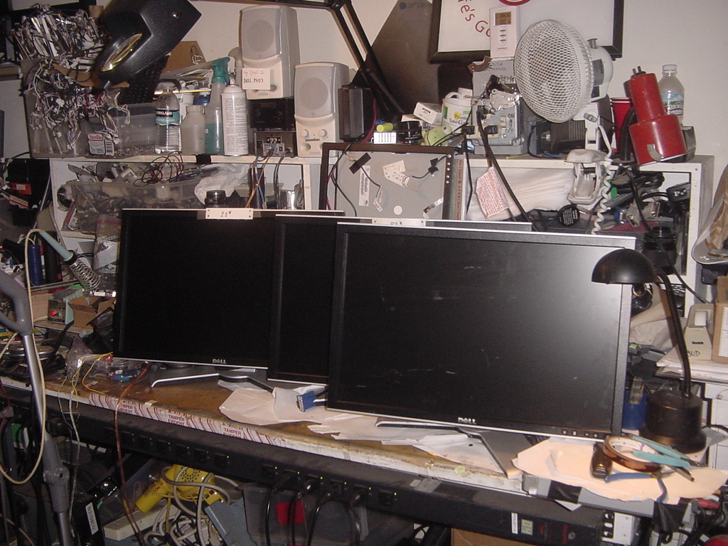

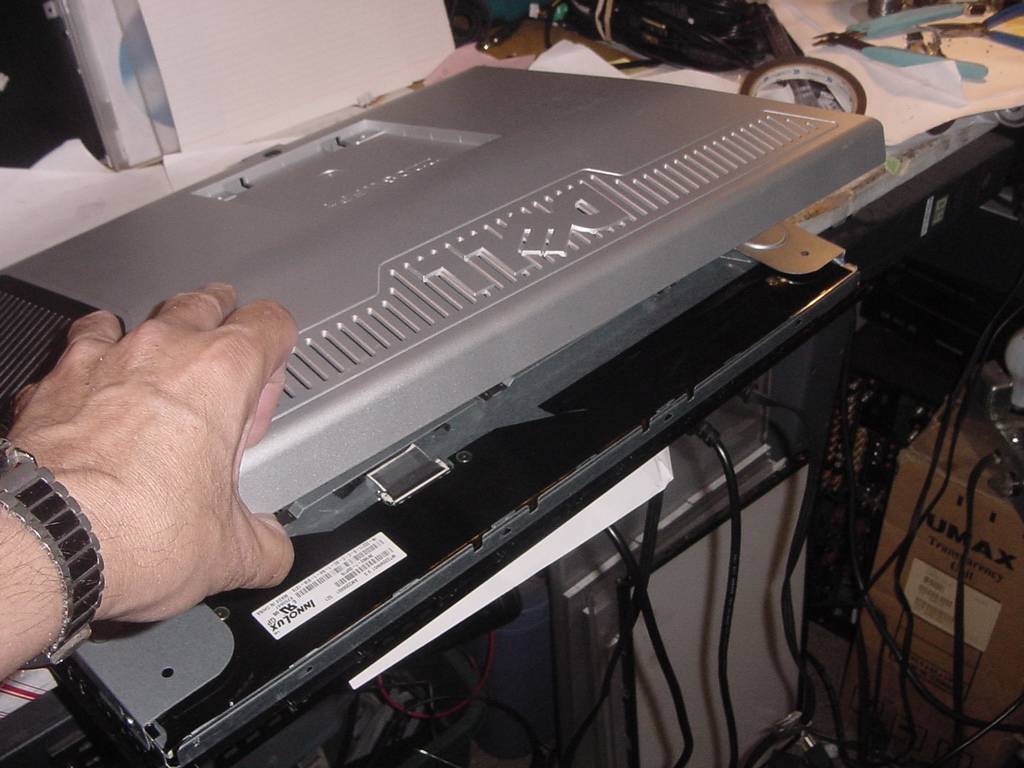

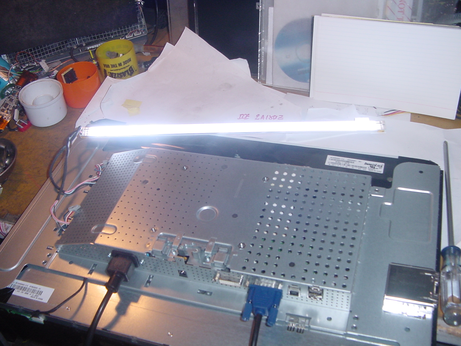

2-second to black, all three has bad wires at the lamp assemblies, all in one day I had to run in three of them with the same problem! very time consuming to repair all three today.Never stop learning

I have one of these monitors and it also had crispy wire connections as shown in your pictures. Out of curiosity, what causes that white wire to cook at that particular end of the CCFL? The caps in the inverter section of the power board looked OK (superficially), but I ended up recapping the board before disassembling the LCD module, just to see if that was the problem (crappy Leion and Su'scon caps anyway). -
Re: 3 Dell 2208WFPF with bad lamp assemblies
Poor solder connection, if you look real close, the solder is crystalized and hard as a rock, it generated lots of heat due to poor connection (poor contact resistance) so it gets hot and burn.
