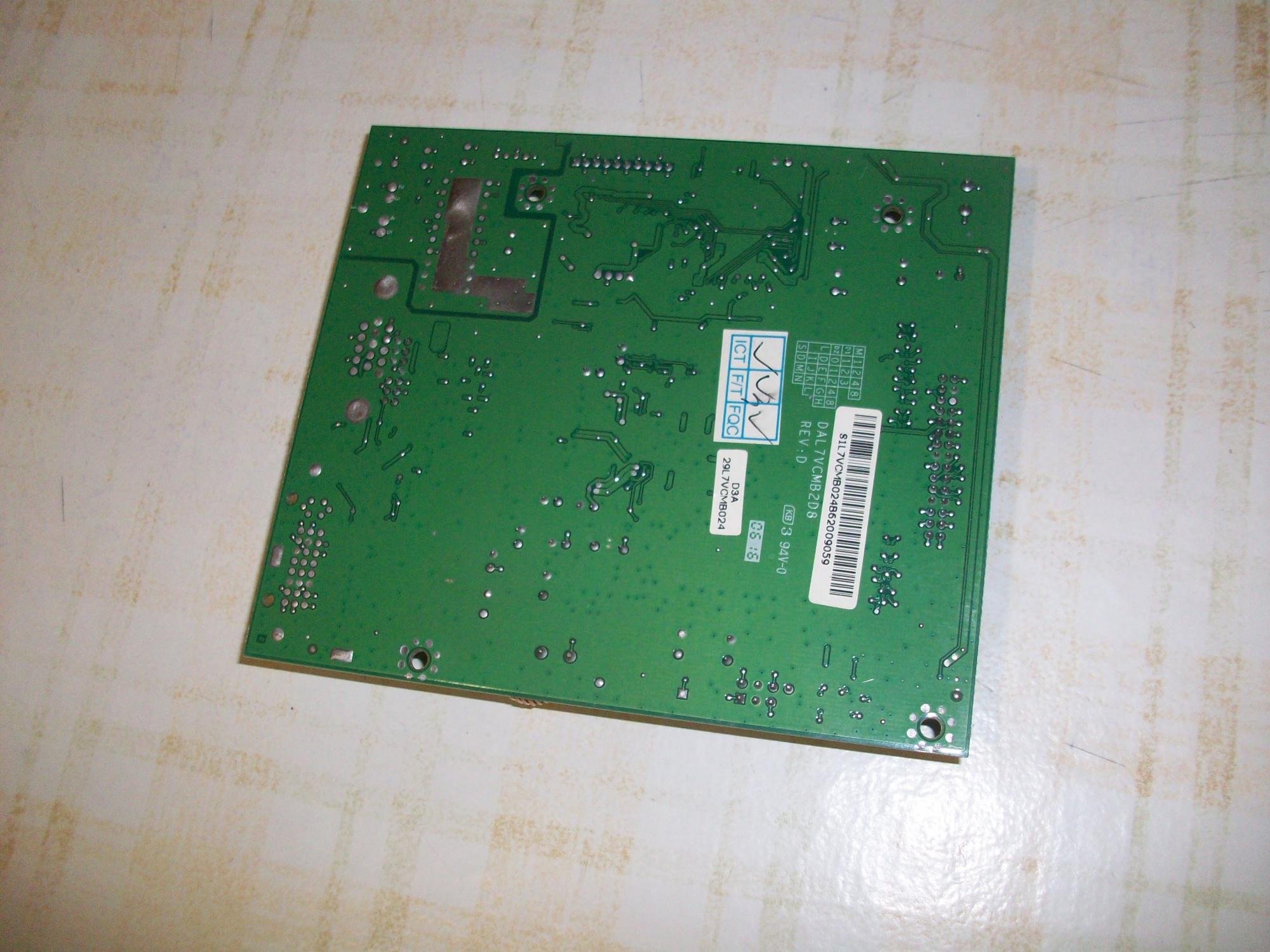

                      Better post a pic of the mainboard front and back and the board
                      on the back of the panel [if this model has one] take care in handling this.
                      Have you been able to retest the inverter transformers yet.

                        #31
                        Re: Viewsonic VE710b Power on black screen
                        Originally posted by selldoor
                        Well that is odd - it looks very much like this
                        Right inverter transformer:
                        P1-P2: continuity
                        P1-P3toP6: continuity
                        P2-P3, etc: continuity
                        P1-S1: 618
                        P1-S2: 822
                        P2-S1: 618
                        P2-S2: 822
                        Left inverter transformer:
                        P1-P2: continuity
                        P1-S1: 614
                        P1-S2: 818
                        P2-S1: 614
                        P2-S2: 818
                        Both have the same readings.
                        Here's two pics from the mainboard
