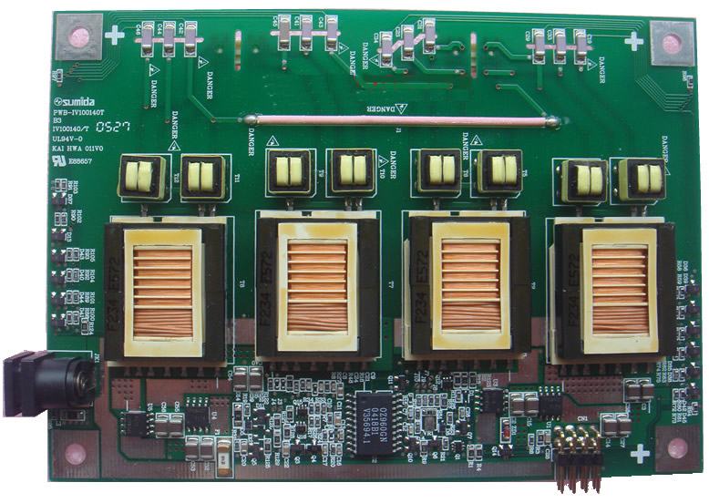

    Here's a picture of the top of the inverter board.
  • retiredcaps
    • Apr 2010
    • 9271
    Re: Westinghouse lcm-19v1 sl 2 Seconds to Black
    Is this a picture of your actual board or a stock photo?
      Right now, I don't have access to a camera, so It's a stock photo. I'll add actual pics sometime soon.

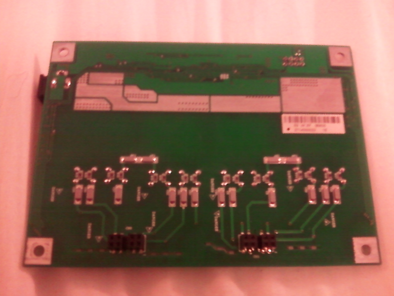

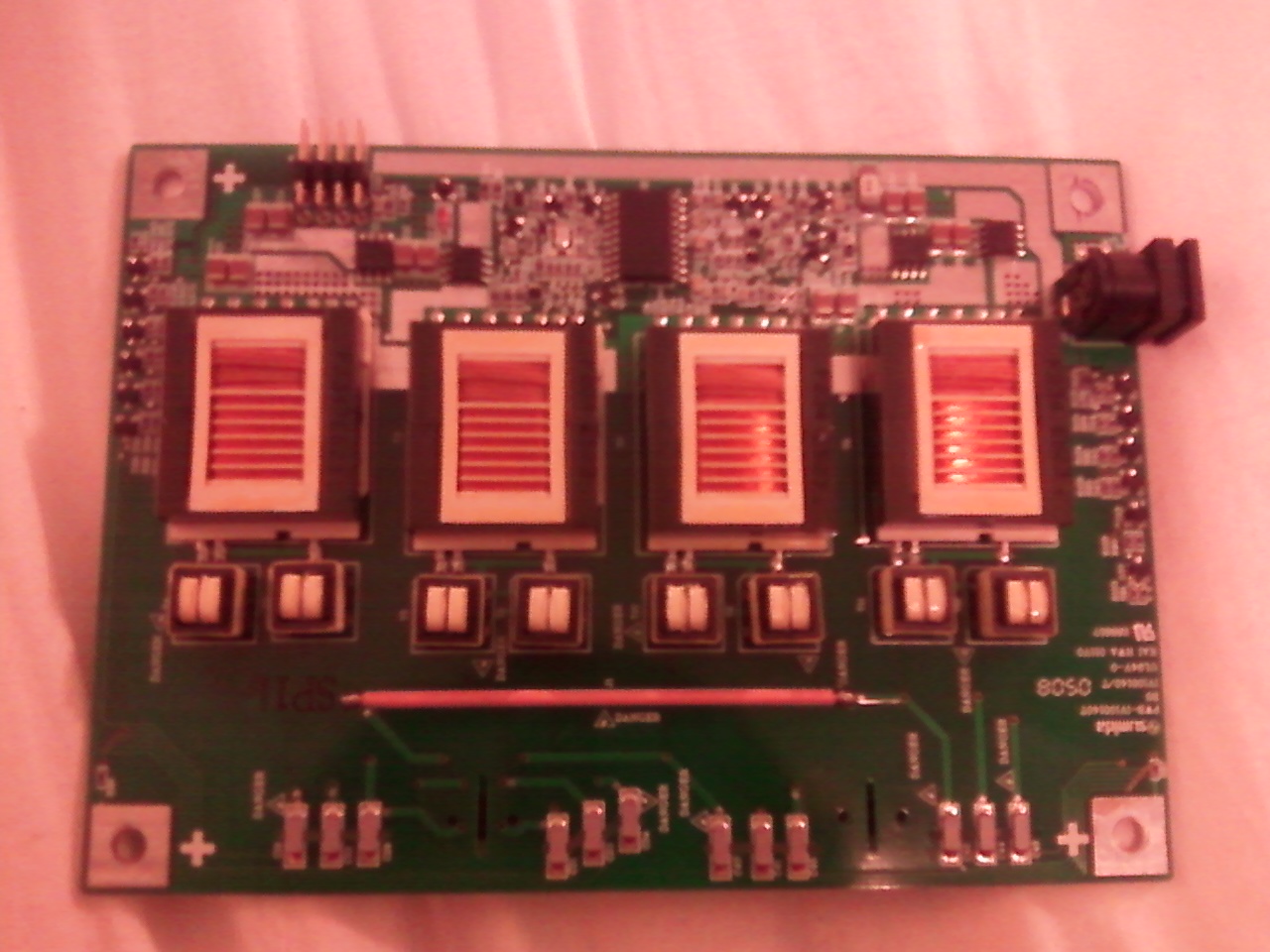

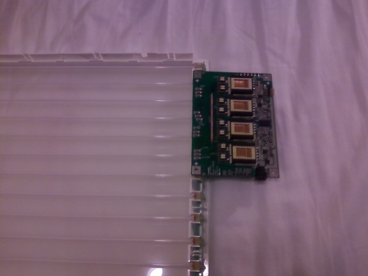

                  Here's a pic of both the top and bottom of the actual board. Sorry for the quality, I'll upload better photos soon.

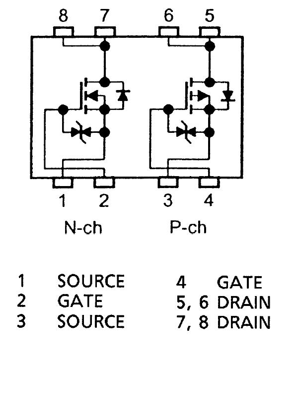

                    I believe the 8-pin devices,U1-U4?, are mosfets used to drive the inverter transformers. Check them for shorts. Look up the datasheet for these devices. With your meter set to 200 ohms, measure:
                    G--->D
                    G--->S
                    D--->S
                    • gregory121295
                      • Jun 2012
                      • 13
                      Yes, it turns out they are mosfets. U2, however, is 20 pins, and I can't find the datasheet for it. Should I test both channels, and how so? I can't seem to get a reading at all with my multimeter set to 200 ohms and my negative lead in com. The meter just says 1, as if nothing is connected.
                      Here's a schematic of the mosfet, TPC8401.
                      EDIT:
                      Rtech, did I test the right pins? Which pins are the secondary windings? Should my negative lead be in com or 10adc? I figured com, but I get a much higher reading when the lead is in 10adc.

                          Its not possible to identify the secondarys from the photos unfortunately,ALSO where do your lamps plug into ??there seems to be no connection for them on the board.Measuring resistance the Black(negative lead) goes to common on the meter.I assume you are taking measurements with the board disconnected and no power on ??
                          • Rtech
                            • Jul 2010
                            • 1095
                            Now that I have a cup of coffee,you are going to have to measure,the resistance as follows;-
                            Black lead to 'x',measure to every other pin.
                            Black lead to 'y', measure to every other pin.
                            Black lead to 'z', measure to every other pin.
                            Note down all the results and compare them, they should be very very close for every transformer,if not then you will have to investigate from there.

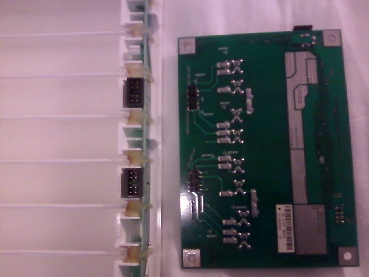

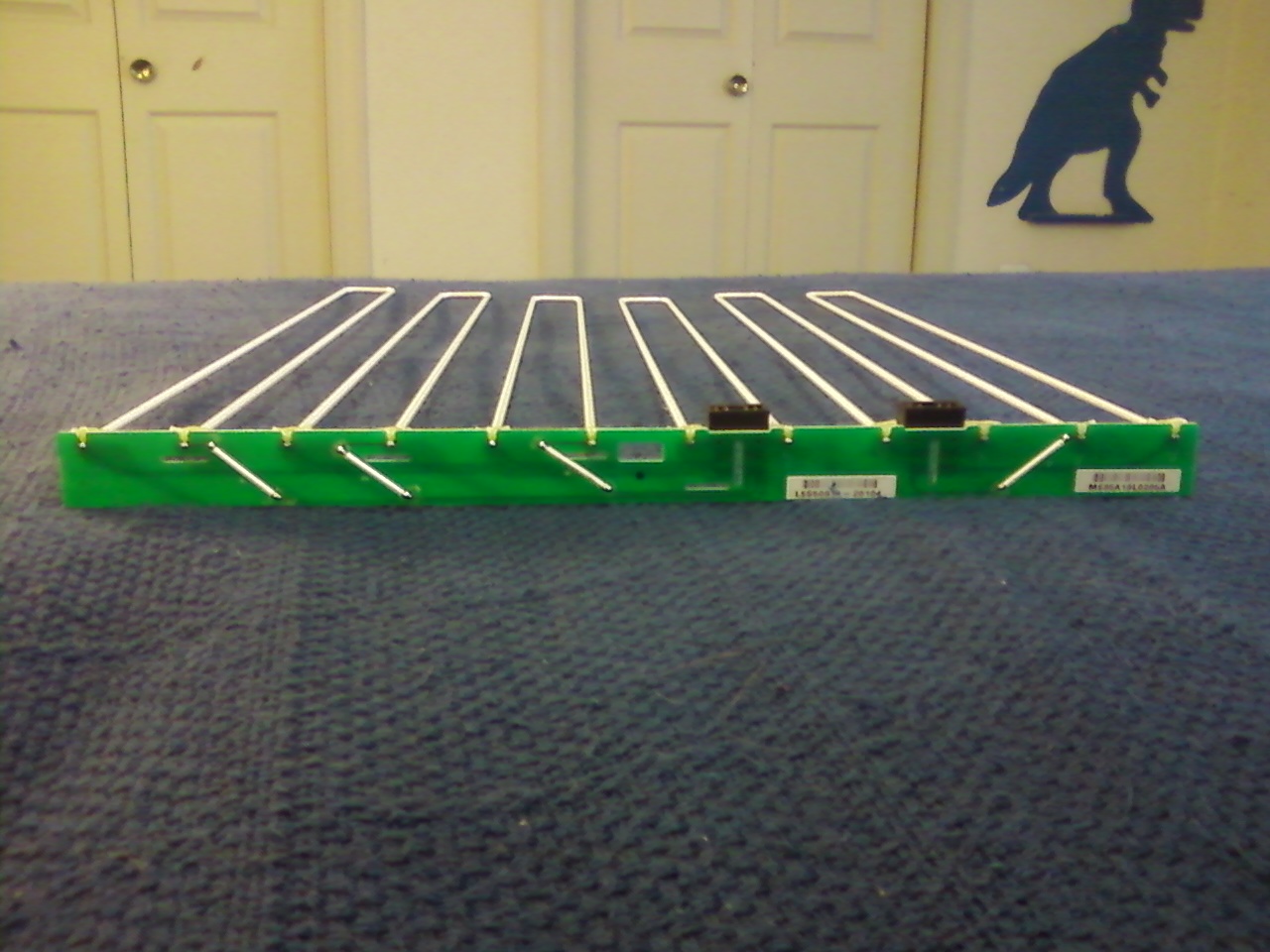

                              Rtech, the lamps plug into the black plugs on the bottom of the board, as shown in this photo.
                              yes, I have neg in com and am taking measurements with the circuit off.
                              • Rtech
                                • Jul 2010
                                • 1095

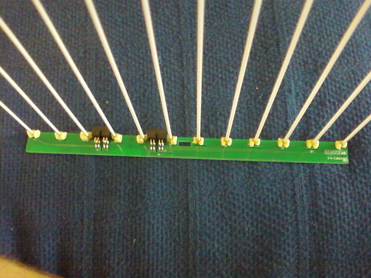

                                Well you learn constantly the Black plugs, I never even considered as plugs, what does the bit on the end of the Lamp cable look like ??first time I have seen these !!! Lets know what the tfmrs read.
                                • gregory121295
                                  • Jun 2012
                                  • 13
                                  Here's pics of how the lights plug in. Working on readings from the xfmrs now.

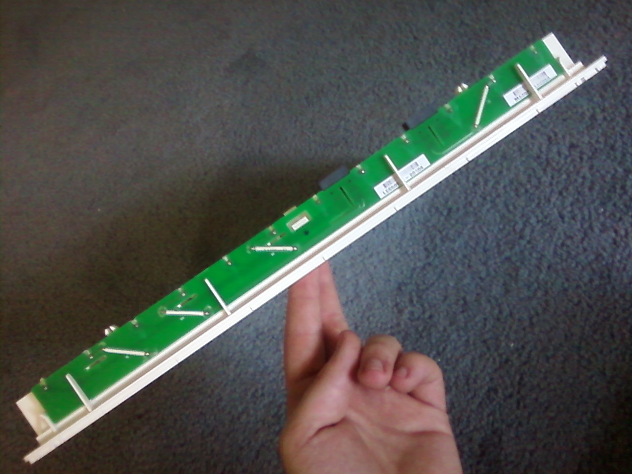

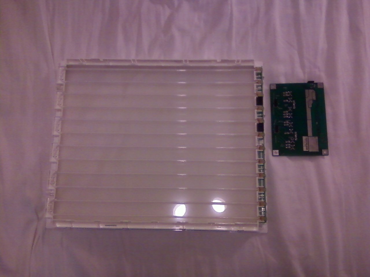

                                      Can I see closed up pictures of the left side of the lamp assembly? I want to see how the end of the lamps are connected.
                                      And by the way, none of the lamps flash for a second?
                                      • gregory121295
                                        • Jun 2012
                                        • 13
                                        When I start the monitor, only RIGHT after i plug in the power to the wall the lamps kind of flicker on for a second or two. Rather than explain it, here's a video of it.
                                        http://youtu.be/Bnc4FkGyy2w
                                        EDIT: I managed to remove the light assembly. here's a picture of both sides of the circuit board.
