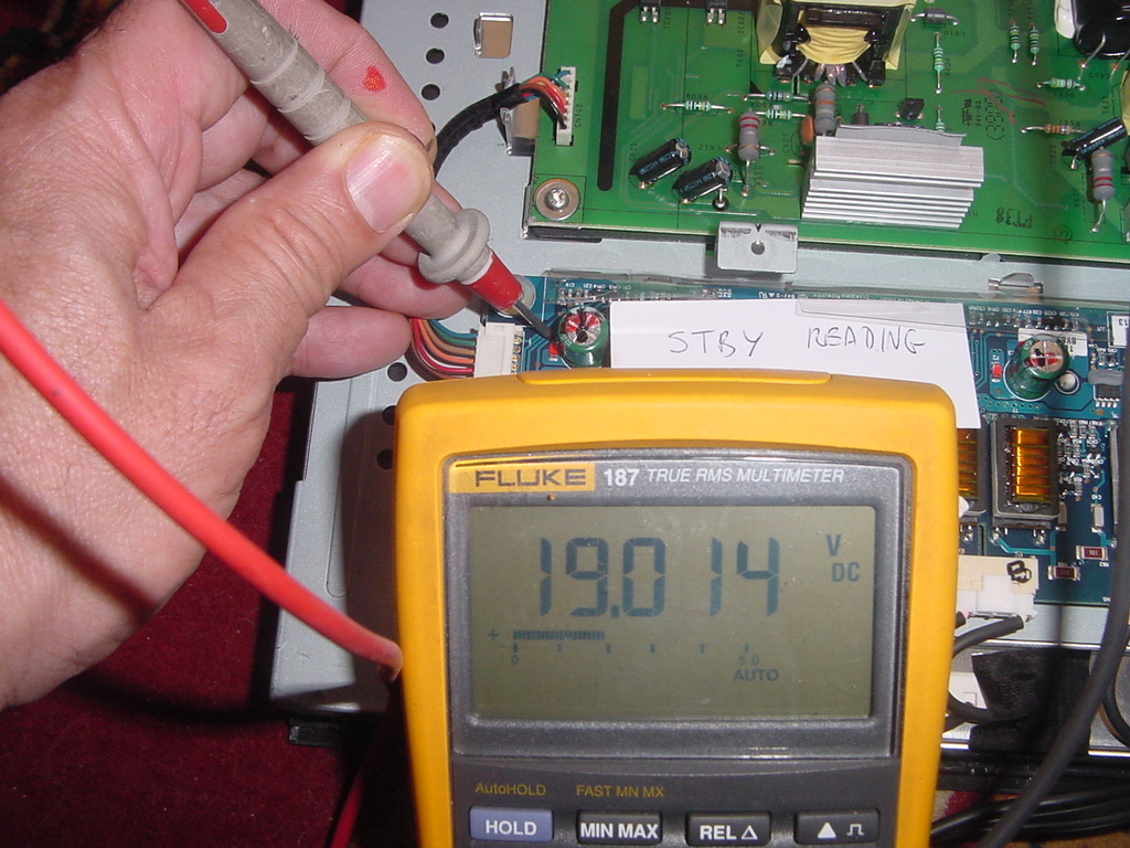

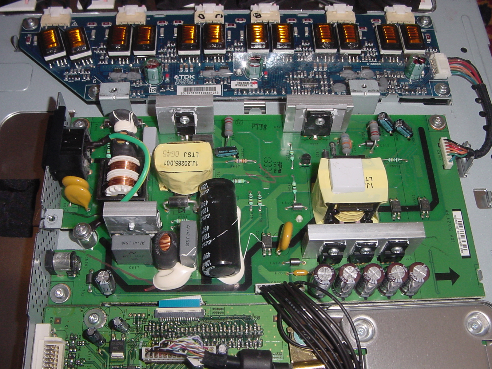

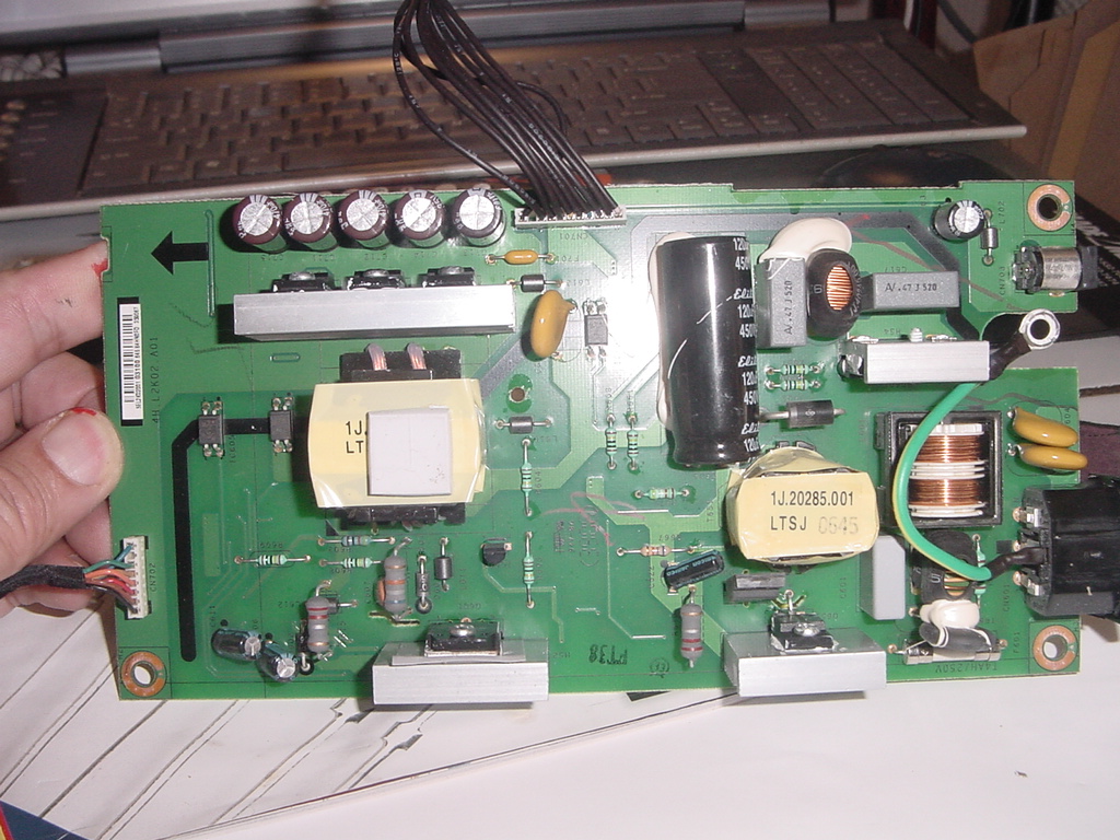

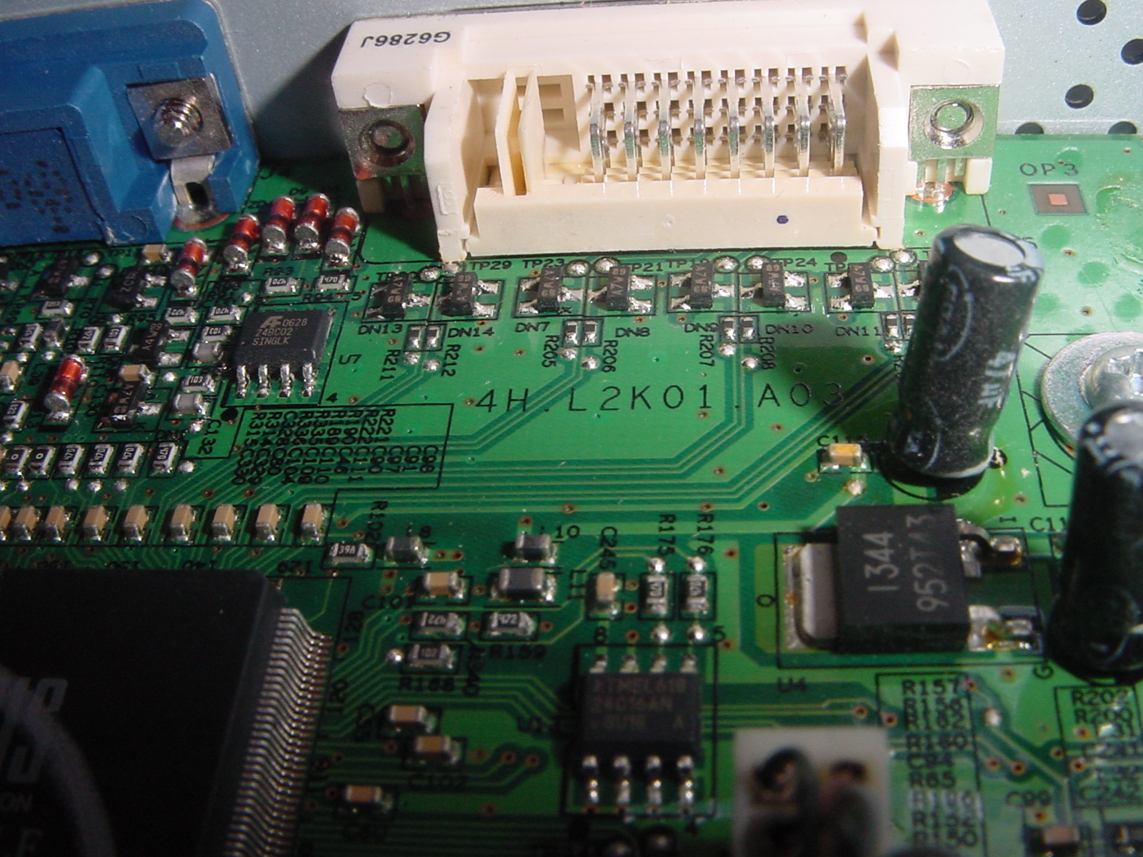

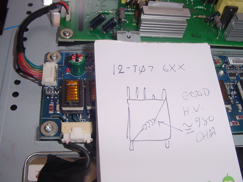

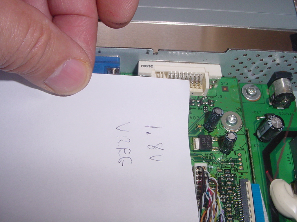

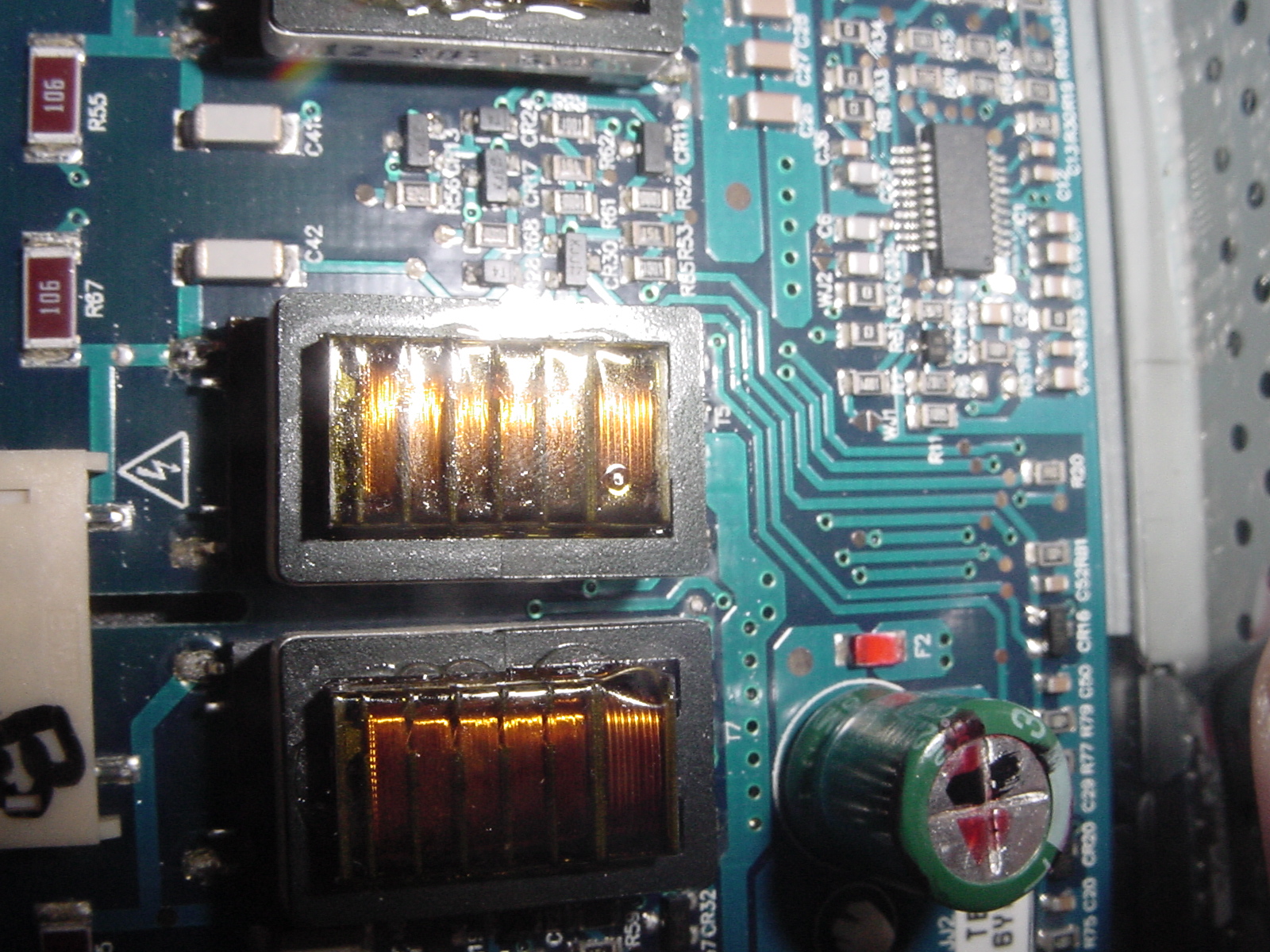

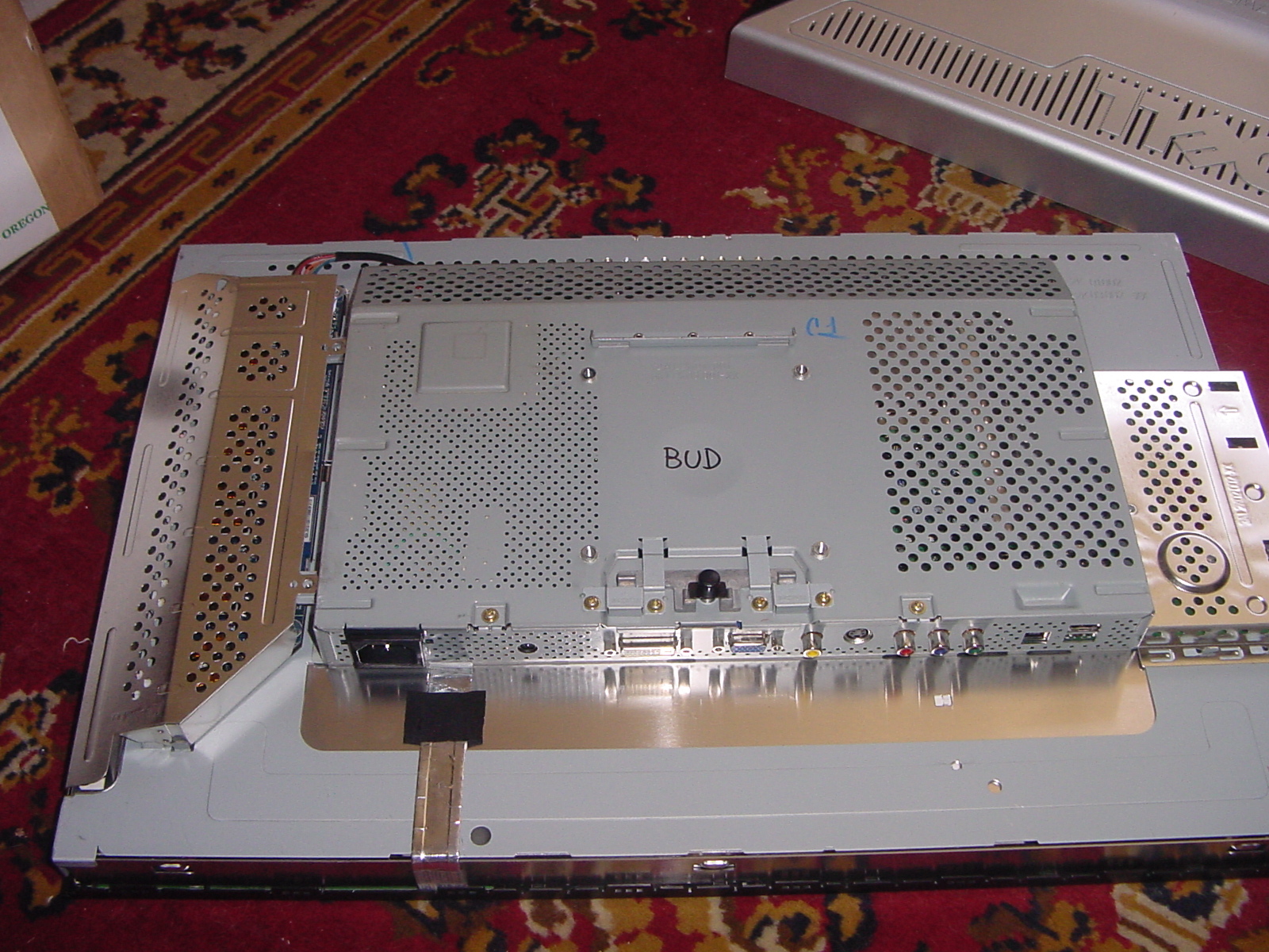

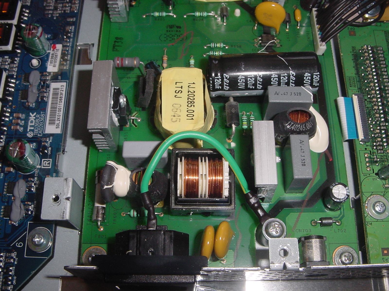

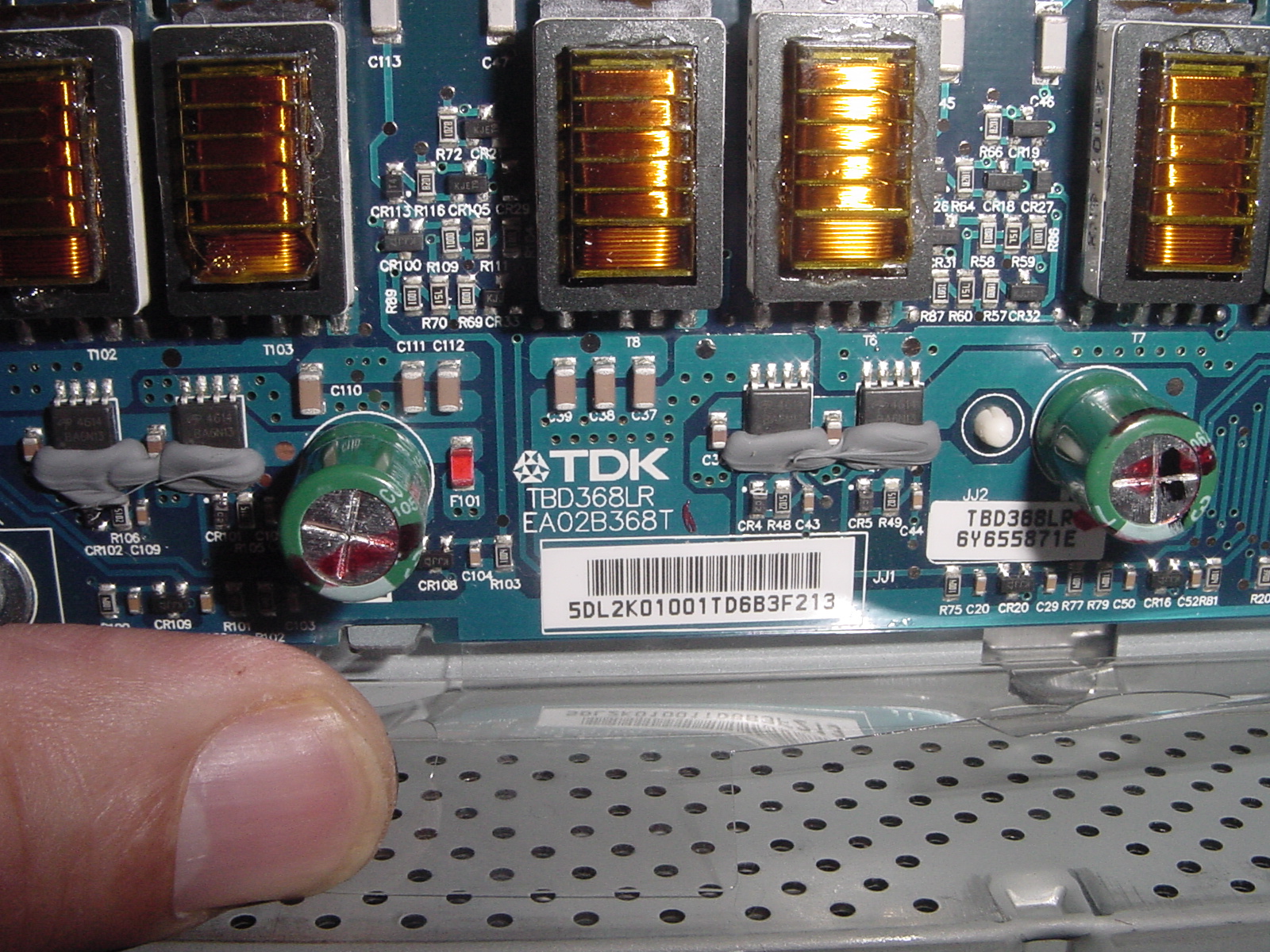

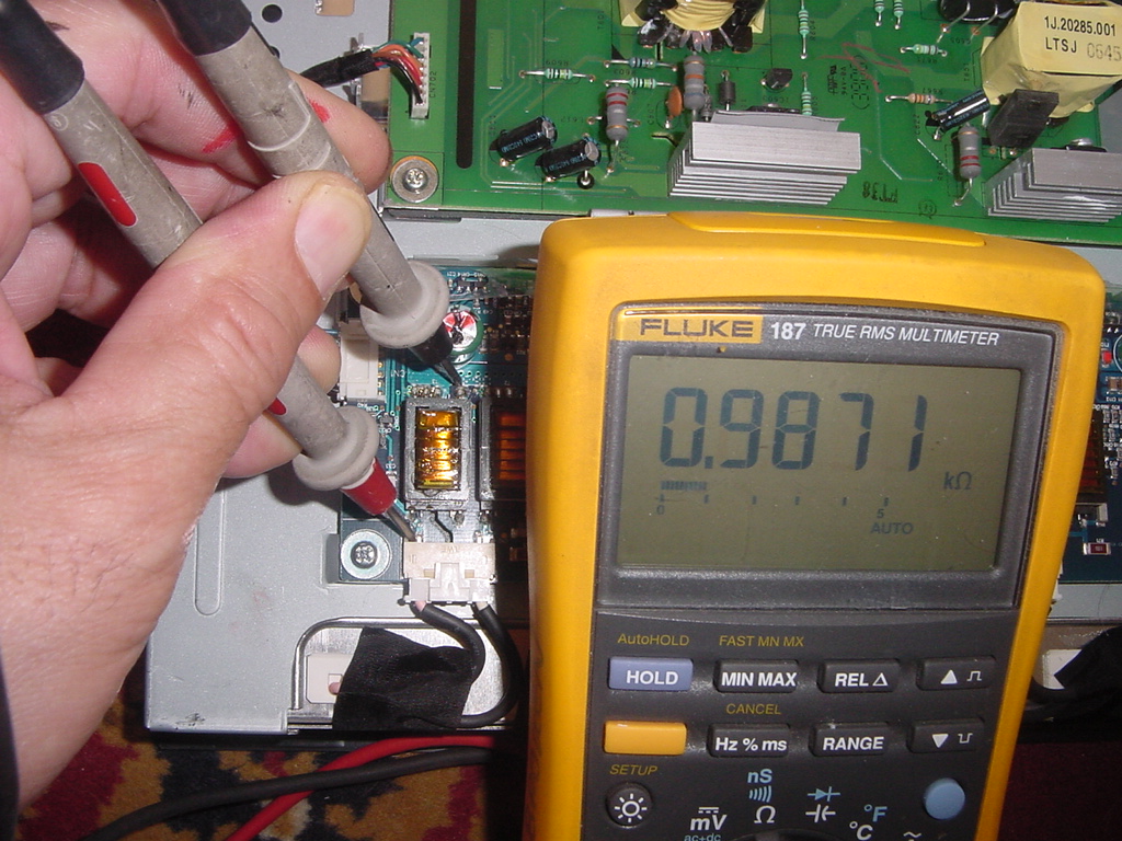

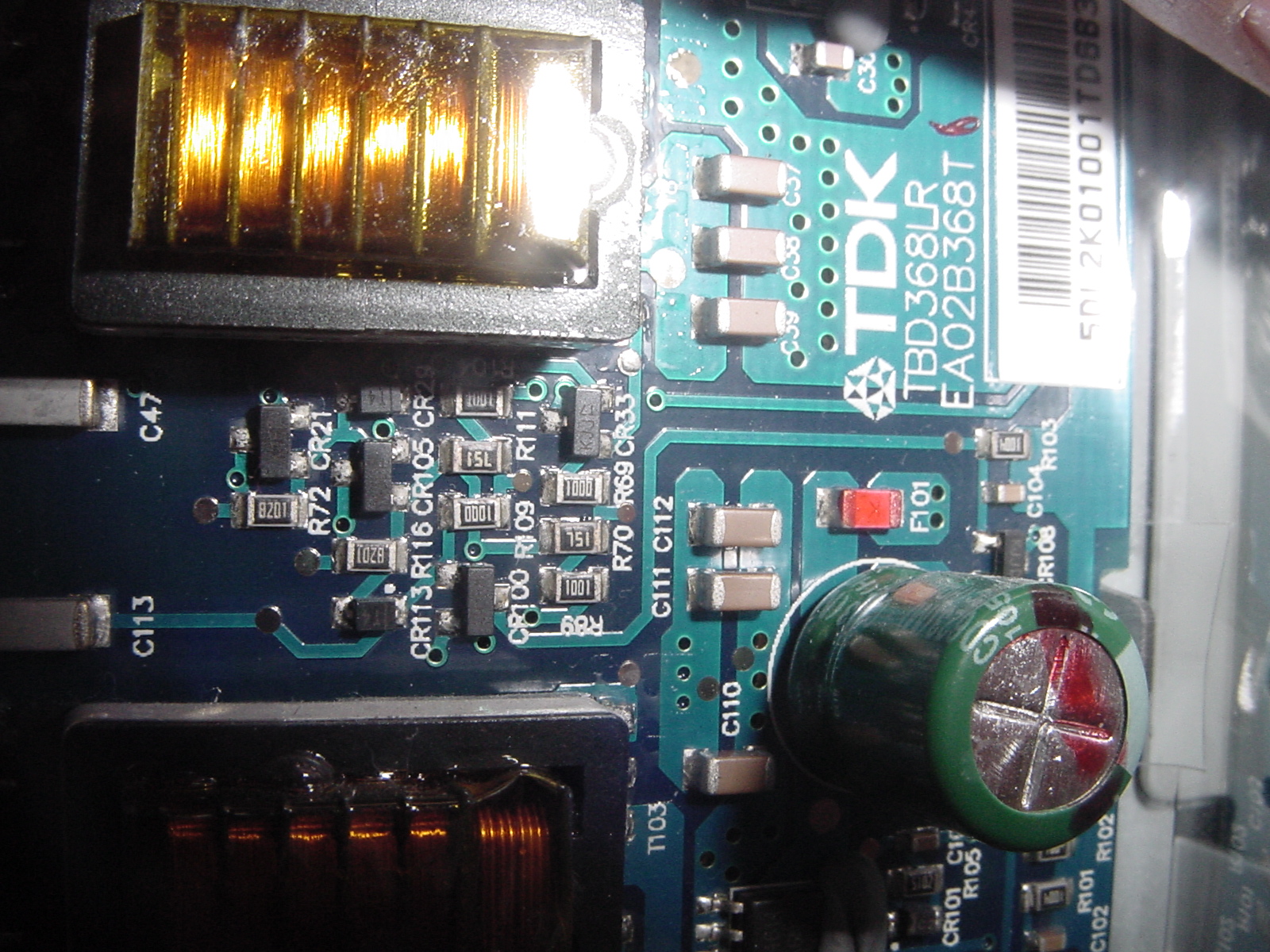

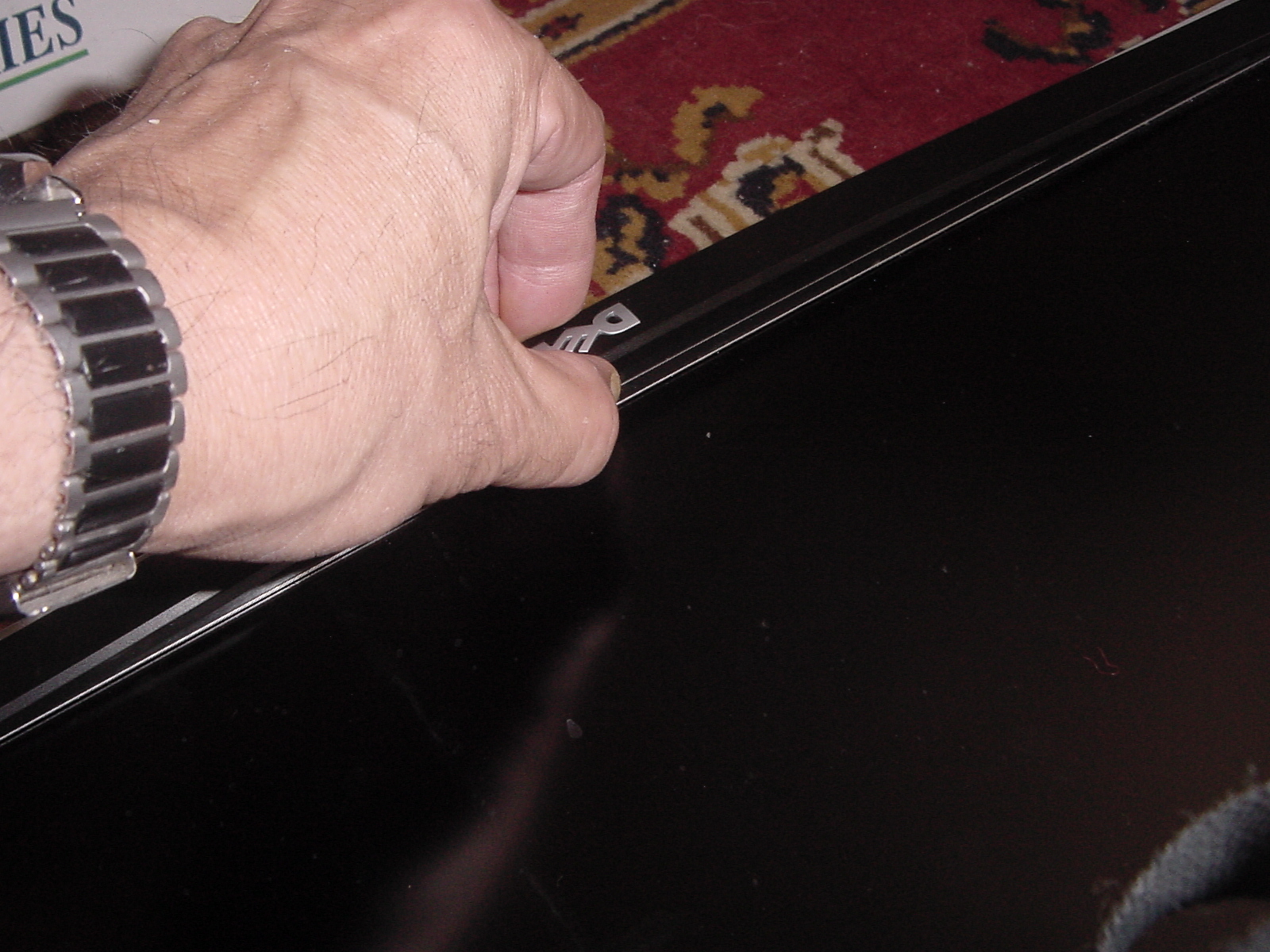

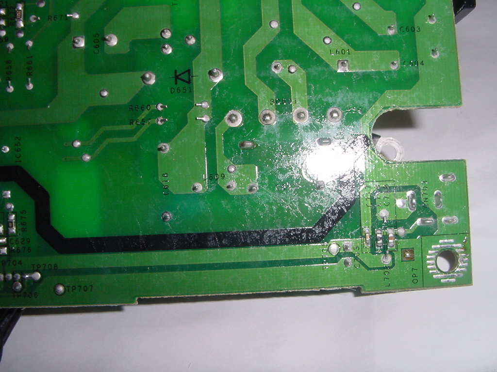

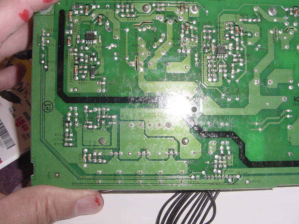

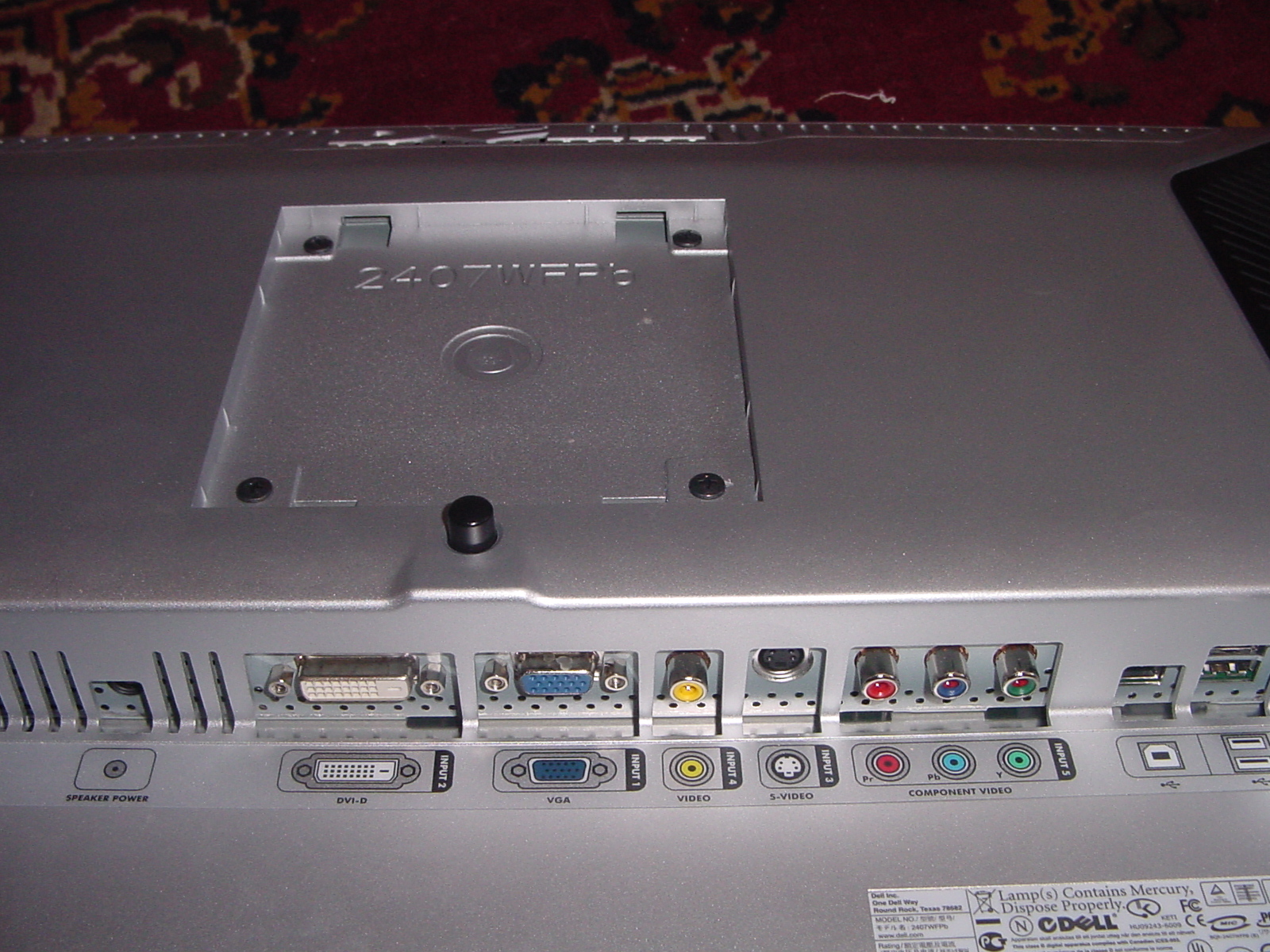

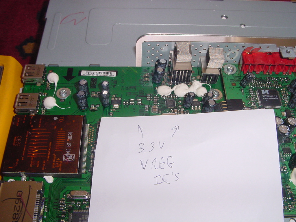

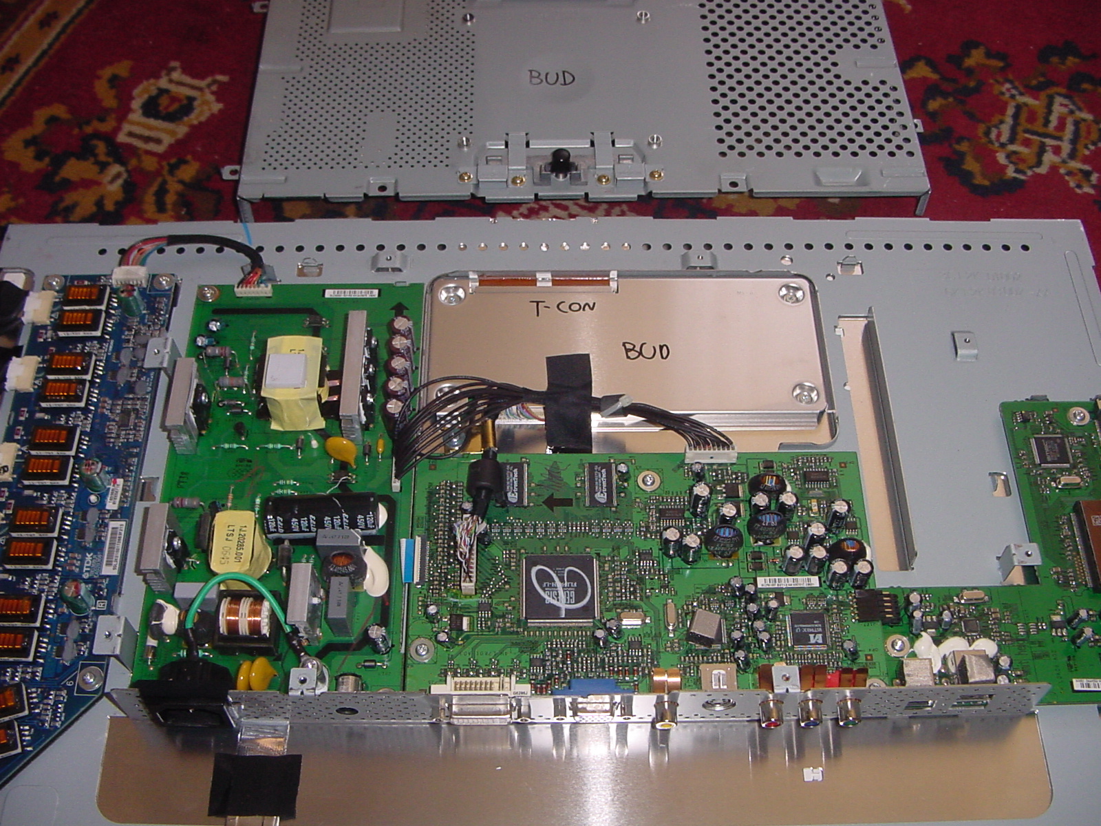

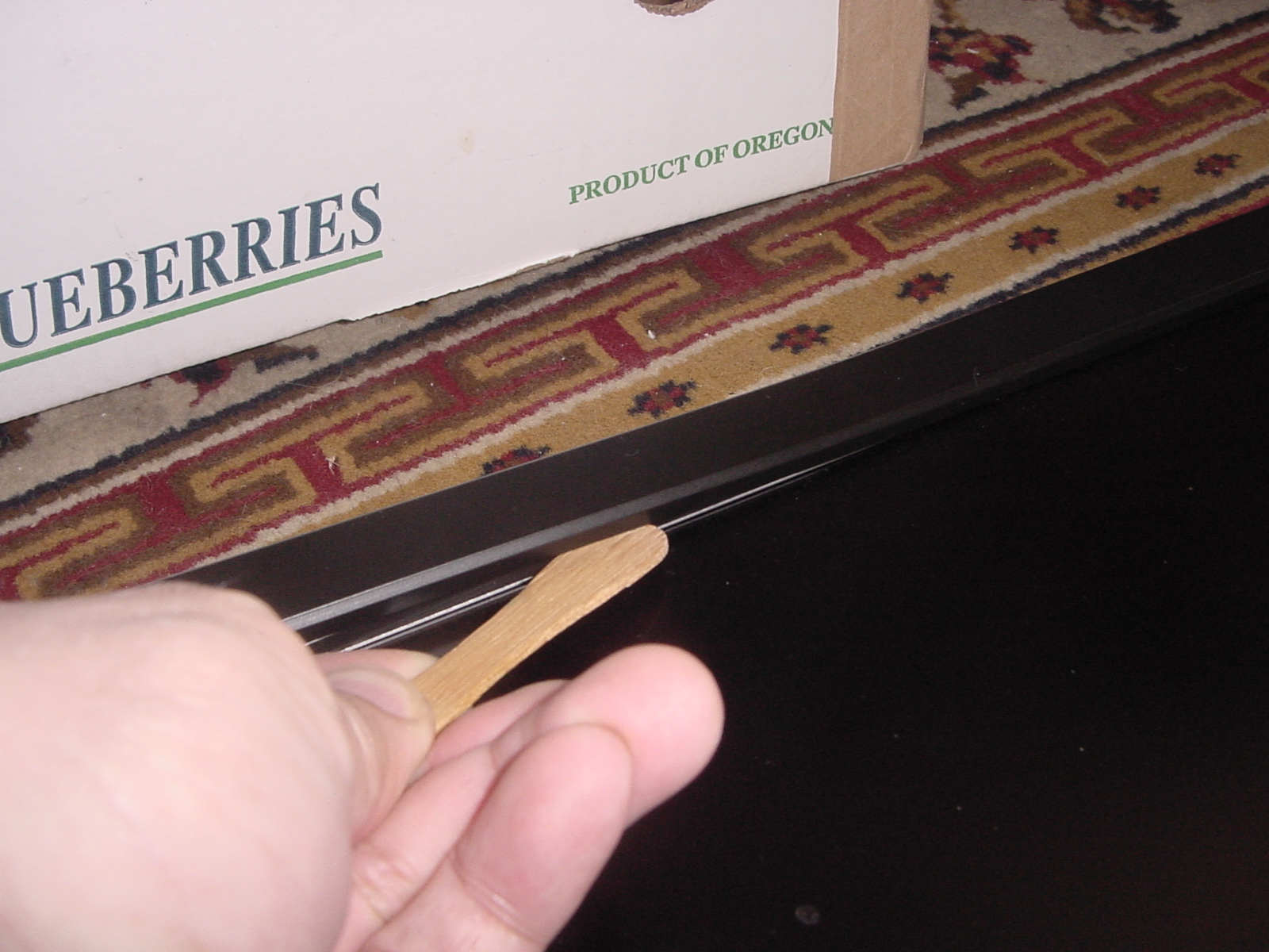

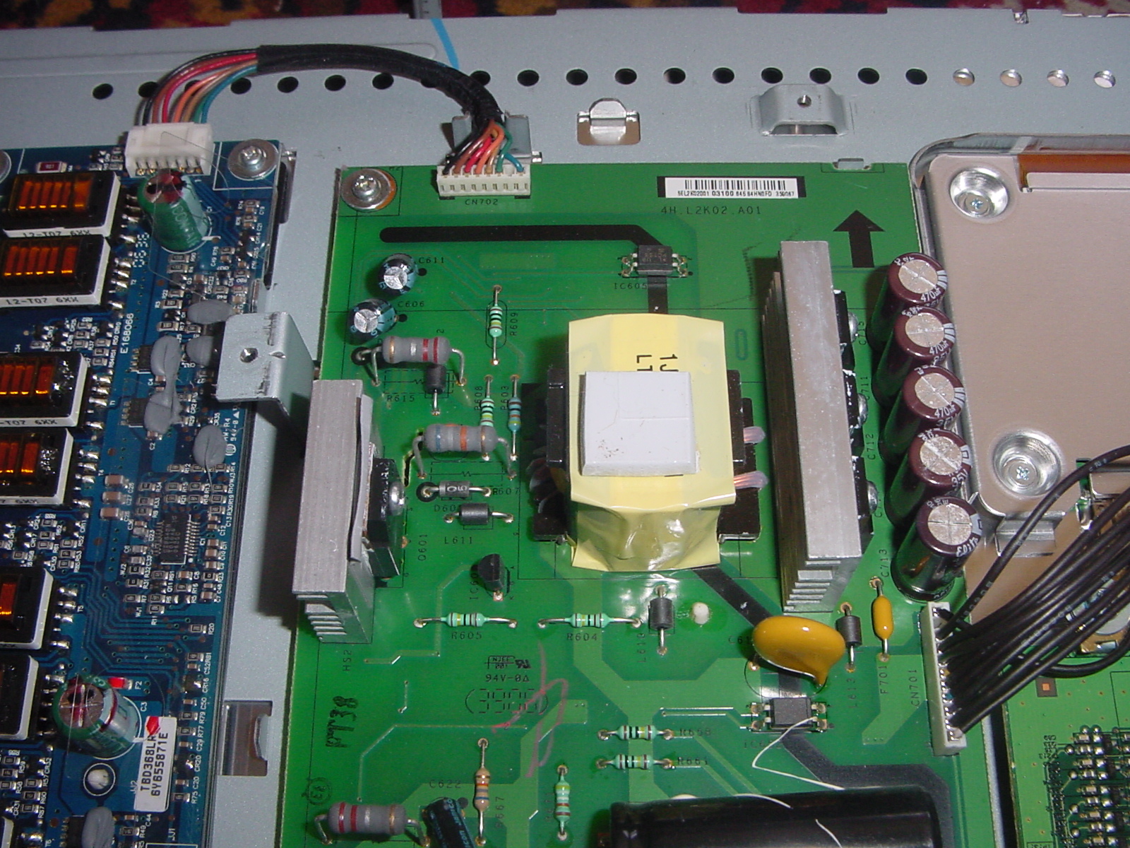

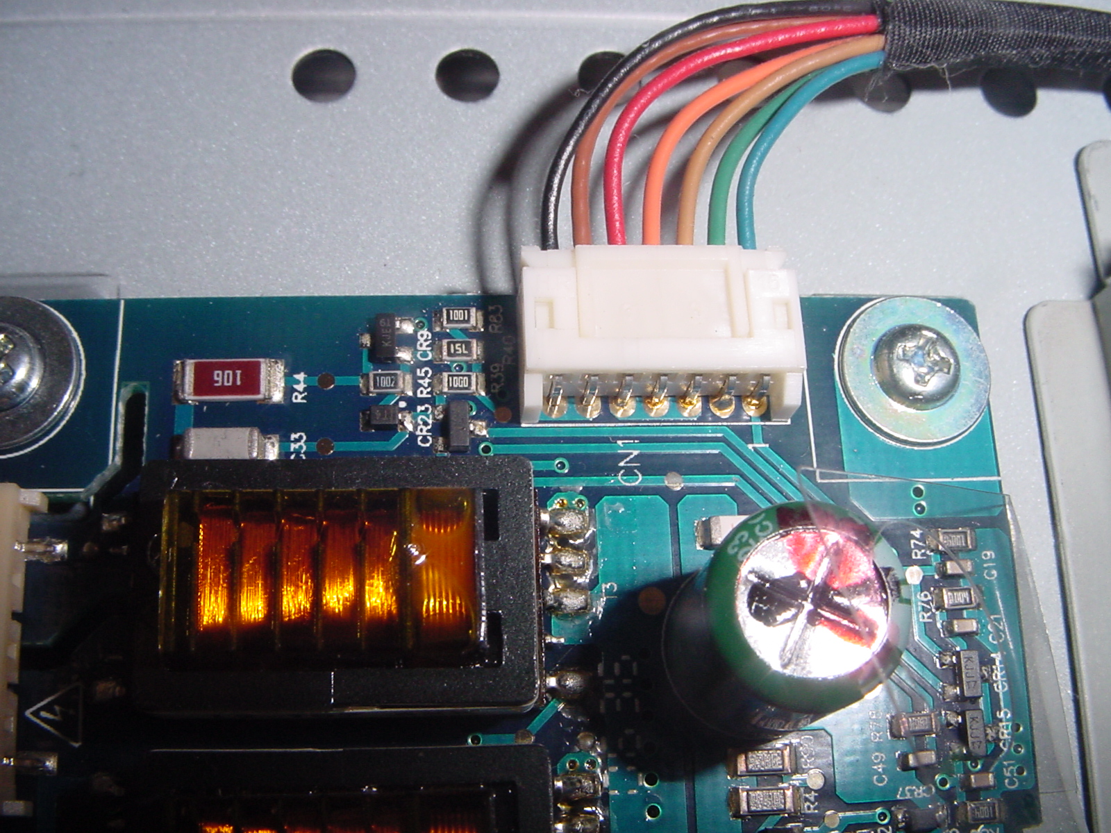

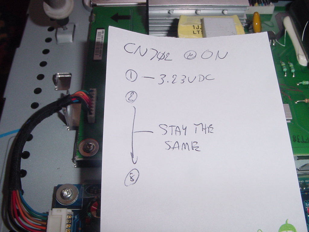

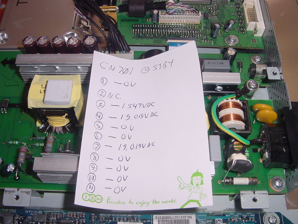

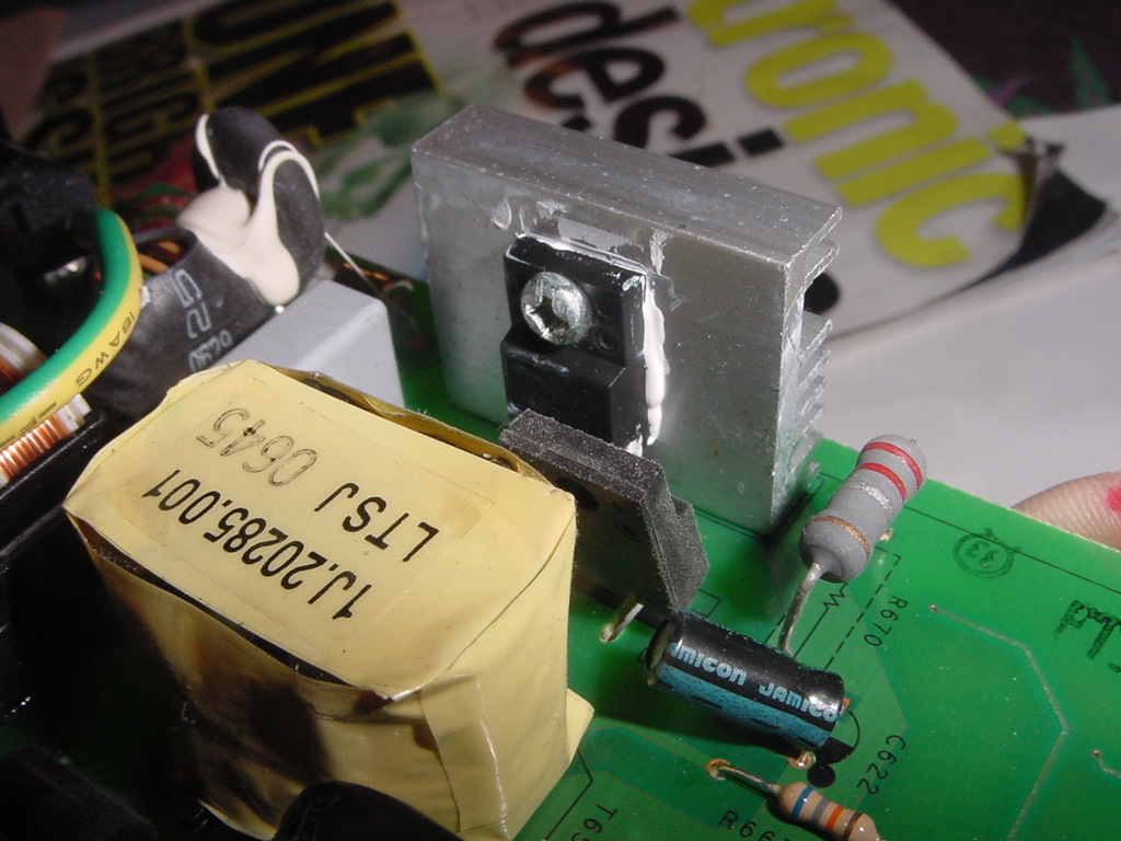

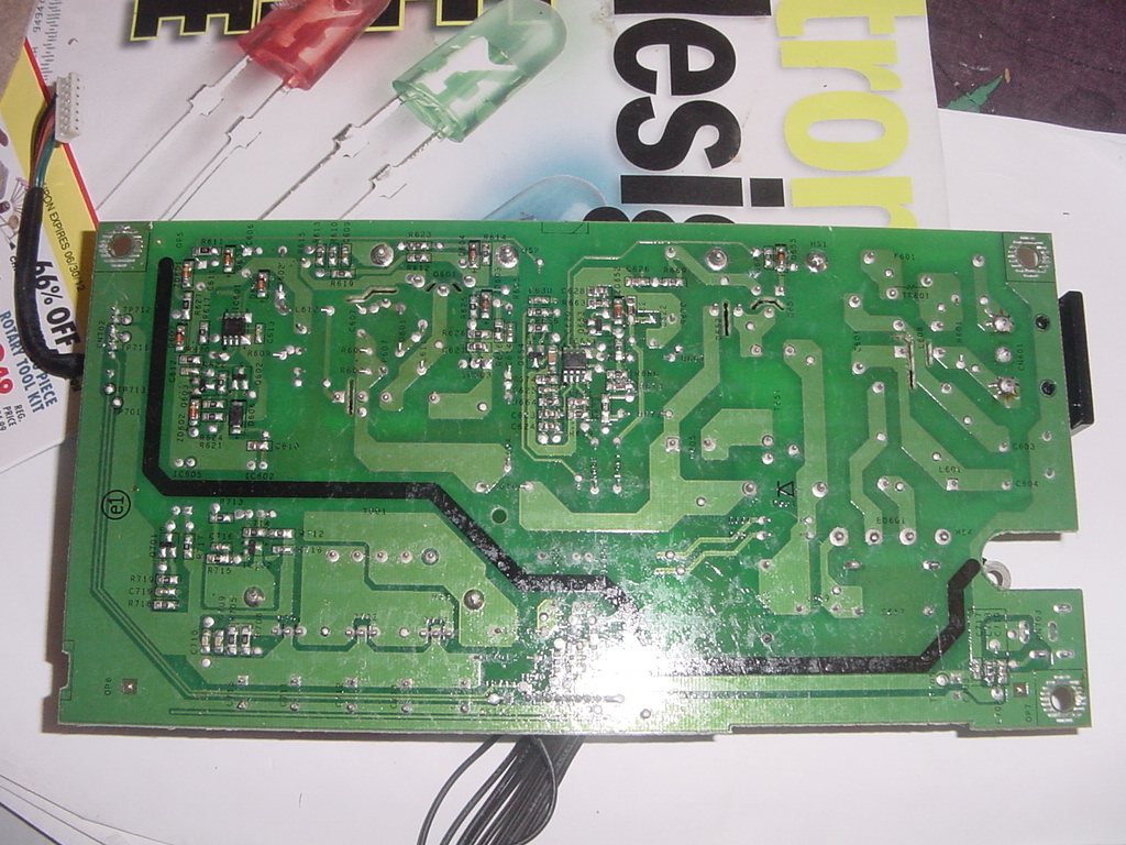

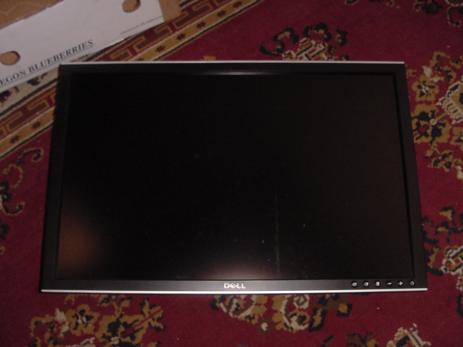

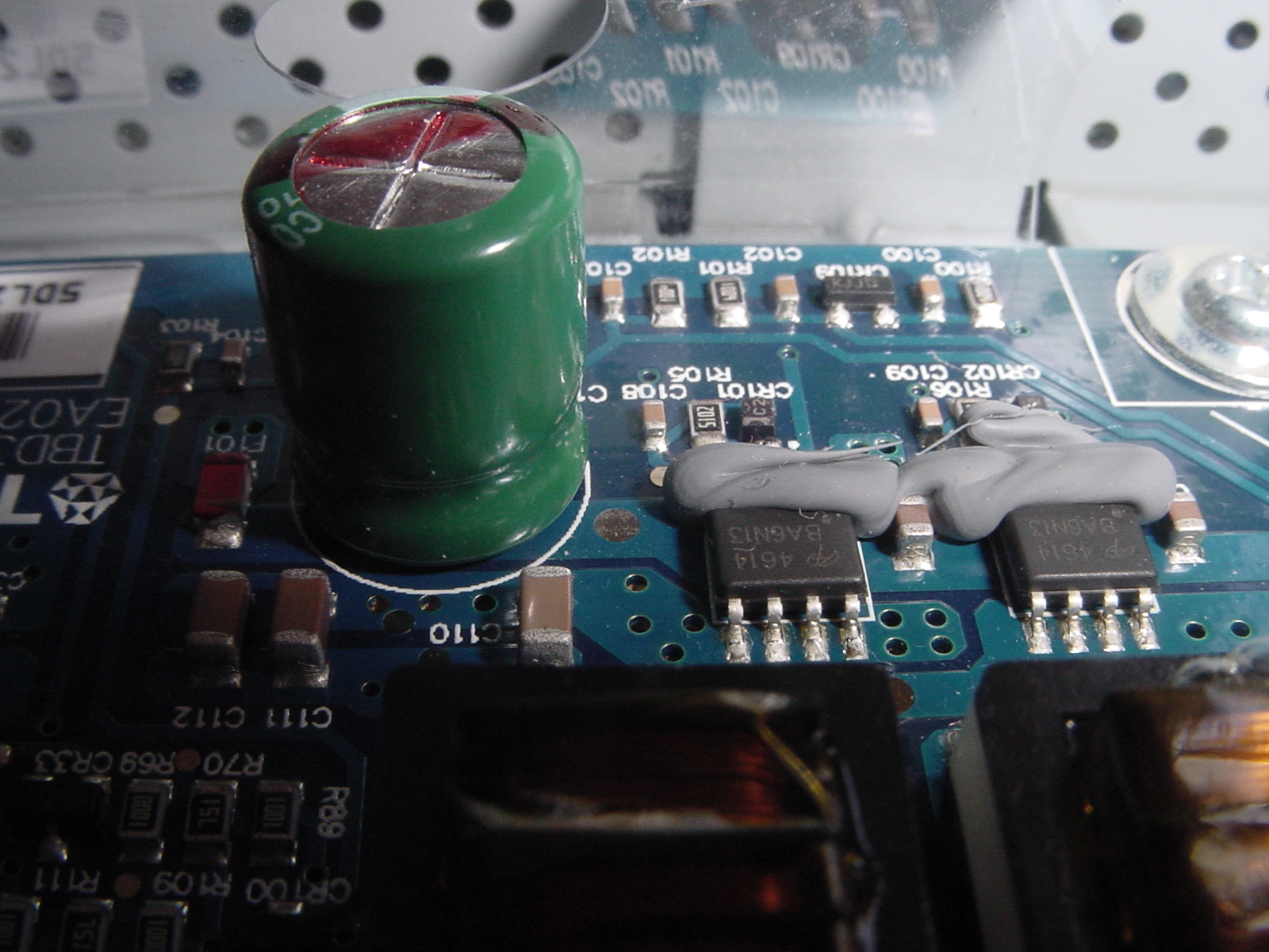

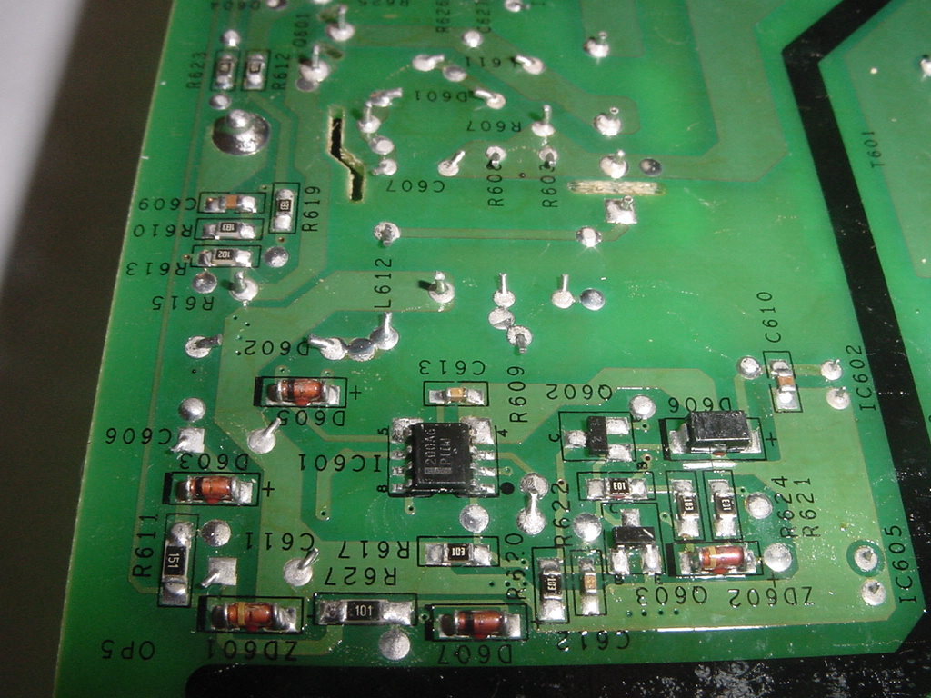

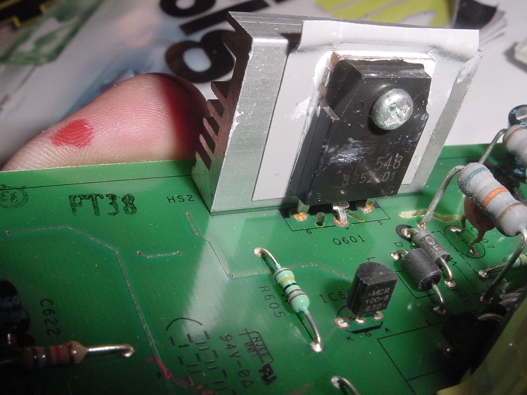

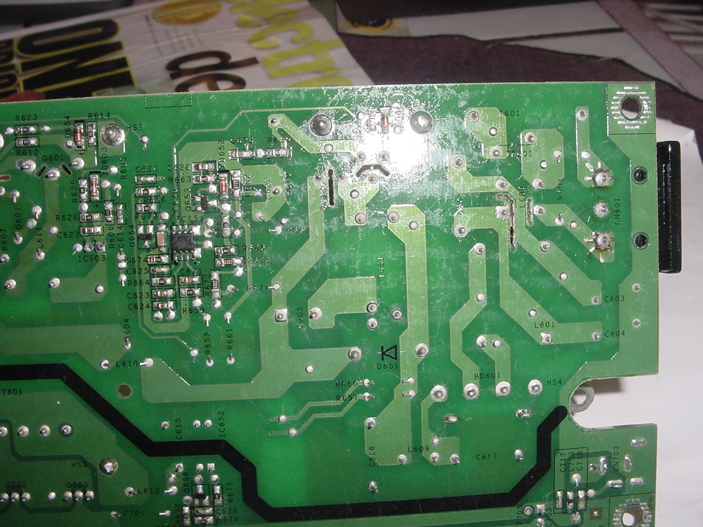

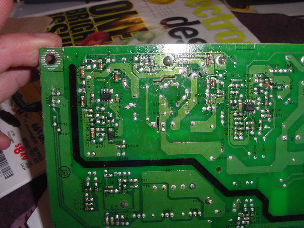

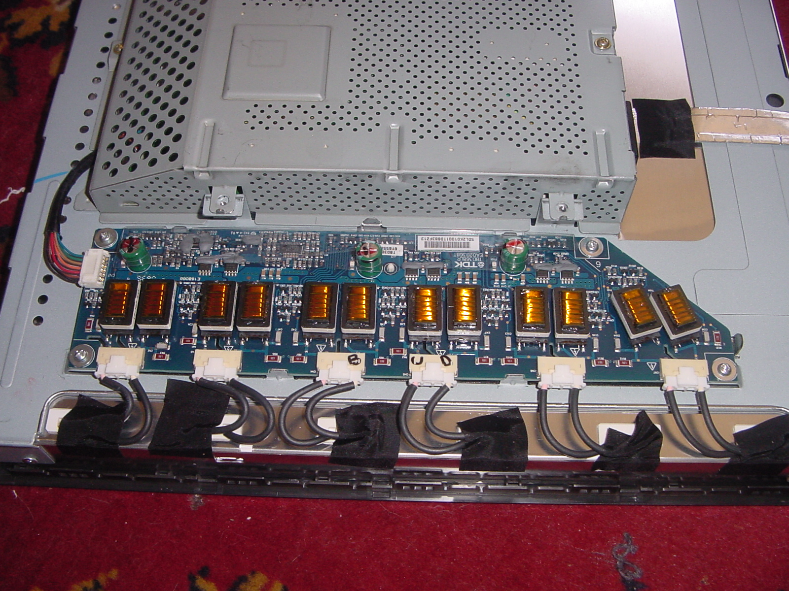

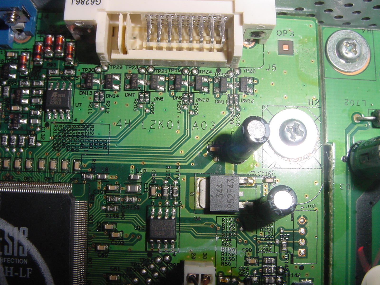

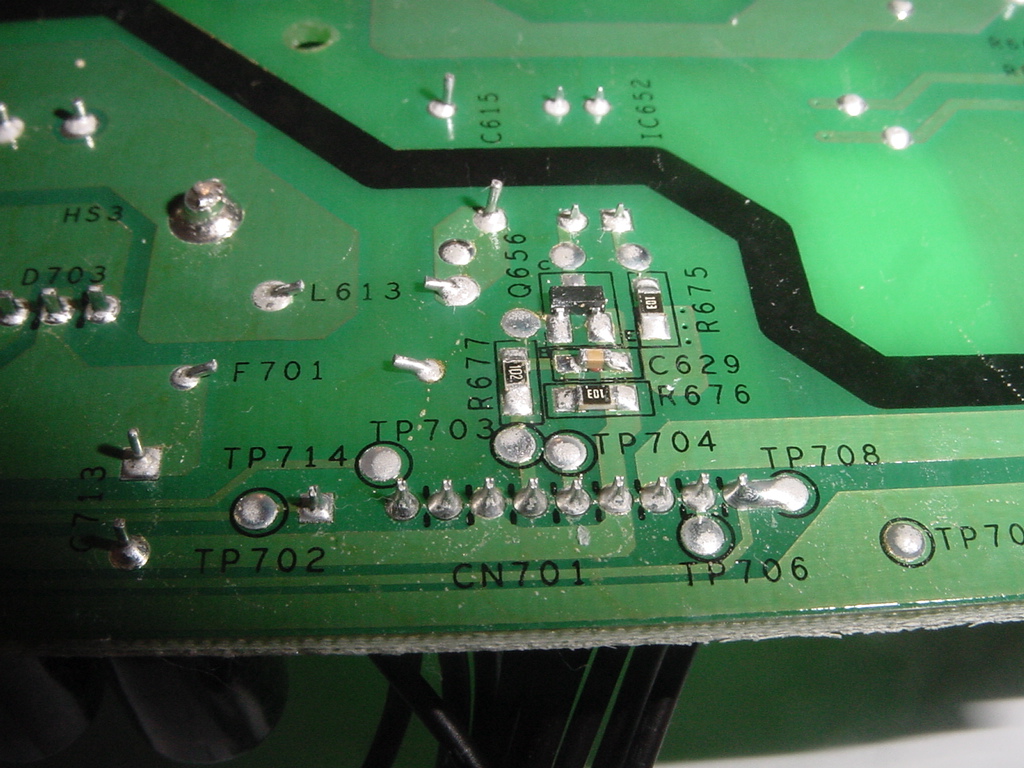

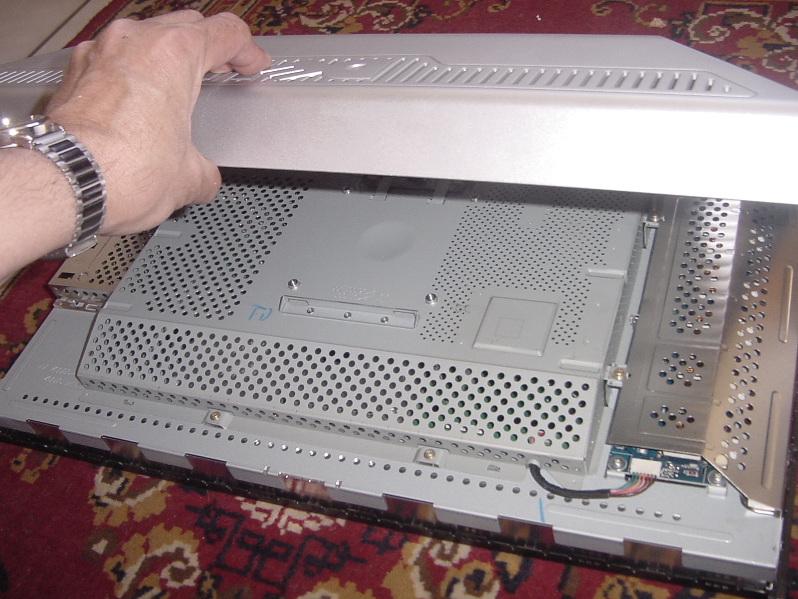

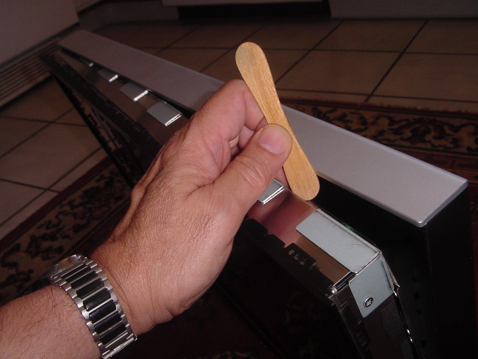

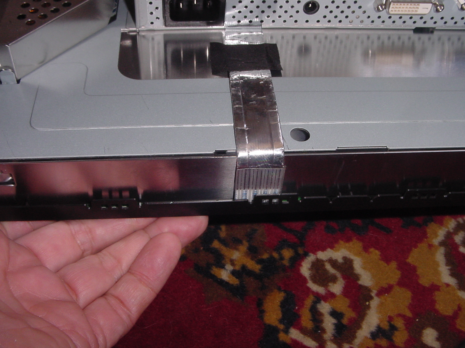

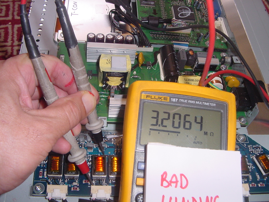

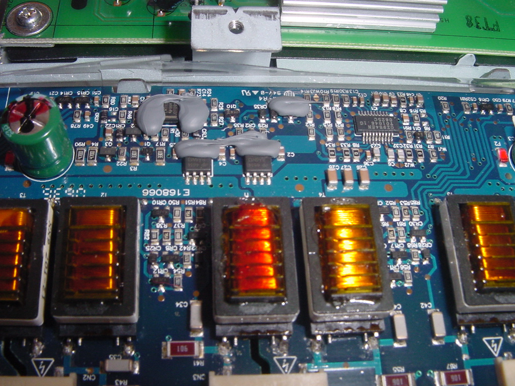

    Have about 1/2 hour of spare time before going to the gym just to find out why it has 2 seconds to black:
    One bad inverter transformer.
    I will have to show in multiple posts due to large amounts of pictures.
    See them at Photobucket also:
    http://s807.photobucket.com/albums/y...ll%202407WFPB/

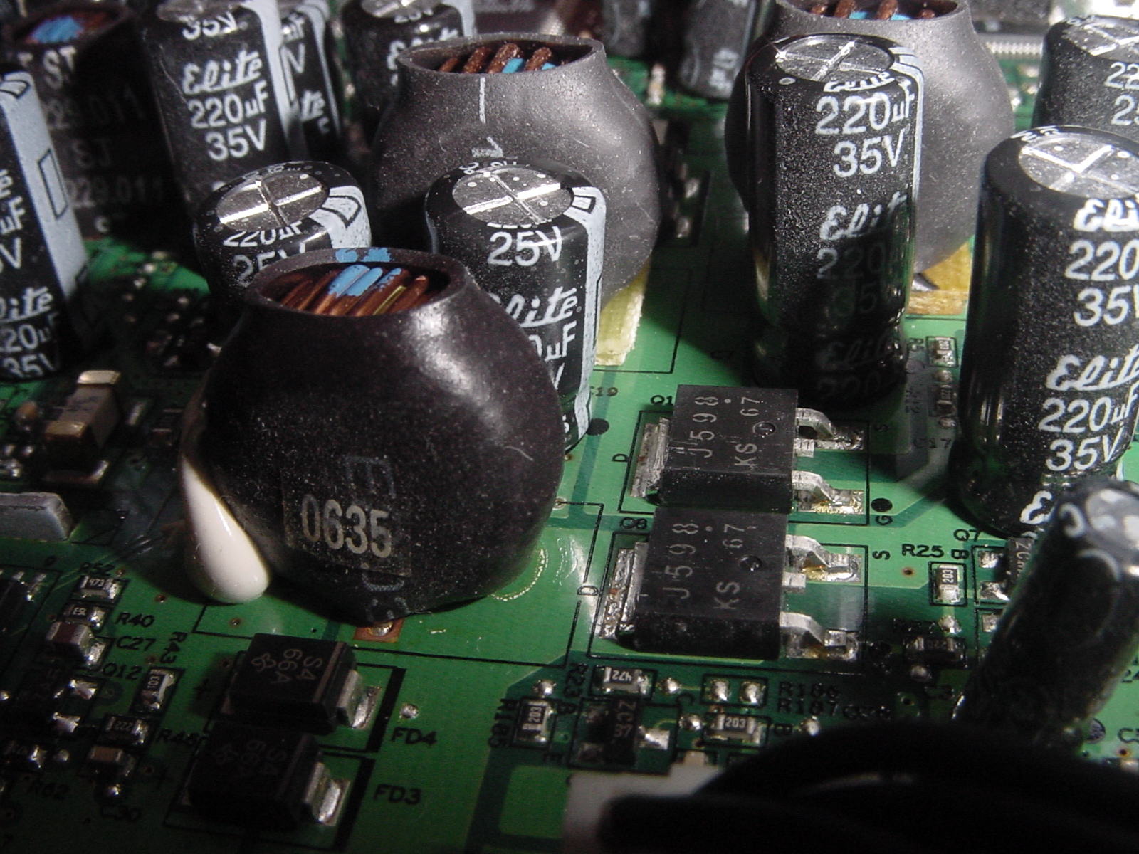

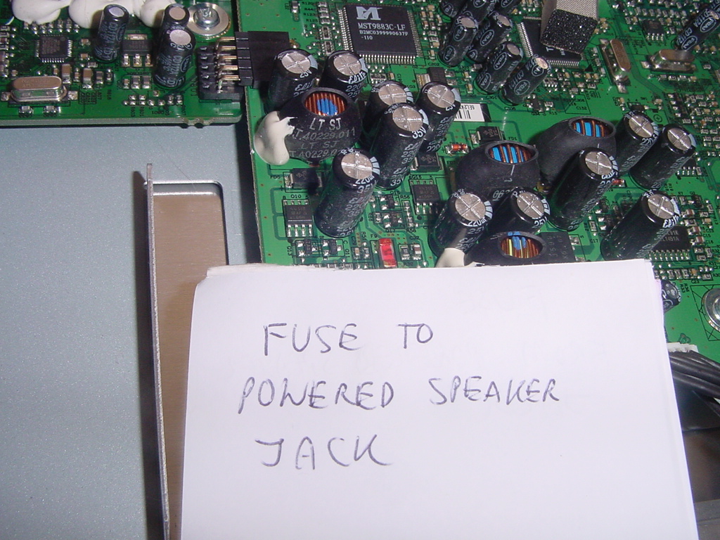

    Re: Dell 2407WFPB bad inverter xformer Part 2
    More pictures.

      The error often occurs if you upload the pictures but it takes too long and the token expires for some reason... maybe try 5 per post at a time or just link to your Photobucket? (very useful pictures you've got there)

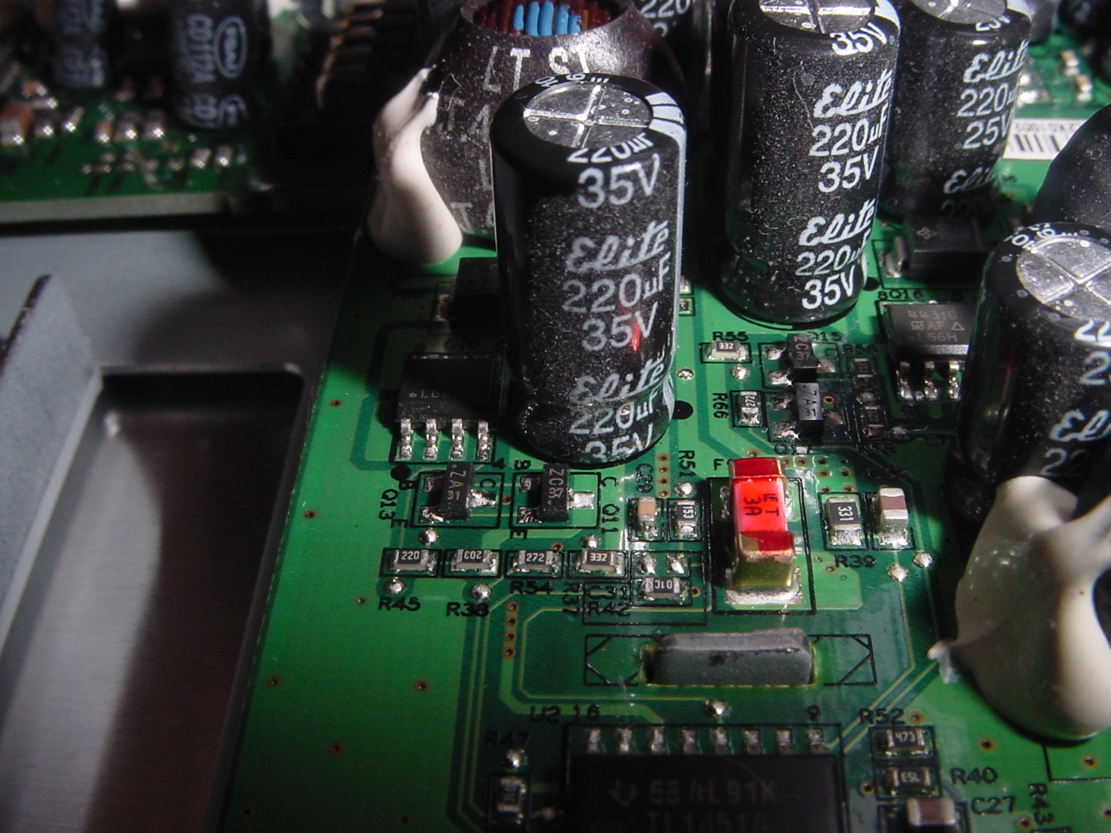

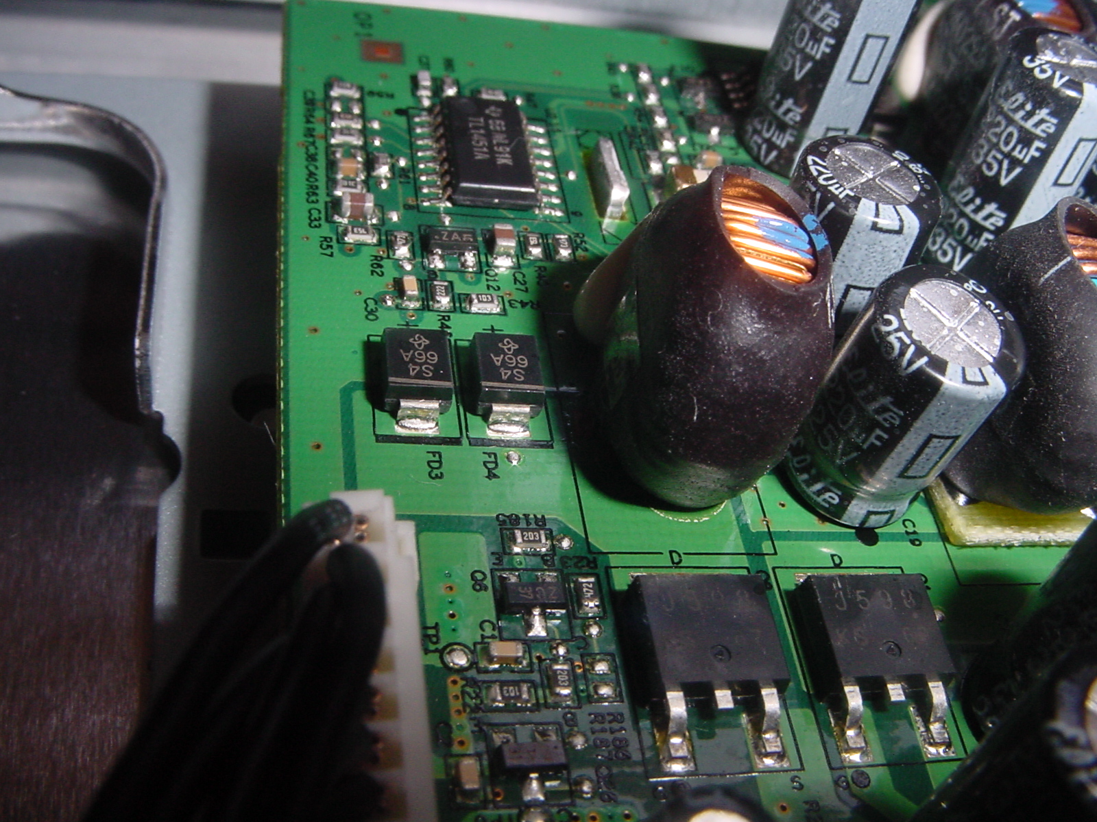

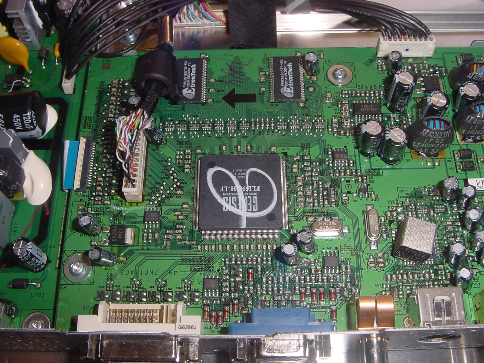

        Re: Dell 2407WFPB bad inverter xformer Part 3

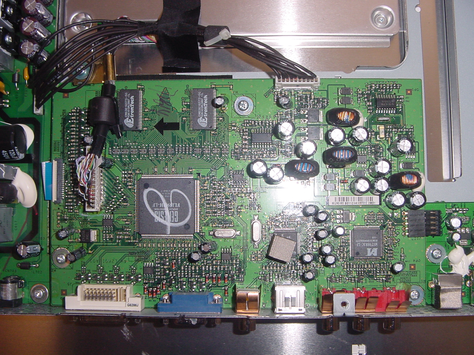

        More pictures.

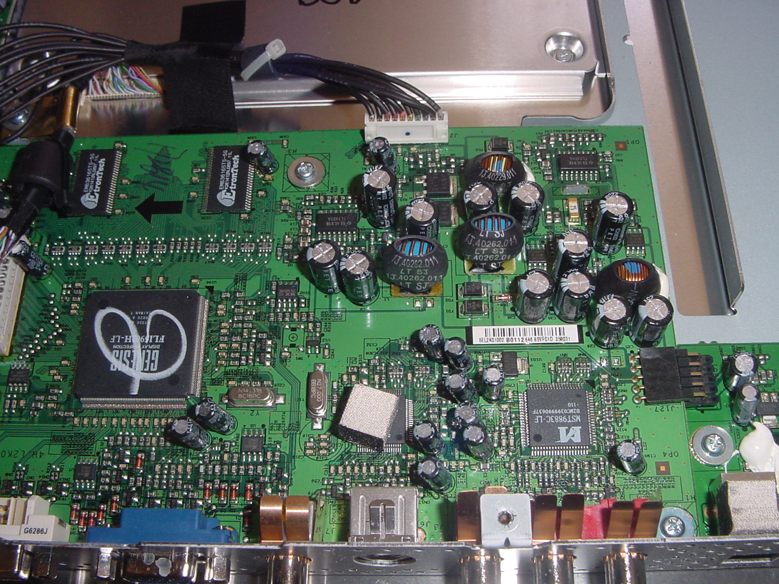

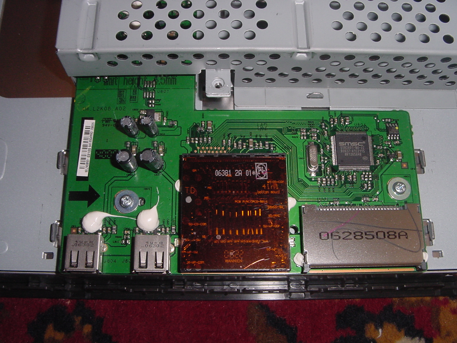

          Re: Dell 2407WFPB bad inverter xformer Part 1
          Using Fluke's autohold would make your life easier to take photos.
          I see this lcd uses the same type of USB board as the Dell 2007FPb.

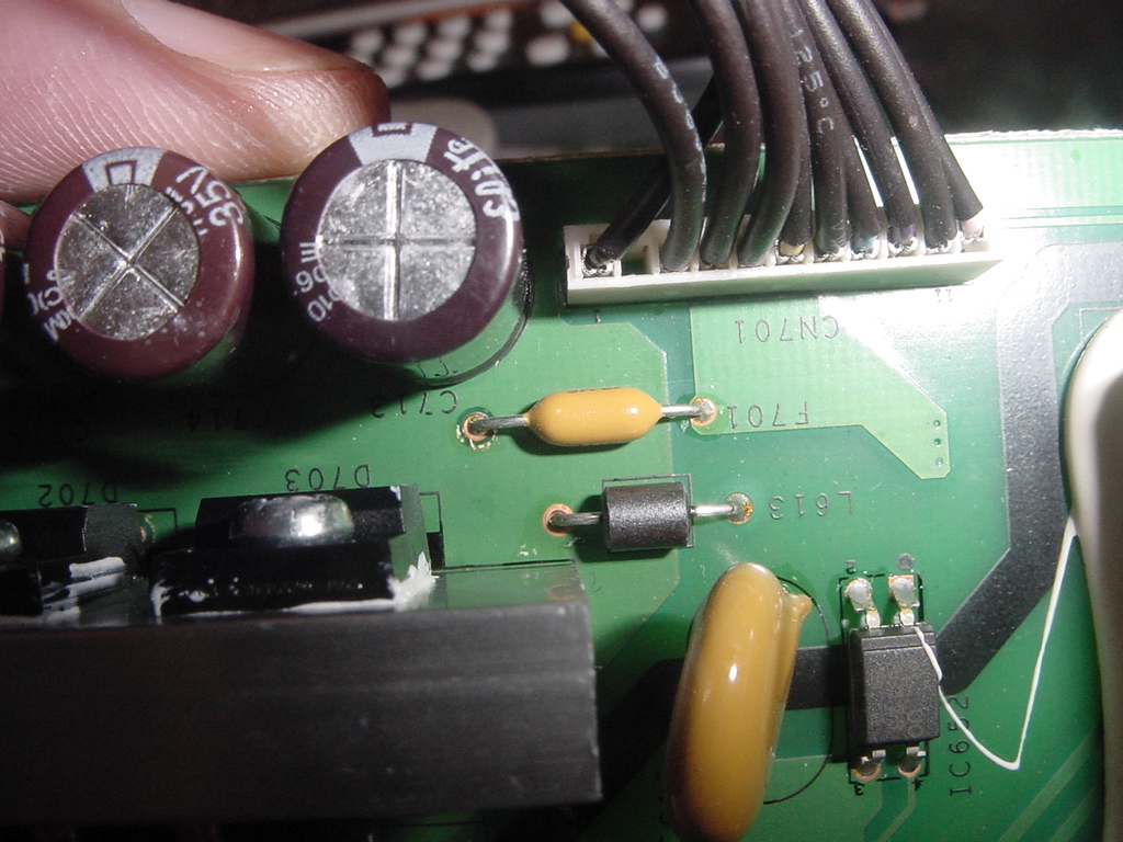

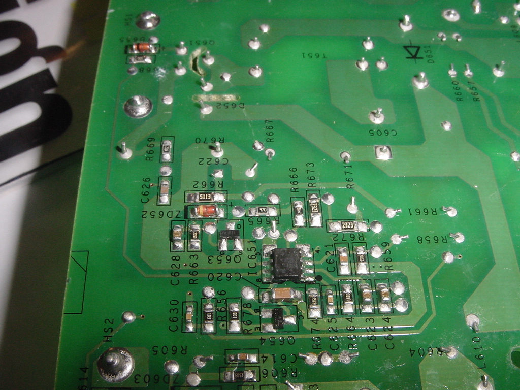

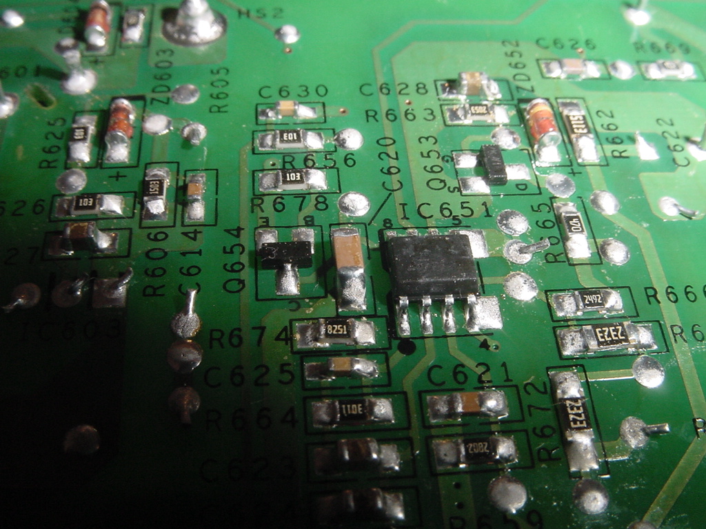

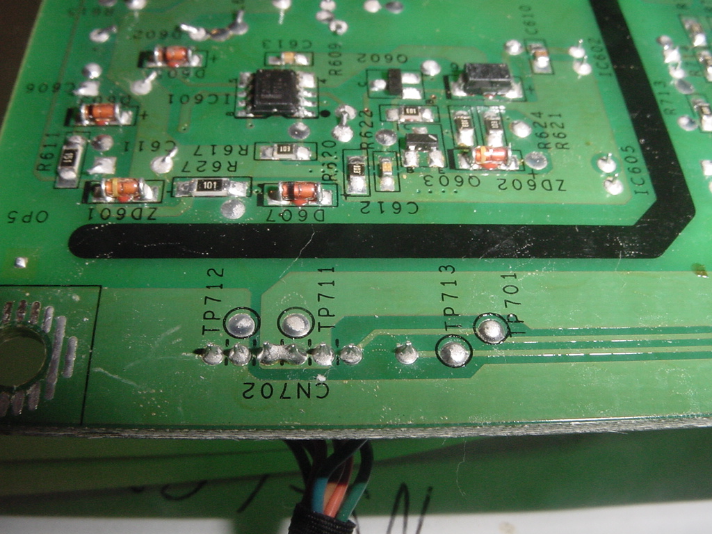

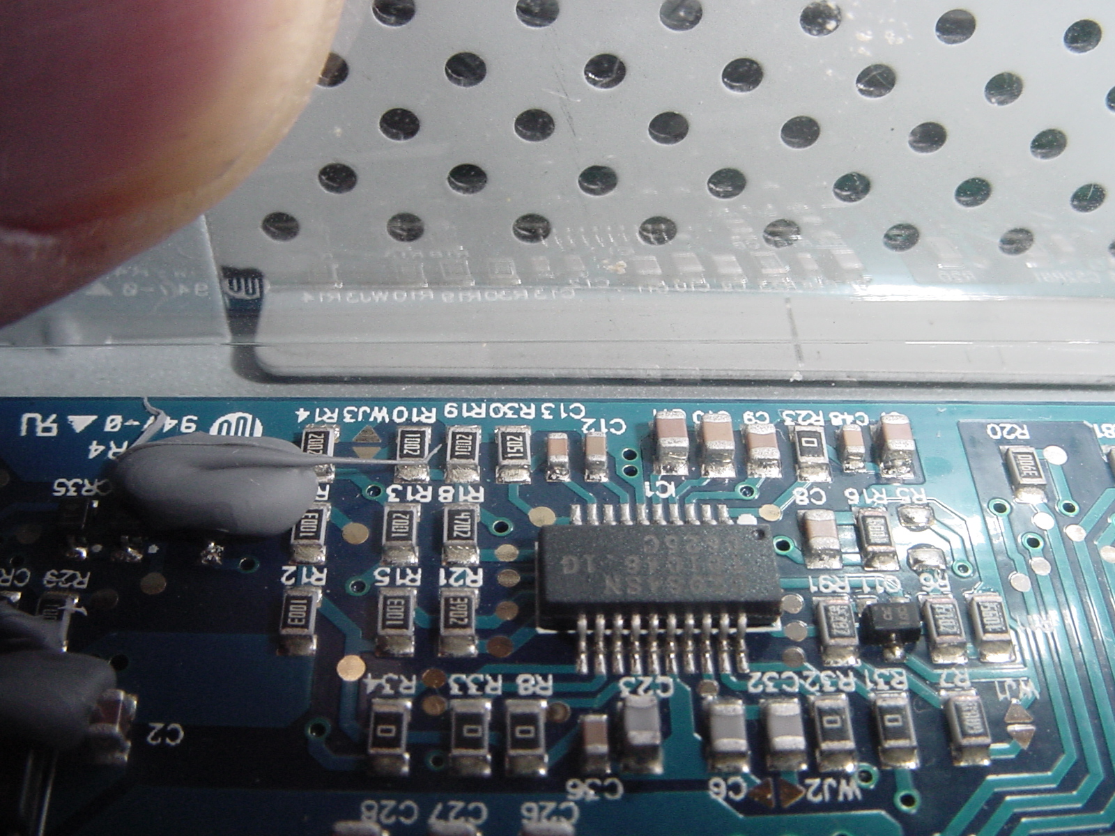

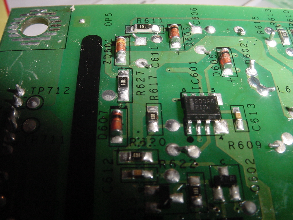

              Apologizing for the necro bump, but I've found that Pin 3 (the green wire) on CN702 is the brightness control line. It appears to go from 0v to whatever the reference voltage on Pin 1 (blue) is.
              Further investigation shows that the 20 pin soic package is an analog to pwm brightness controller.
              (Datasheet here: http://pdf.datasheetbank.com/datashe...O2Micro/0Z964S)
              Pin 3 on that chip seems to be related to the presence of voltage on pin 1, and pin 14 seems to be related to pin 3 on the connector.
              My guess is the dimming voltage is found via the comparitor (the odd 8 pin soic package) and then fiddled with through the rest of the circuitry.
              Regardless, I feel this is important information and should be known for future reference.
