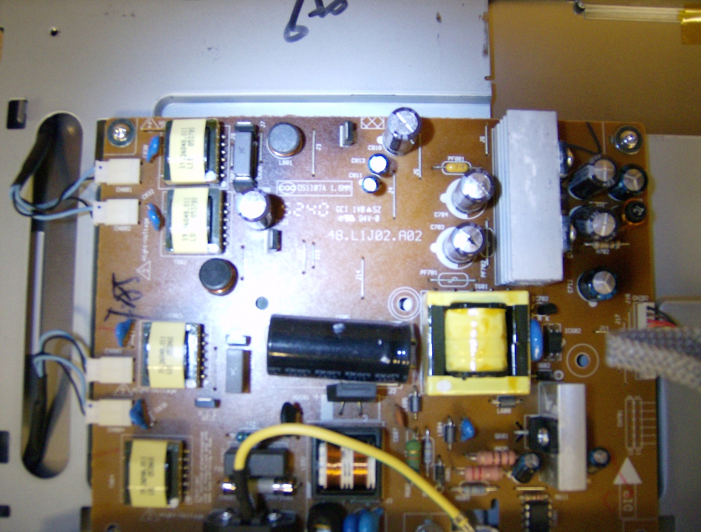

          The first thing to do is always to open the unit and examine it. The shut down is consistent with the problem my FP91G had, bad caps. They were obviously (visually easy to see that they were) vented and swapping in good caps solved the problem.
          Definitely not a fuse, it wouldn't come on at all if that were the problem, would seem 100% dead. If you see vented caps I wouldn't even bother with any other testing before replacing them and trying to power it on.

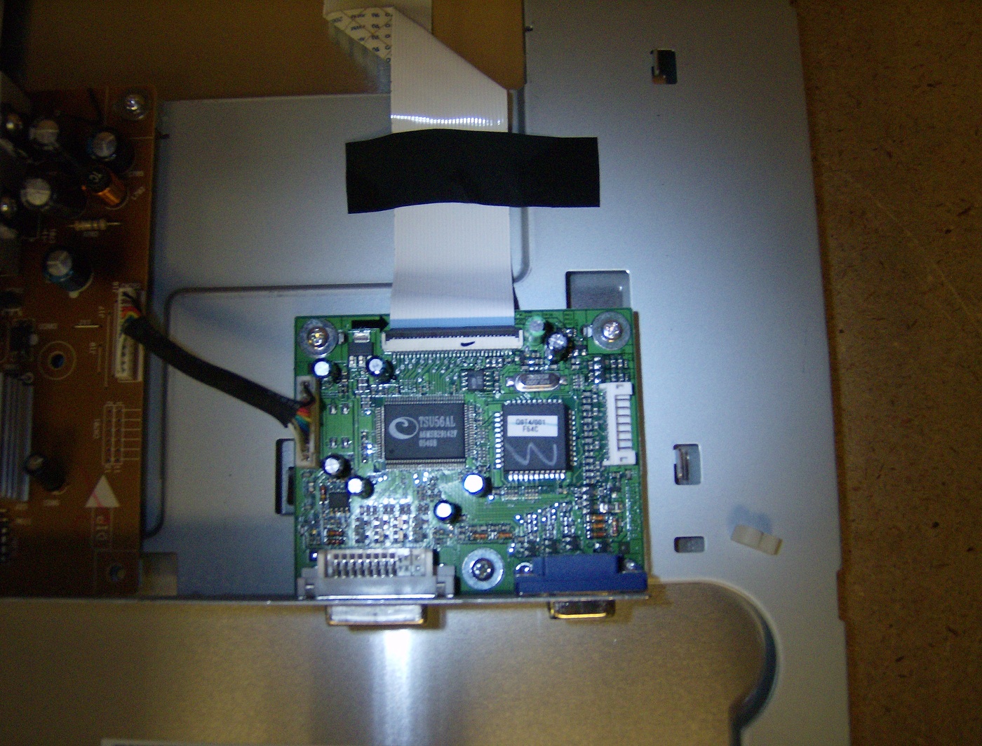

            I have pics, my camera is not the best quality...
            After looking at it, right away i see 8 bad craps (bulging) on the power supply, one of them oozing.
            I will take your suggestion 9x9, replace those and go from there. Im almost certain it will fix this problem.
            2x Jamicon?10v 1000uf
            6x elite 35v 470uf
            Is there a rule of thumb for capacitors replacement can go by as i dont have exact ones? I have various ones laying around but different voltages and capacitance.
            edit: i only have some (new) rubicon 6.3v 2200 uf, i suppose i cant use those. rest are ones i pulled off other parts.

              Hi - no you cant use the 6.3v ones - here is a guide
              http://www.niccomp.com/help/capsubguide.asp
              Sometimes it is good to increase the voltage by one notch but the uf value should be maintained unless you know what your doing.
              Using old ones - unless you can test with an esr meter may not be a good idea if bad they could cause knock on damage to components more expensive and more difficult to replace.
              Some members would recommend replacing all capacitors of same makes that have gone.
