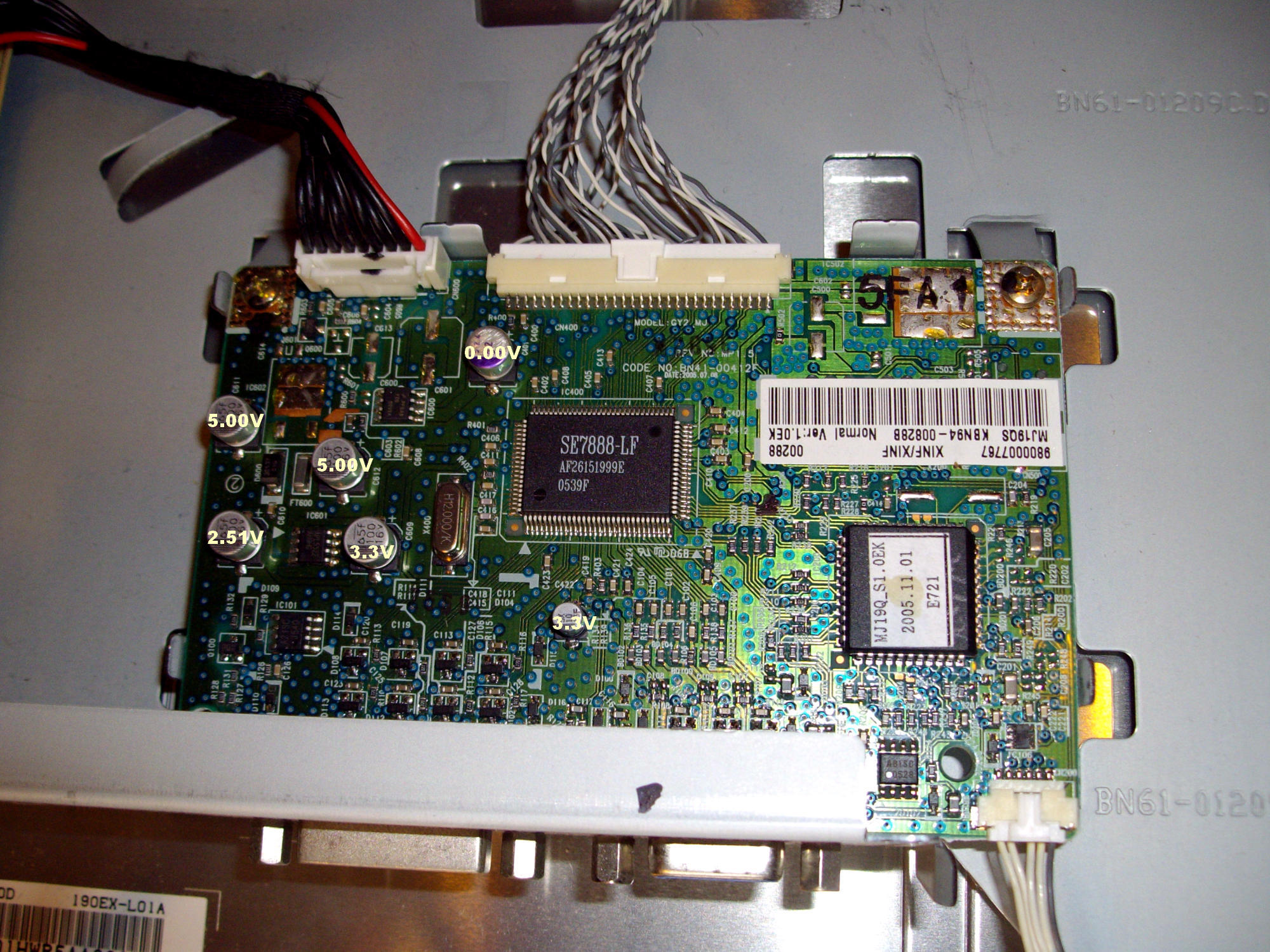

    Hallo there,
    after repairing the inverter-board of a Samsung 901B S, there is still a problem
    with the input signal. Even though a signal is connected to the VGA-SUB15, the monitor toggles between digital and analog input (screen-window) and doesn't process the signal onto the screen. Therefore I guess something on the VGA board is damaged too. Does anybody know this bug?

    Re: Samsung 901B S finds no input signal
    Could be a bad joint on the VGA connector of your video/logic board.
    Could be bad capacitors on the video/logic board or a bad regulator.
    Could also be corrupt firmware.
    The first 2 items are fixable, so start by checking the joints on the VGA connector and make sure all of the linear regulators are outputting the correct voltage. If yes, proceed by replacing the electrolytic caps on the video/logic board. If that doesn't work, it's possible the firmware is corrupted.
    Post some pictures of the video/logic board so we can see what we are working with. Please attach pictures using the hosting service on this website (when posting, use Advanced mode - below the text box, you will see a button "Manage Attachments") and make sure your pictures are large and clear enough (yet not larger than 2000x2000 since that won't upload).
      Hallo momaka,
      thank you for your reply. I checked the pins from SUB-D and resoldered
      it. After I checked the voltage over each visible capacitor (have no schematic)
      and wrote the values on it (see picture). Also I tried the pin5/pin6 method
      (bridged with 50 Ohms) on the Novatek IC. Surprising was the changing of sceen
      message after. Instead of toggeling between analog and digital there appears
      "you use the wrong resolution, try 1280x1024 60Hz". That's quite telling.
      I'm not quite shure if this capacitor above, with 0.00V shows it's normal value.
      Without a schematic difficult to say. If used only as galvanic isolator,
      this value might be normal, but never when should be a regulator cap. In
      this case either a voltage is missing or the cap is probably shorted.
      If possibility nr. 3 is the reason for this bug, it will be gainless
      to buy another vga-board for about 47.- Euros. The value of this monitor
      is marginally lower.

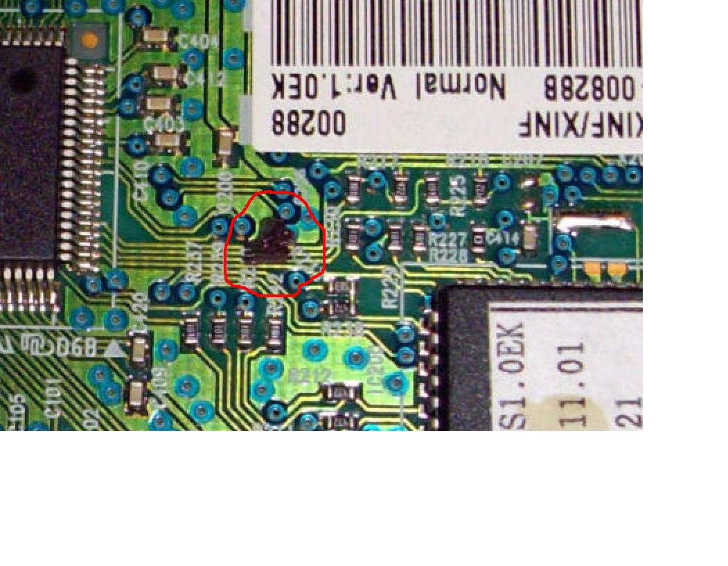

      • selldoor
        Slow Learner
        • Dec 2010
        • 7870
        Is this brown spot ok?

          The Novatek controller chip was used on several different models of Samsung monitors. From what I understand, the chip goes bad over time and can cause the problems you're seeing. The only solution is to replace the Novatek chip and reload it's firmware. See the link for the schematic for the Samsung 912N model with similar logic board (vga only):
          https://www.badcaps.net/forum/showth...hlight=novatek
          Also, the resistor trick will eventually cause the chip to burn out.
          Repair success for the logic board are poor.
            Yes, a cap that big without any voltage across it doesn't look normal.
            What's the part number of IC600? See if any of the pins of IC600 connect to the (+) side of that cap.
            The dark spot that selldoor found looks suspicious as well.
                Good evening @all,
                @selldoor: this brown spot was only color. I cleaned it away with a little alkohol
                (of course not inside me, but onto the platine-surface)
                  Hallo,
                  after switching on I got a voltage over the 0,00V Cap from about
                  4,92V during for the same time this window-frame appears, where
                  analog oder digital input is toggling. After around 20s the signal
                  breaks down to 0,00V. I think I will need a second-hand video board.
                  Cheers

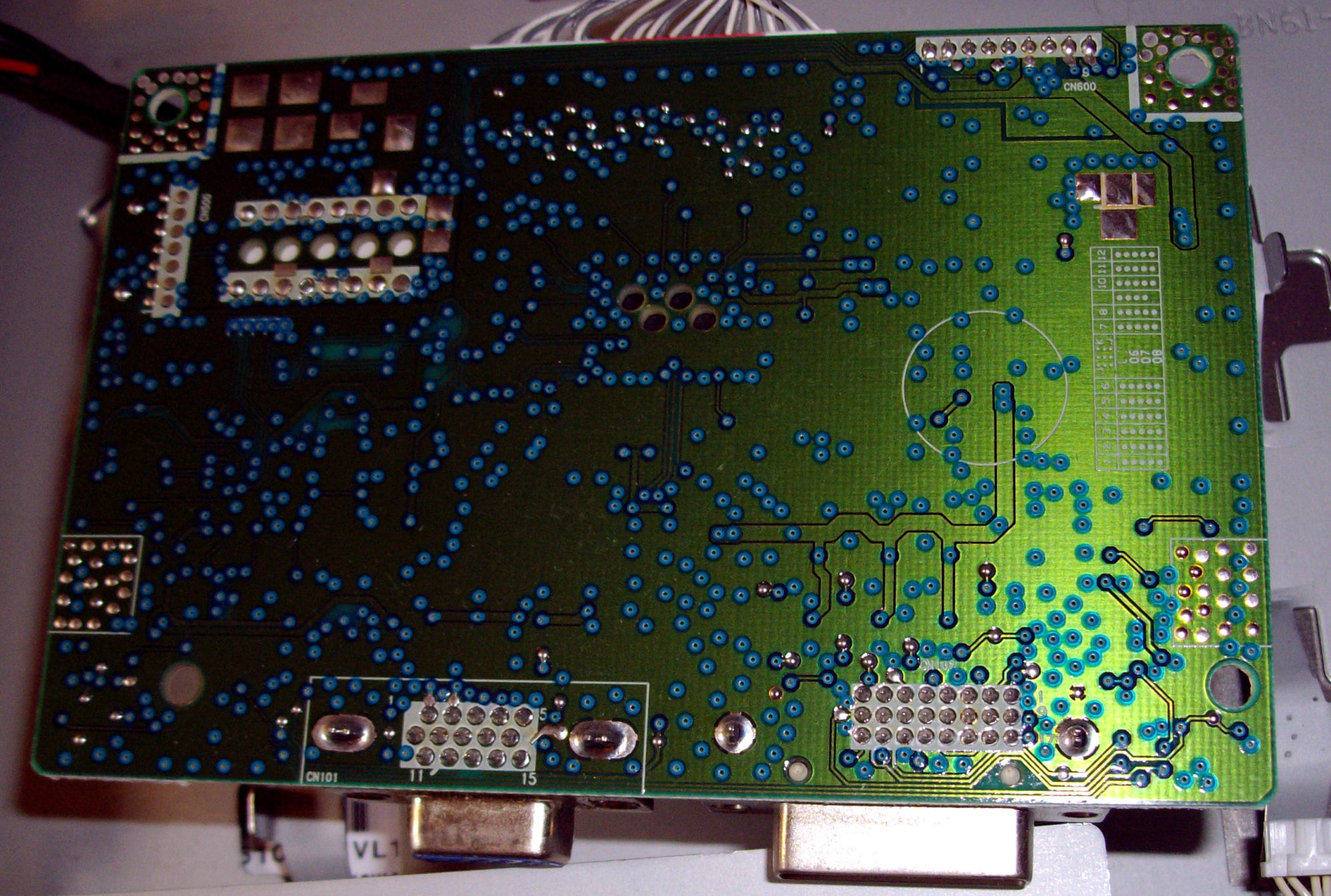

                  • selldoor
                    Slow Learner
                    • Dec 2010
                    • 7870
                    I am struggling to follow this.
                    I didnt understand what you meant in the first post by:
                    "the monitor toggles between digital and analog input (screen-window) and doesn't process the signal onto the screen."
                    and you use a similar reference in the last post:
                    "where analog oder digital input is toggling."
                    Can you say that differently at all? ( I do understand "oder")
                    You may need a new video board but I am not certain we have bottomed out the voltages from the Power supply.
                    If you want to do that can you post a picture of the top and bottom of the power supply and of the inverter if a separate board.
                      master hoarder
                      • May 2008
                      • 12170
                      • Bulgaria
                      after switching on I got a voltage over the 0,00V Cap from about 4,92V during for the same time this window-frame appears, where analog oder digital input is toggling. After around 20s the signal breaks down to 0,00V.
                      That looks normal. The 4.92V you're seeing is likely going to the t-con board, so when the monitor stops toggling between analog and digital inputs, it turns off the backlight and the t-con board. So I would say the voltage on that cap is not your problem
