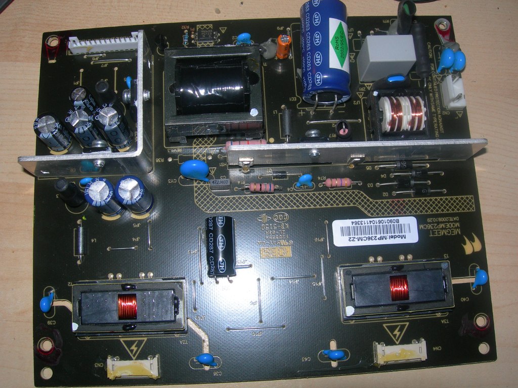

    Took it apart (quite easy.) No bad caps from visual sight, and all check okay ESR. Full of CapXon and JH caps, ugh. Pulled plenty of JH from an old LCD TV so I know they don't last. And we all know about CapXon. So I'll probably do a preventative recap on it anyway.
    5VS (standby 5V) is 5.1V. However the 5V main rail only reaches about 1V when it flashes; so something isn't letting it rise high enough, possibly a bad PMOS switch. This unit doesn't have a real standby supply, it just switches the 5V and 12V rails on when it gets a PSON signal.

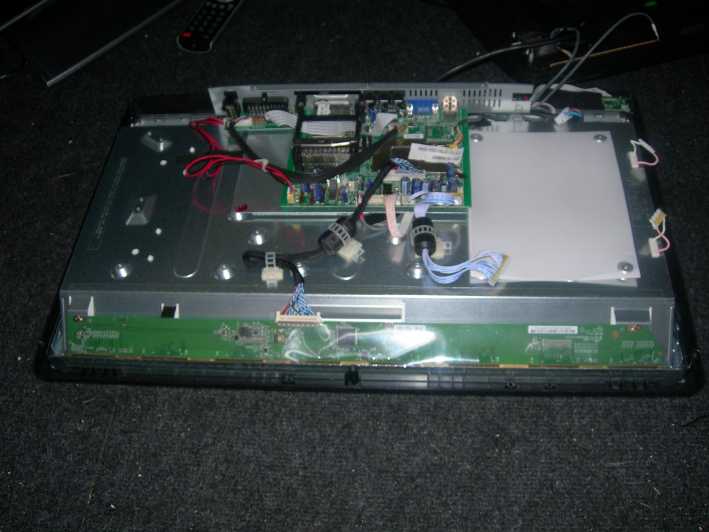

    Amazing how thick these newer LCDs are (I'm used to 10mm panels, this thing is a good 50mm.) Maybe this is how manufacturers are forcing OEM "super slim" TVs to be expensive LED based panels? I'm wondering if they are using a different type of CCFL, as it's only got two bulb connections which is a low number for a 24" monitor.

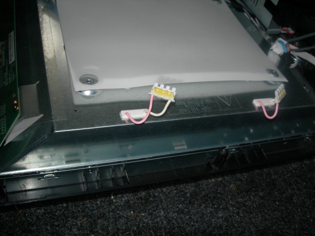

      It is unusual for a 24" to have just 2 B/ls,I would have expected with those connectors they would have 2 live and one return each,so feeding 2 lamps on each socket.

        Just two wires on each socket as far as I can see.
        Just now the soldering heating element on my Aoyue 968 died. Perfect timing!!! I have a mains "fire starter" iron and a gas/butane iron, so I might end up using one of those.
        Look how thick this panel is... The T-con is mounted diagonally!

                        I've decided I'll replace all the caps in this monitor/TV as I want it to last me through at least 4 years of university. I'll probably also add a makeshift heatsink to the LDO too, to stop overheating from causing issues. And I am using maybe a slightly better LDO by Texas Instruments instead of "AMS", whoever they are...
                        Cap replacement bill:
                        1000u 25V JH Black x1 -> 1000uF 25V Rubycon ZLK
                        1000u 25V JH Blue x2 -> 1000uF 25V Rubycon ZLK
                        1000u 10V JH Black x2 -> 1000uF 25V Rubycon ZLK
                        (the 10V has the same diameter as the 25V - crazy!)
                        470u 25V CapXon KM x2 -> 470uF 25V Panasonic FM
                        22u 35V CapXon Orange -> 22u 35V Panasonic MA
                        120u 400V JH Blue -> 120u 400V Rubycon KXW
                        The 120u 400V cap was a nightmare to lift of, Megmeet used some stupid glue on it which covered up the rating.
