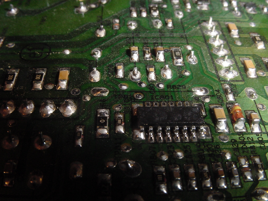

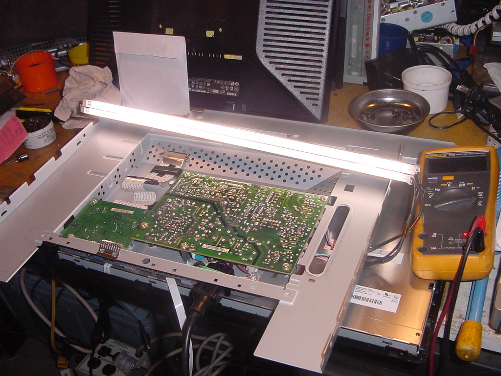

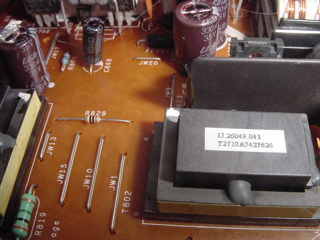

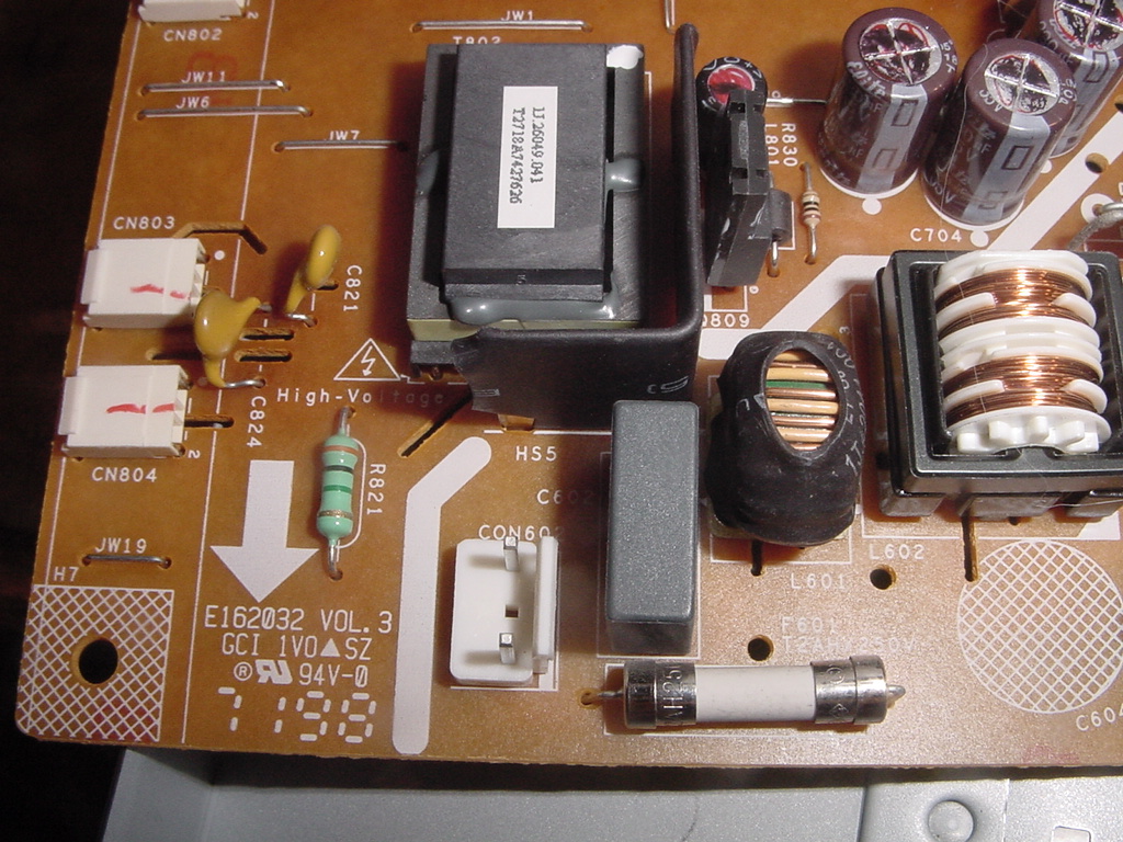

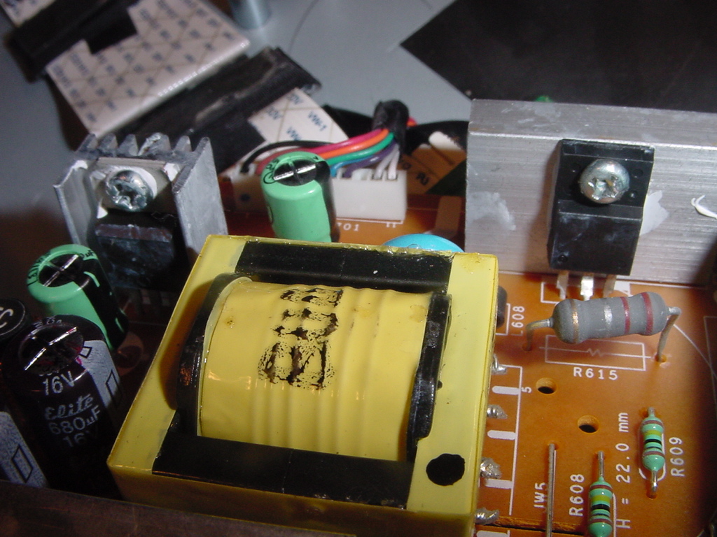

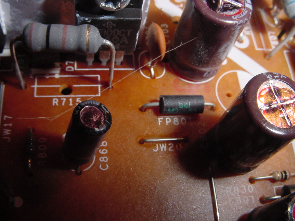

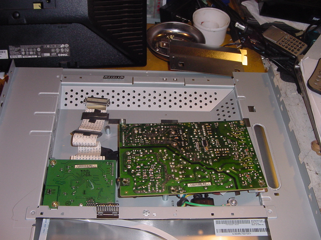

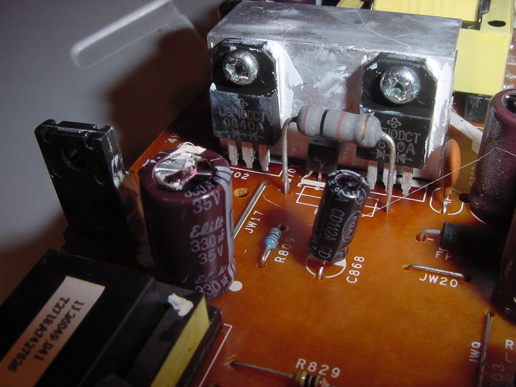

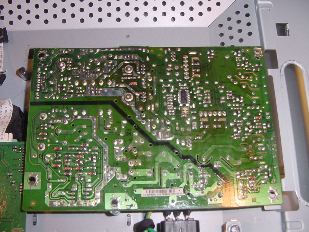

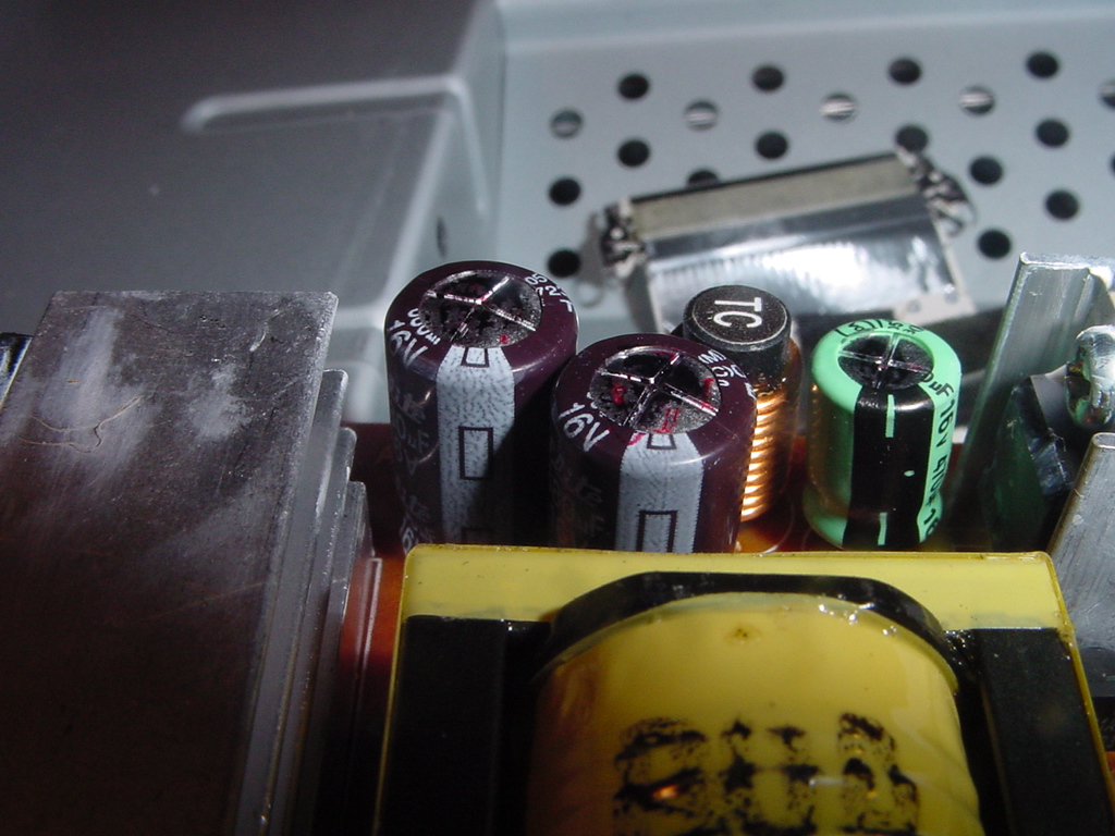

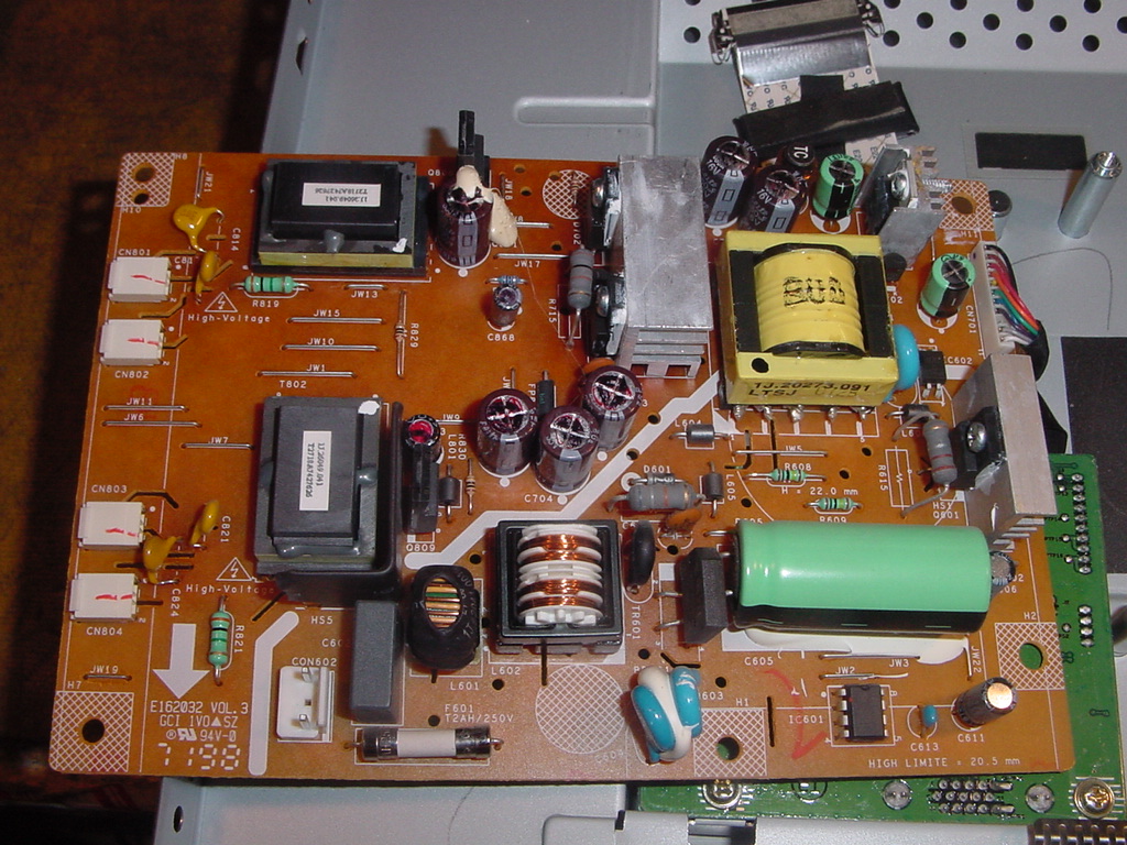

    Since I did not see any thread on this model, I just fixed one today so I decided to post it for FYI.
  • jetadm123
    • 2169
    Re: Dell E198FPB with bad caps
    I take it that bad caps were the only problem? And what are the PWM controller and inverter transformer switching transistor part numbers?
      Just bad caps, the Inverter IC p/n did not come out in the pictures.
        Another monitor saved from landfill. Good work.
        More failed Elite capacitors... Second only to CapXon in terms of failures.

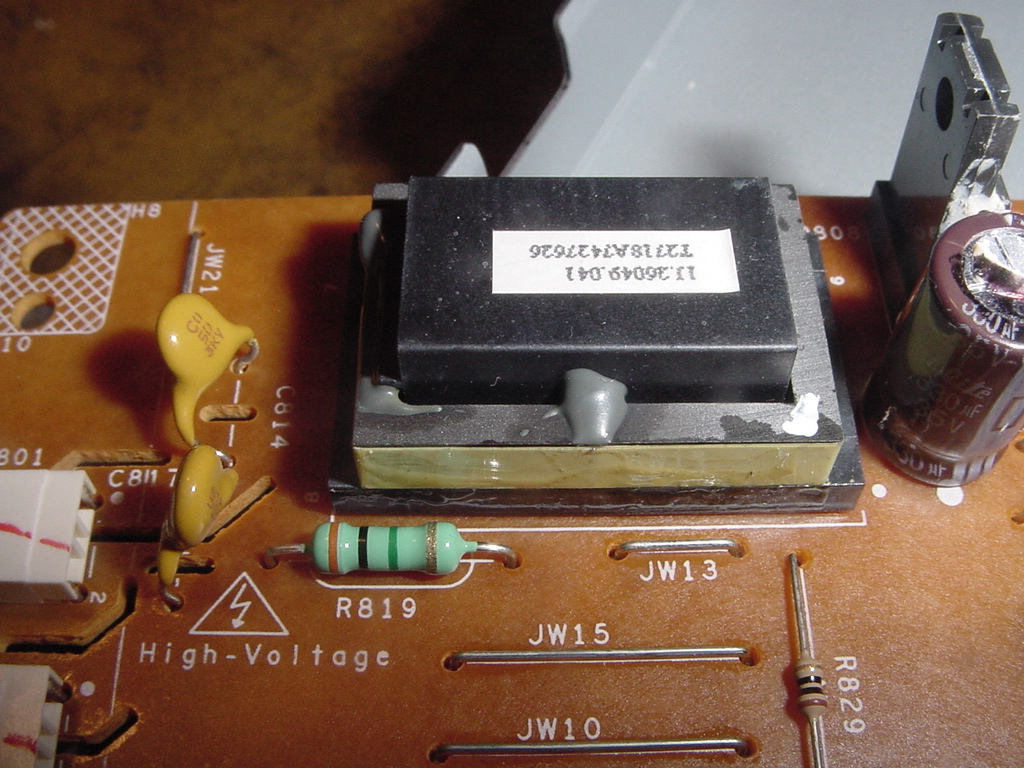

          i got the same model and board with No Power, no standby LED.
          No irregularities during ocular inspection (no bad caps), upon voltage check I found only voltages around the BIG cap around 250v up to the Drain side of the BIG Mosfet.
          Could it be the 1203 8-pin PWM IC that won't start?
          I believe it has an internal start-up circuit.
          Help would be much appreciated...
          Eugene
            Check the bog resistor connected to the Source pin of the power MOSFET, and also check the small start-up cap (22~47uf 50V) close to the power MOSFET, try heating the caps with hair dryer.
            Check the secondary rectifier diodes, transistors/MOSFET in the inverter circuits section for shorts. It could be that the power supply is in the shutdown mode due to shorted circuits.
            • ek2oo2
              • Oct 2013
              • 24
              • Philippines
              budm you are amazing...
              The culprit is the shorted (O ohms) 47uf/50v that is located nearest the pwm IC. It prevented the IC from powering up... Replaced with a spare cap with the same value. Dell 19" is up and running...
