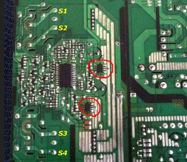

              OK so here's what i did.. first of i have this http://www.goodluckbuy.com/images/de...ku_73585_2.jpg,
              i have to use this link instead..
              anyway yes the LCD backlight is indeed working good using the supply of that light that i used to test.
              In my experiment i also used the ccfl lights and use it in the board and what i found out is, it lights up then turn off... i dont know whats wrong with it this time. could it be theres another component that is faulty? all electrolytic caps are already replaced except the big one.
              and another observation is that when i use the main backlight of the LCD i noticed sparking kind of thing like a short circuit... probably a bad connection i rather have to caulk it or use glue to fix it.. anyhow the LCD backlight is proven to be in good condition so we have to focus on the board..
              again by using the ccfl that i use to test it turns on for a sec then off.. then nothing happens..
              hope this explains everything so that we can go directly to the faulty component.. hoping we can resolve this soon..
              thanks so much guys for being specially budm happy new year.............

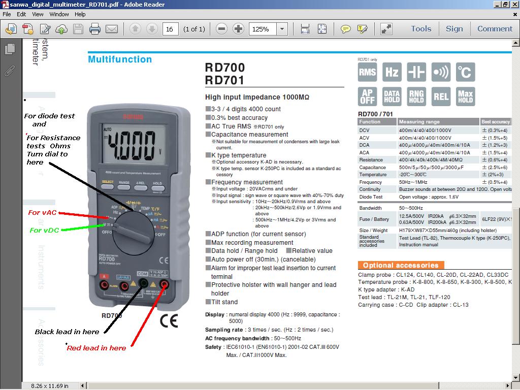

                  thanks to the picture but i dont know how if im going to use the digital multimeter.. i need help on that one.
                  thank you, looking forward for another result...

                    Please tell us the model of your multimeter

                        im using a sanwa rd701
                        heres a reference pic
                        http://www.e-v-t.ru/imgbig/sanwa/pc520m/pc520m_1433.jpg

                          Hello, jahjhai, have you managed to find out the problem?
                          those mosfets are 8309 not 8303.
                          I have the same board, same problem.
                          I replaced caps, mosfets and now backlight comes on for 2 sec, then only image, no backlight.
                          I found one smd resistor, and one smd cap which look burnt. Those are for OVP circuit for SEM2000. I found a schematic for sem2000 usual setup and it looks pretty much like the one on board, but there are no values there.
                          Anyway, i measured the voltage on OVP pin for sem2000 and it rises to 5V. In the datasheet says that this value should be around 2V.
                          Can you tell me from your board what values are written on the resistors. I have attached a picture here:
                          https://www.badcaps.net/forum/showpo...8&postcount=59
                          The culprits are marked with red.
                          What i did is i removed the resistor which looks damaged from the board and the problem is the same, 2 sec backlight, now the voltage on OVP pin on sem2000 is around 5V from the begining, it's not rising anymore.

                              You can buy them on ebay - will ship to Philippines
                              To test see this thread
                              https://www.badcaps.net/forum/showthread.php?t=25926
                              Meter instruction see attached picture
                              For Resistance and Diode tests No POWER TO SET

                                  OK, that is why I cannot find the spec. I would check the DET pin which is for Open lamp/lamp will not fire up, if the lamp has open wire, I would expect voltages at DET and OVP to go above normal.
