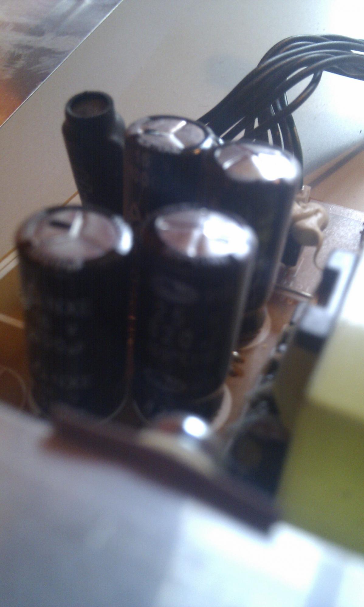

    I have a Samsung 2253LW that's been going strong for 3.5 years but the last few days randomly decides if it's going to work or not (sometimes pulling the plug out and sticking it back in will fix it, other times not).
    Ive got it in pieces right now and can identify 2 bulging capacitors, both are Sam Young 25v 820uf 105 degrees - I thought it would be a straight swap but having searched the forums it looks like there are a lot of capacitors that match that description!

    I would suggest you to use PANASONIC FM or FR series for the replacement. You should repalce the whole set of caps in the secondary side of the power supply at least.
    http://search.digikey.com/us/en/cat/...panasonic%20FM
    Post the pictures of the board.

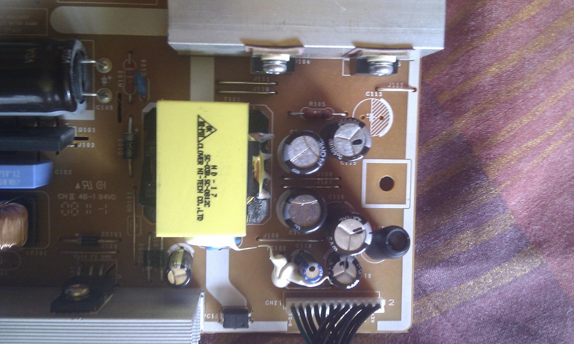

        I stupidly didn't take a pic of the whole board - I had to reassemble the monitor due to space. (phone quality) pic of capacitors attached.

                    After swapping the 2 820uf 25v I still got nothing and realised the 47uf 50v cap had also blown - just swapped this out for a new one and now when I plug the monitor in the blue light slowly flashes and I hear a high pitched whistling noise - the back-lights don't come on however and I don't see anything on the screen.
                    All other caps look OK - is there any more I can do or is this thing dead?

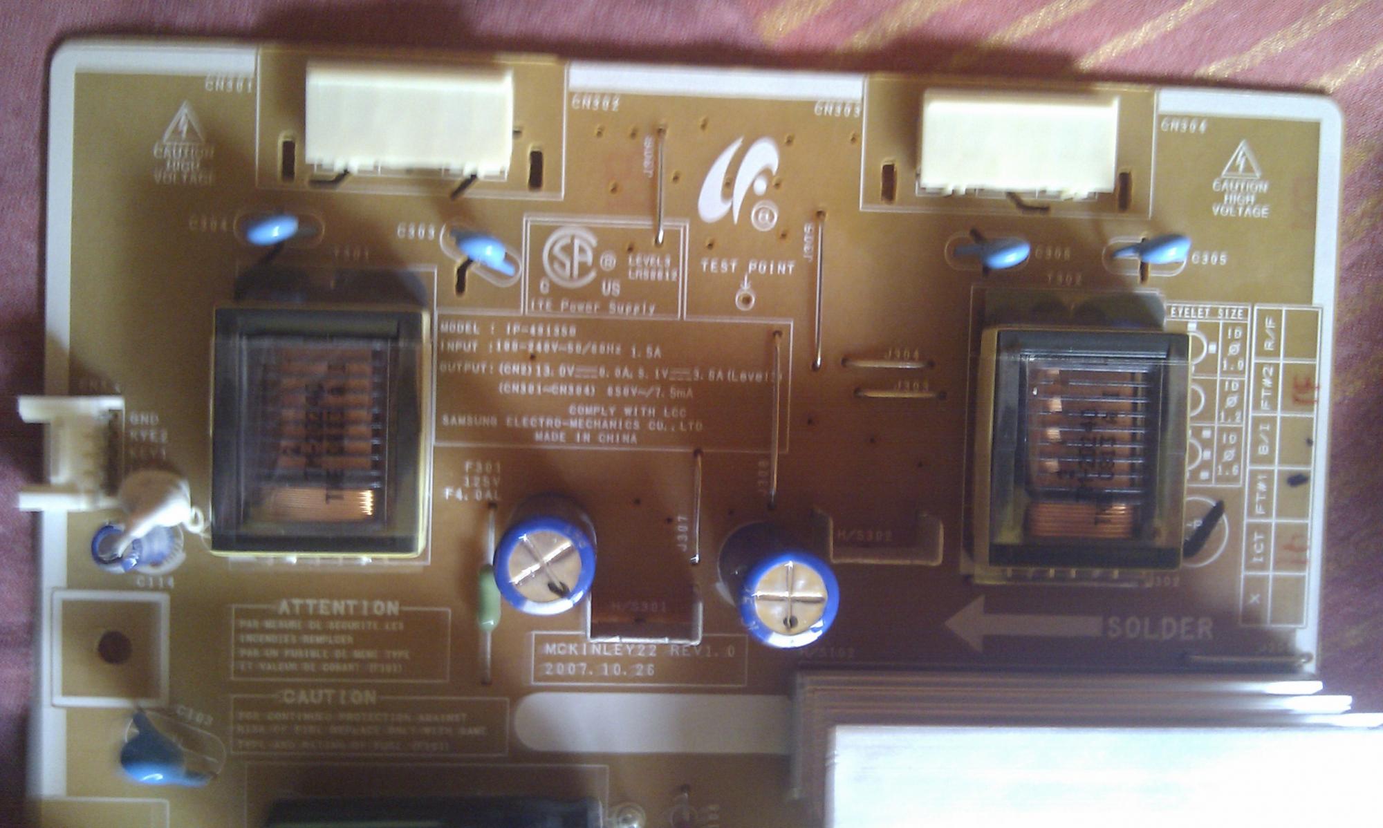

                      Hi - what make cap did you use for the small one - If that is on the primary side it is probably the startup cap so a decent brand/series is essential.
                      With it all connected up and powered on what are the voltage readings on the connector out. Cant see the board markings -looks like 12 pins

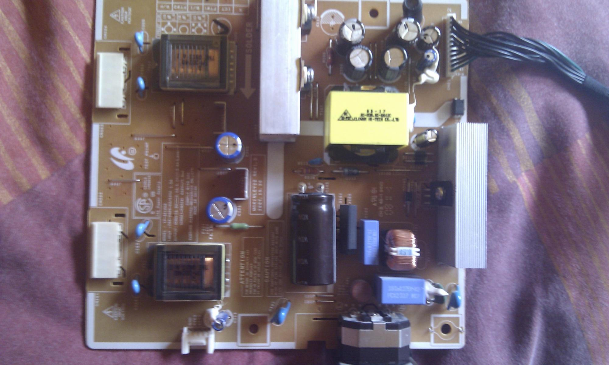

                      To be honest there are so few caps on this board you should have replaced all of them to give it the best chance

                        all caps are Panasonic FC.
                        The start-up cap seems to have definitley worked as I didn't get blue light at all before.
                        Caps not replaced:
                        Far side:
                        2x 820uf 25v
                        1x 16v 100uf
                        Inverter side:
                        2x 16v 1000uf
                        1x 50v 10uf
                        1x 10v 33uf

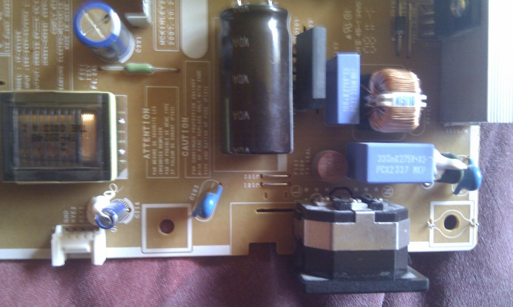

                        the massive cap - think its a 100uf 450v but the label is against the PCB and dont want to move it really.
                        everything looks OK, no bulging or puffing. all original caps look to be Sam Young.

                          board markings are
                          B-DIM
                          13.0v
                          GND
                          GND
                          5.1V
                          5.1V
                          A-DIM
                          on/off
                          3.3v
                          LED
                          KEY1
                          KEY2
