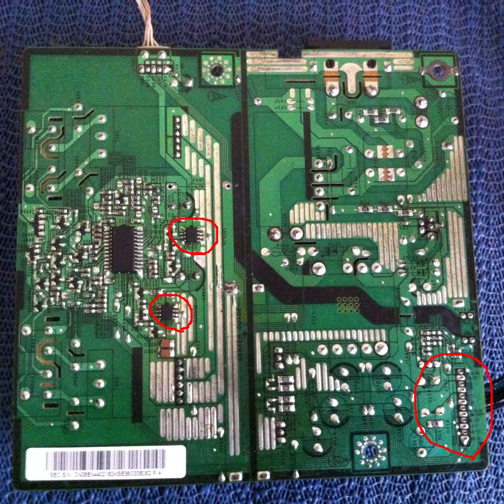

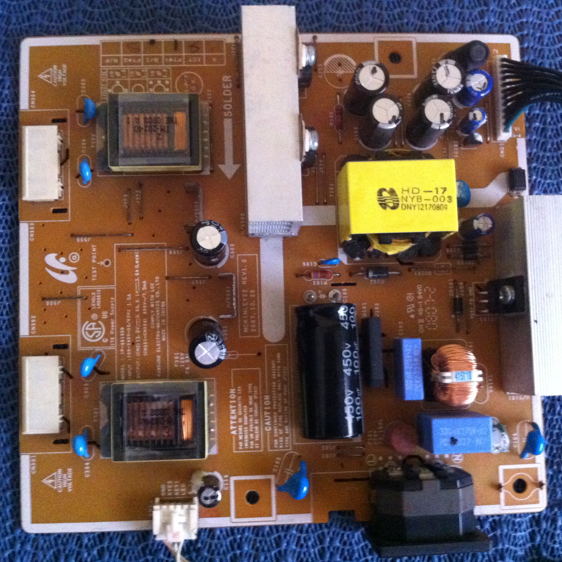

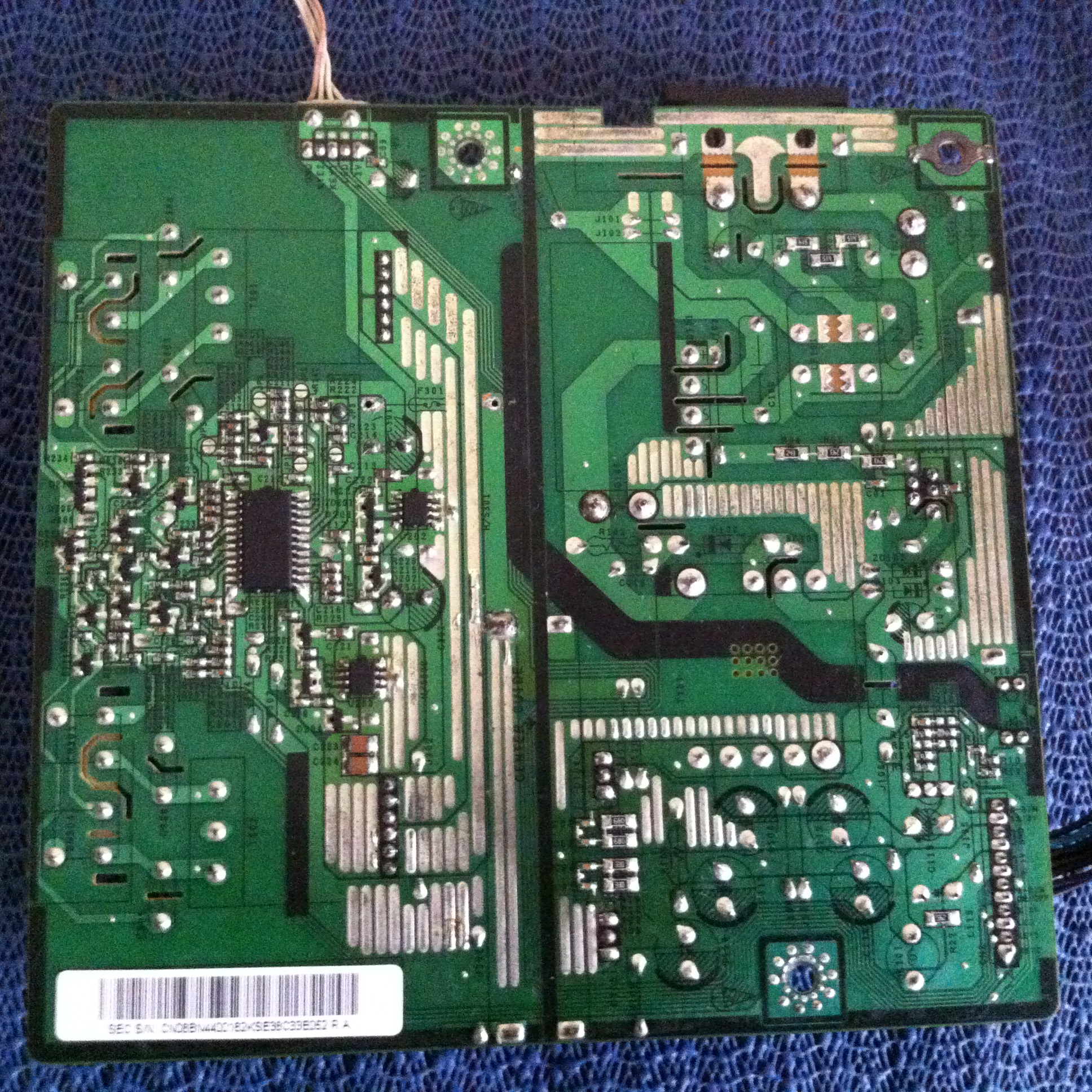

                          #32
                          Re: Samsung 2253LW
                          here are the pictures you have requested...
                          thanks and advance happy new year...
                            #33
                            Re: Samsung 2253LW
                            OK, please give me the label of those pins and the P/N of those two MOSFETs.

                              Re: Samsung 2253LW
                              Originally posted by jahjhai
                              greetings... holidays make me busy fixing my things.. now i have the voltage reading for the components needed.. the 5V voltages are in good condition, yes i do understand logic circuits, they need 5 volts to operate to get low or high signals.
                              anyway the MBR20100CT has two terminals with 1 common cathode. the first i test has voltage reading of 5.33V on each anode.. while the other MBR20100CT has a higher voltage which is 18.88V and i tested this without the fuse resistor to determine whats goin on...
                              also i have some voltage data for the DM0565R
                              Pins in Order:
                              1. Drain = 302V
                              2. GND
                              3. Vcc = 14.82V
                              4. FB = 0.647V
                              5. NC
                              6. Vstr = 296V
                              AC supply is 220V
                              with a fuse resistor voltage is 16V
                              without it becomes 18V
                              backlight nevers lights up..
                              Those readings are kinda on the high side, as usually on the 2253LW the voltage to the inverter section should be around 13V to 14V. You can also force the backlight to power up manually (without using the Dscaler board)...
                              Have you replaced all the capacitors at the secondary side yet? Looks like el-cheapo capacitors there especially on the inverter side...
