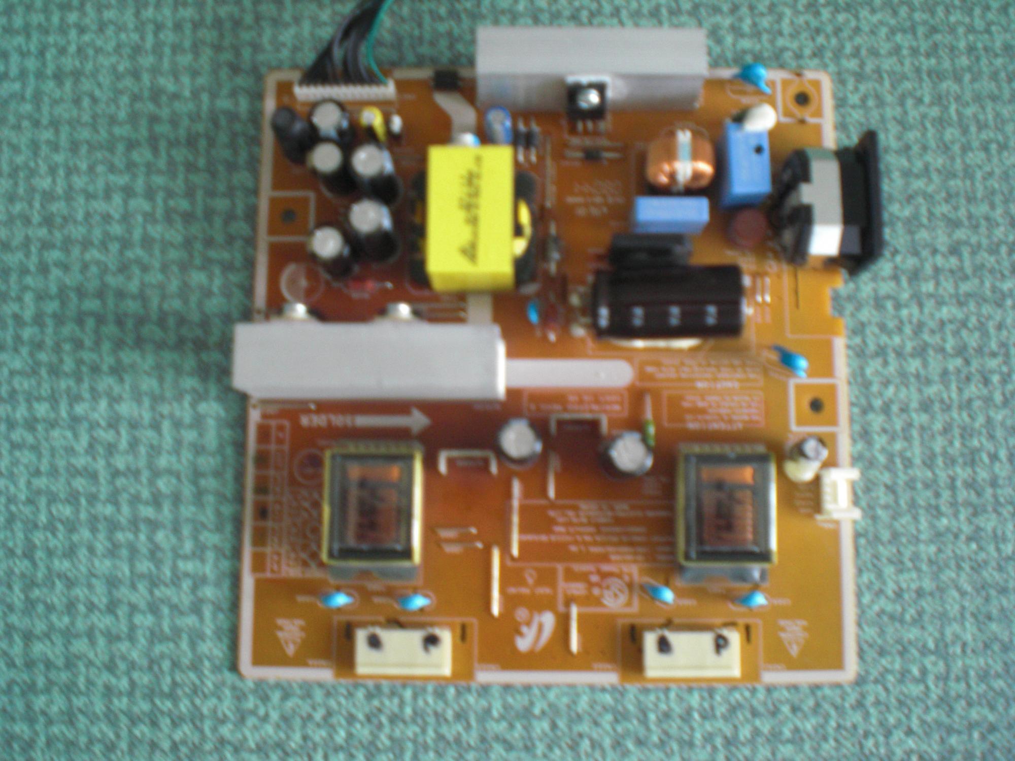

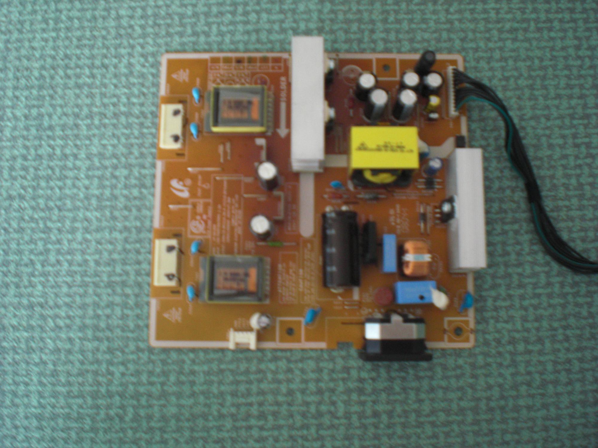

Syncmaster 2253lw inverter "not turning on"
  • retiredcaps
    replied
    Re: Syncmaster 2253lw inverter "not turning on"
    Originally posted by Jasgriff
    And Mr Retiredcaps will more than likely be along shortly to advise you on a good mulitmeter. I am sure there were some good ex military/government meterman ones that he has found before. Not sure if they are still kicking about.
    The 34XR $10 deal is long dead. This was the original deal 2 months ago.
    https://www.badcaps.net/forum/showpo...02&postcount=8
    @nickt1862, what is your budget for a multimeter?
    If you don't mind buying off ebay, this is a decent deal.
    $12.47 + free shipping for a Meterman DM9B (I have the predecessor to this one)
    http://www.ebay.com/itm/110642474359
    The DM9B will certainly be more than adequate for troubleshooting and a good overall tool.
    Last edited by retiredcaps; 05-06-2012, 05:03 PM.
    Leave a comment:
  • Jasgriff
    replied
    Re: Syncmaster 2253lw inverter "not turning on"
    And Mr Retiredcaps will more than likely be along shortly to advise you on a good mulitmeter. I am sure there were some good ex military/government meterman ones that he has found before. Not sure if they are still kicking about.
    Leave a comment:
  • nickt1862
    replied
    Re: Syncmaster 2253lw inverter "not turning on"
    Originally posted by Jasgriff
    Multimeter's are not that expensive to buy if you are just doing the basics.
    You are right on the fuse testing however you wont need to take out the fuses to test them. Make sure that there is no power going to it whilst your checking.
    Leave a comment:
  • Jasgriff
    replied
    Re: Syncmaster 2253lw inverter "not turning on"
    Multimeter's are not that expensive to buy if you are just doing the basics.
    You are right on the fuse testing however you wont need to take out the fuses to test them. Make sure that there is no power going to it whilst your checking.
    Leave a comment:
  • nickt1862
    replied
    Re: Syncmaster 2253lw inverter "not turning on"
    Photos of the board.
    Leave a comment:
  • nickt1862
    replied
    Re: Syncmaster 2253lw inverter "not turning on"
    Deleted subpar photos - new ones in next post.
    Last edited by nickt1862; 05-06-2012, 12:46 PM. Reason: Deleted subpar photos
    Leave a comment:
  • nickt1862
    replied
    Re: Syncmaster 2253lw inverter "not turning on"
    Originally posted by Jasgriff
    Do you have a multimeter and know how to check them?
    Setting the meter to OHMS and a good fuse should read almost zero ohms.
    Most people say to take the component out to test and the probes on both leads.
    Now I have to work on acquiring a multimeter.
    Always wanted to get one, never got around to it or had a good enough reason to get one.
    Nick
    Leave a comment:
  • Jasgriff
    replied
    Re: Syncmaster 2253lw inverter "not turning on"
    Do you have a multimeter and know how to check them?
    Leave a comment:
  • nickt1862
    replied
    Re: Syncmaster 2253lw inverter "not turning on"
    Originally posted by Jasgriff
    Are the fuses testing as open?
    Jasgriff,
    I didn't get that far yet.
    Nick
    Leave a comment:
  • Jasgriff
    replied
    Re: Syncmaster 2253lw inverter "not turning on"
    Are the fuses testing as open?
    Leave a comment:
  • nickt1862
    replied
    Re: Syncmaster 2253lw inverter "not turning on"
    1) The 47uF 50V is probably your startup cap. It helps the SMPS startup properly.
    2) If this was my monitor, I would have replaced the first 3 and left the big filter cap as is (100uF 450V).
    3) If the backlights are not coming on and you have proper DC voltage to the inverter section, then you could have a blown fuse and/or shorted out mosfets/transistors in the inverter section.
    retiredcaps,
    Yeah replacing the rest except the 100uf 450v was my plan and it seems is what I'll do first and see what happens. Those remaining 4 are all Chinese branded garbage.
    One fuse on mine is a button type 250v, T3, 15AL.
    The other by the inverters is a 125v, F4, 0AL
    Nick
    Leave a comment:
  • nickt1862
    replied
    Re: Syncmaster 2253lw inverter "not turning on"
    Originally posted by Jasgriff
    Hi Nick,
    Does the screen flick on for 2 seconds or does it not flick on at all?
    And yes the other caps can still cause problems even if they are not showing bad signs as you said. I think most would eliminate that risk by swapping them.
    Jasgriff,
    Nope, no flickering at all.
    All the caps on this board were all chinese garbage ones except for 2 Sam Young caps which was part of the initial replacement, till I replaced the ones I mentioned with Rubycon caps ordered through badcaps.net.
    Nick
    Leave a comment:
  • retiredcaps
    replied
    Re: Syncmaster 2253lw inverter "not turning on"
    Originally posted by nickt1862
    The caps I didn't replace which weren't bulged/puffed up:
    1 x 10uf 50v
    1 x 47uf 50v
    1 x 100uf 16v
    1 x 100uf 450v
    1) The 47uF 50V is probably your startup cap. It helps the SMPS startup properly.
    2) If this was my monitor, I would have replaced the first 3 and left the big filter cap as is (100uF 450V).
    3) If the backlights are not coming on and you have proper DC voltage to the inverter section, then you could have a blown fuse and/or shorted out mosfets/transistors in the inverter section.
    Leave a comment:
  • Jasgriff
    replied
    Re: Syncmaster 2253lw inverter "not turning on"
    Hi Nick,
    Does the screen flick on for 2 seconds or does it not flick on at all?
    And yes the other caps can still cause problems even if they are not showing bad signs as you said. I think most would eliminate that risk by swapping them.
    Leave a comment:
  • nickt1862
    started a topic Syncmaster 2253lw inverter "not turning on"
    Syncmaster 2253lw inverter "not turning on"
    Okay, the caps I replaced because of buldging/puffiness:
    2 x 1000uF 16v by the inverters
    1 x 330uF 25v
    4 x 820uF 25v
    The caps I didn't replace which weren't bulged/puffed up:
    1 x 10uf 50v
    1 x 47uf 50v
    1 x 100uf 16v
    1 x 100uf 450v
    I know that caps that look good doesn't mean they are good and that the 100uf 450v cap has a low failure rate.
    The lcd ccfl's are fine = 1000% sure of this but they are not lighting at this time.
    Having said all of this by your past experiences can any of the remaining caps NOT replaced cause the lcd ccfl's not to light up?
    I am ready to replace 3 of the 4 remaining for starters not replacing the 100uf 450v one - yeah watch you all say that this would be the possible culprit.
    I already repaired another 22" Samsung lcd monitor which I'm using now, but this one I'm inquiring about is a tad more challeging, lol!
    Any input would be greatly appreciated.
    Thanks so much!
    Nick
  • x_orange90_x
    Vizio E55-E1 bad backlights or bad inverter?
    by x_orange90_x
    I just got this tv today and it appeared to have no backlight on. After taking off the rear cover and checking again in the dark I can see that MAYBE one quadrant is lit.. But still it's quite dim. I was going to check the LEDs with my tester, and I found LED 1 and LED 2 + pins on the wire from the inverter, but I couldn't identify a ground. Nonetheless I tried using a mounting screw on the inverter board and also the chassis as ground but regardless my tester reads 300 which is what it reads when there is no voltage draw.
    I don't know how exactly to test the inverter itself. Is it...
    01-29-2025, 09:24 PM
  • Gentian
    APSINT3636VR 3600W APS INT Series 36V DC 230V AC Inverter/Charger schematic
    by Gentian
    I have a tripp-lite aspint 3636vr inverter charger which blow some of mosfet transistors. I replaced them repaired also the driver circuit and tested but the mosfets burn again.
    It work very well as inverter and also as charger if I let the rear switch in auto mode (inverter) and charger only(charging) but in auto when I connect the feed line 220V AC first time it pass ok to line and start charging the batteries but when I remove the feed line it pass to inverter mode and if I do it again the second time when passing from charging to inverter the Main transformer start making a...
    03-06-2023, 07:07 AM
  • valvashon
    Insignia NS-LCD19-09 (PS OK, Inverter problem?)
    by valvashon
    For some reason I'm just not going to let this 19" TV defeat me. I guess because I have a schematic to work from I feel like I'm oh so close.
    History- while adding a turn-on circuit I let a small screw roll under the power board. Worked through all of that circuitry, probably replacing a MOSFET and PWM controller that were not bad but I was following the service manual. Finally figured out that the power supply is in working order when the inverter section (for the backlights) is disconnected. When the +12 supply to the inverter is disconnected the +12 and +5 will come up...
    01-04-2024, 01:44 PM
  • eccerr0r
    A modified sine wave inverter + a grid tie inverter?
    by eccerr0r
    If I had a solar fed grid tie inverter (GTI), a modified sine wave inverter, and a power outage occurred, what would happen if you disconnected mains, backfed the modified sinewave inverter (MSI) into house power, and hooked up the GTI to the output of the MSI, would it work?
    Next thing is trying to charge the batteries using solar power, but that's another issue ...
    08-31-2023, 09:14 PM
  • caseyjay_48
    Sony KDL-46BX450 Inverter Troubleshoot Logic
    by caseyjay_48
    I am currently on a troubleshoot of 46” Sony KDL-46BX450 tv. I came back from Washington to Texas on medical emergency and had to leave all my tools up there. All I have is a couple of screwdrivers and a dvm. I wish to ask the community a troubleshooting question. Please forgive stupid questions as meds I am taking produce brain fog.
    I have well maintained Sony KDL-46BX450. It went black one day. After turn-on, I get solid green light and Sony logo in screen center for about 1-2 seconds, then black. No blinking LEDs, no hissing. Flashlight test shows screen characters dimly viewable,...
    09-23-2022, 08:08 PM
