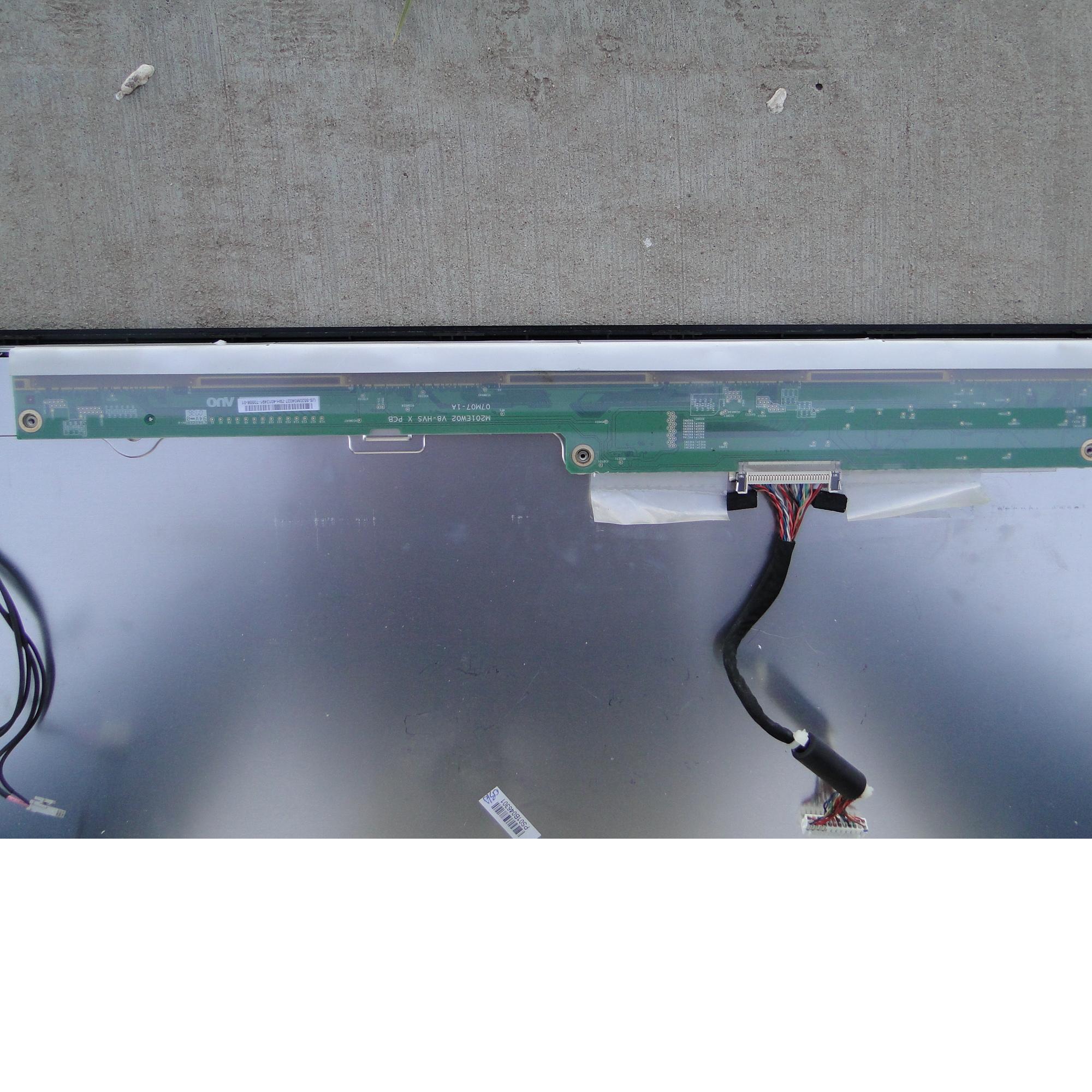

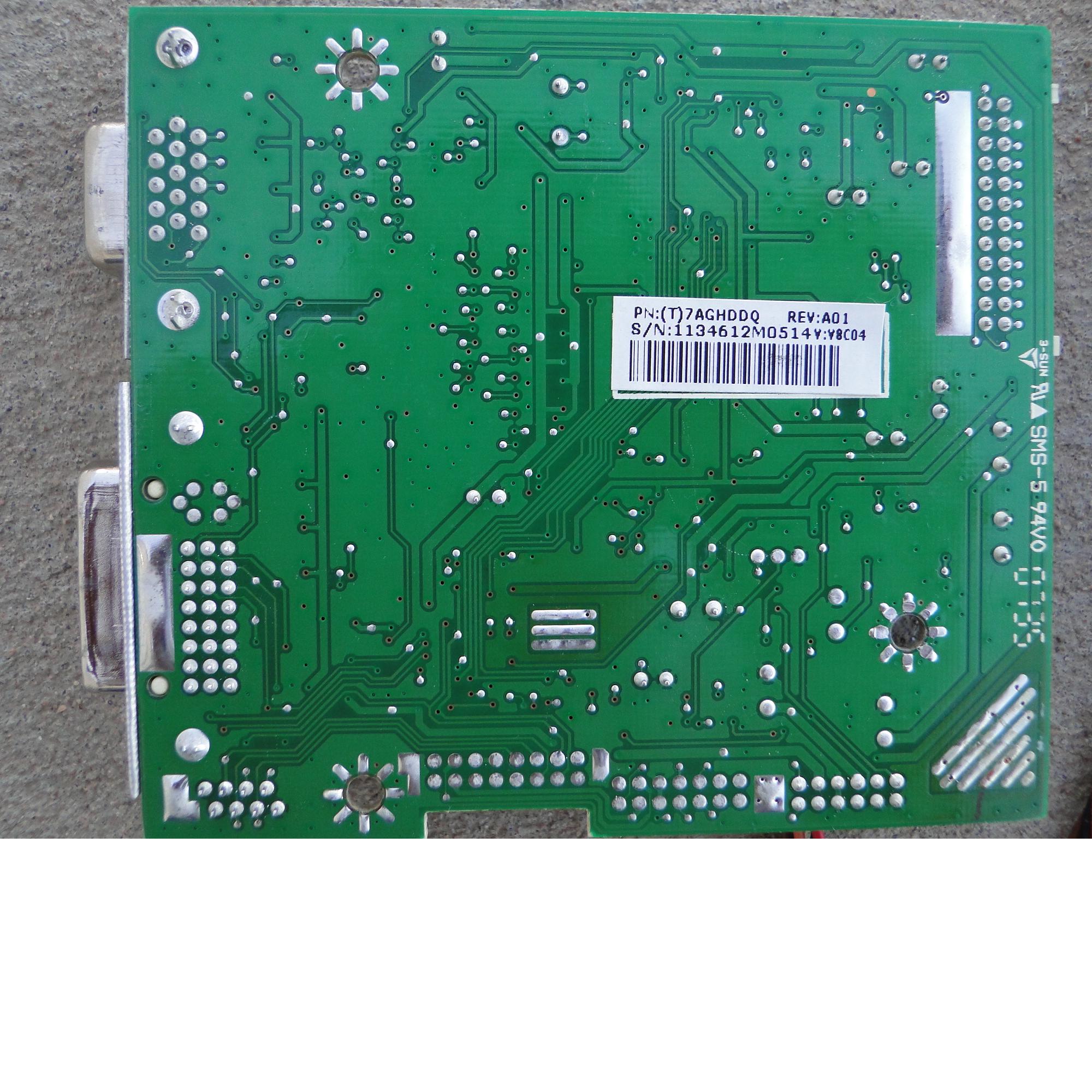

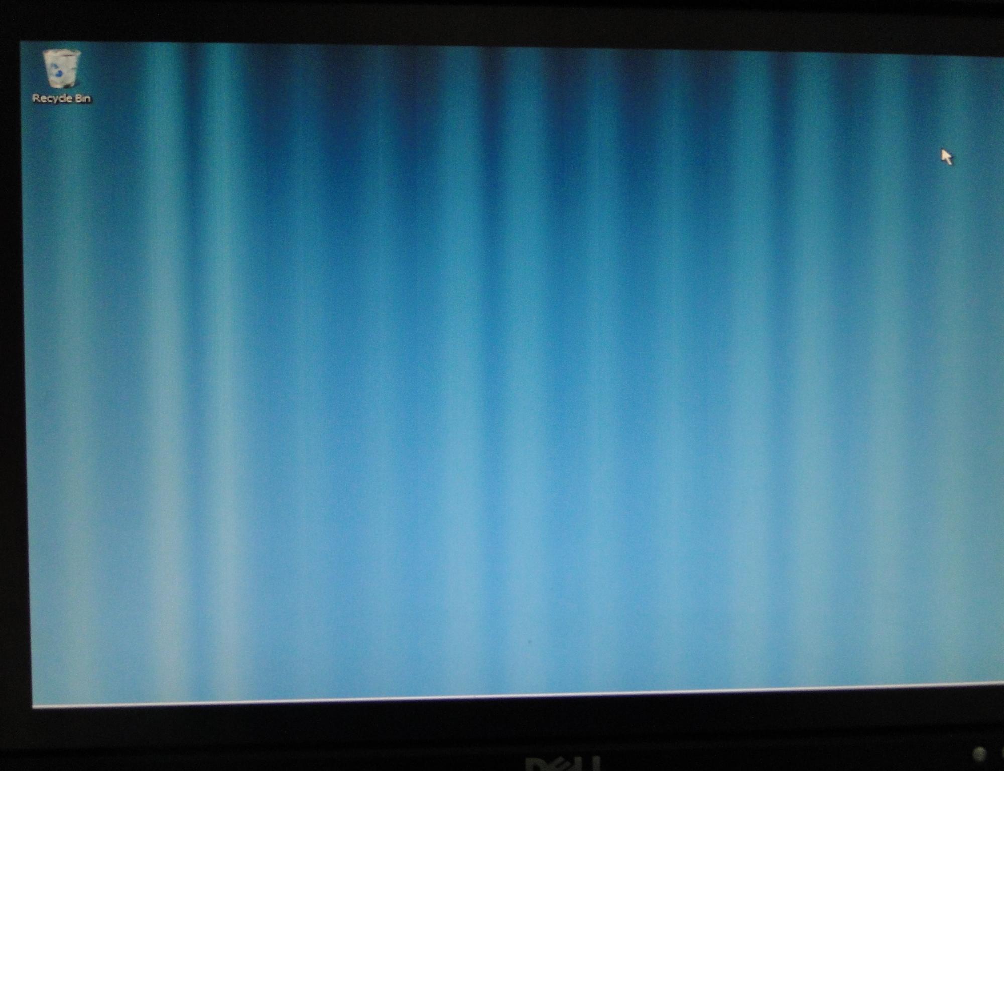

    Hello All,
    First post great forum!!

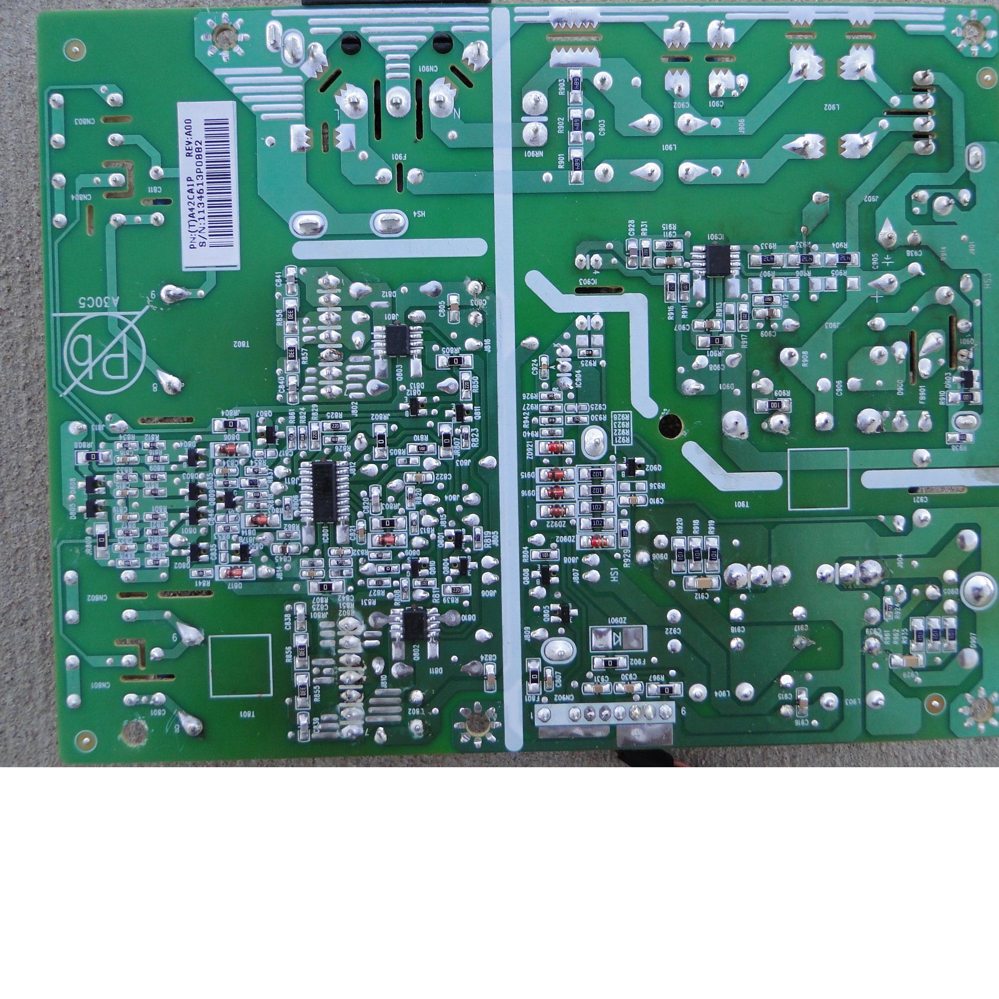

    Please see attached. I have two of these Dell E207WFPc's that are doing the same thing. I have searched this forum for related symptoms with no luck. Was hoping someone can look at picture and point me in the right direction. Have all test equipment at my disposal if needed.
    Thanks,

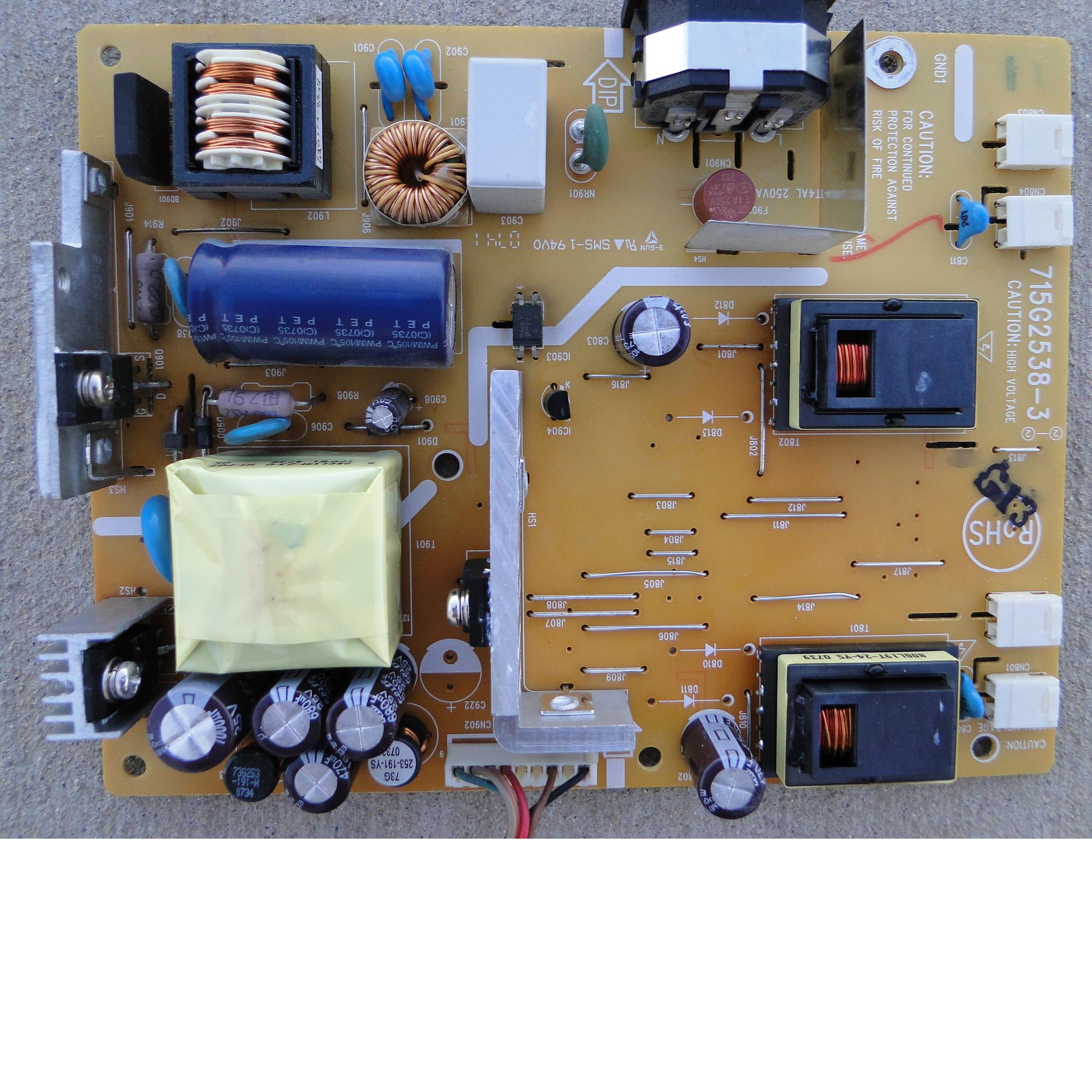

    Update: All voltages from the power supply look normal. Verified all voltages on regulators of the video board. Not sure what the voltages are supposed to be leaving the video board to the panel. Removed and re-soldered inverter transformers. Saw a post somewhere about bad solder joints at these transformers. Lines are present with or without input connected. Lines also present on OSD.

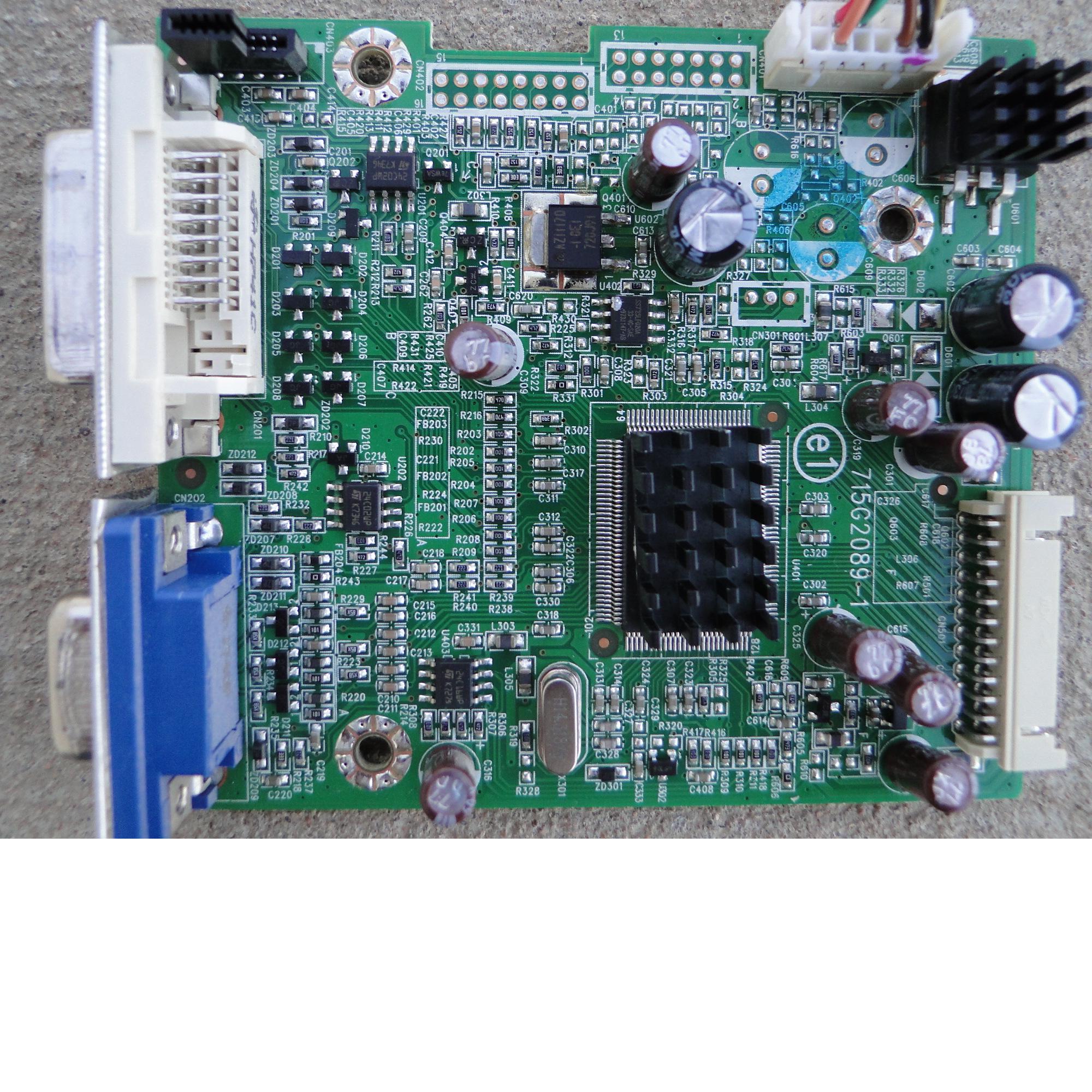

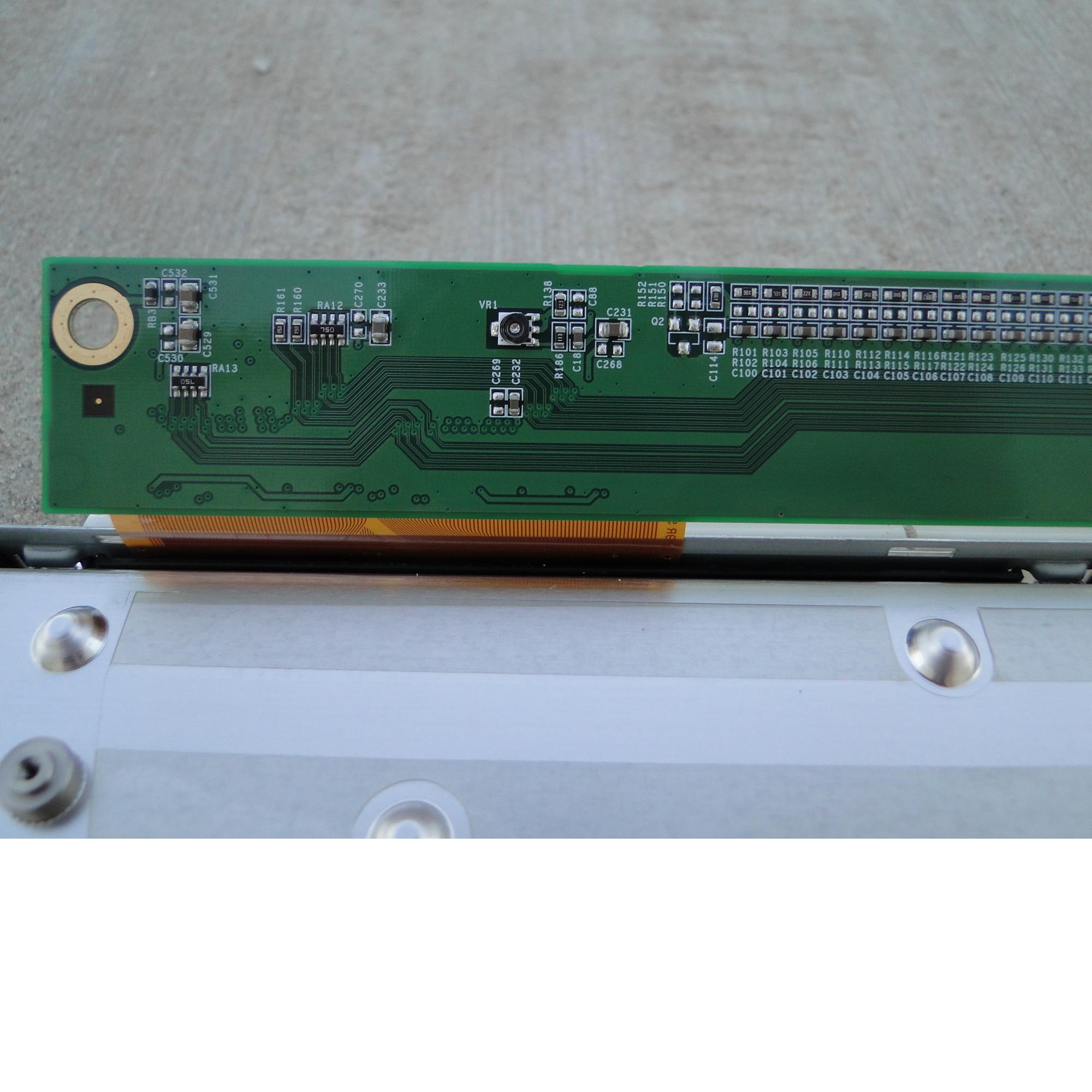

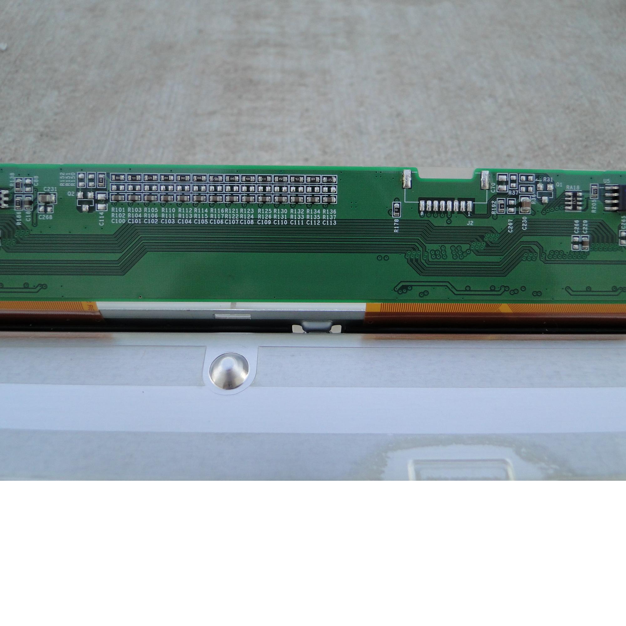

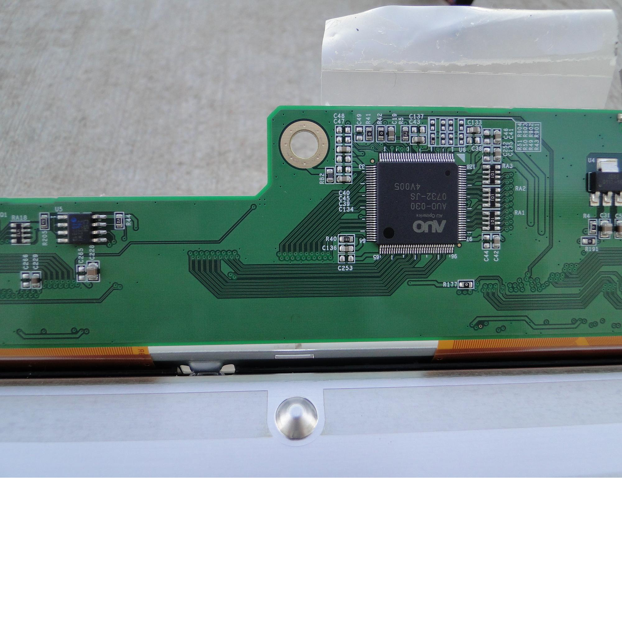

    1) Post clear focused top down pictures following my sig file below exactly.
    2) List your power supply voltages and list the part numbers for the voltage regulators and their measured voltages so we can verify.
    3) Include a picture of the panel board. This board is at the top of your lcd and runs the entire length of the lcd. It might be behind a metal shield.

        Voltages exiting power supply
        N/F - 3.07v
        N/C - 0
        Dim - .384v
        +14 - 14.27v
        +14 - 14.33v
        +5 - 5.66v
        +5 - 5.05v
        Gnd - 0v
        Gnd - 0v
        U601 on Video Board - No part number covered with heat sink.
        Pin 1 - 0v
        Pin 2 - 3.38v
        Pin 3 - 5.09v
        Q401 on Video Board - AZ1117D1.8E1
        Pin 1 - 0v
        Pin 2 - 3.30v
        Pin 3 - 1.83v
        U402 on video Board - 691D6
        Pin 1 - 0v
        Pin 2 - 3.03v
        Pin 3 - 4.97v
        No voltage measurements have been taken on the Panel Board yet.

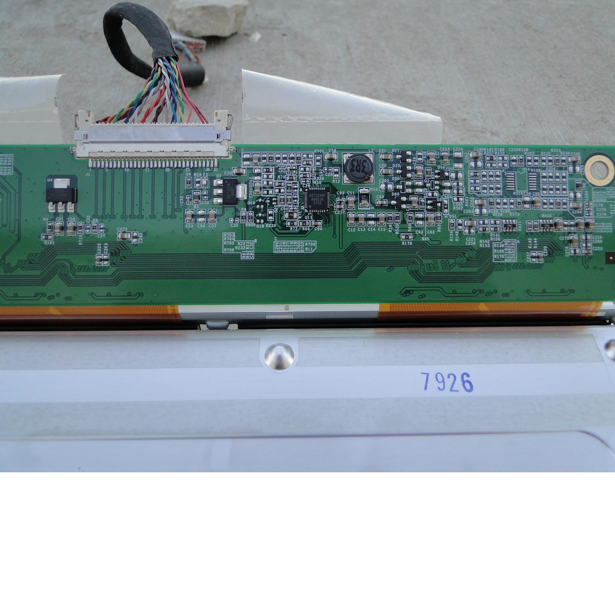

          Measured both regulators on the Panel board.
          J293 9177-18
          Pin 1 - 0
          Pin 2 - 1.81
          Pin 3 - 3.28
          J293 9177-33
          Pin 1 - 0
          Pin 2 - 3.29
          Pin 3 - 4.77
          Just do not know enough about panel boards at this time to know what else to look for.
          Thanks,
          Chuck
            Pin 1 - 0v
            Pin 2 - 3.03v
            Pin 3 - 4.97v
            From what I can see, U402 is a 8 pin IC on the video board?
            Please circle the 3 pin voltage regulator that you are referring to and double check the voltage on pin 2.

              Re: Dell E207WFPc Vertical Lines
              Sorry typo on my part..it's u302. I was verifying voltages as per post from PlainBill below.
              https://www.badcaps.net/forum/showth...207wfpc&page=4
              Not sure which pin is which but
              Top left is 3.03v
              Top Right is 0v
              Bottom is 4.97v
              The number on the IC is 691D6. Not having any luck identifying it.
                These pictures are marvellous - you wouldnt believe some of them we see, or rather dont see.
                I dont know if it is relevant but in Pic 1 (Panel Board) there is a fuse F5 just to the left of U1 As you get pics and OSD on screen I dont think it can have gone but always worth checking.
                Also I am wondering if your unidentified 691D6 and Killian6pk's unidentified 6910P could be a G910 -Retiredcaps might advise.
                  I know I know I know this is a very very old thread and thread necromancy is generally frowned upon at pretty much every forum online but...
                  I just got one of these monitors and it's exhibiting the same symptoms. It works great, but obviously those vertical disruptions are somewhat irritating - does anyone know if there was ever a specific diagnosis found and a specific fix, whatever it might happen to be? Hate to just toss out the display because of something that might potentially be fixed with something simple but I don't have a clue myself, just learning from others.
                  If anyone has any info I'd greatly appreciate it, thanks.
