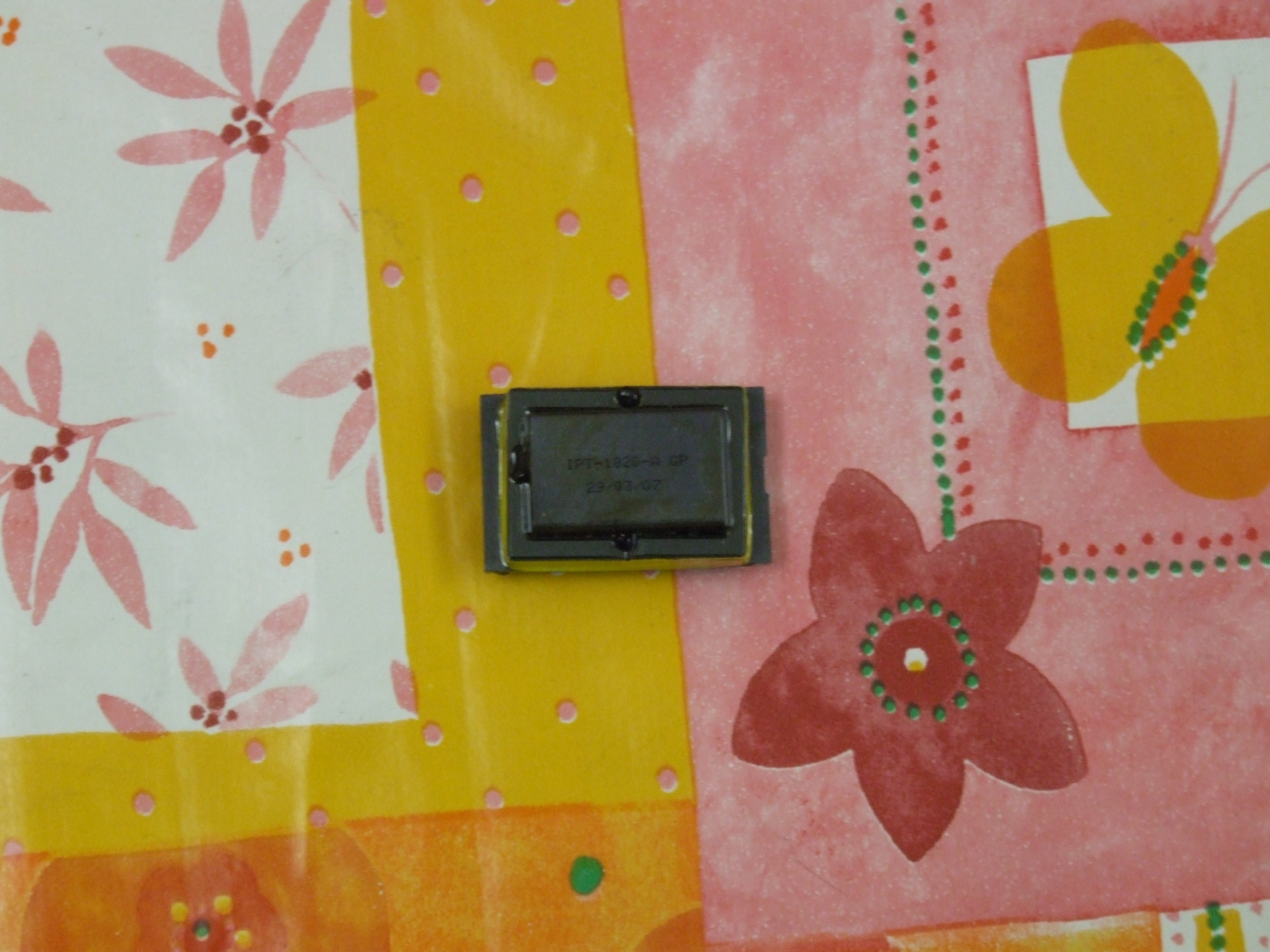

      I find the T302 ( an IPT-1820-A-GP ) open on the primary...
      I oredered on a local shop, but need some days to recive.

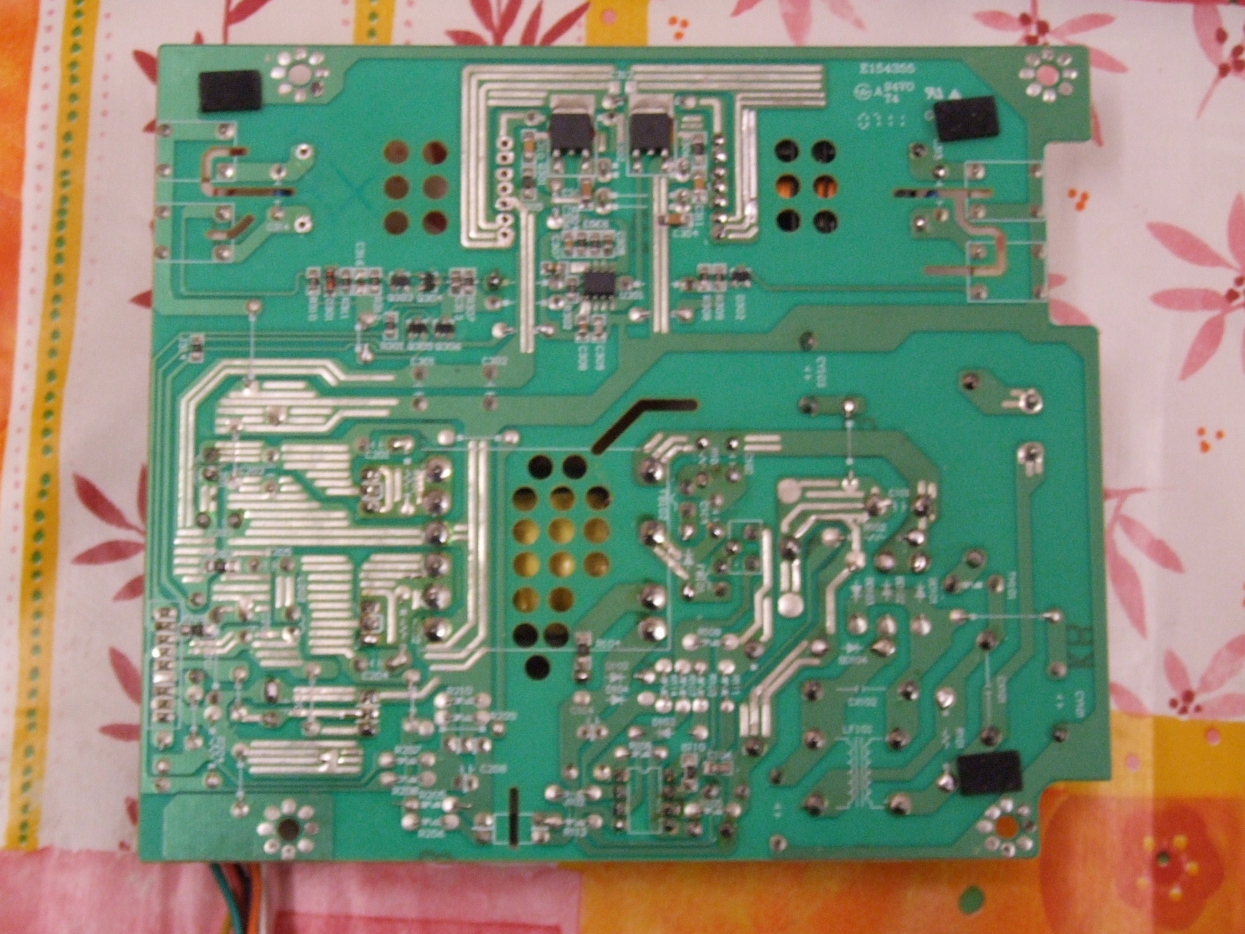

          Pics:
          Top view:
          Detail 1:
          Detail 2:
          Detail 3:
          Rear view:
          Electronic board:
          Flip971.

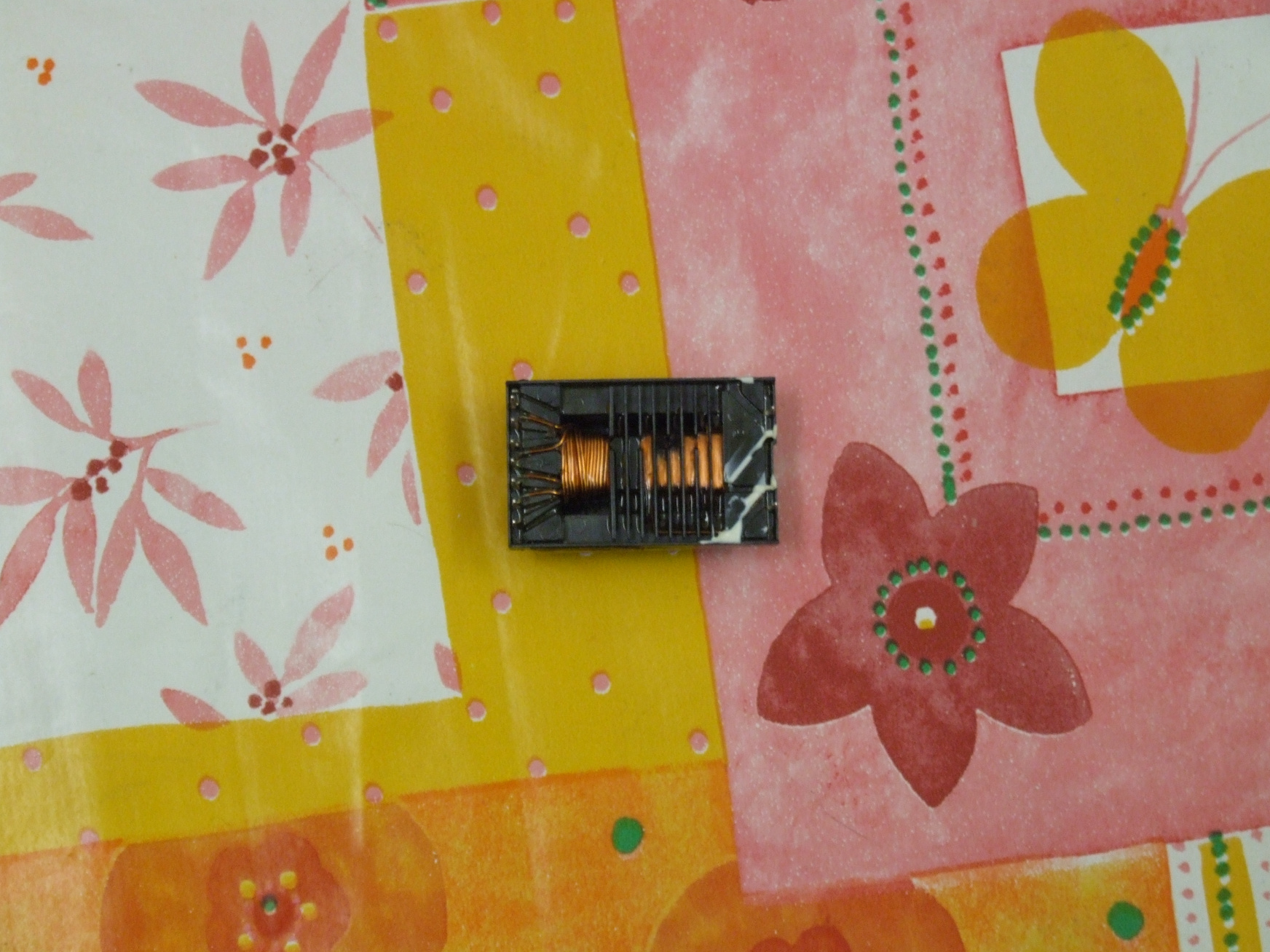

            Re: Airis lcd monitor m143b
            Yes that is the secondary winding that has burnt out .

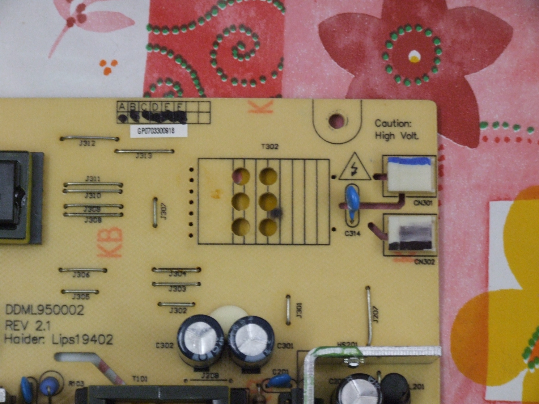

              Look at connector CN302 as shown in detail #1 photo. The inside of that connector looks like it has carbon tracking (burn marks).
              Check that connector and its mate going to the ccfl. Carbon tracking is conductive.
              IMO, that connector went bad (loose connection) and took out the transformer.
                Same goes for cn03 , however there is no scorching to the bottom of the board so I decided it was part of his labelling system. Or marked and rubbed off. Anyway as delaware says check the plugs as well to eliminate this as a problem.

                  Thanks to all for the information gaven
                  Finally, I recive yesterday the inverter transformer.
                  Mounted and...
                  Ok it works!!!!!
                  @delaware74b, selldoor: the marks on the connector are maded by a marking pen ( sorry for the blurry photos ).
