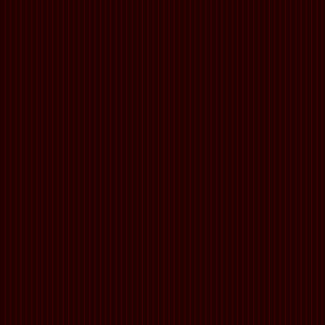

    I recently repaired a veiwsonic VP201 by replacing the large cap (400/150) on the PSU board, thanks to helpful posts on this forum. The monitor now comes on and stays on, hooray. The new issue is that in dark or black areas there are vertical lines of red, single pixel in width across the entire screen. Like mini pin-striping. This is very visible in dark/black areas. For instance when the back-light first comes on with no PC input. Also when the PC is plugged in via the DVI or VGA cables, you can see it in mid tone areas too, it seems to make those areas flicker or look like they are vibrating. Also it makes the display look as though it is in a low color mode. Remember the days of 256 colors? Doing some research on this and other sites, my guess is that it might be the inverter board. But as I'm only an amateur/hobbyist when it comes to electronics, I though it would be good to get more opinions before I go opening the case again. Any thoughts? Thanks in advance...

    Was it your monitor - did you see it working before you fixed the cap issue.
    If it was yours and was ok before then you may have not replaced the cable that goes to the panel correctly or dislodged it slightly. Try removing it and replacing - if it is a flat cable clean both ends. Hopefully it will be something simple like that although you could have damaged the panel putting the cable back. It is unlikely to be an inverter problem.
    Edit_ didnt mean cable back - meant putting the panel back into the case

        It is my monitor. It was working before I replaced the cap on the PSU. But only for minutes at a time. It would get hot and shut down. Then after a period of cool down time you could turn it back on, and it would work until it heated up again and shut off. And by shut off I mean the display would go dark, but the led on the front of the display would stay lit. It was the backlight that would shut off. Anyway that issue is resolved. I dont recall having the vertical lines issue prior to replacing the cap on the PSU. But to be fair this display sat in a closet for a year or more until I came across this forum and saw people with similar issues and learned how to repair the unit. So Its been quite a while since I used it on a regular basis. It may very well have had this issue as well, and I am not remembering. I will try cracking the case again and reseating the cable connections to all boards, and see what happens. Thanks.

          It's a possibility that when you were taking the monitor apart, you might have damaged one of the flat ribbon cables that connect the LCD panel circuit board to the LCD panel itself. These ribbon cables span the width of the LCD panel. With your finger, try pushing down on the cable in the vicinity of the red line. If the line changes color or goes away, then you've found your problem.

            Actually its not one line its lines across the entire width of the screen - evenly spaced. I am posting a pic of what it looks like. Since I can't do a screen cap and my camera is not taking good enough pics to show, I recreated what it looks like in photoshop. This picture shows what my a section of my whole screen would look like. I didn't think I needed to make a graphic the full 1600 x 1200 size of the display. Just imagine this pattern the full width and height of the screen.

              Are you able to try the screen on another PC/laptop.
              Does it stay the same when you adjust the brightness.
              Is it just on Black - what happens if you put up an all white,red,green,blue
              yellow picture .
              Does it make any difference if you adjust the colour/temp in the OSD
              Is there a factory reset.
              When you say you have tried VGA and DVI are the cables connected at the same time - if so try separate.
              Have you got the service manual -a quick flick suggests you have to actually select the input you want to use? ( Exactly what model have you got.)
              Presumably you have another screen - does that have the same problem.

                  If doing all the things SellDoor suggested did not work then probably one of the ribbon cables from the TCon Board to the LCD screen has become damaged. They are not repairable. Try the suggestion of putting a little pressure on each cable that is over an area with red stripes if they go away or change color then that might be the problem. However, if the lines go all the way or most of the way across the screen then it is unlikely that you have torn all of the ribbon cables as they are somewhat protected by the TCon shield and the TCon being screwed down. In that case the problem probably resides on the TCon board and could be an SMD Capacitor or other component. It will be fairly time consuming to track that problem down and may involve several components. It might be cheaper (time wise) to look on Ebay for a Non-Working model the same as yours and buy it to replace your LCD screen. Look under the section on condition and you will see For Parts or Not Working as a choice. Just make sure the screen is not broken (cracked) before you buy it. Then it will just be a simple matter of changing your boards for the others.
