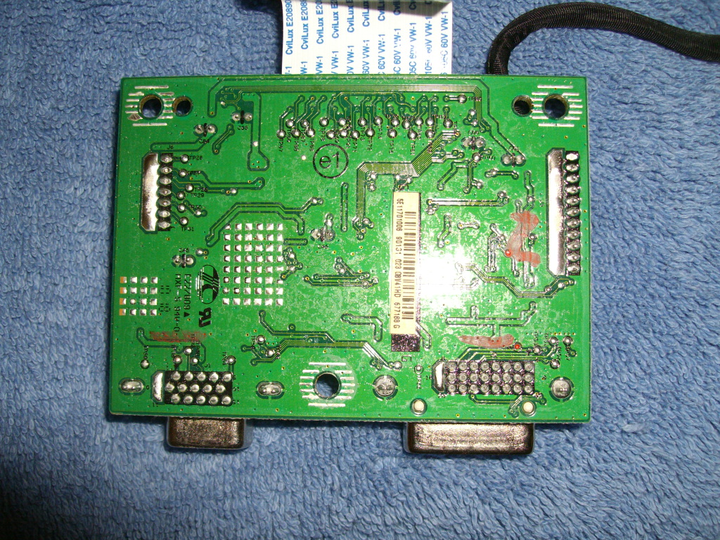

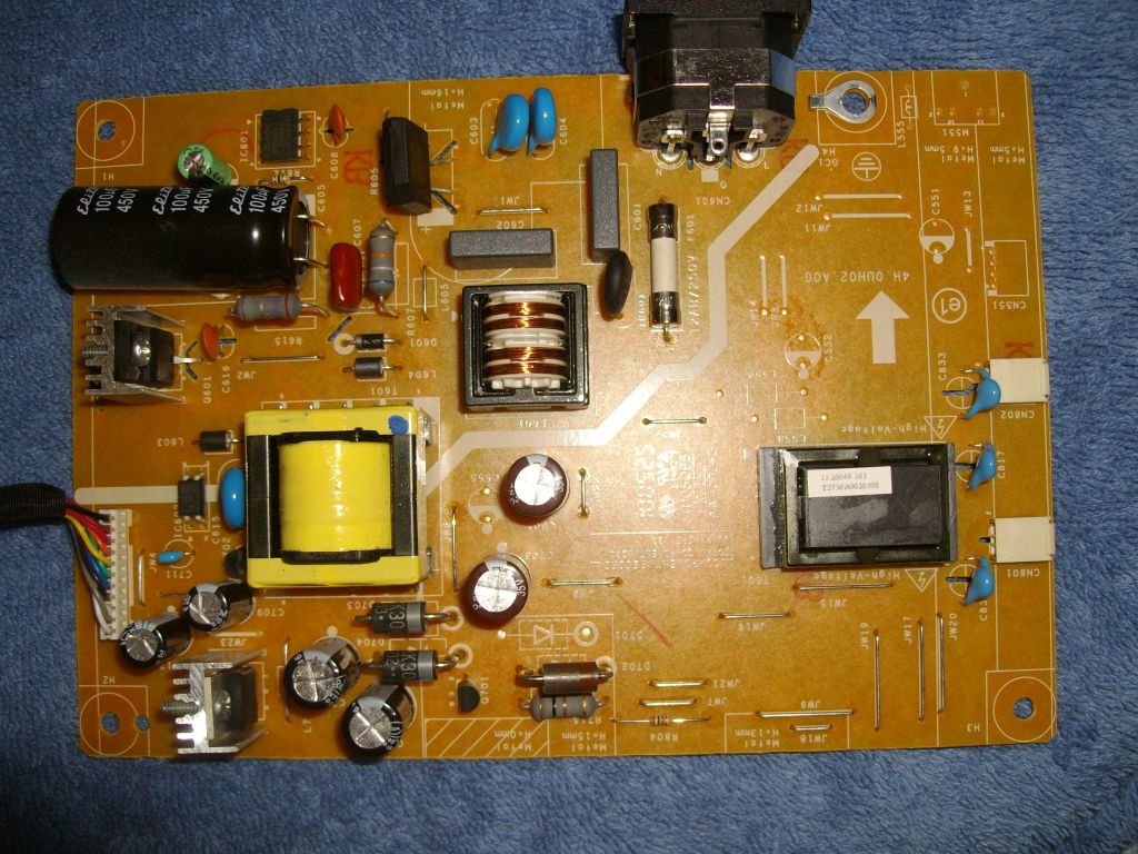

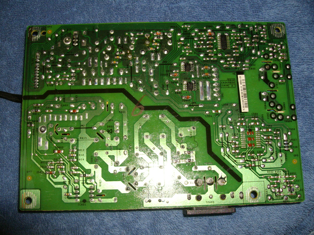

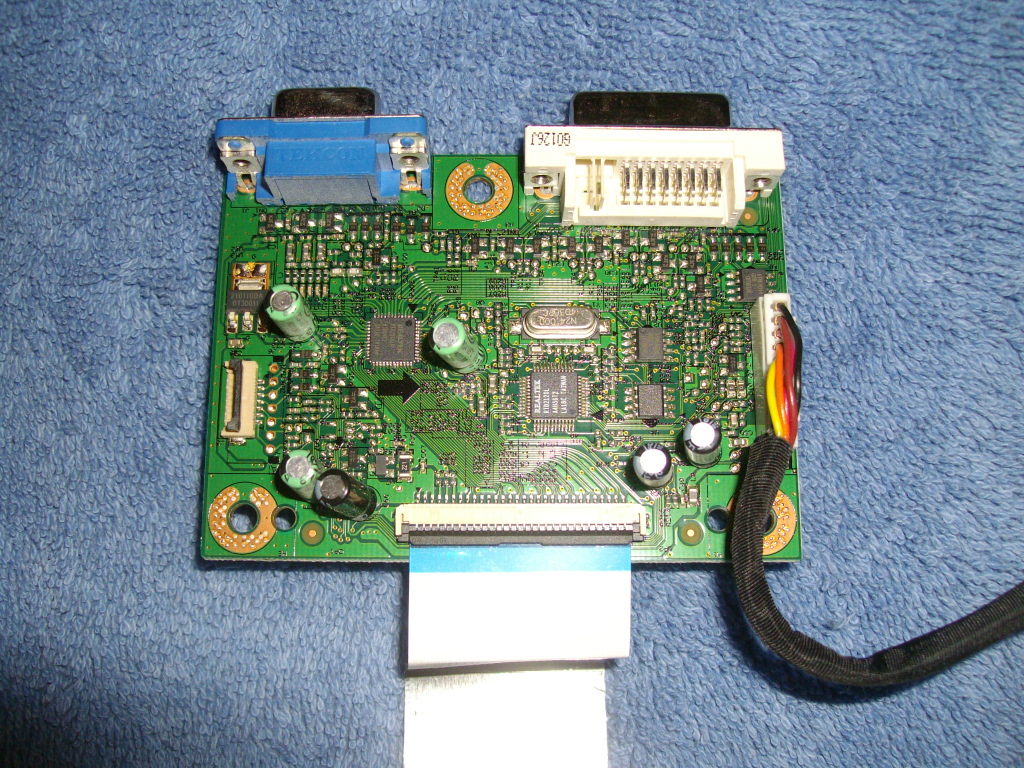

      I got the back off and took pics of the boards.
      Let me know where to go from here. Got the multimeter (digital) ready.

        First thing I would check is the Inverter Transformer which is the large
        black rectangle with a white label on. You need to check the resistance
        of the primary and secondary coils. I am not familiar with this item so do not know which are the pins to check. I am trying to find details of it but nothing has come up on the numbers I have used so far.
        We normally ask that you do not use flash in the photographs as important
        detail is missing. Can you advise the part number and version of the power board.
        Do you have another monitor that you could test the ccfls on?

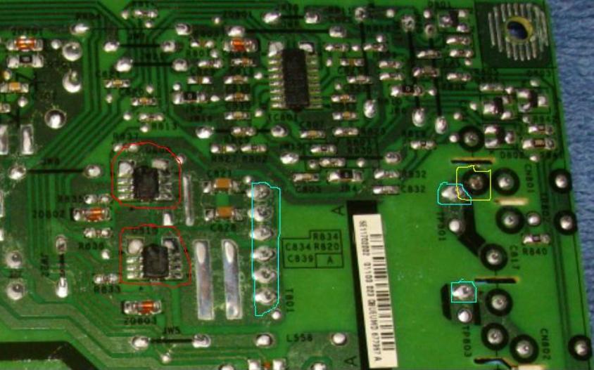

        Hi I see we have had one of these before. The pin test is shown in the thread with this picture so you can test and post your results.
        https://www.badcaps.net/forum/attach...9&d=1321094967
        In the attached pic of your board can you do a close up pic of the
        the components ringed in red and what are the part numbers.
        Can you check the soldering on item ringed in yellow - looks
        a bit off in the picture. Resolder it.
        The transformer pins (Circled in Blue) should also be resoldered but wait until you have posted the test results as it may have to be removed for further testing.

          The power board has the following numbering:
          E 227809 HXF-S S4v
          The paper label has the following:
          5E 1170008 90131 D23 G8V41HD 677188 G
          Even with a magnifying glass I can't read the IC chips.
          Transformer information:
          I used the numbering in the pic in your reply.
          1-2 440 ohms
          1-3 through 1-8 all are open
          2-3 through 2-8 all are open
          3-4 through 7-8 all are Zero (short)
          Checked the solder joint and is fine.
