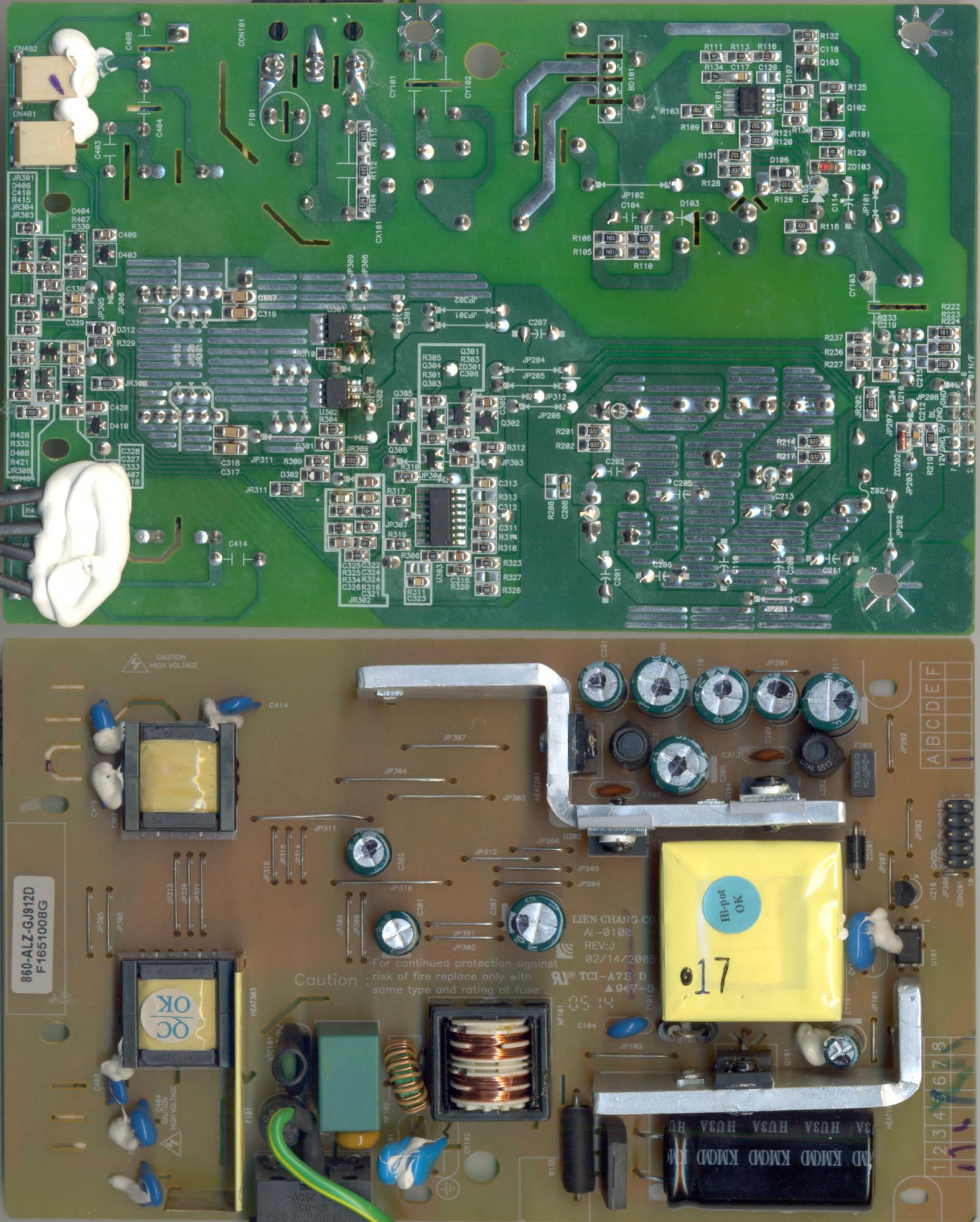

    I have acquired a Gateway 900G model FPD 1960.
    I have read and tried to do as much as I could to give the best account of what is occurring.
    The story so far ...
    It does not do, from my understanding what I read to be, the 2 seconds on then black screen. i.e. the LCD does not flash a normal screen then turn black.
    The power button is lit and stays on.
    Screen is black.
    LCD is not cracked.
    When viewed using flash light technique everything is there and looks like nothing is wrong with the LCD itself.
    Looking at PSU ...
    No capacitors show any signs of bloating on top or leakage on bottom.
    Transformers both show 712 Ohm
    Power output shows both 5 VDC and 12 VDC
    Both Alpha&Omega 4606 IC's (U301 & U302) show signs of being burnt/melted on the corner of what it think is Pin 1.
    Fuse has continuity
    I tried to run the tests described here: https://www.badcaps.net/forum/showpo...2&postcount=33

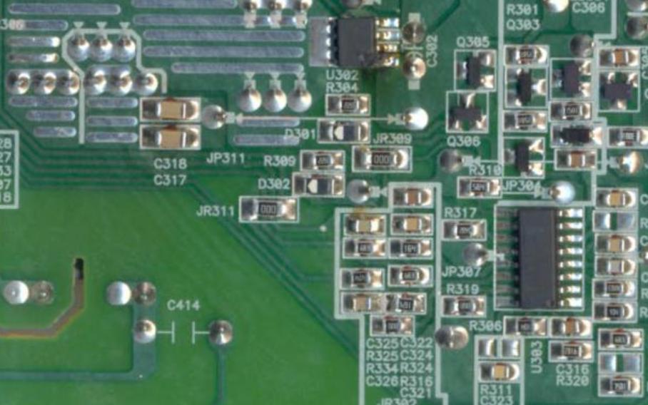

    While using a flash light to see I tried to change the Brightness and Contrast and could not see any change. I don't know if this is a function of, and thus points to a problem with, the CCFL's or the two burnt IC's.
    The logic board seems to be clean.
    Additionally, as seen in the attached picture the red arrow points to what seems to be a failed capacitor (C325), with what looks like leakage on the board but I am uncertain. Is there a way to test the capacitor and if bad does anyone know its value so as I can replace it?
    So the question I have is, Is everything functioning correctly and the only problem is the two burnt IC's(U301, U302)?

    WoW! Great job on testing and describing the symptoms. Also, great job with the photos. You've verified the voltage outputs are good and the logic board is outputting video. And you've narrowed it down to the inverter section. Yes, U301 and U302 do look burnt. Try testing them for shorts:
    1) look at http://www.alldatasheet.com/datashee...MD/AO4606.html for the datasheet.
    2) with power off and your meter set to 200ohms resistance, place your probes across the following:
    S1-G1
    G1-D1
    S1-D1
    S2-G2
    G2-D2
    S2-D2
    As for testing the ccfl's, if you have a working monitor lying around you can try plugging them in to that monitor. Otherwise, I can't think of any way to test them with your monitor in it's current state.
    Also, caps C301 and C302 could be failing, thus causing U301 and U302 to work harder, overheat and burn out. With the exception of the large 450V cap, a complete recap (I counted 10 caps) might be in order.

                As I look at the board I still wonder about C325, the one pointed out with the red arrow, I don't know whether to worry about it affecting anything.
                  What red arrow?

                    The red arrow in my original attached picture, in the lower central portion of the back side of the board.
                      I looked three times and still don't see it? If it is there, it must be very tiny red arrow.

                        Is this a poll - if so I see no arrow. I see the cap and the smut but no arrow.
                        Ceramic caps do not leak I was going to suggest trying to clean with isopropyl
                        alcohol (gently as they can become brittle).

                            My apologies I had unknowingly uploaded the wrong image. Sorry for that.
                            Ok, if the ceramics don't leak then that's good I have one less thing to worry about.

                                  3) Did you measure the new mosfets to see if they are shorted after powering up the lcd?
                                  Yes, they are not shorted.
                                  I tested for shorts using the procedure
                                  S1-G1
                                  G1-D1
                                  S1-D1
                                  S2-G2
                                  G2-D2
                                  S2-D2
                                  No audible noise for continuity from meter or change in ohms from what meter reads when probes are not touching anything.
                                  As they do not appear shorted I am not sure what to check next.

                                    Originally posted by Mad Capper
                                    Is it possible the inverter controller causing the problem? How would I confirm this?
                                    U303 is likely your inverter pwm controller. Find its datasheet. Measure the voltages on each pin and compare it to the expected values on the datasheet. The most important ones are probably VCC and EN (enable).

                                        After looking for a BIT3193G datasheet all I could find was this
                                        http://html.alldatasheet.com/html-pd...IT3193-SO.html
                                        I am hoping that is close enough otherwise I am not able to find the exact datasheet.
                                        When checking voltages for the inverter controller should I check on the PSU alone, connected to the logic board, or everything connected together? I assume everything connected together and powered on so that is the readings I am posting
                                        As per the pinout on the datasheet this is what I get:
                                        1 1.307
                                        2 4.51
                                        3 0.7
                                        4 1.41
                                        5 3.96
                                        6 3.85
                                        7 0
                                        8 0 (when turned on goes to 0.87 then to 0)
                                        9 0 (when turned on goes to 0.49 then to 0)
                                        10 7.77
                                        11 1.77
                                        12 1.81
                                        13 1.28
                                        14 0
                                        15 0.39(when turned on goes to 1.89 then drops to 0.39)
                                        16 0
                                        I only watched for voltage change during the power on process for pins 8, 9, and 15 as they seemed from my interpretation of the datasheet(which is probably way off) and what retirecaps said as they should important. The others were take when it was already powered on.
                                        Having read some I understand that good caps make a big difference, but after it did not work after the new IC's the ones lying around were all I had so I thought I would give it a shot. They might be just as good/bad as the ones on there but thought I would give it try to see it that made a difference.
                                        I have done subsequent testing in various iterations and am perhaps more confused.
                                        I replaced the 47Uf 25v with a 220Uf 25v and then a 100uf 50v, again that I happened to have, and this time when I turned it on the screen was brighter, flickered/brownout more noticably for a second or 2 then went dark. Does this point toward a complete recap as the solution?
                                        Selldoor - It seems the link you referenced refers to a transistor on the PSU not video board
                                        Post 21
                                        https://www.badcaps.net/forum/showth...highlight=700g
                                        First point: The shunt regulator is part of the regulator circuit. Check the output voltages of the power supply. The connector is labeled. If you have 5 volts at the 5V pin and 12 volts at the 12V pin (if there is one), the shunt regulator is not damaged.
                                        As I have 5v and 12v would this point to the transistor working properly? But I don't know if when turned on the clicking and slight 5v fluctuation has to do with the 47uf cap or the transistor.
                                        I did some more reading and saw that some one posted the way the CCFL's are supposed to be plugged in. I marked mine before removing and had a different order. So I tried what was posted and got the two seconds to black rather than the flickering. However, in changing the 47uf with others that I had and changing the CCFL order my results varied. I would get the flickering, two seconds to black or the clicking. At first there did not seem to be a particular setup that I tried that consistently produced one symptom vs the other, i.e. while keeping one thing constant and changing the other I would get different results even from one time I turned it on to another.
                                        So I put back in all the original caps, and now it seems to consistently get the clicking. In time with the clicking the CCFL fire and shut off. 5V goes between 4.99 and 5.03.
                                        So I tried other combinations of the components I had and it seems to still get the clicking.
                                        So if the results I got for the inverter controller show it to be ok or make sense for the symptoms does a recap point the way to a working monitor? Should I retest the inverter controller again now that the main symptom is the clicking?
                                        Thanks again
