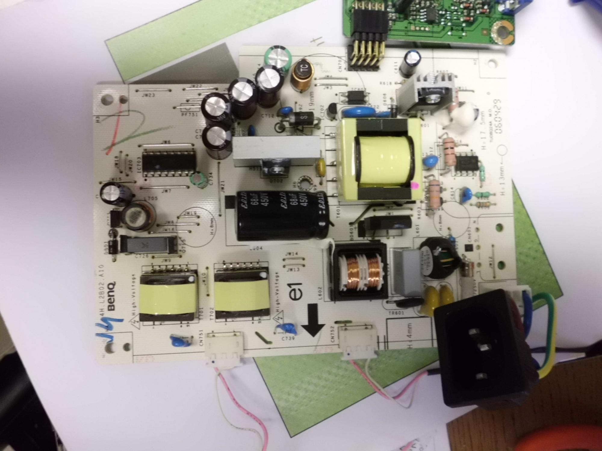

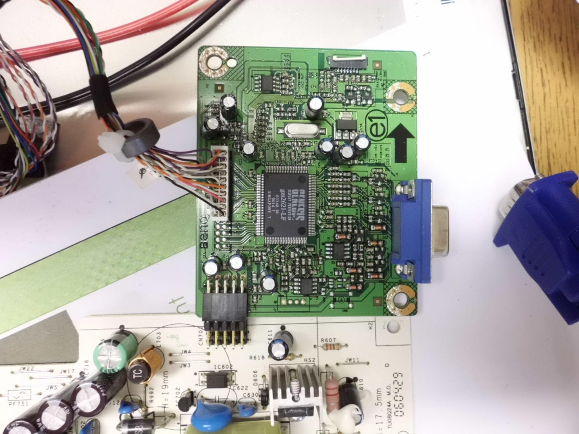

    I have a Dell E156Fpb 15" monitor that I suspected had a CCFL gone bad causing it to shut down after 2 seconds. It did in fact have a bad CCFL on the bottom side, however, after replacing it with a good CCFL I found the same symptom (shutdown) exists when the VGA cable is connected. If I release the VGA cable, the CCFL's light back up. So far, here is what I have done in terms of troubleshooting:
    1. swapped out the controller board from another E156Fpb with no changes in symptoms.
    2. searched for similar issues with no luck.
    3. replaced the two C5707's and the FU9024N on the inverter. Nothing.
    4. resoldered all the pins on the two transformers.
    Suggestions at what to look at?

      Re: Dell E156Fpb backlight turns off when VGA connected
      Id say its unlikely to be a fuse on the inverter board problem as the inverter works and only shuts down when the vga is connected. Do you mean the Internal vga cable or the vga cable from the pc. If the latter have you tried that cable on another monitor or another cable on this one?
      Was the board you swapped in working in the other monitor?
      Did you try swapping the internal vga cables.
      If the other monitor was working can you connect the panel from to this one.
      You should post pictures also of the front and back of the logic board with close ups of the connectors.
      There are a number of different Power boards for this and if it doent show clearly in the picture can you state the board number and revision- a close up pic of it would be good
        Sorry, the weekend came about and I stepped away from the project. Below are pictures of the separate boards involved.
          Update. For whatever reason, I decided to swap out the CCFL that I believed was good with another one (it lit up on power up for 2 seconds so I assumed it was good). Problem solved. Since the CCFL's are gas bulbs, can anyone recommend a convenient means of testing them without removal from the glass substrate?
