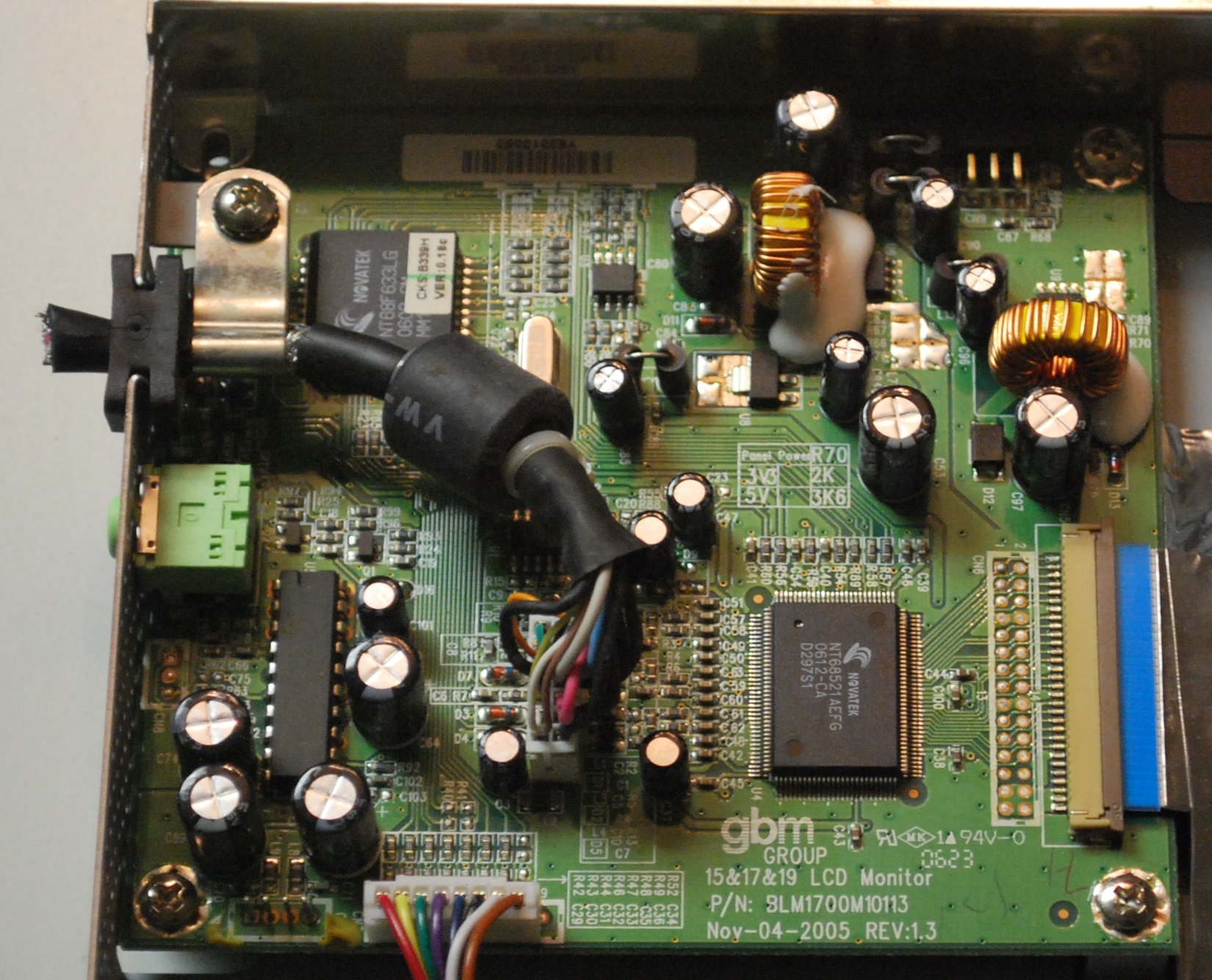

    Fixed up an Optiquest Q9B-2 by replacing three CapXon capacitors (470uF/25V).
    I then realize I can't hook up a video signal. The previous owner cut off the internal VGA cable.
    Any thoughts on jury-rigging a VGA cable to get this monitor to full working functionality?
    Thanks for reading!

          It's been said many times, but often requires repeating. We do not have a massive library of schematics, parts lists, assembly drawings, and service manuals of every monitor. A simple picture will give us much more information than having to drag it out sentence by sentence.
          To answer your question, if the internal end of the original cable terminated in any kind of push-on connector, the odds are a cable from another monitor will not match it.

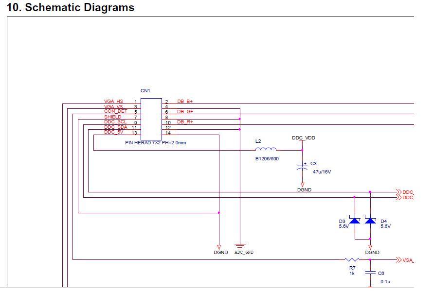

            I got a service manual from eservice.info and hope there's something that will help me make my own cable.
            Here's a pic of the video board. I'll be looking for a schematic for this board, too.

              Yeah, that jerk really shafted you when he cut the cable.
              If you fail to find a schematic, look for a datasheet for the Novatek NT68521AEFG chip. I found one for the NT68520AE, it shows the pinout, so you will be able to identify the R G B and sync lines on the cable as well as the ground lines.

                Hi- I have had a similar problem myself- I have written you a rigmarole
                which may help and have posted as an attachment so it doesnt take up
                pages. I hope it makes sense! If your schematic differs I will post a screen shot of the relevant page from mine.

                  Connectors have a pin order. If you're lucky and the designers had some sense they will have made 1-15 on the board connector 1-15 on the VGA cable.

                    Interesting development. In going through a batch of monitors someone else gave me, I found another Q9B-2. This one DOES have a video cable. I'm thinking I can manually map the pins using a multimeter's continuity feature. I'd have to map the scavenged cable, too, though. I'm thinking this could be a more appropriate challenge given my skill set with reading a schematic (~0).
