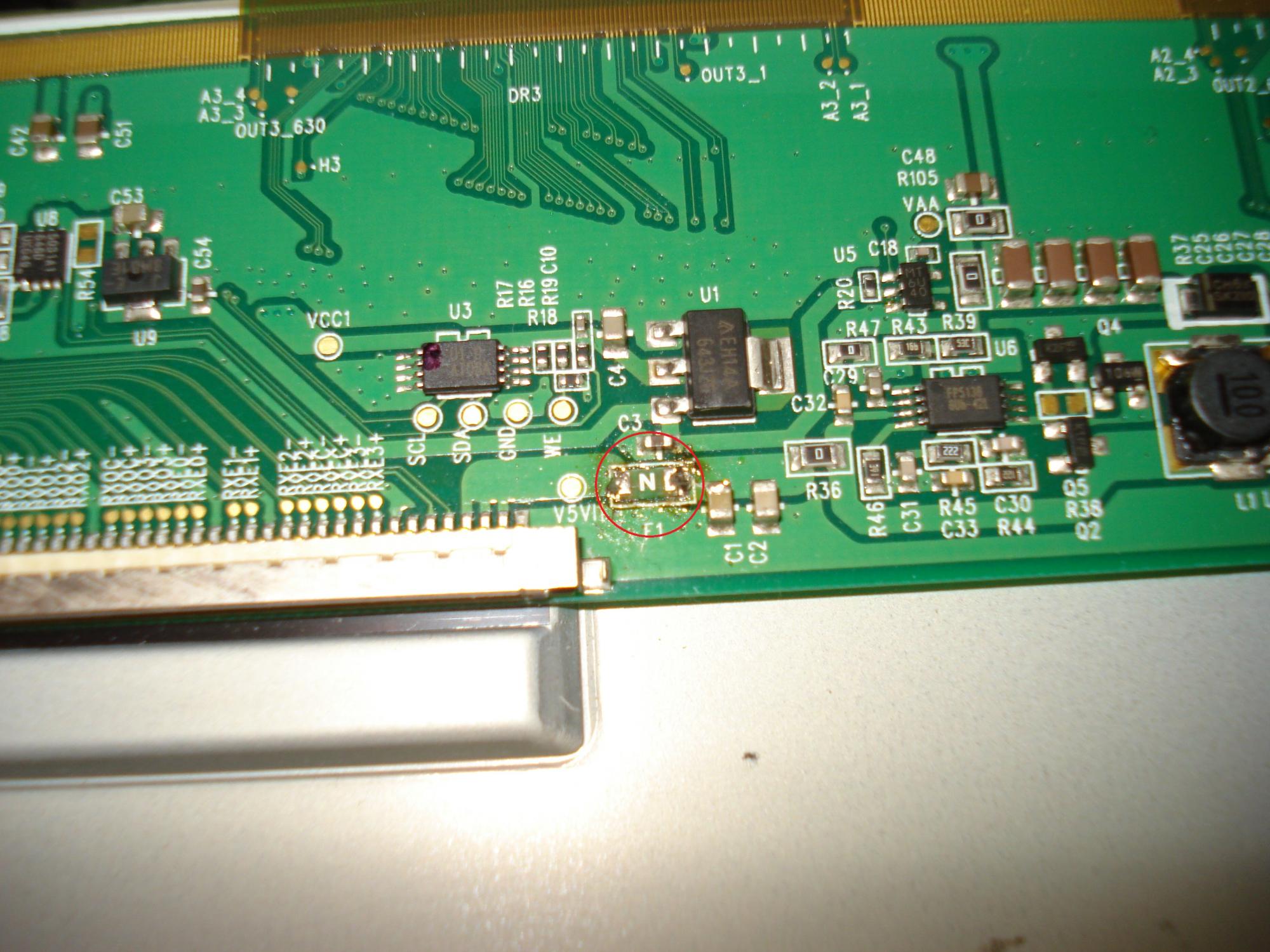

    Oh youre right, I remeasured the transformer S1 and S2 came to 620 ohms, S3 and S4 came to 618 ohms. Using the red probe on S1 and black on S2. The guide before told me to use black on S1 and red on S2 which didnt give me a reading, i must of measured it upside down.
    In regards to the Tcon, there is a blown smd fuse "N" which was replaced by the previous owner. The originally SMD fuse was "K".
    Heres the thread where the previous owner troubleshooted the white screen.
    https://www.badcaps.net/forum/showth...ight=VX2255WMB
    Where can I buy a new SMD fuse of the same specifications (SMD "K")? I'll replace it and see if it works, but rereading the previous owners thread, the source of the blown fuse was not yet found.
      Digikey.com if you are in the USA. They have friendly people who answer phones and can help you find the correct replacement. 1.800.344.4539

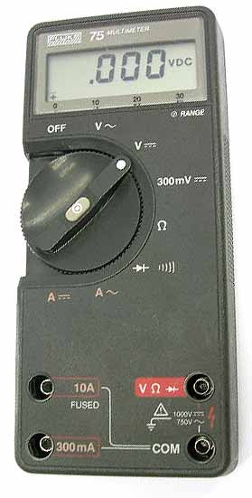

            Please post a picture of your multimeter.

              #46
              Re: Viewsonic VX2255WMB Grey Screen
              Well i just went out to work wont be home til around midnight but this is the meter im using http://www.microcenter.com/single_pr...uct_id=0207743

                #47
                On your multimeter notice that the diode test function is shared with the 2K ohms function and possibly the other ranges with the exception of the 200 ohms. I wonder if your multimeter somehow is doing a diode test function instead of an ohms reading?
                A diode test function is designed to apply voltage across a diode to ensure the diode only allows current flow in one direction. Thus, when you reverse the probes you should get "1" in one direction and a reading between 0.5 and 0.8V in the other.
                Your multimeter, because of the shared design (ohms and diode on the same dial), may be incorrectly applying voltage instead of measuring resistance.
                My 3 multimeters at home have all the ohms and diode test function separated. For example, I have an used Fluke 75. See picture.
                I also looked at the DVM850 manual online and it is useless in terms of discussing this operational aspect.
                PS. I have a huge interest in multimeters and that is the reason for this sidetrack.

                  Even so if i increase the range off 2k and to 20k wouldnt it measure 0.06? Unless the diode is being used along with all the resistance test

                    #49
                    In the post above, I revised my first sentence and you probably didn't see the edit.
                    You would think that 20K should show 0.06, but your multimeter may still be doing a diode test? It could also be malfunctioning too? Again, there is nothing the manual that discusses the operational aspect of the shared dial functionality.
                      Well i just tried it one more time, and it seems to be working properly now hmm odd.
                        Maybe you have a low battery or your probes are fraying internally causing some intermittent contact?

                                  About the specifications:
                                  - K indicates the current rating - 1.5A in this case. Any fuse with that current rating will do.
                                  - The voltage rating is irrelevant since most SMD fuses are rated for 32V or above while the t-con uses typically 5V.
                                  - To get an exact replacement, measure the original fuse length and width in mm. The size is the actual case style. For example, a fuse that measures 1.2 mm length by 0.8 mm width usually comes in a "1208 (metric)" case style. If you can't find your fuse on Digikey or Mouser, post the size of it here and we can help you find it.
                                  In any case, once you find the fuse, buy at least 2 of them. Judging by codeMoneky's thread, I would say get 4. They are cheap anyways.

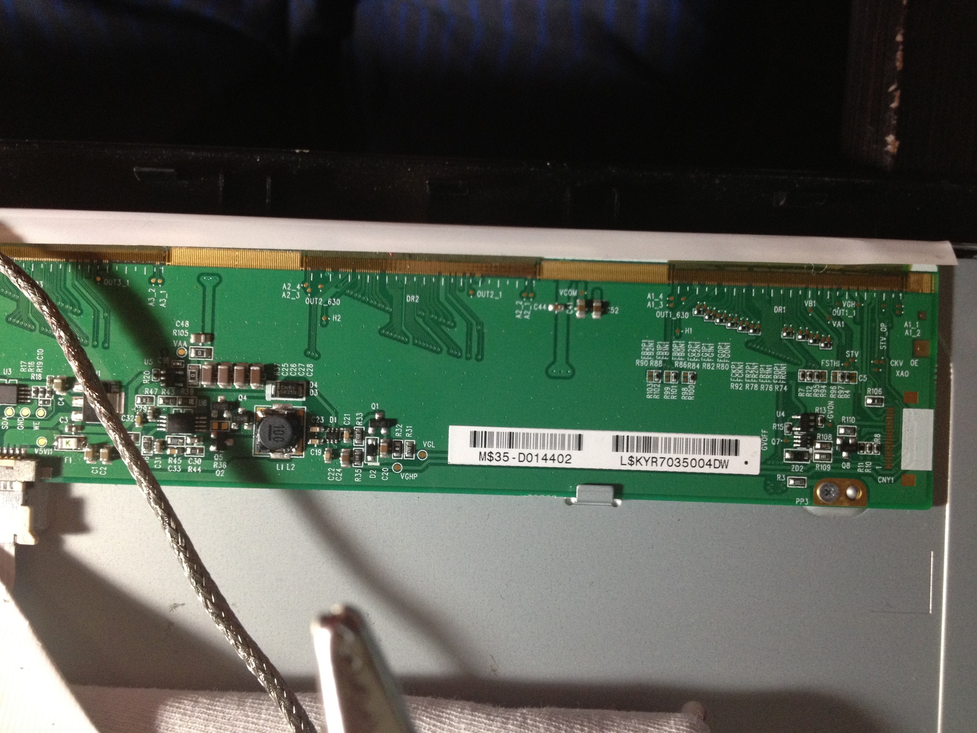

                                    Please also post decent pictures of your tcon and perhaps one of our "screen advisors" Alexanna might join in and suggest some test points that your meter can cope with.

                                      Well I just replaced the fuse, the white screen is gone but now I would turn on the monitor (blue power light on) and it would instead get flashes on and off with a bunch of random oriented color lines and then it would turn off again (blue light goes off and red light comes on) Would the graphics board be the cause of this? What usually causes the monitor to go off, shouldn't it stay on when connected to a computer with the screen on, but it keeps shutting off after 3 seconds?
                                      For the resistors I measured again.
                                      R78 0.4Ω
                                      R39 0.4Ω
                                      Tcon
                                      R100 0.4Ω
                                      R101 0.4Ω
                                      R102 0.4Ω
                                      R15 0.4Ω
                                      R95 0.4Ω
                                      R97 0.4Ω
                                      On the picture showing R22, It wouldnt give me a reading. I'm guessing it was the only one replaced. I tried to reflow the solder but it still won't give me a reading (won't change off 1). I'm guessing it has a bad solder connection or its a faulty part. I ended up wicking it off and trying to measure it again but still no reading. I also had this same problem with the K fuse, i didn't try to reflow but i just replaced it.
                                      How would i find the actual values for these resistors if they need replacing?

                                        #59
                                        When resistors fail, they go open-circuit, not short circuit!
                                        The component you circled in the picture above looks like an inductor or a jumper resistor (a resistor with no resistance - those are used quite often to jump over traces on the board). The silkscreen on the board should tell you what it is. R = resistor, L = inductor, C = capacitor, D = diode. Jumper resistors with 0 resistance can still be marked with R.
                                        If anything, it's the ceramic caps that usually fail shorted. A white screen usually implies something is wrong with the power supply on the t-con board. The shot above shows the video/logic board. That can cause a white screen too, but it's rare. You can check by seeing if 5v is coming to the fuse on the t-con board.
                                        Have a look at the thread below. It's a different monitor, but in post #13 (look at long version), I explain what generally goes wrong with these t-con boards and what causes the white screen/gray screen issue.
                                        https://www.badcaps.net/forum/showthread.php?t=17904
                                        From the picture of your t-con you provided, you can even see some of the test points I mentioned in the above thread. Namely VCC1 (left side of the picture), V5V (next to "N" -marked fuse you removed), and VAA (upper right corner of your picture). All you have to do is measure the resistance and the voltage going to these points and report your findings back here. Test point VCC1 is likely at 1.8V or 3.3V, V5V should be at 5V, and VAA somewhere between 9V and 15V (depends on the design). Also, it is worth to note that test point VAA on your monitor is the equivalent to AVDD in the above thread.
                                        There should be 2 more test points that are important. I will need to see more pictures of your t-con, though. Most likely, you will find these test points named as VGH and VGL or VGG and VEE.

                                          #60
                                          The component i circle was labeled R22, so i'm guessing its a jumper resistor that failed (no reading, and no continuity). (I'll need some help trying to find a replacement.)
                                          I found all the specific points you asked for (voltages and resistance)
                                          I had a problem measuring the voltage though, since the monitor kept turning off (blue power led to red) after 3 seconds, the voltage would drop back down to zero. I had to probe the points and turn on the power to measure the voltages before it went off. Most of the time it stablized at a value except for VGH.
                                          VCC1: 2.51V, 457Ω
                                          VAA:12.7V, 1336Ω
                                          VGL: 6.9V, 712Ω
                                          VGH: 19-20V fluxuating, 962Ω
                                          For the fuse, I measured 5.04V going into it.
