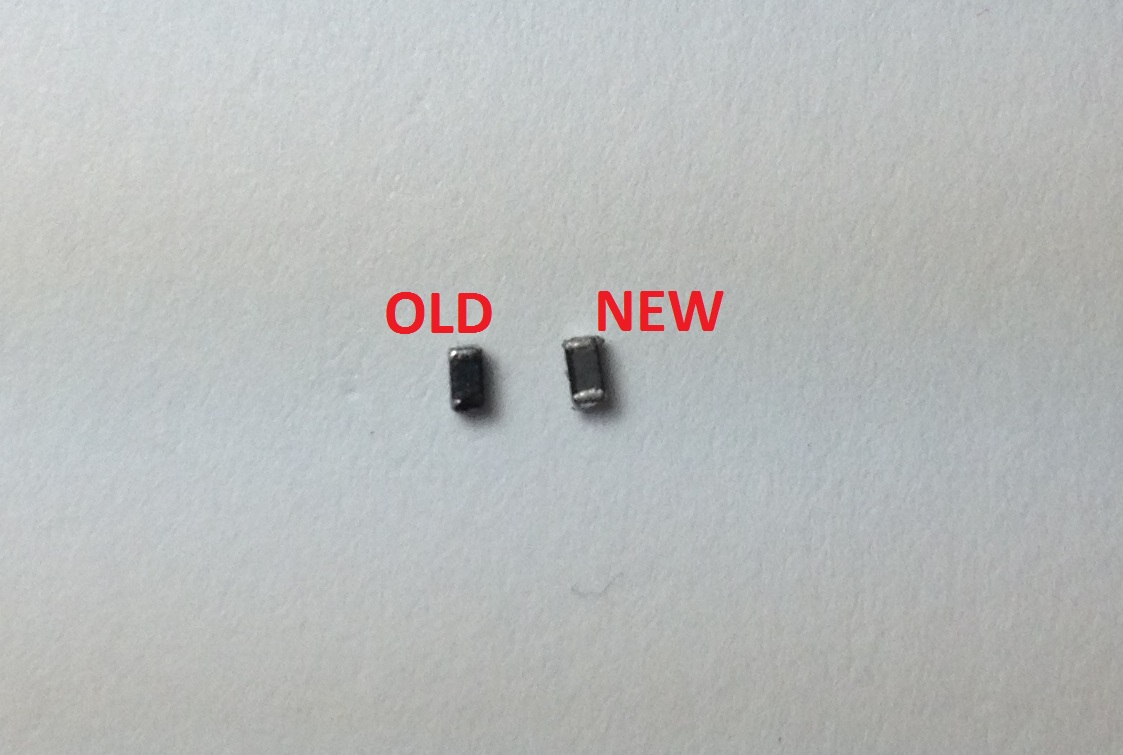

    Since jumper resistors have low resistance close to zero, wouldn't they just act like wires? In that case could I just find another jumper resistor from a salvaged circuit board and use it? How does the size of a jumper resistor affect it?
    From the old resistor I took out from the video board (R22) you can see that the bottom has lost the metal part that connects the solder between the resistor and the board.
    Would it be fine to use the new resistor I found from a salvaged board? Its "about" the same size and it has the same resistance of 0.4 ohms.
      Yes and yes.
      The bigger it is, the more current it can handle. On the video/logic board, however, there's hardly any high currents, so the size doesn't matter that much.
      That's usually fine. As long as the top part still has the metal contacts intact, I just rotate it 180 deg. and solder it that way. Of course, this is only if you need to reuse the resistor. I would say save it for now.
      Well, it would be fine to use the new resistor *only* if you know for sure what the resistance of the old one was. Codemonkey didn't clearly indicate what it was.
      Did you try measuring it with the highest resistance setting on your multimeter (usually 2000K/2M or 20M)? Also, check the resistance of the spot where the resistance was.
      Putting a jumper resistor in the spot of a resistor that could have possibly not been a jumper resistor can damage the video/logic board.

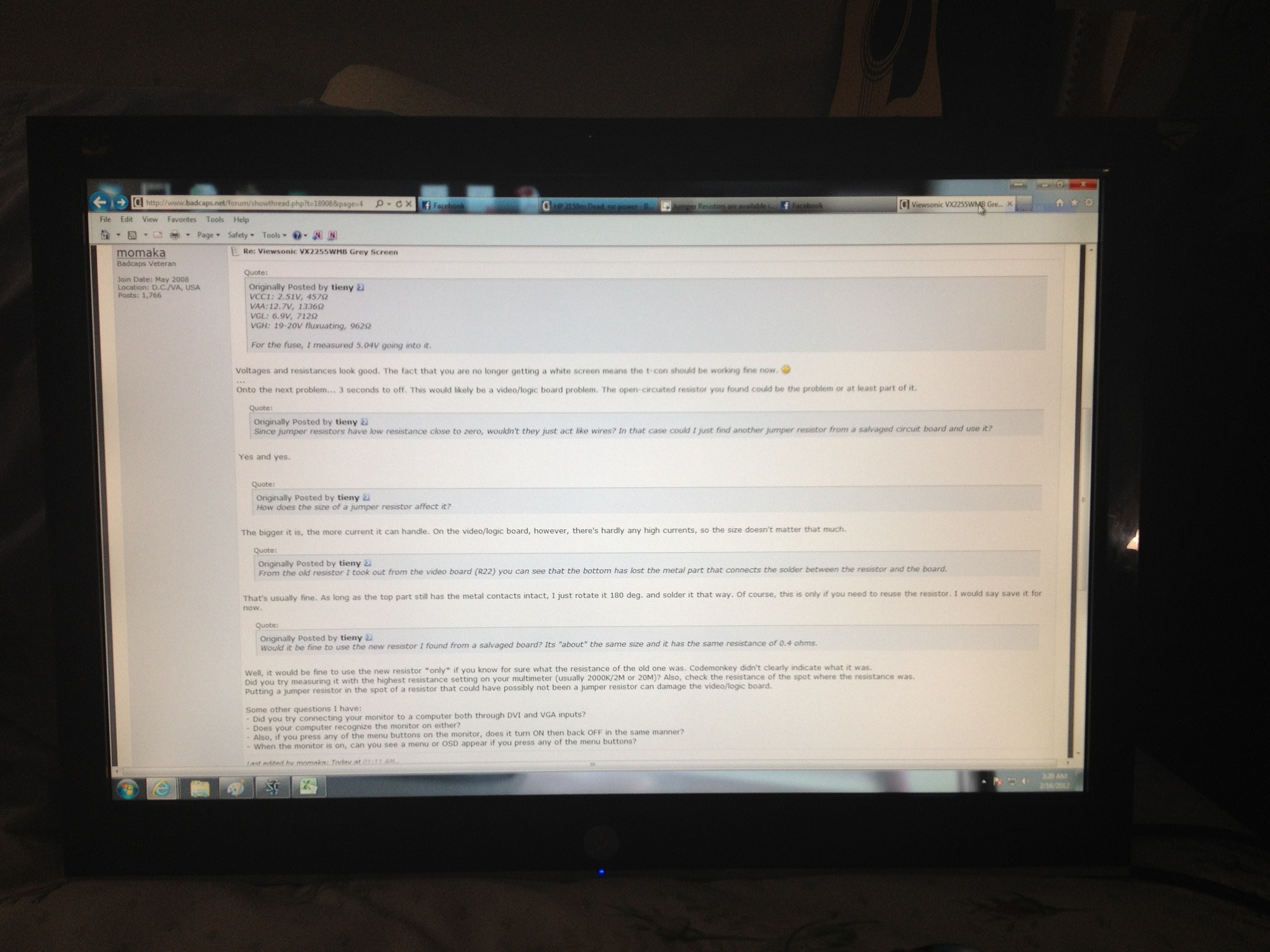

        I'm pretty sure it was a jumper resistor. I was able to measure the old resistor after moving the probes around a bit and it gave me 0.4 ohms. Well I replaced the resistor and the monitor is working now!
        But theres another problem, the monitor would keep randomly flashing black and back to my desktop and it would display the word "digital" on the top right of the screen. Any ideas?

                Well i solved the problem, i noticed that it went black once it started flashing colored lines for a second so I thought it would of been the resistor I put in. I reflowed the solder for the resistor and tried turning it on again.
                I think it worked, I left the monitor on for 30 minutes with no more flashes! Now its working perfectly hopefully. =)
