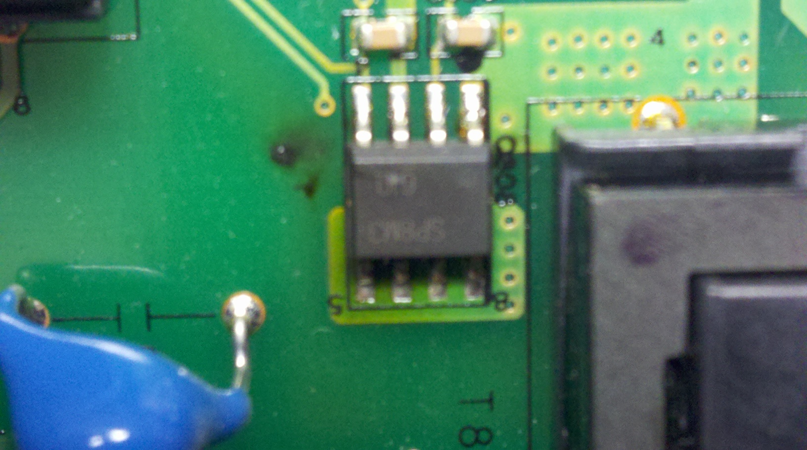

    I was 'gifted' with the above monitor, powers up but no display. On the inverter board (#5EL2J04011), I found one of the 2 transistors driving the center ccfl transformer had burned up.
    My issue is the Rohm SP8M3 mosfets aren't available in the USA unless I go to China. I did find the Fairchild FDS8958B mosfet available from Mouser and Digikey. These mosfets appear to be better than the originals.
    Question: Should I replace all 6 for a balanced drive of the ccfl section?

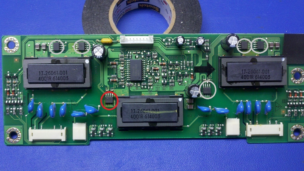

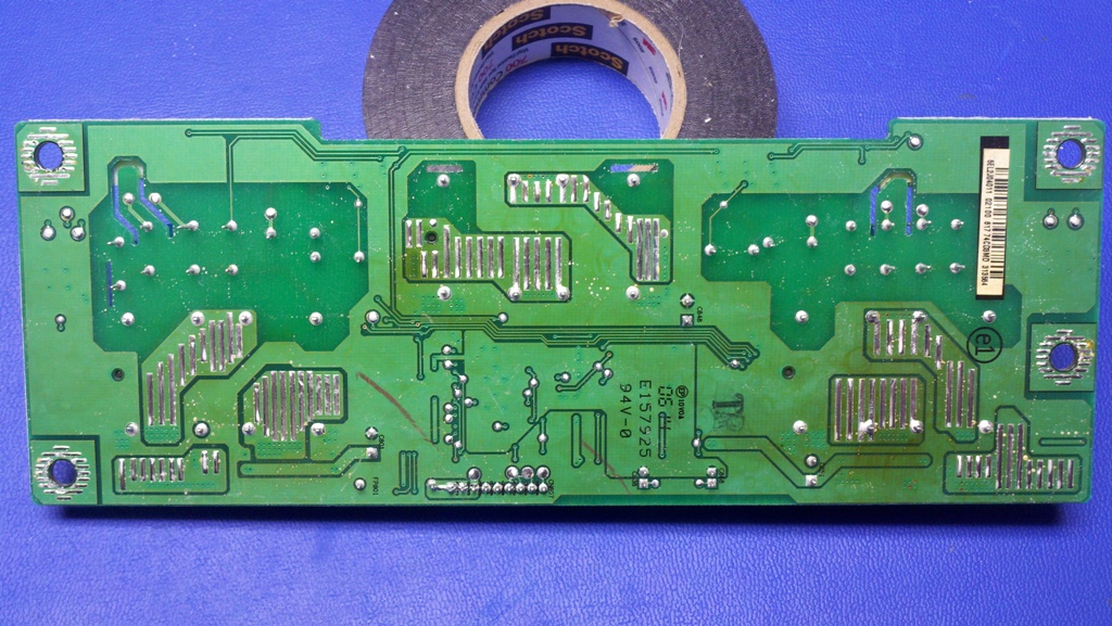

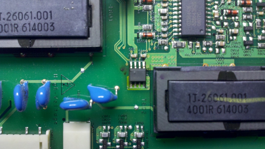

    I have uploaded pictures of the inverter board.
    The third one shows the damaged mosfet.
    Is there a good way to test the transformer (T802) either in circuit or out of circuit with just a DMM? I was looking at possibly getting the Anatek Ring Tester to test the transformer.

      It's not a definative test, but about all you can do is measure the resistance of the secondaries. If either secondary on this transformer is more than 3% low, that is an indication it is shorted.
        Those are excellent pictures.
        This is NOT your transfomer, but it gives you an idea where the primary and secondary pins are.
        http://www.lcdparts.net/TransformerD...ProductID=2726
        The secondary pins should be within 3% of each other.
        If it helps, I have this exact board in front me (waiting for repairs on the USB and logic board - shorted diodes and voltage regulators).
        I get the following ohms readings on my Fluke 75
        T801
        S1-S2 = 1021
        S3-S4 = 1016
        T802
        S1-S2 = 1028
        S3-S4 = 1023
        T803
        S1-S2 = 1026
        S3-S4 = 1021

          retiredcaps - thank you for your guidance. I definitely have something going on between the primary circuit and secondary for the center transformer. I am reading 15K between pins 1 - 2. Getting the same thing on 3-4, 5-6, 7-8. These pins are numbers on the board counterclockwise from the white dot.
          The other two transformers were reading 10M minimum on the same pins. All secondary readings were pretty close, all between 1036 and 1043 ohms.
          I am in the process of lifting the mosfets for t802 and going to take new readings
          Photos were taken with cell phone (8.0MP Motorola Droid X) with macro turned on. I re-sized the photos to 1024x768 on my desktop before uploading.

            I got the mosfet lifted off the board and T802 transformer readings match the other 2 on the board.
            I am looking at replacing the mosfet with the Fairchild FDS8958B. I am going to order enough to replace all 6 of the Rohm SP8M3's on this board and replacing the Elite Caps on the inverter and power supply boards.
