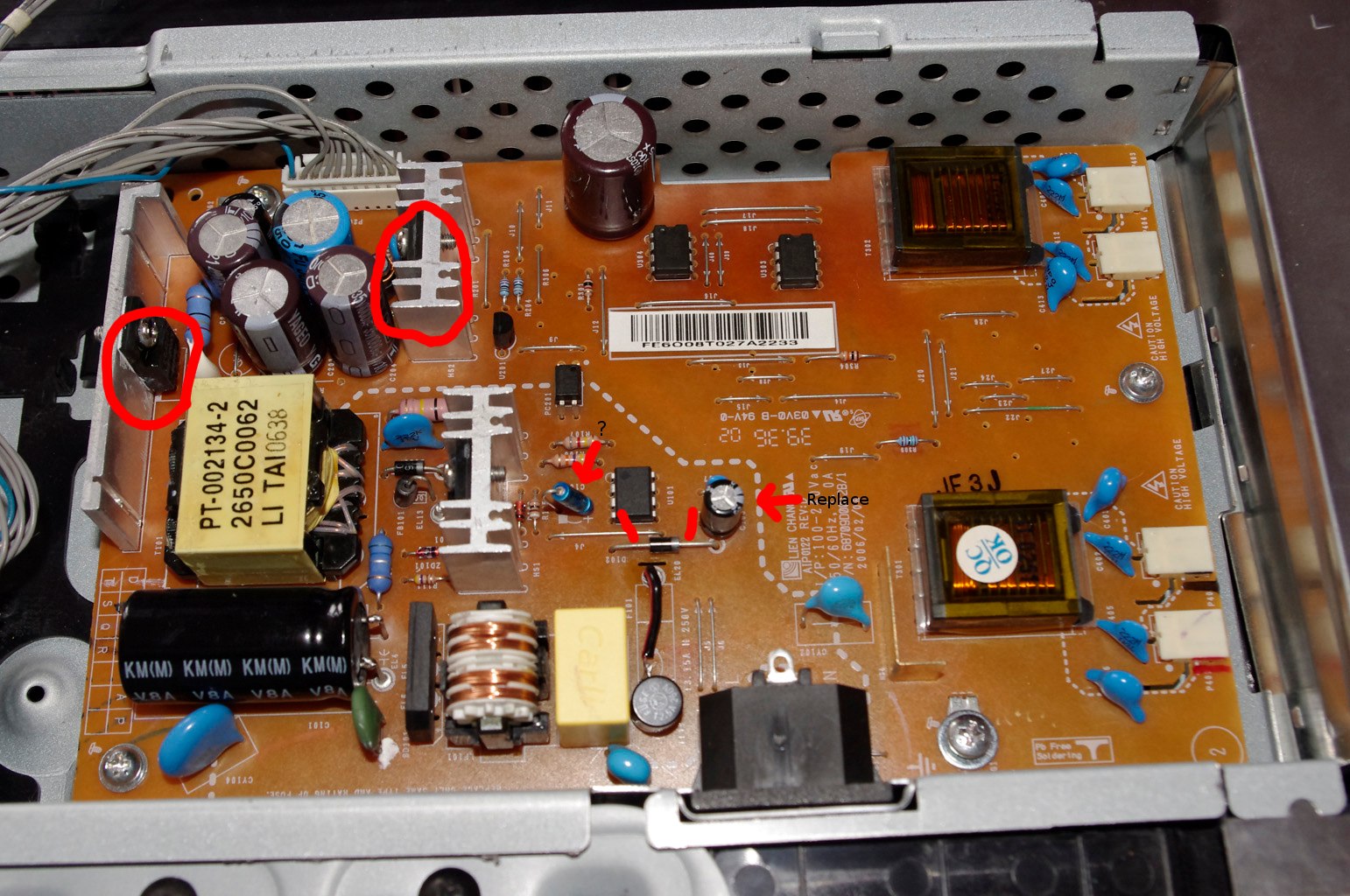

              Replace the capacitor I've highlighted. You can use a general purpose one. If this still doesn't work, then at least we know this wasn't at fault.
              Test the diode near the capacitor I've highlighted. Use your multimeter's diode mode. Test it with the positive lead on one end, negative on the other; note the reading down, and then reverse the leads and test again, noting down the reading. One way should give OL or "1 .", the other should give a number from 150..750. [Do this while monitor is OFF and UNPLUGGED!!]
              What's the axial lead cap? Did you replace that or is it original?

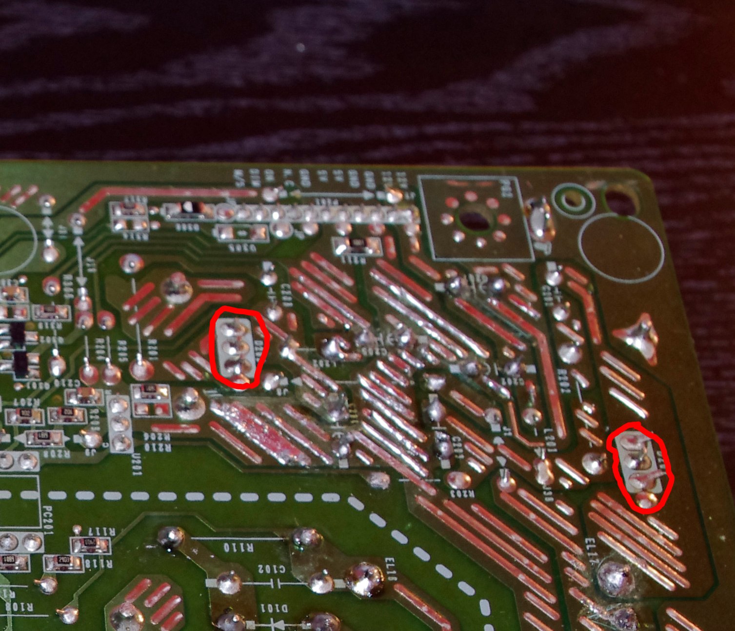

              The devices on the heatsinks I've highlighted - take a closer picture of the underneath of the board where the components are and also a more detailed top down (not side on) picture of this area.

                This one axial cap is replacement, but same as the original 0.47uF 50V
                I have mesured D102 you've highlited, RED->BLK=528; BLK->RED=1, so I think it's ok.
                Capacitor replaced with new one 33uF 63V, nothing happend, still the same mistery
                BTW can you tell me what values are used for this general purpose capacitor?

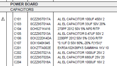

                    Without a topdown pic we cant see the numbers on the board but you can see what the values should be from the schematic by matching the numbers from the board to the schematic BUT you should replace like with like in case
                    the board is a newer version than the schematic.
                    It looks like it begins 10? so is on attached list?

                      Test the circled components. With the monitor unplugged and off, use your meter's diode check to test all combinations of pins, forwards and backwards. 1-2, 2-3, 1-3, 2-1, 3-2, 3-1. For both devices. Then report the results. We are looking for approx. 150 from 1-2 (or 2-1) and 2-3 (or 3-2). A zero result, or a number under about 50, indicates a failed (short circuit) diode.
                      The 5V isn't unstable, it's the power supply that's switching on and off because it's not charging Vcc. This can be caused by a shorted diode, bad startup cap or excessive load on the output, among others. More or different capacitors probably won't fix the problem.

                        this schematic is newer I think..
                        Here caps start with 20, except those two near mains they are 103 & 105
                        202- 1000uF 25V
                        203- 680uF 25V
                        204- 1000uF 25V
                        205- 1000uF 25V
                        206- 1000uF 25V
                        207- 470uF 25V
                        some of them (1000uF) were 16V, but to be safe I've used 25V
