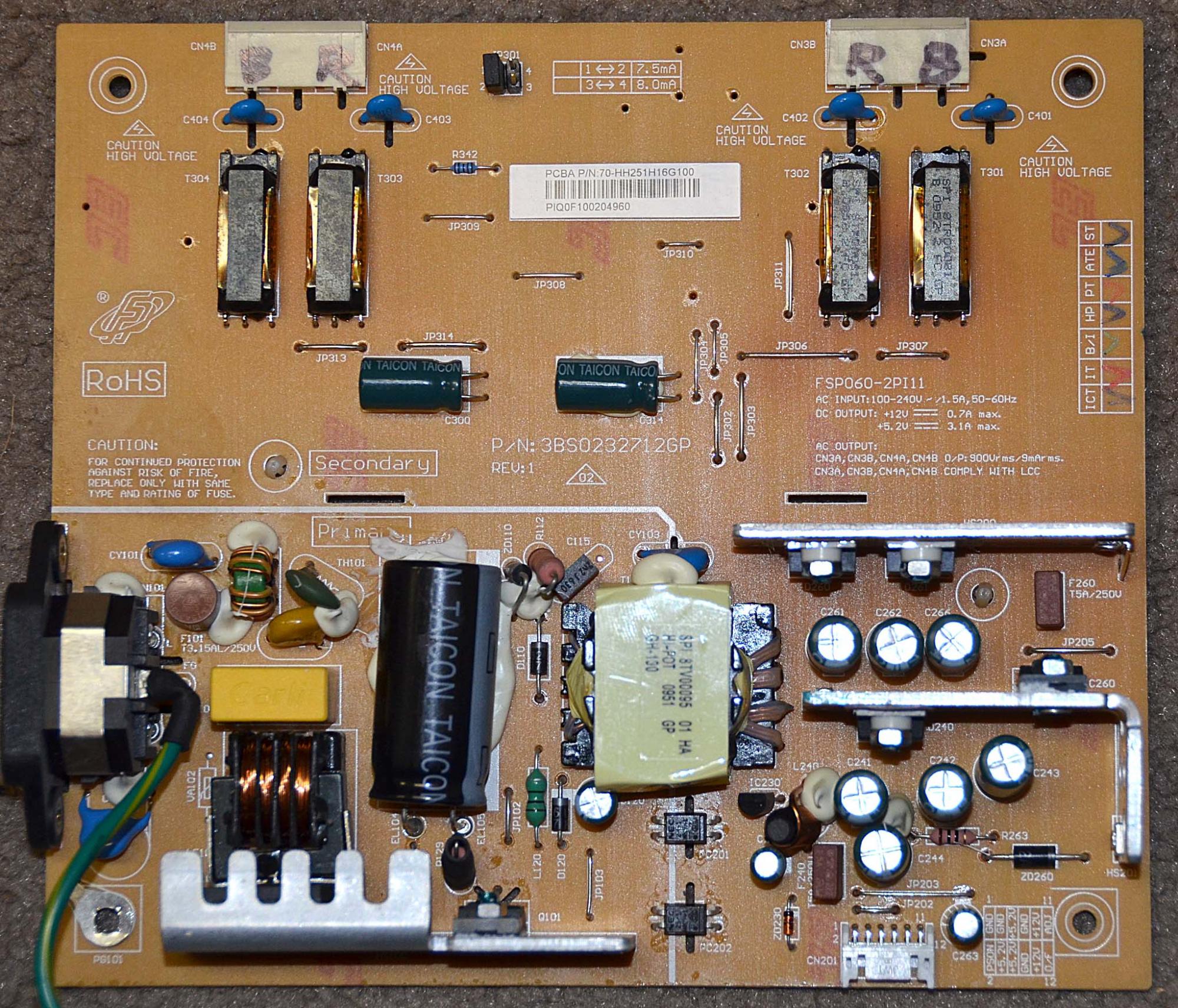

    Thank you guys for the wonderful site and willingness to help. I used the information to recap and repair a 19" LCD with obviously bad caps and got a great deal of satisfaction when the screen came back to life.
    This board seems a bit trickier.
    I Have done a little probing on the board and here is what I have come up with.
    Monitor will not Turn on but the switch checks good.
    Capacitors all look good but they are all cheap Taicon.
    I have 110 AC to the first Transformer and 65v out
    I have 45 v out of the second transformer with 65v in.
    The power connector that goes to the 2nd board has no power out 12vdc or 5vdc.
    I guess what you could help with is to give me the next logical things to check and how. Should I recap the board? Can caps cause a complete loss of power?
    Should I pull the Mosfets? off the heatsinks and replace them. I have checked them in circuit and a couple appear to be shorted.
    Picture of the Power Supply board is attached.
    Also is there a source for a service manual for this beast.
    Thanks in advance for your help

    1) Thank you for a clear focused picture using the manage attachment button. Thanks also for punctuation, paragraphs, and not the poor quality crap we have had to deal with lately.
    2) What is the DC voltage across the largest capacitor (just under the word Primary)? It should be around 165 V DC if working properly.
    3) What is the DC voltage of the cap (looks like C120) just above JP103? Is it steady or fluctuating?

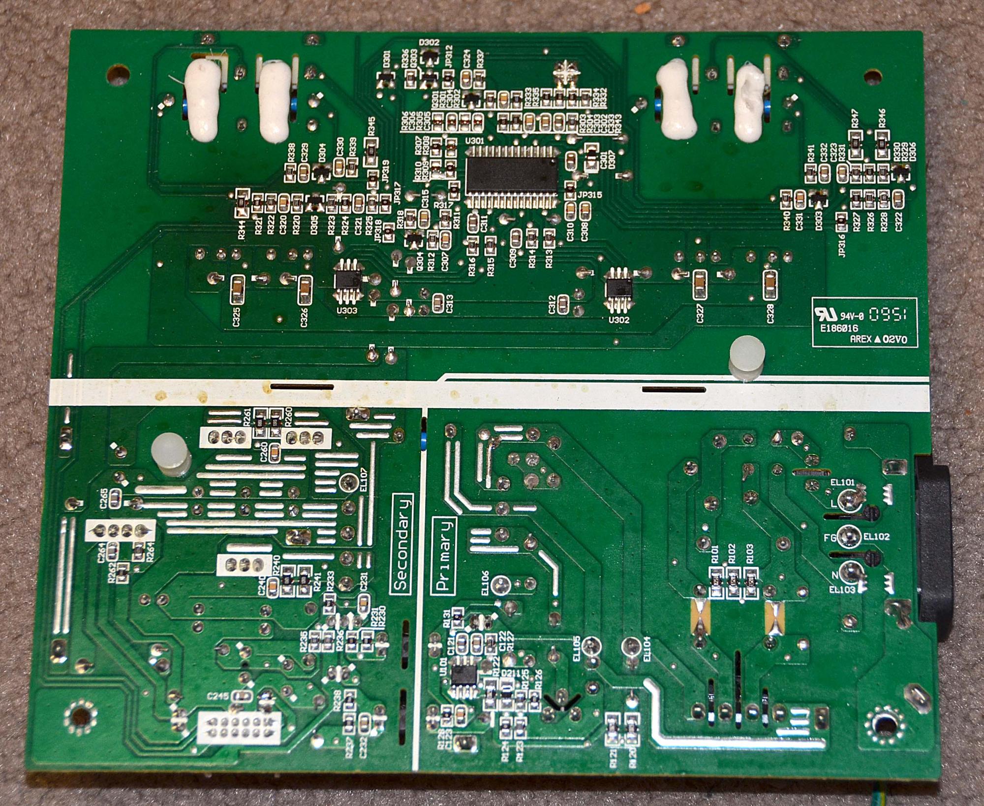

    4) We will probably need a clear focused pic of the backside as well. We are looking for possibly a 8 pin IC that is the SMPS chip.
    Last edited by retiredcaps; 12-14-2011, 11:51 PM. Reason: added C120 and look for SMPS chip

      5) F240 and F260 are fuses. A good fuse should measure less than 1.0 ohms.
      6) Is that a solder blob on ZD260 and R263? Piece of straw?
        Looks more like a strand of the white glue stuff. Same thing on the coil near the AC input fuse (above the yellow block cap)

          7) What is part number U101 on the backside? This should be the SMPS chip.
            DC Voltage is 167v and steady
            Jumps between 8vdc and 13vdc
            I am reading 2.9 ohms across both. I need to calibrate my meter leads shorted reads 1.8 ohms.
            It was a strand of Glue. (since Removed)
            I added it to my original post.
              That small cap could be the root cause. It should be a steady voltage. The SMPS IC Vcc pin probably is tied directly to this cap. If the cap DC voltage is fluctuating, the SMPS won't startup properly.
              Generally, we recommend replacing all electrolytic capacitors (with something like Panasonic FR/FM/FC series) on the board except the largest which rarely, but not never, fails.
              For the purposes of finding root cause, I would like you to replace JUST C120. If your monitor works, then recap the rest.

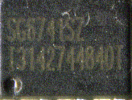

                  Wow. that is tiny print for these old eyes.
                  Best I can tell it is 131427448-40T
                    Is it written like
                    1314
                    27448
                    40T
                    or some variation of the above?
                    --- begin sig file ---
                    --- end sig file ---
                    • ZappedAgain
                      • Mar 2011
                      • 49
                      Re: Hanns-G HH251 Does not Power Up.
                      Is it written like
                      1314
                      27448
                      40T
                      Written Just like this
                      131427448-40T
                        131427448-40T
                        Wow, all that fit on the 6 pin IC? Anyway, I had no luck finding a datasheet for it so replace that small startup cap and retest your monitor.
                        I'm guessing it is a 22uF or 47uF 50V cap.
                            I took a little alcohol and cleaned the top of U101 then took an extreme closeup with my scanner. Revealed a whole other line of numbers.
                            Image is attached
                              That helps alot. I love helping people who do some extra work.
                              Datasheet is at
                              http://pdf1.alldatasheet.com/datashe.../SG6741SZ.html
                              Pin 7, Vdd, requires at least 15.5 V (min) to start with 16.5 (typical), and 17.5 (max). So 8 to 13V DC from C120 won't be enough to start the SMPS.
