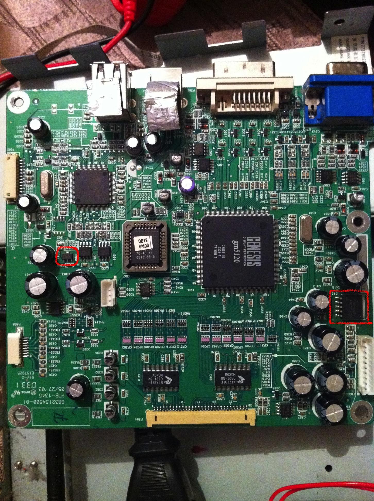

              Re: Dell 1901fp
              Originally posted by littlski717
              I have no power led light.
              The power LED is controlled by the logic board.
              I circled what I think are 2 voltage regulators.
              1) Put your multimeter on 20 V DC if manual range.
              2) Put your black probe on a ground screw (any one on the logic board will do fine).
              3) Put your red probe on each voltage regulator pin EXCEPT the big fat tab.
              4) Report the part number for each regulator.
              5) Report all your findings like the following example,
              U101 - part number AL1117-33 - pin 1 = 0.00 V, pin 2 = 3.3 V, pin 3 = 5.0 V

                  • littlski717
                    • Nov 2011
                    • 28
                    #29
                    Re: Dell 1901fp
                    Okay, here are the measurements -- hopefully I explain this good enough......
                    1st regulator w/ metal flap (pins from left to right with flap on top)
                    part# FAN1537PAC
                    pin 1: 2.93v
                    pin 2: 0v (slowly climbs by a hundredth of a mV)
                    pin 3: 0.2mV
                    pin 4: 2.22V
                    pin 5: 1.79V
                    2nd regulator (from left to right with single pin on top)
                    part# AH3324985
                    pin 1: 0.3mV
                    pin 2: 0.3mV
                    pin 3: 10mV
                    top pin(4): 0.3mV
                    ----HOPE THIS HELPS SOMEONE!! ----
                    • retiredcaps
                      • Apr 2010
                      • 9271
                      #30
                      Re: Dell 1901fp
                      part# FAN1537PAC
                      pin 1: 2.93v
                      pin 3: 0.2mV
                      pin 4: 2.22V
                      pin 5: 1.79V
                      According to the datasheet at
                      http://pdf1.alldatasheet.com/datashe...FAN1537PA.html
                      pin 1 = Vin should be 5 V
                      pin 2 = NC
                      pin 3 = GND
                      pin 4 = V1 should be 3.3 V
                      pin 5 = V2 either 2.5 V or 1.8 V
                      Let's verify that you are indeed getting 5 V on the connector on the logic board. So measure each pin on the logic board connector. At least one of them should be 5 V DC.

                      • littlski717
                        • Nov 2011
                        • 28
                        #31
                        Re: Dell 1901fp
                        Just to double check, you want me to measure the voltages on the logic board pins from the bottom of the board, where the adapter connects from the the power supply board, right?
                        ps. I hope that made any sense. lol
                        • retiredcaps
                          • Apr 2010
                          • 9271
                          #32
                          Re: Dell 1901fp
                          Correct. If 5 V DC is present, then either that IC chip (Vin should be 5 V DC) is bad or some component in between is bad (maybe a bad capacitor?).
                          --- begin sig file ---
                          --- end sig file ---
                          • littlski717
                            • Nov 2011
                            • 28
                            #33
                            Re: Dell 1901fp
                            Okay, here's what I got.
                            on the 5.15v pins, they are both 2.85V.. the bri-out pin, is 2.15V.
                            I replaced the four larger caps on the board and none of them were bad. Someone earlier had mentioned the smaller caps by the big cap. but they don't seem to be bad either.
                            • retiredcaps
                              • Apr 2010
                              • 9271
                              #34
                              Re: Dell 1901fp
                              Okay, yesterday you reported that the blue and purple wires on the power board were measured at 5.18 V DC. Now, you are saying the same blue and purple wires on the logic board are now 2.85 V?
                              If yes, then something is wrong on the power board. Can you re-measure the blue and purple wires on the power board?
                              • littlski717
                                • Nov 2011
                                • 28
                                #35
                                Re: Dell 1901fp
                                That is correct. When I didnt have the adapter connected, that's what I got.
                                With the adapter connected and pulling measurements directly off of the bottom of the logic board at the connector pins, I got roughly half of that. I will re-measure now and report back.
                                • littlski717
                                  • Nov 2011
                                  • 28
                                  #36
                                  Re: Dell 1901fp
                                  ***UPDATE***
                                  Both the blue and purple wires still have 5.18V at the harness that plugs into the logic board.
                                  • retiredcaps
                                    • Apr 2010
                                    • 9271
                                    #37
                                    Re: Dell 1901fp
                                    ***UPDATE***
                                    Okay, now re-check that 5 pin IC and see if the voltages match the datasheet.
                                    • littlski717
                                      • Nov 2011
                                      • 28
                                      #38
                                      Re: Dell 1901fp
                                      So I re-measured, and pin 5 which is furthest to the right with the tab on top, is giving me a reading of 0.09mV
                                      • retiredcaps
                                        • Apr 2010
                                        • 9271
                                        #39
                                        Re: Dell 1901fp
                                        Sorry, I meant to retest all 5 pins of the 5 pin IC. List it like you did back in post #29. We want to see all the pin voltages.
                                        • littlski717
                                          • Nov 2011
                                          • 28
                                          #40
                                          Re: Dell 1901fp
                                          No need to apologize, I read that waaaay wrong. lol...
                                          so here's the new readings.
                                          Pin 1: 867mV
                                          Pin 2: 0.3mV
                                          Pin 3: 0.8mV
                                          Pin 4: 0.3mV
                                          Pin 5: 0.3mV
                                          .... something seems really strange.
