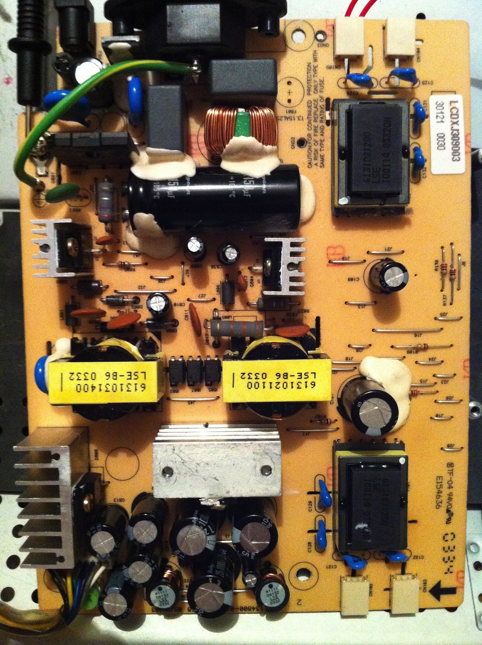

    Hey all, I hope this is in the right thread.
    I have previously fixed a ton of DELL motherboards with bad caps, but I have now been put to the test with two bad 1901fp lcd monitors. I have taken the inverter boards out on both and neither have bad caps. Atleast to the naked eye.
    Here's the problem. They have been powered up constantly at our office for about 8 years with little downtime. We have recently moved, and during the moving process, we tried to fire them back up and they were both no-goes. We get no response with power (and yes, the new outlets work). Now, I have done some research and have found that there can be some bad transistors on these boards. Hmmm. So, I was hoping someone has messed with this board in any way to find out maybe these caps could possibly not blow or leak, but just cause problems. They are the infamously crappy capXon caps. I know these inverter boards are the same as the DELL 1703fpt lcd's.
    If anyone can help, I would greatly appreciate it!!

    1) Post clear focused pictures with the following composition
    https://www.badcaps.net/forum/showpo...94&postcount=1
    Please do not post pictures inline as they slow down the loading of pages.
    For best picture quality and clarity take your boards to a window on a sunny day, turn flash off, and use macro mode. Take a top down view of all your boards (front and back). Make sure the photo is legible so that we can read the PCB printing clearly. A shutter speed of 1/125 or faster will produce nice clear focused pictures. Try to get a photo that is 2000x2000 resolution or as close as possible.
    2) Do you have a multimeter?
    Here is an example of the pictures we want.

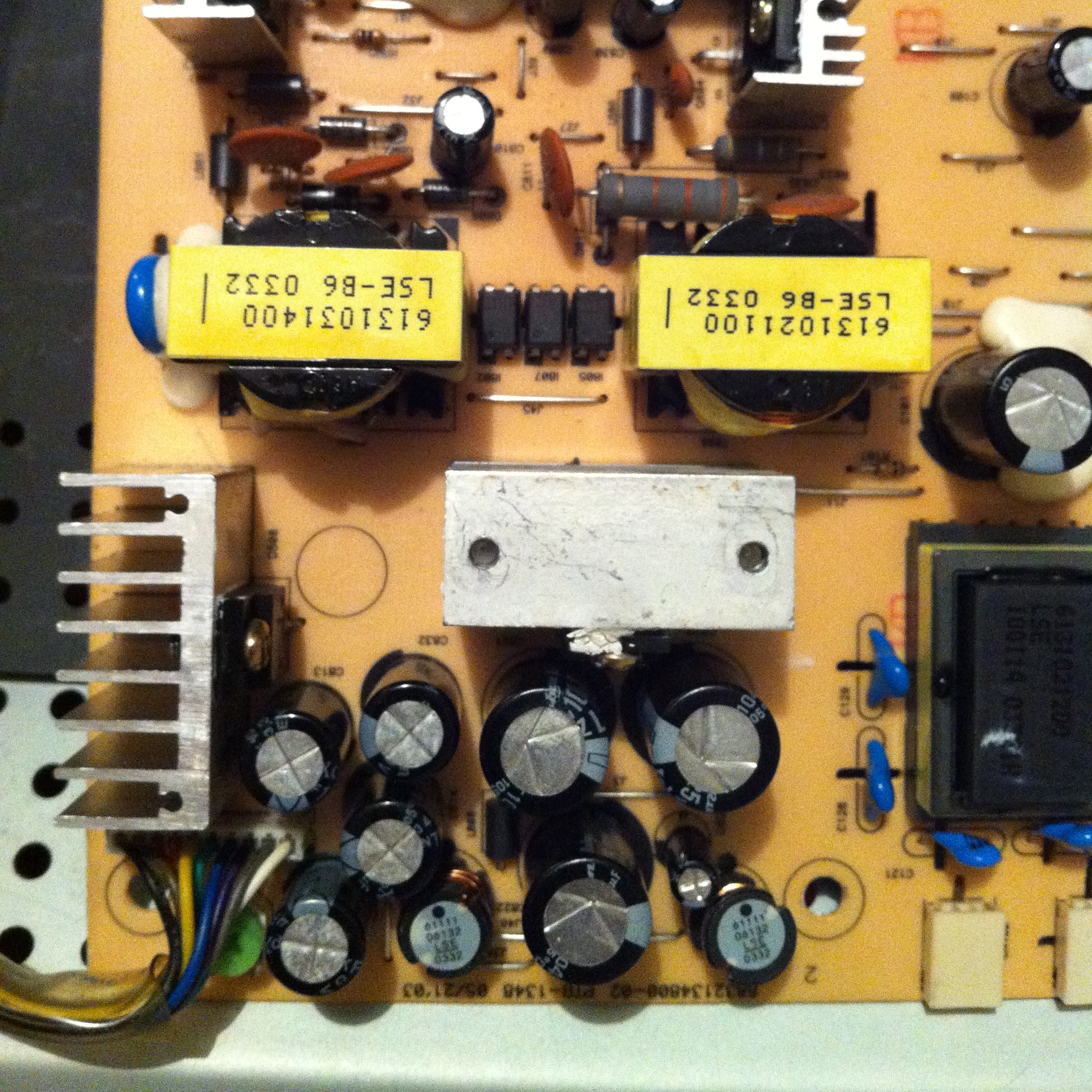

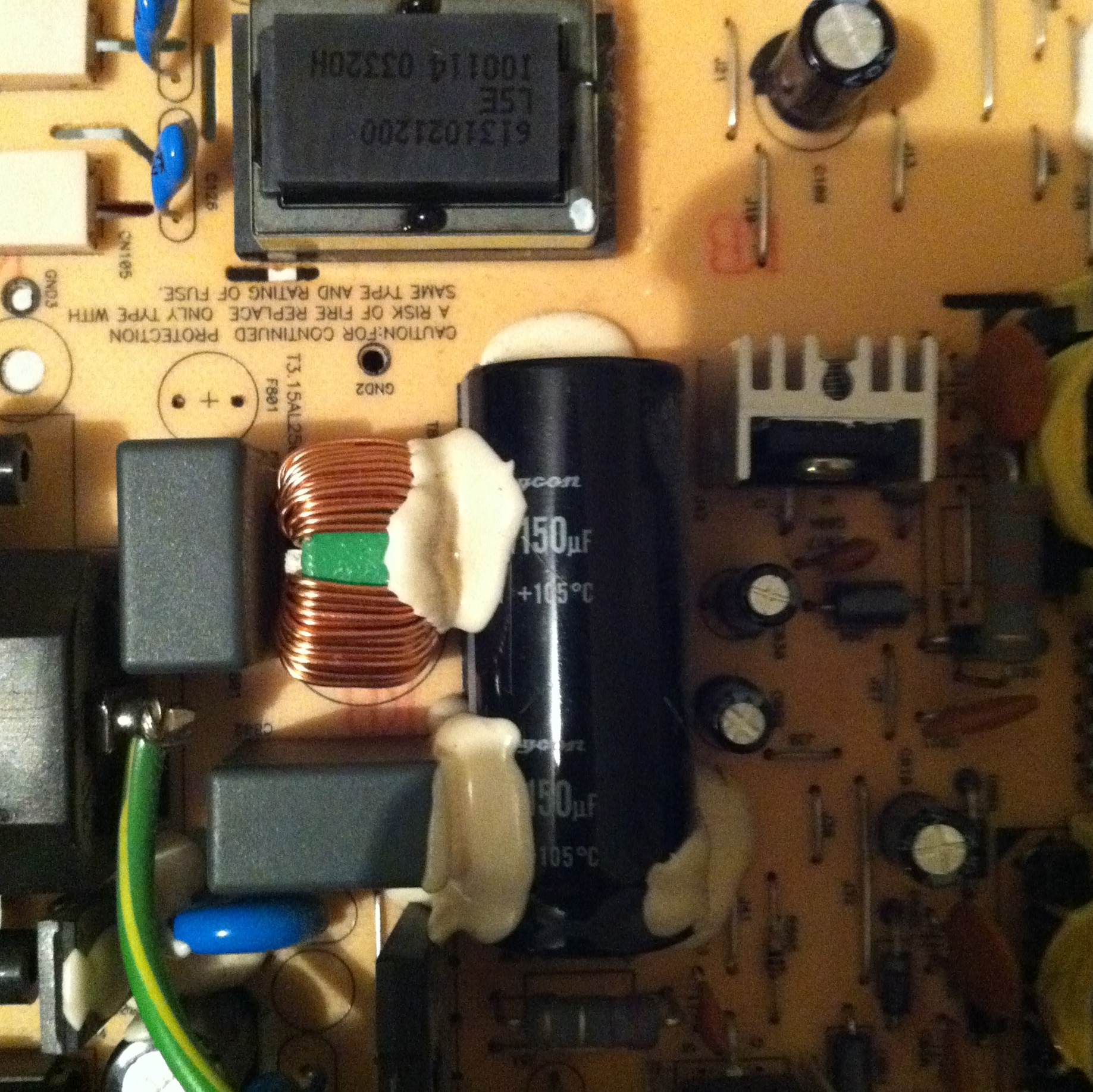

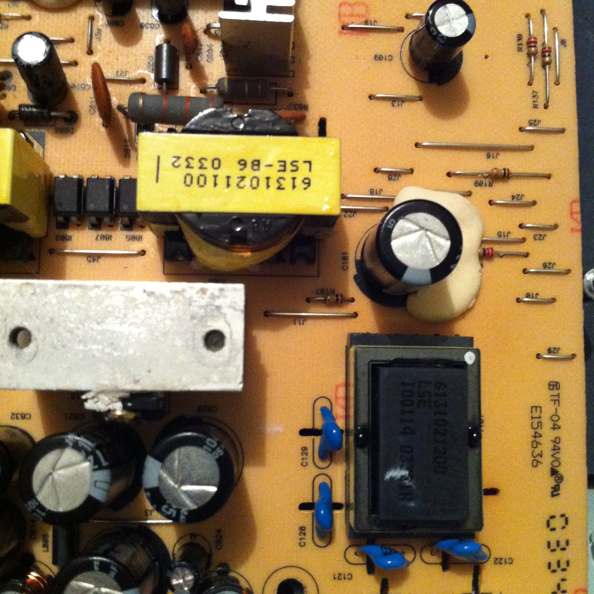

          It's relatively easy to troubleshoot the power supply using nothing more than a DMM. Having pictures to work from makes it easy to direct you. Since you haven't provided pictures, here are the general directions.
          With the power supply plugged in, measure the voltage on each pin of the output connector. Use one of the mounting screws as a ground. Report the readings.
          If there are no output voltages, measure the voltage across the large capacitor. This should read 1.4 X the AC input voltage. If that is present, what is the part number of the SMPS controller?

            I took all of the voltages on the output pins and got a big fat nothing on all of the pins. So I moved on to your next step and found that the giant cap gave me nothing - high 600 millivolts at best. Is this a sign of a bad cap? Transistor? possibly the transformer?
            BTW, this may sound completely dumb, but which one of the numbers on this board would be the part number. Please have some patience with me. This is the first monitor I have played with.
              Are you by chance measuring AC? If yes, we want to measure DC volts across the big cap and the output pins.

                Yeah I measured DC... I double checked again and im still getting nothing..

                  Okay now this goofy thing says 172 volts. So judging by the calculation, its a little over, but I know components aren't always perfect.
                    172V DC is fine. Now what about the output connector pins?

                        Output connector is as follows:
                        blue and purple wires (labeled 5.15V on the board) are measured at 5.18V each.
                        All of the rest are goose eggs (0).
                        • littlski717
                          • Nov 2011
                          • 28
                          Re: Dell 1901fp

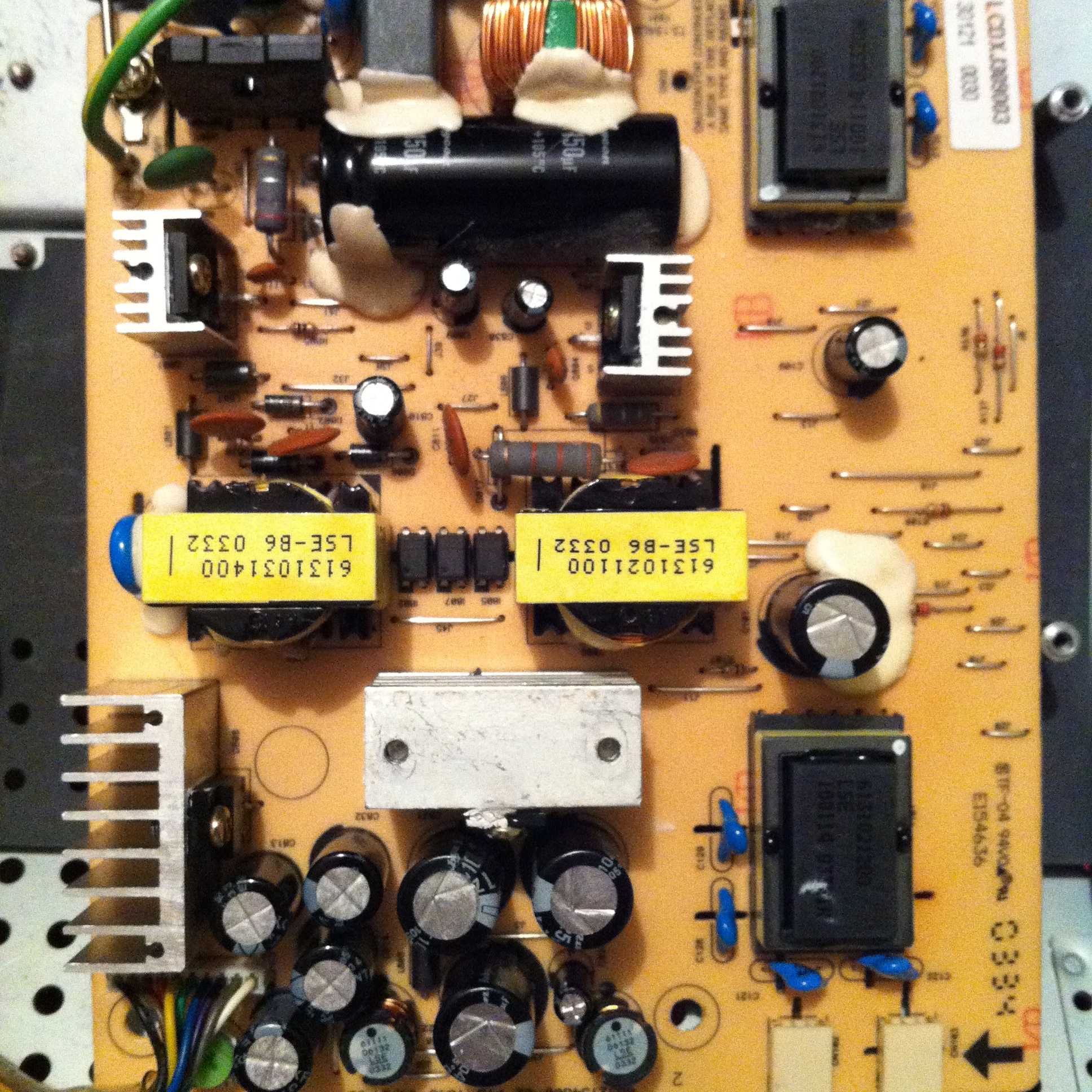

                          I tried to take a couple pics, but my damn camera is broken. I took them with my phone, any idea how to get them up here?
                          • littlski717
                            • Nov 2011
                            • 28
                            Re: Dell 1901fp
                            Alright, I got em. If you need anymore, let me know.

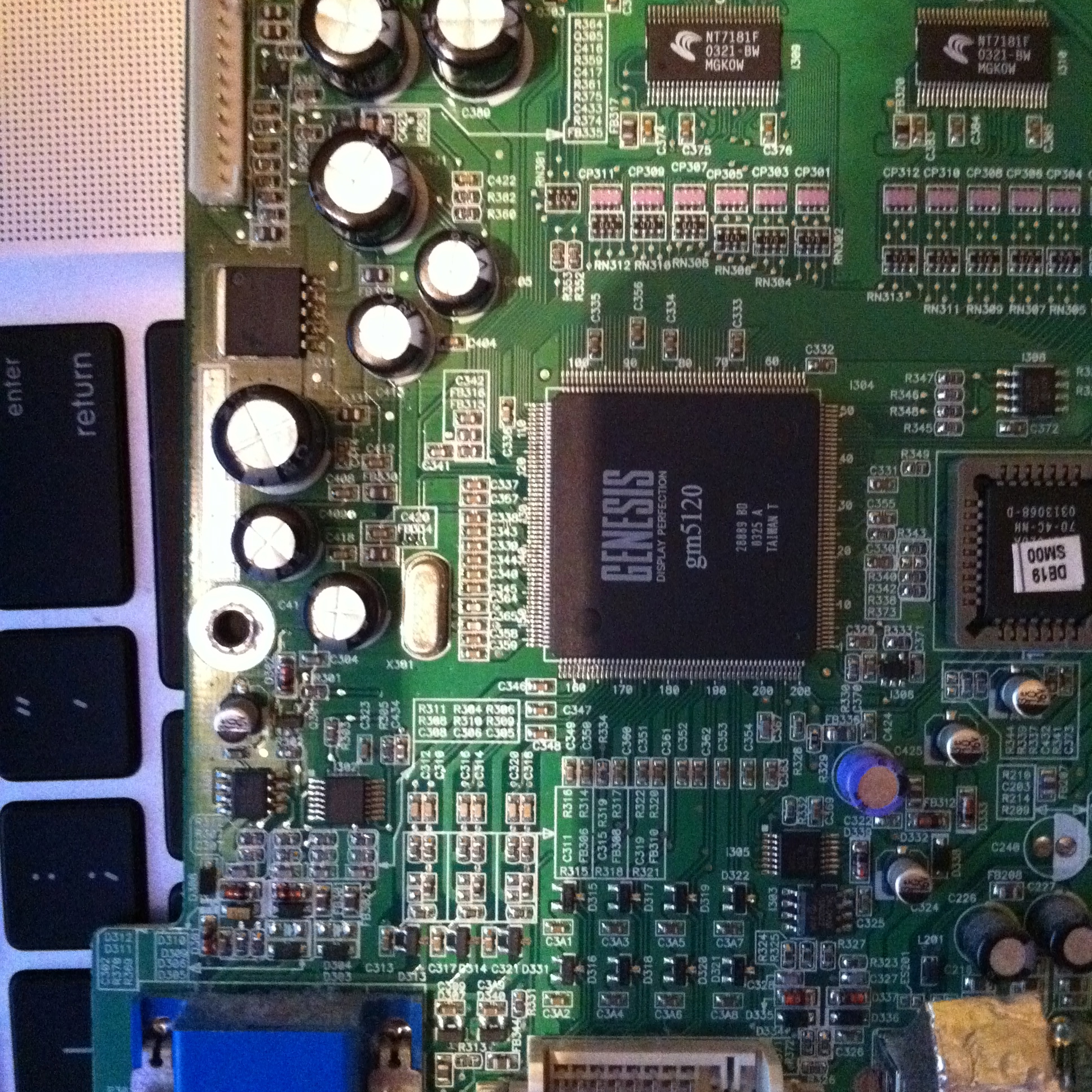

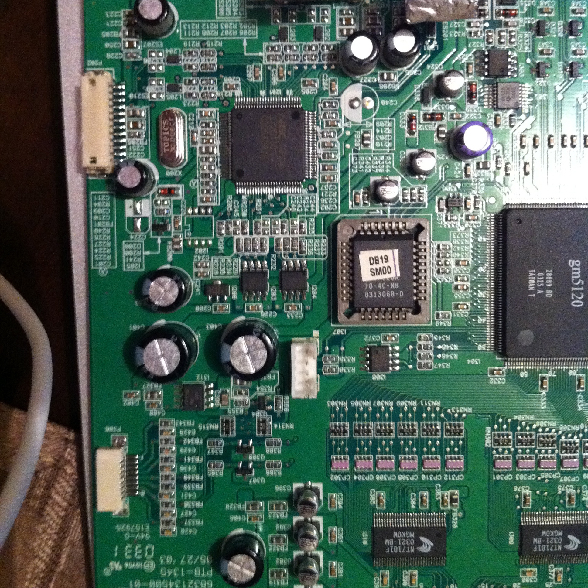

                              We also need pictures of the logic/main board (where your VGA/DVI connectors are).

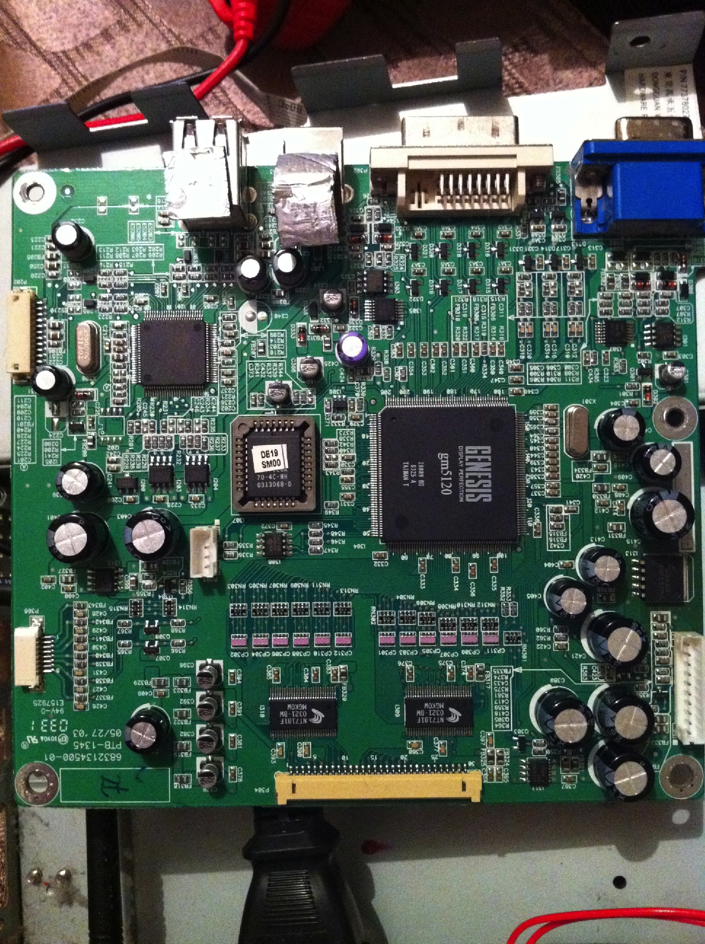

                              • littlski717
                                • Nov 2011
                                • 28
                                Re: Dell 1901fp
                                Here are the pics of the logic board.
                                • retiredcaps
                                  • Apr 2010
                                  • 9271
                                  Re: Dell 1901fp
                                  Can you not crop it? We need to see the ENTIRE board edge to edge in ONE picture. The same goes for the power supply picture.

                                  • littlski717
                                    • Nov 2011
                                    • 28
                                    Re: Dell 1901fp
                                    I did crop it. Unfortunately this is where mac sucks compared to windows. It cuts parts of the pics off. I will try again right now.
                                    • littlski717
                                      • Nov 2011
                                      • 28
                                      Re: Dell 1901fp
                                      Here ya go!
                                        I'm not a screen wizard like these other guys but: reading the sequence of events..
                                        Transistors in -two- screens aren't likely to suddenly fail at exactly the same time, nor from being moved.
                                        The screens also wouldn't work at all if those were shot before you moved, so if they 'went' it was when you moved them.
                                        Since you never turn them off,, the start-up caps may have bit the big one weeks or months before you moved and you didn't notice because that probably wouldn't kill a screen that is already running and you never restart them to see the problem.
                                        - Until you moved them.
